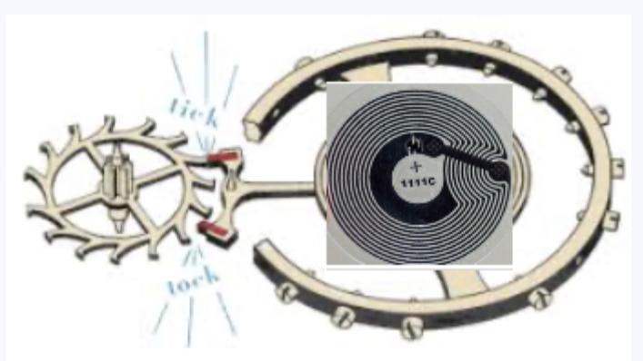

Is that not the spring drive from Seiko?
It should be noted that the Swiss came up with the idea first.
It's just that they didn't pursue the concept to completion because they considered it too challenging to overcome the technical issues around things like adequate power reserve and high current drain from the IC.
It's just that the Japanese persevered with sporadic developments over a number decades to be able to make it work.
960
515
The quartz crystal is the only thing controlling the unwinding of the mainspring. There is nothing else that is controlling it, so there's no mechanical escapement. People often make this sound like the quartz movement is only fine tuning the accuracy that is already there somehow, but it's 100% responsible for the accuracy. The spring would just unwind as fast as the frictional loads of the wheel turning would allow if it wasn't for the quartz crystal.
It's a mechanically powered (spring drive) quartz movement.
I think there are technical aspects built into the design with the Seiko Spring drive that do actually limit the speed at which the Mainspring releases its energy.
I understand that's where the actual magic resides with the Seiko Springdrive👎
960
515
Spring Drive is not a quartz movement. It’s a mechanical movement that’s regulated against a quartz crystal. There’s a brake mechanism that uses the quartz signal to control the rotational speed of the movement to maintain accuracy.
Quartz analogue display movements are mechanical as well. They are just powered by a battery which drives a stepper motor.
Make no mistake, a Seiko Springdrive is a Quartz movement in that it's regulated by quartz crystal technology.
Looking at it from a purely technical perspective.
A mechanical movement that's powered by a Mainspring, needs to have the release of the power from the Mainspring controlled by a mechanical/physical locking and unlocking mechanism of some description.
I imagine Seiko don't promote their Springdrive as a Quartz movement as that would devalue it from a certain perspective and make it a hard sell at the price point they need to sell it at.

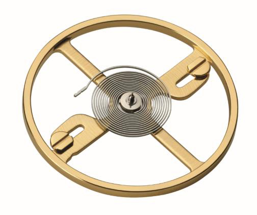

to me it looks just like their Silicon Hairspring.
Yup … with my rifely speculated 1000h Power Reserve improvement, upon the rifely speculated ‘Apple Watch x Omega’ collab … upon the rife fact that the Apple Watch will only be fixed when it no longer needs recharging every 17h … I speculate that they are fixing the Apple Watch 😁
