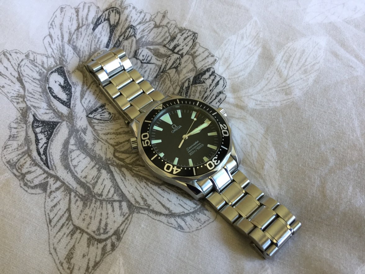

What are the bracelet model numbers that fit this watch .
I know one of the bond styles fit it to but can't find the model

An old bond style bracelet (from SMP) is 1503/825.
This case takes also a newer bond bracelet, from SMPc - 1515/816.
Aqua terra bracelet fits SMPc case too, but i do not know a number of this bracelet.

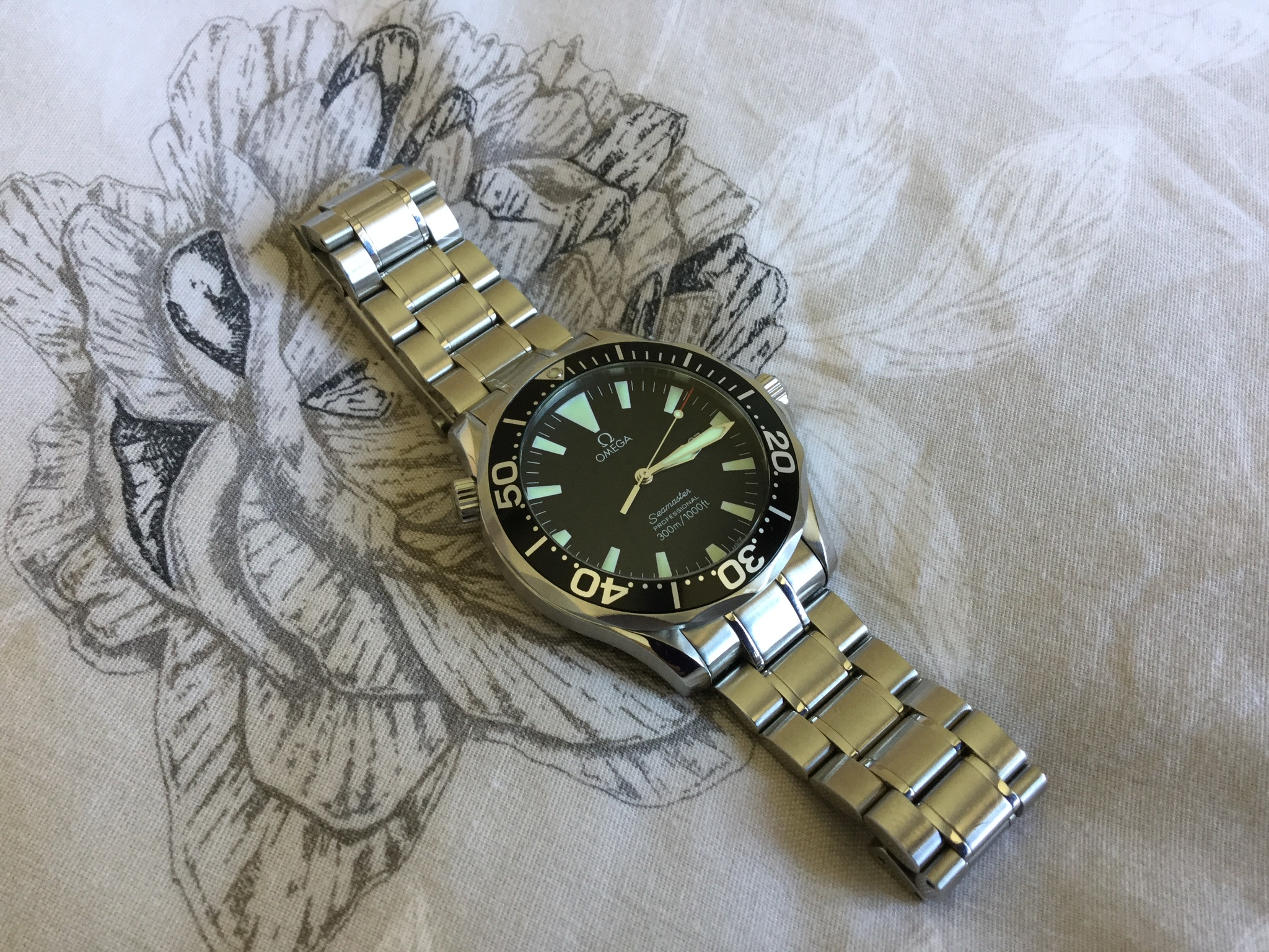

You usually find these on the 1610/930.

The 2254.50 and 2264.50 were also supplied from factory on the 1503/825 bracelet but the speedy style bracelet was the more popular choice. The model numbers for the Bond bracelet watch models are 2054.50 and 2064.50.
