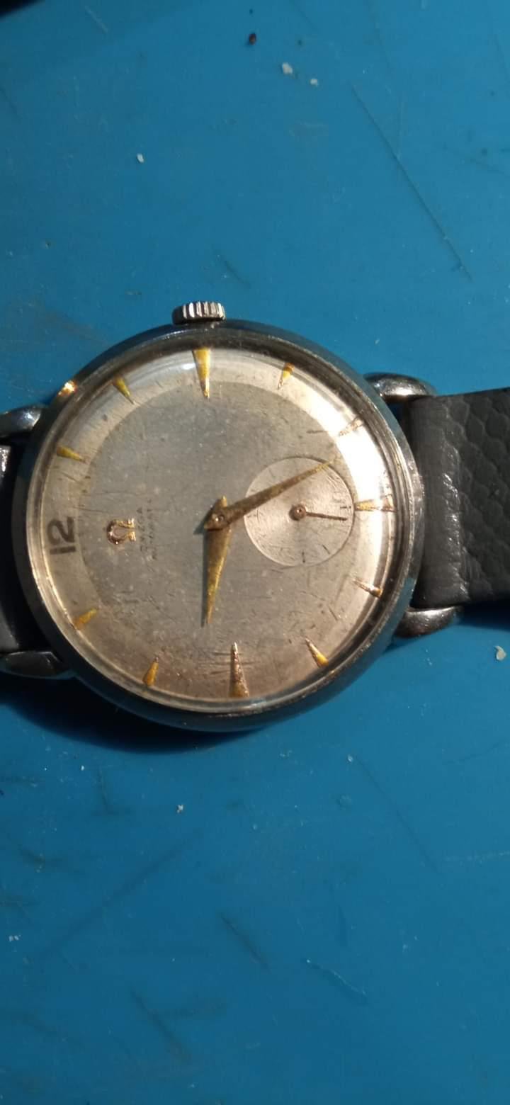

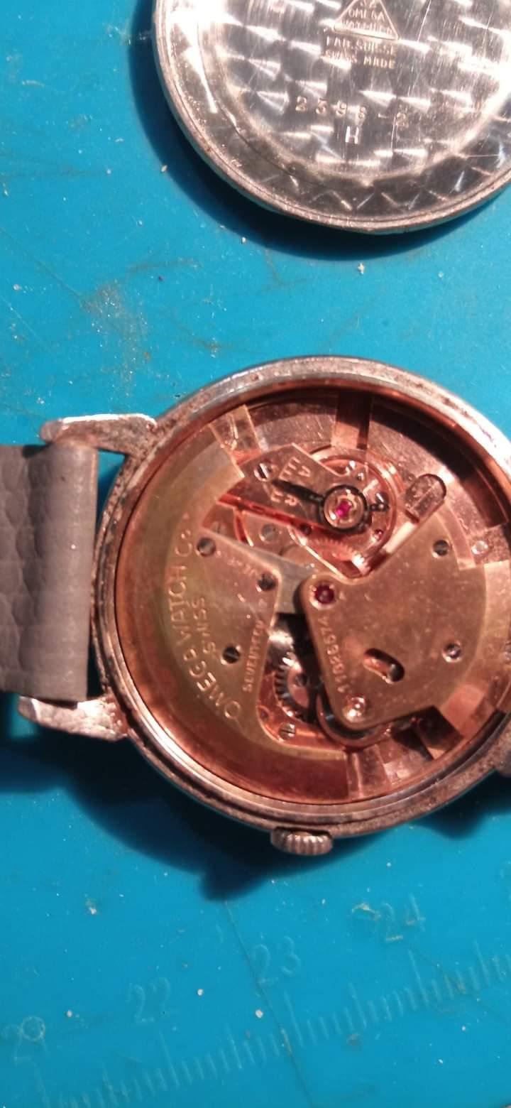

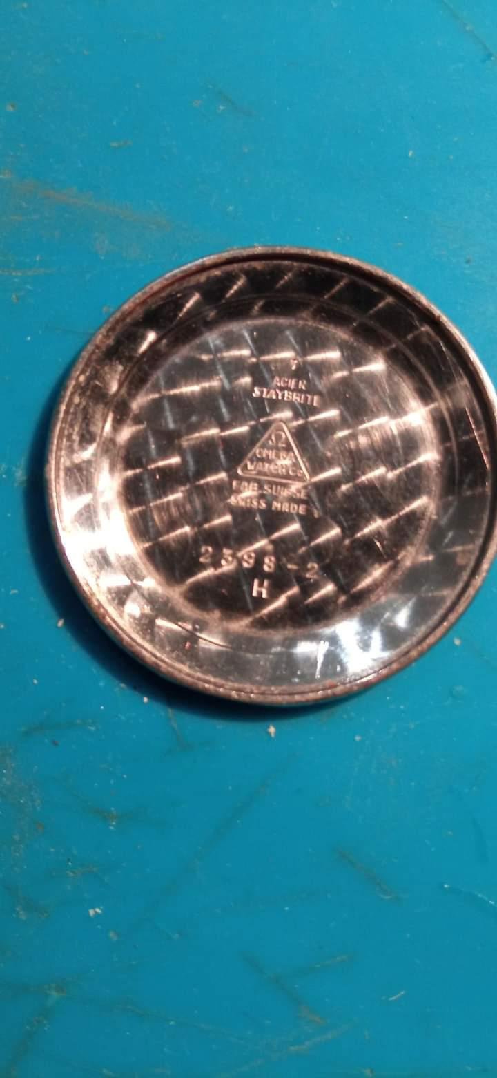

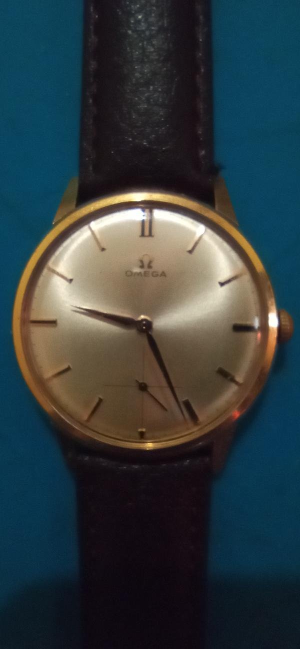

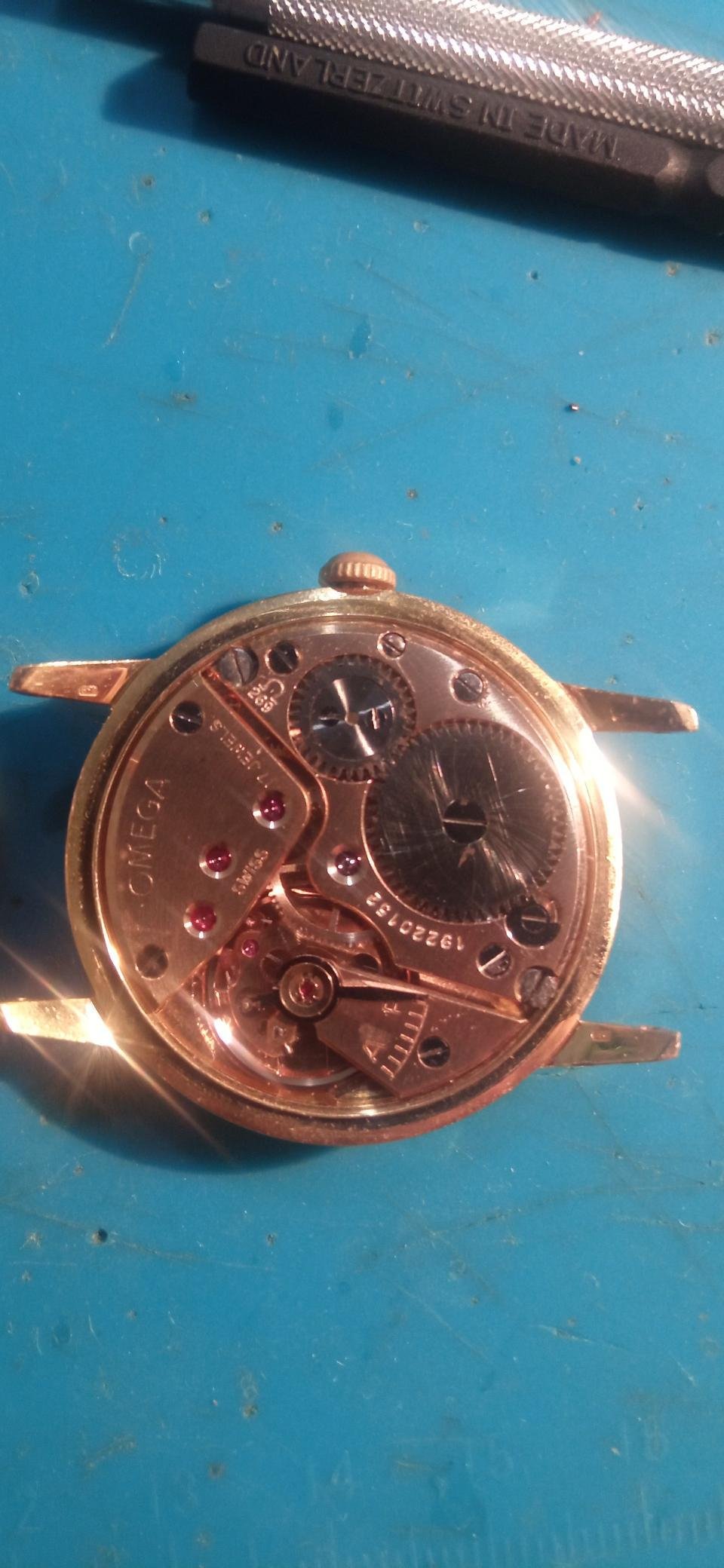

Hello i have two vintage omega watches. Their reference are 121.010 and 2398-2 . For the first watch i would like to know if it has its original crown and if not ,what is its original crown. For the second, i would like to have your opinion. Should I restore the dial, should I find a replacement,or should I leave it as it is? Thank you in advance

Your 121.010 was introduced in 1962 so I would expect to see an Omega symbol on the crown.
The original part number for the crown (gold) is LA35002.
https://adnhorology.com/products/omega-069-la35002-gold-plated-crown
https://www.omegawatches.com/en-au/watch-omega-other-omega-ba-121-0010
Regarding the 2398 I would have the dial dusted with a fine sable brush and a puffer, nothing else.
Both watches should be sympathetically serviced of course.

Got two versions on tap size for the caliber 265 - 6 or 7 from two different sites. Any new crown is going to be plated, so not a great match to the gold case, but not much you can do.
Other option is find out the exact tap size of the step and find a vintage gold filled crown. Doesn't need to be signed. Just something in the correct diameter and matching tap size. Also buy a new stem when you buy a new crown
Try a little Polywatch to see if the crystal will clean up. Might make the dial look a little better

Thank you very much for your reply. I have both warched serviced but my photos are a bit bad
