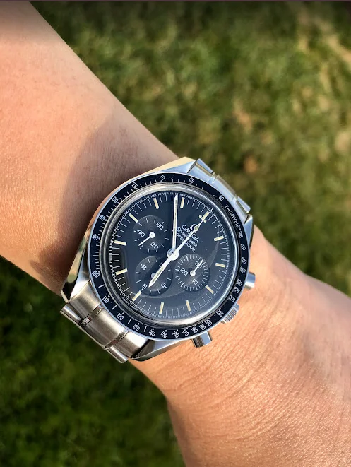

I have a 1998 3570.50 with a tritium dial (1499/842 bracelet). This morning, I wound it as usual with no issues. A few hours later, I noticed that it had stopped. When I attempt to wind it, the crown rotates normally with the ratcheting sound, but it just keeps spinning with no increasing tension. From what I've read, I'm guessing this is a broken mainspring, but I'm hoping it's something less serious. I've owned it for six years and never had it serviced - we were living in SC for the majority of that time and the times I attempted to find someone to service it, no one was willing to do it without mailing it off, so I just always put it off (obviously, I greatly regret that now). Would be happy to hear of any alternate theories / potential service providers in the DC area / ballpark estimates of cost. TYIA.

The original purchase date was 1998. It’s my understanding that the watch itself was likely manufactured earlier - as you point out, likely in 1997 or even earlier perhaps. The dial markings and lume, plus the condition of the hands suggest to my untrained eye that it is in fact a tritiim dial, and I don’t believe it’s out of the realm of possibility that it was perhaps made earlier than the purchase date.

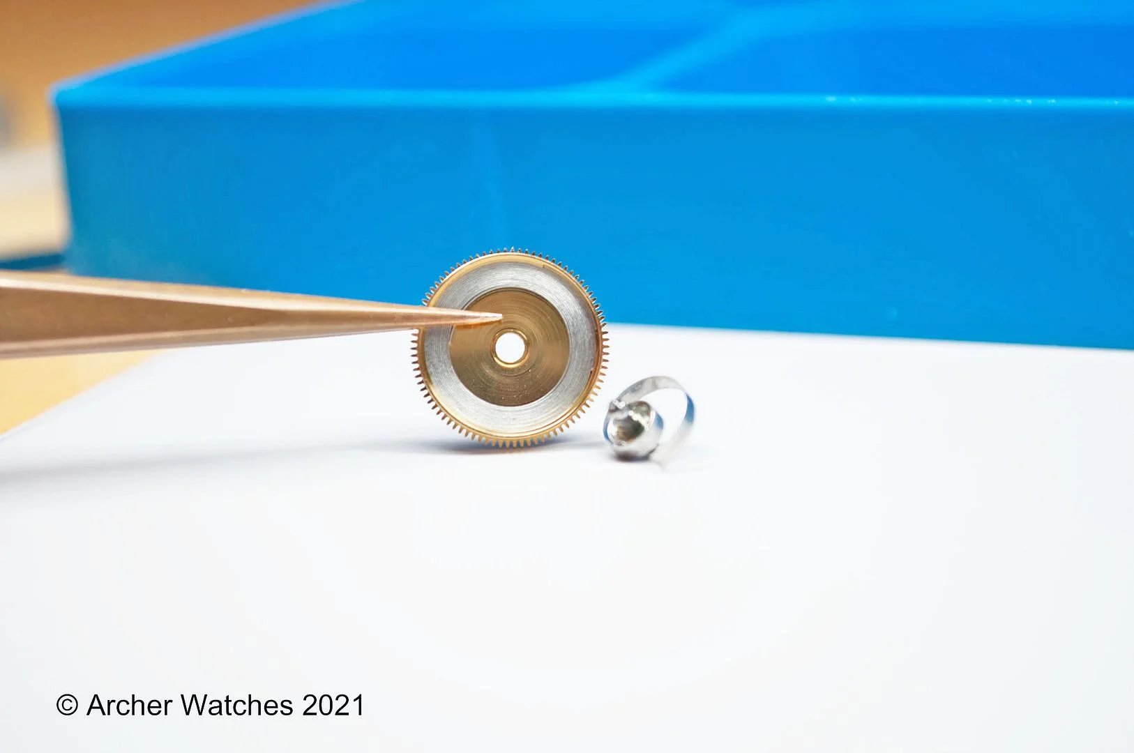

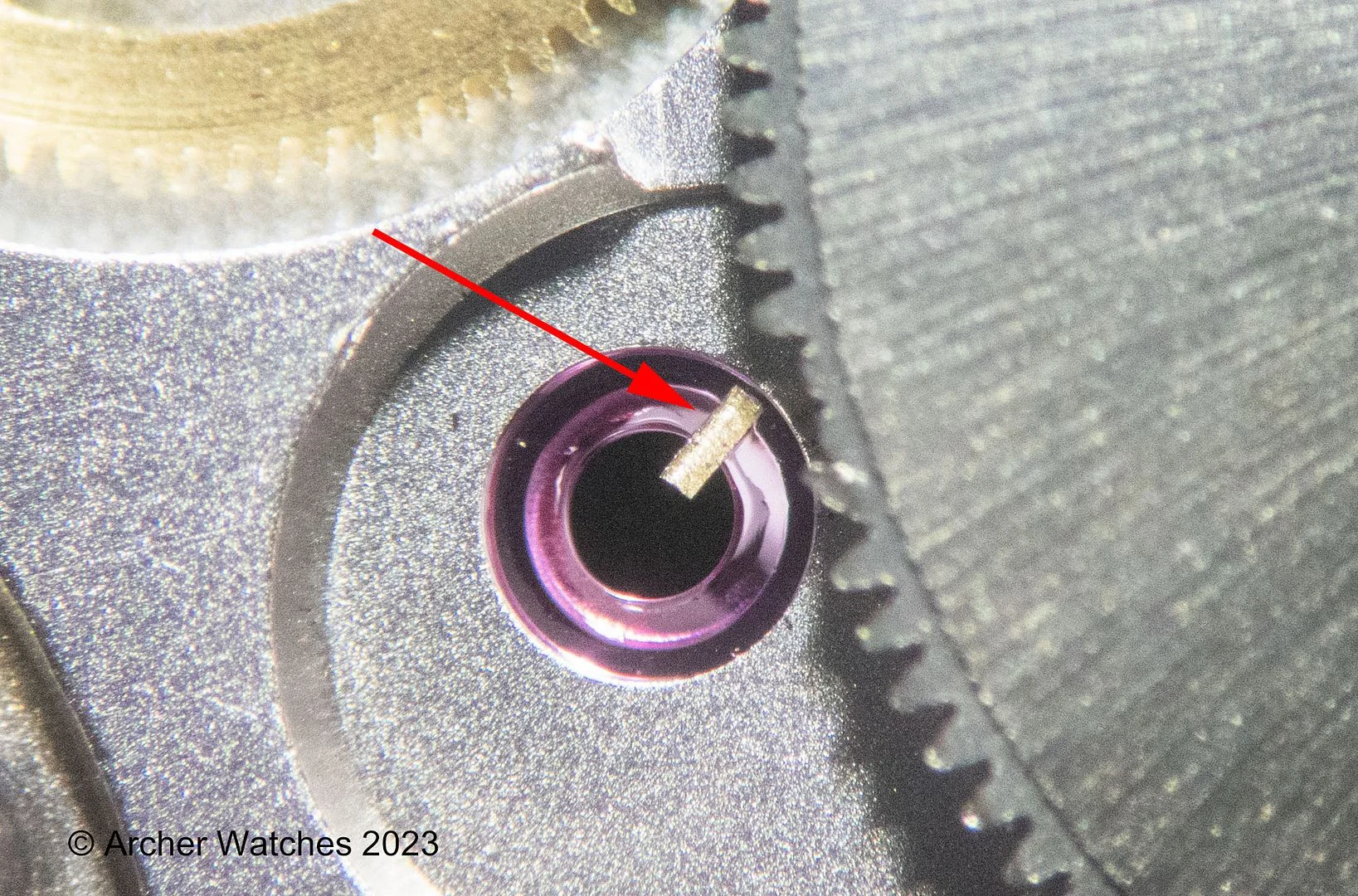

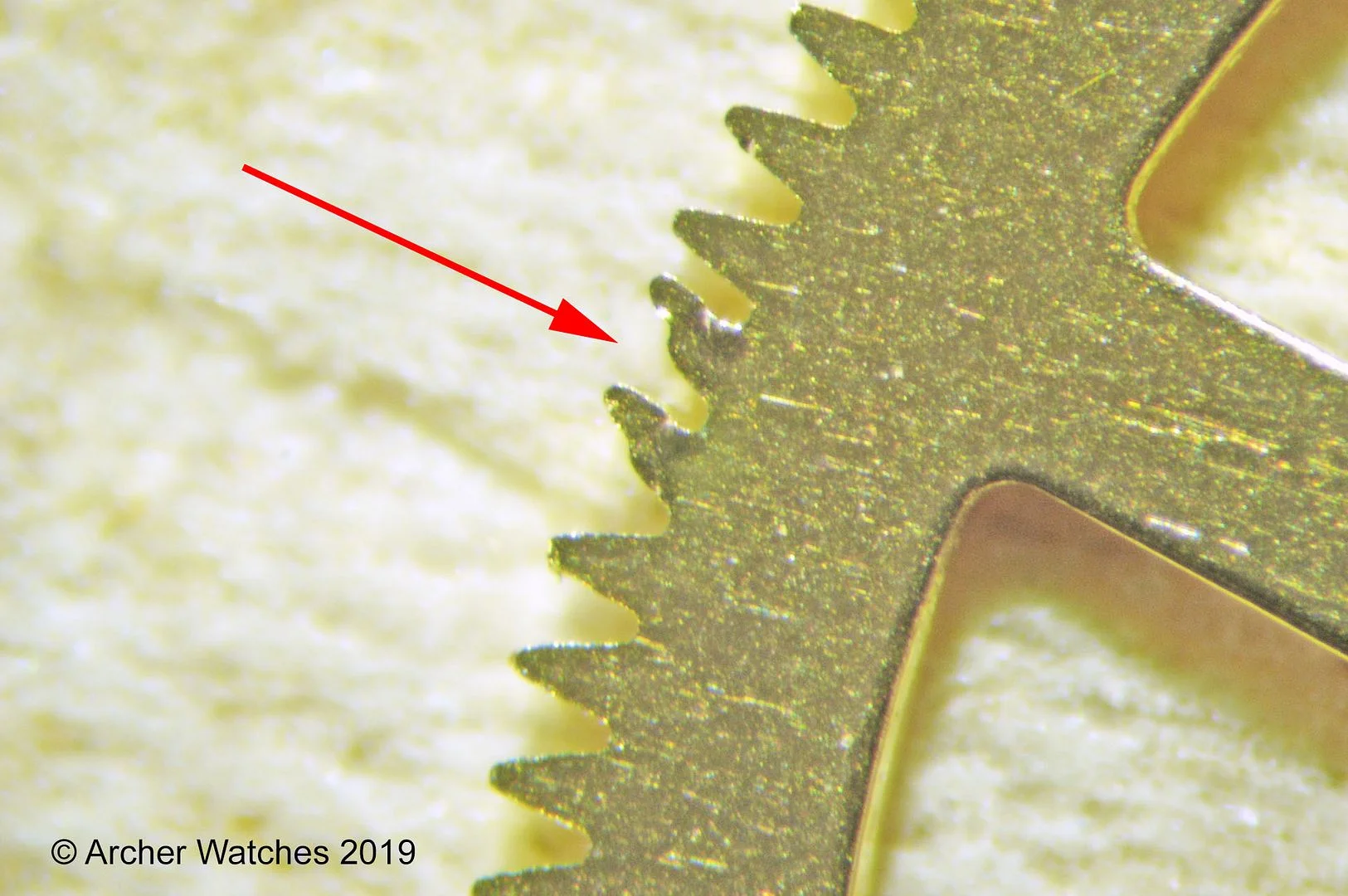

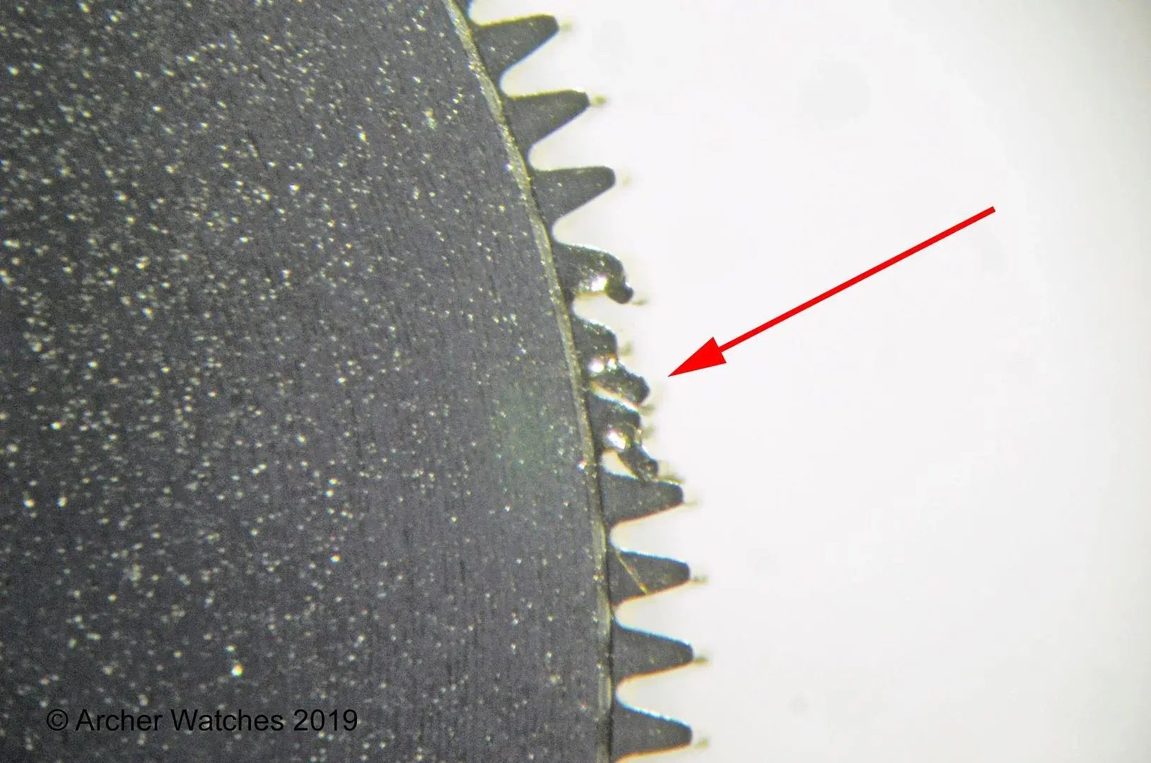

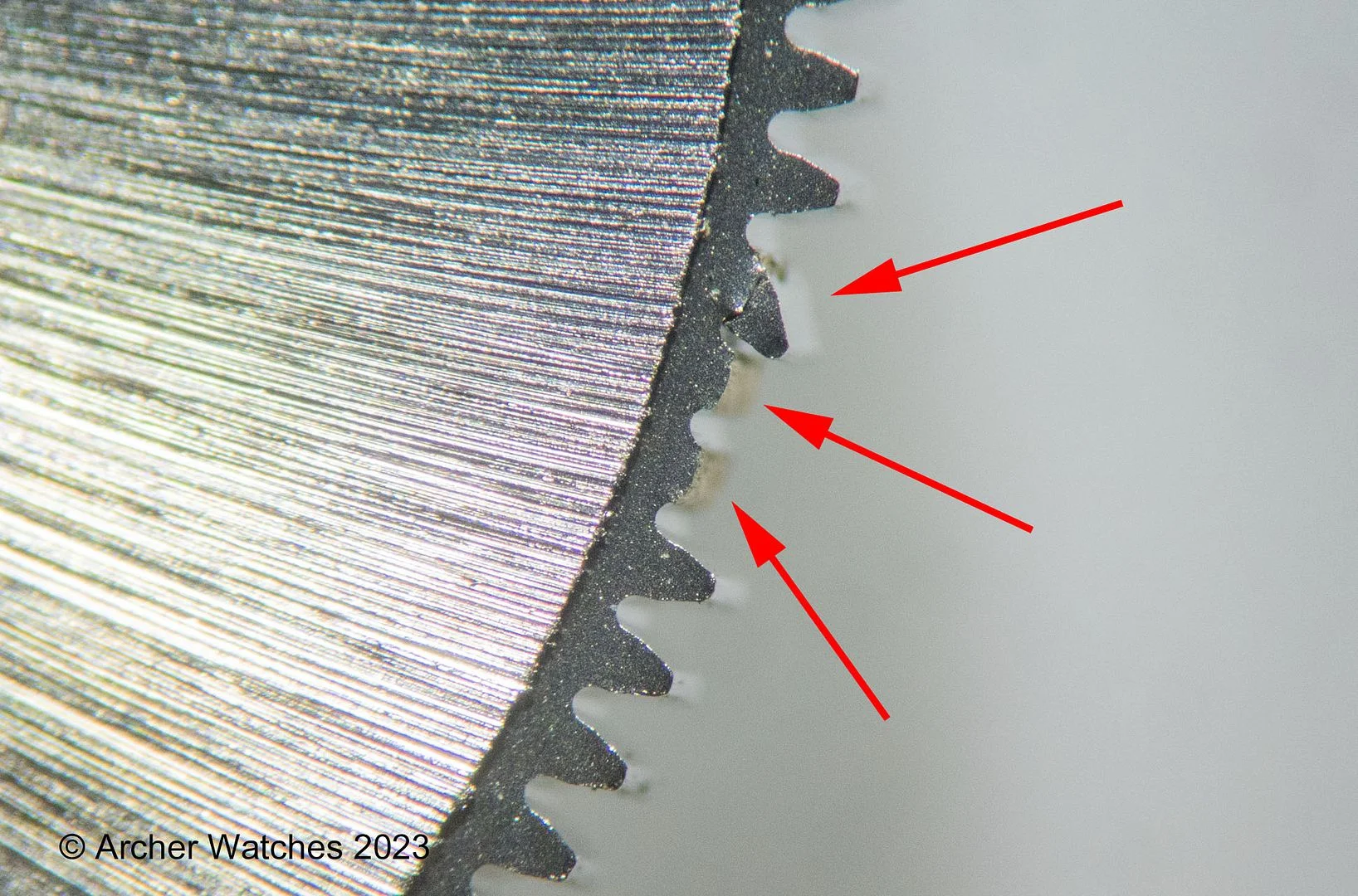

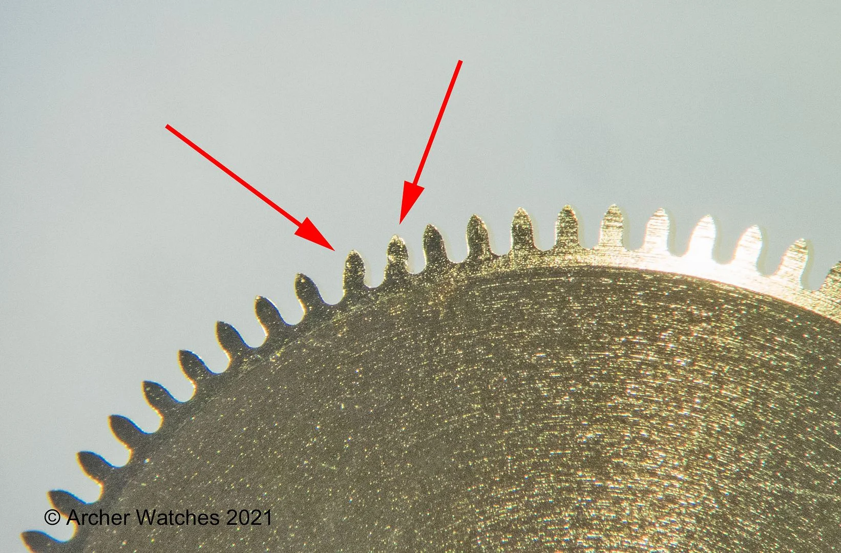

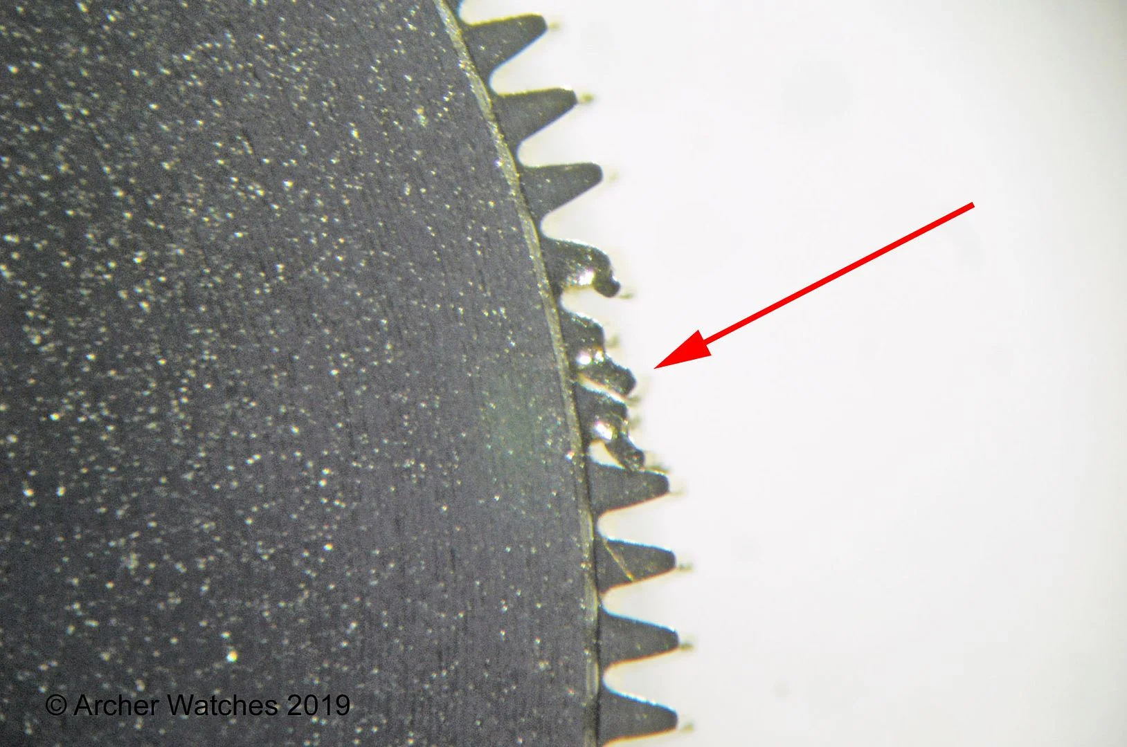

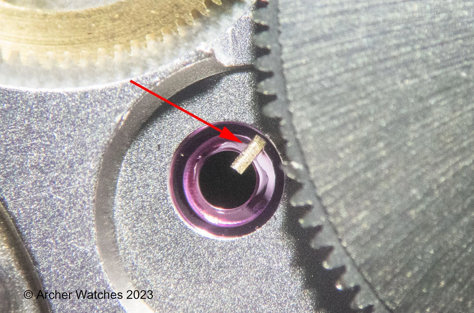

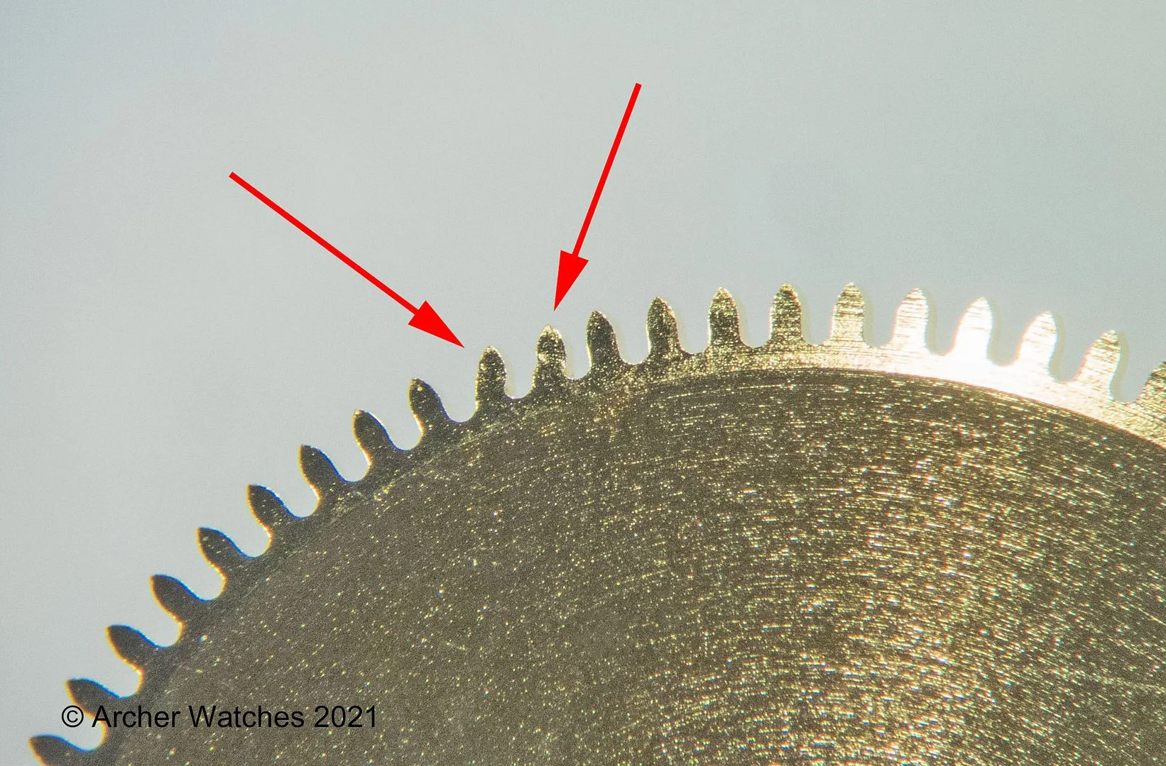

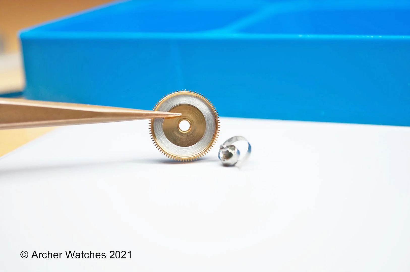

Well, it depends. If the spring breaks at full wind (where it normally does or close to it) the spring unwinds with a good deal of force. That torque is transmitted to the barrel drum, making it want to turn with a lot of force. Of course it cannot turn because the teeth on the barrel are engaged with the teeth on the center wheel (or whatever wheel is next).
This can lead to damage to the barrel teeth and in some case shear those teeth right off:
Sometime it just bends the teeth on the barrel, like this:
And it can carry that force through to the center wheel - not common but it does happen:
Neither of these examples (only a few of the many I've had over the years) are Speedmasters, but this one is:
Yes, often you get away with no damage, but every time a mainspring breaks, you really needs to look at all the teeth on the barrel quite closely to check for damage.

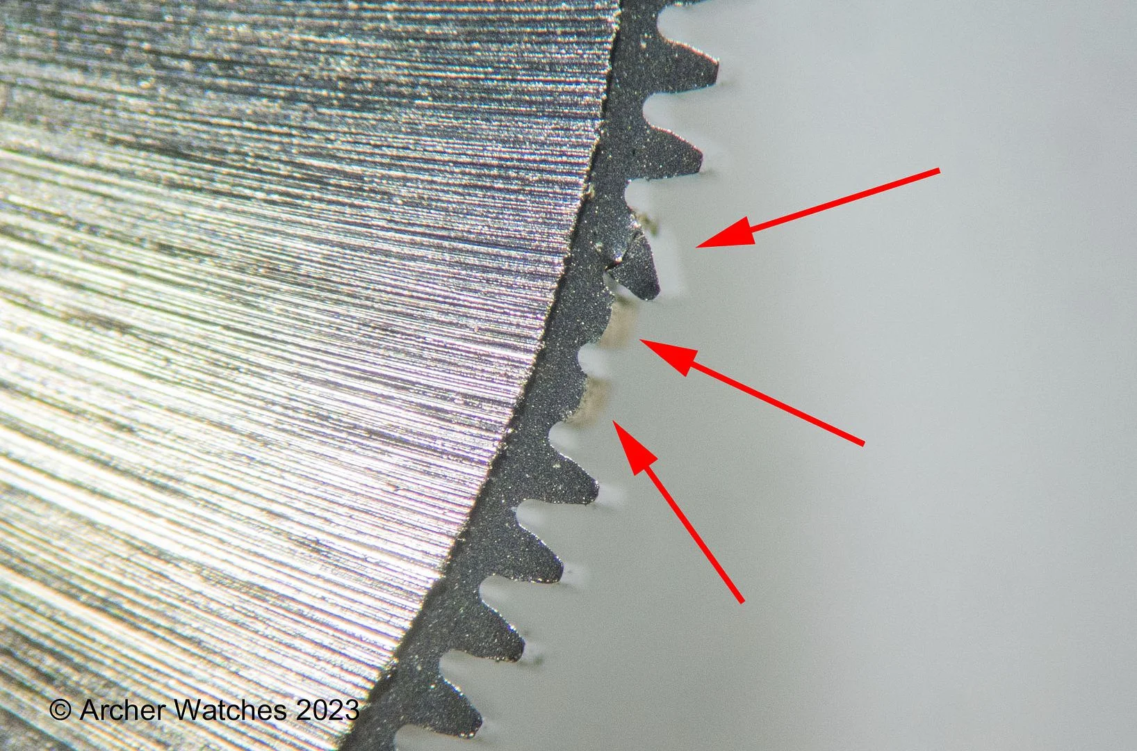

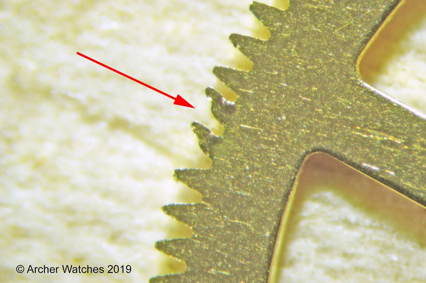

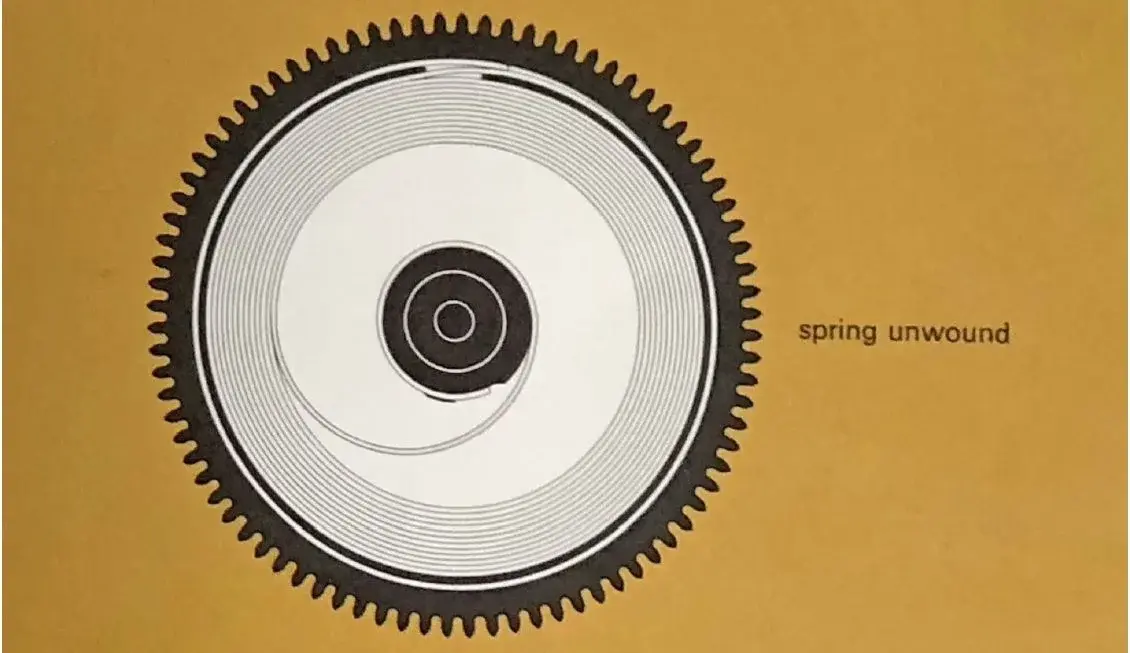

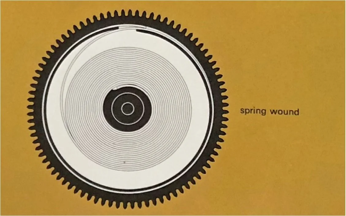

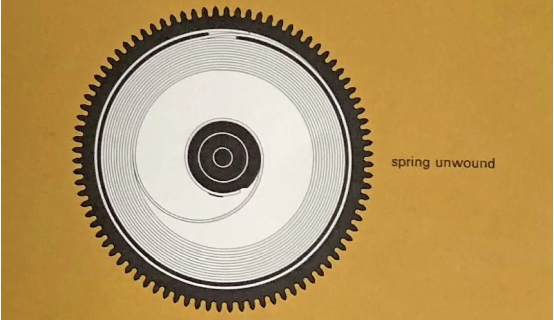

Here is an illustration of an unwound spring inside the barrel:

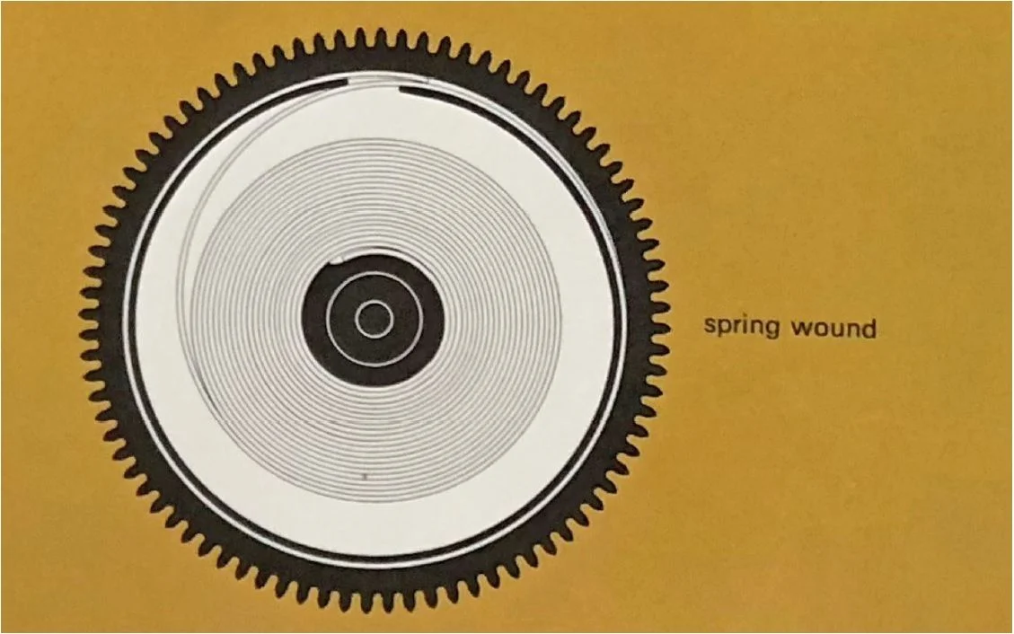

Here is a fully wound spring:
When the spring breaks near the arbor, nearly the entire mass of the spring is let loose to go from fully wound to fully unwound in an instant. It quickly unwinds until something stops it - what stops it is the outer coils slamming into the barrel wall, and this imparts a torque to the mainspring barrel, making it want to turn. Clearly the stronger the spring, the more torque this is going to create, which is why the most common movement I see damage like this on is the 6497/6498 movements, which are essentially pocket watch movements that have been used in wrist watches like Panerai.
