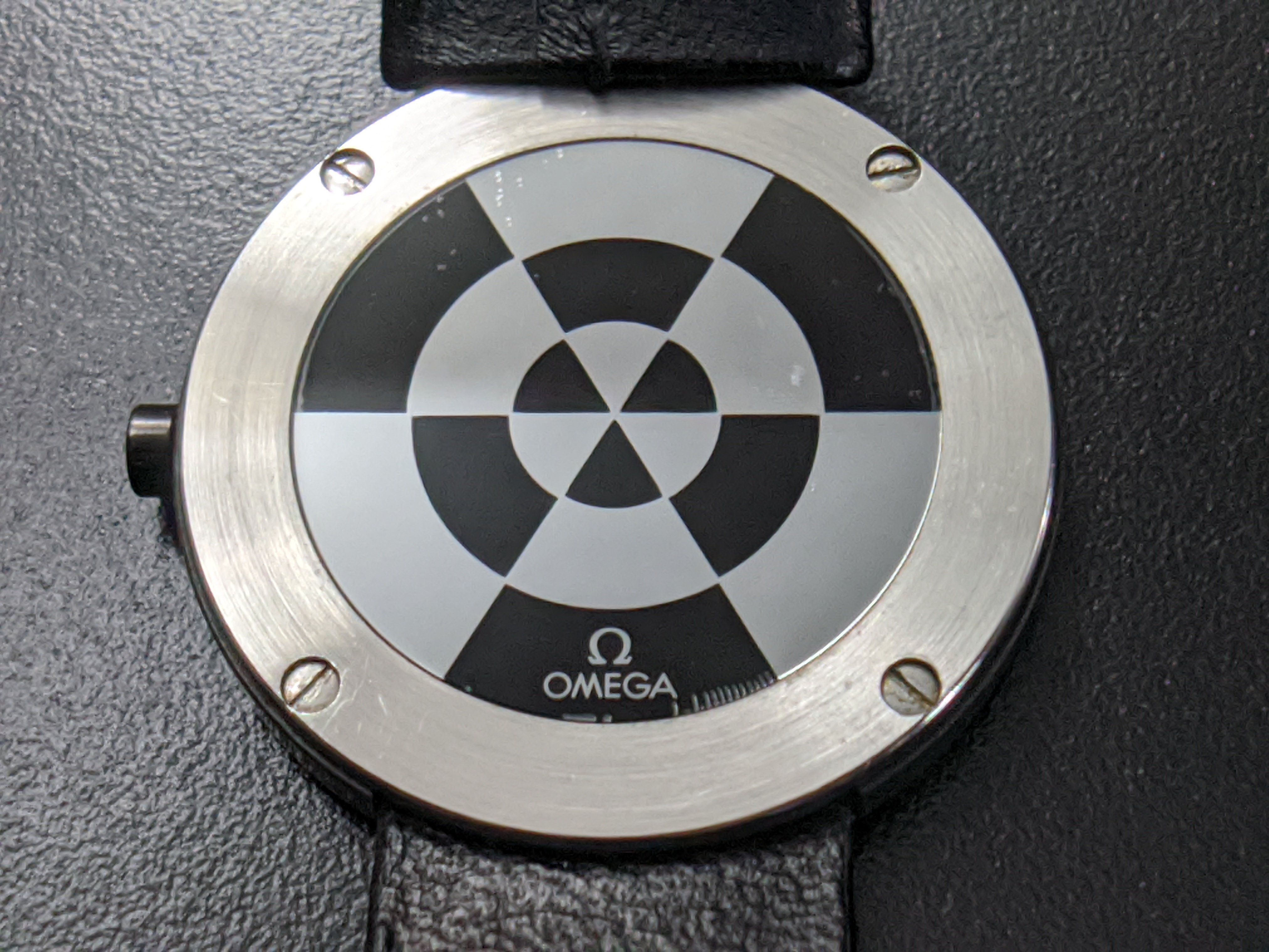

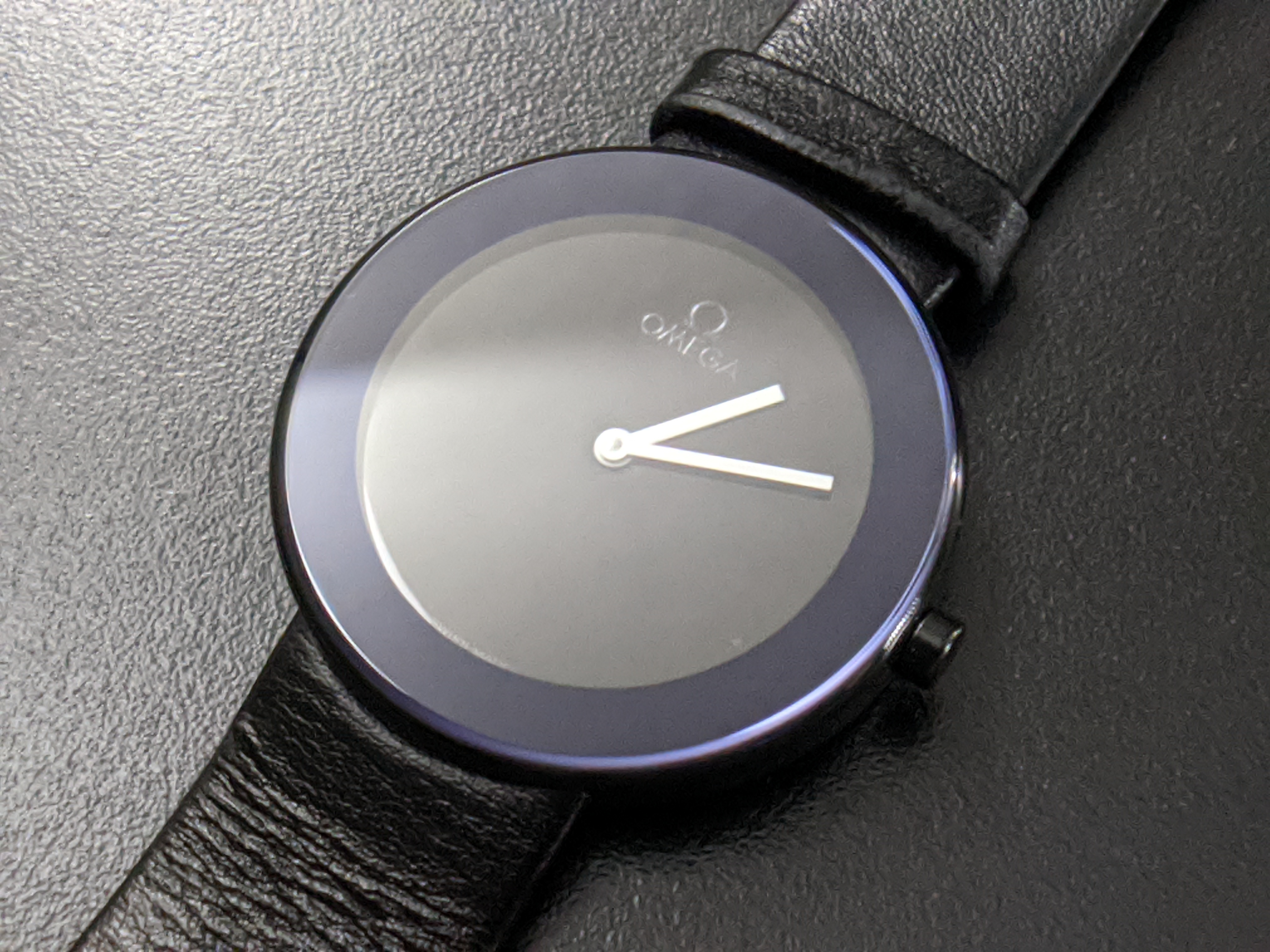

I recently purchased a supposed 1986 Paul Talman Art Collection (32mm, black dial, no-date) for $288 on eBay. I was a little skeptical of the legitimacy, as the caseback art was "off" (pattern inverted, compared to the only image I've seen of this reference here at the top left of this image: https://omegaforums.net/attachments/img_3258-jpg.344679/). However, for the price, even if it's fake, it's fine by me as it has that great 80s vibe.

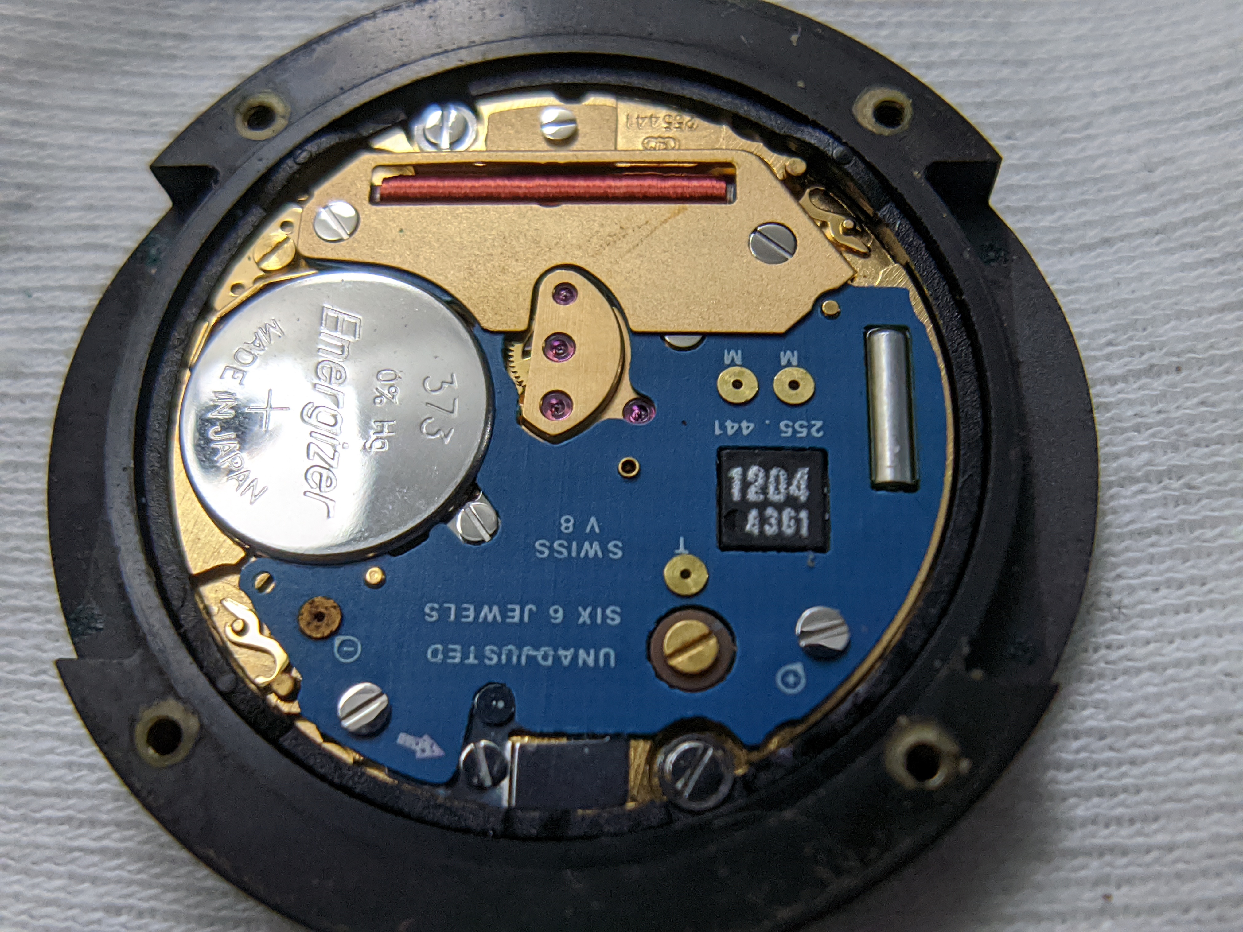

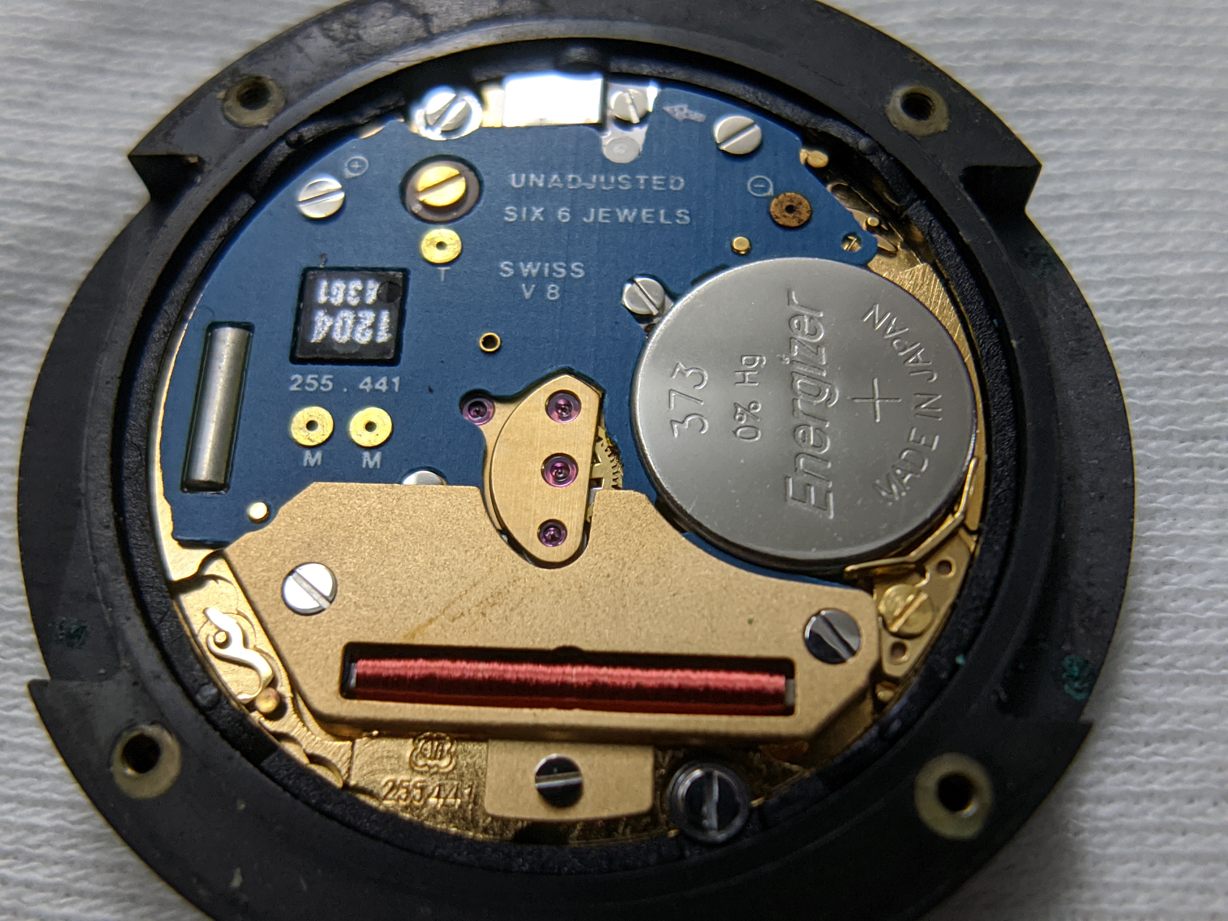

I took my watch apart and found an ETA 255.441 in it (date complication); this is the Omega 1436 equivalent. My dial has no date window, but I know movement replacements are common in older watches. I assume a 1455 would be the original movement for a typical no-date Art Collection?

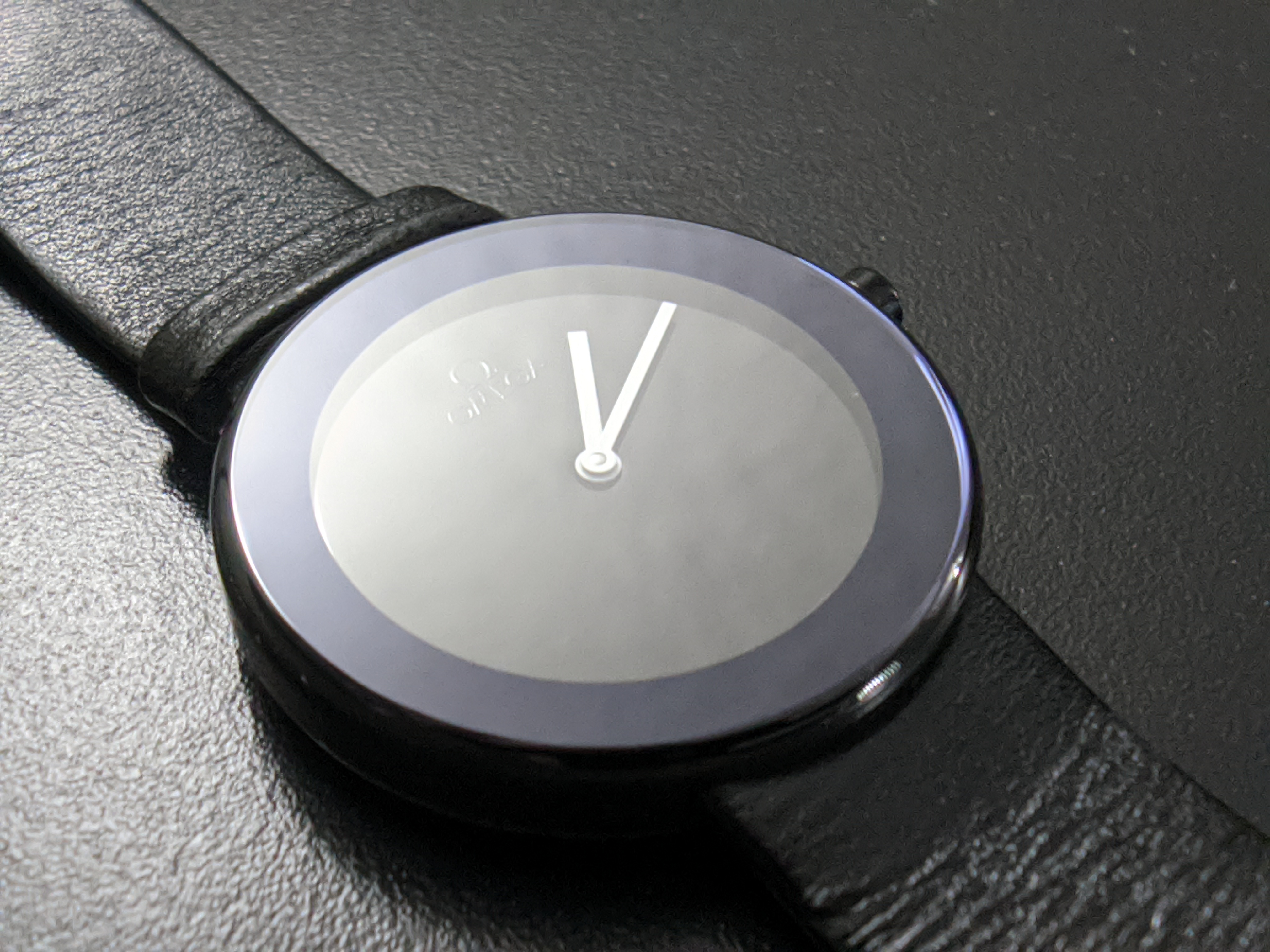

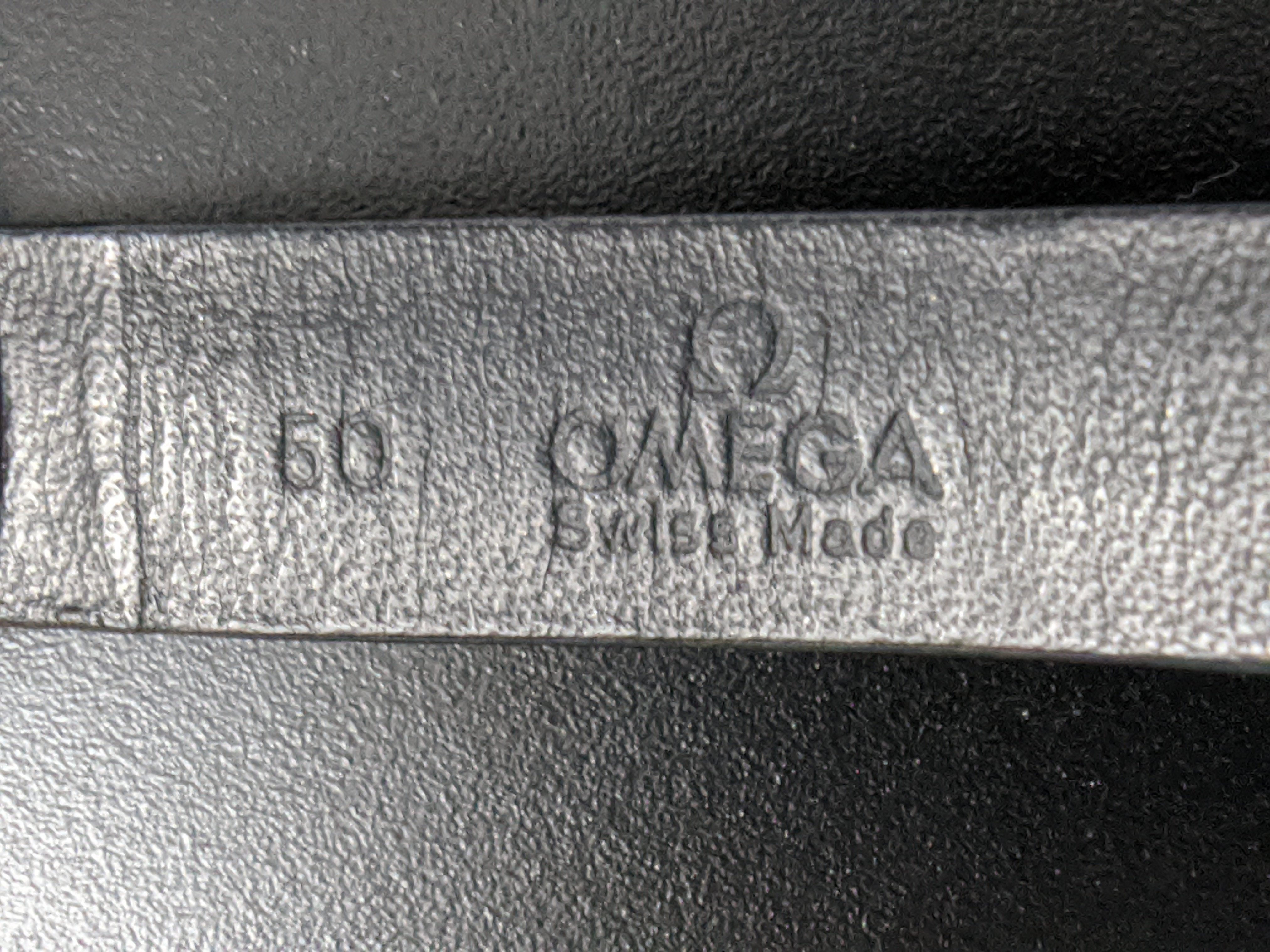

The leather band looks legitimate, as well as the dial. The caseback is where it gets interesting.

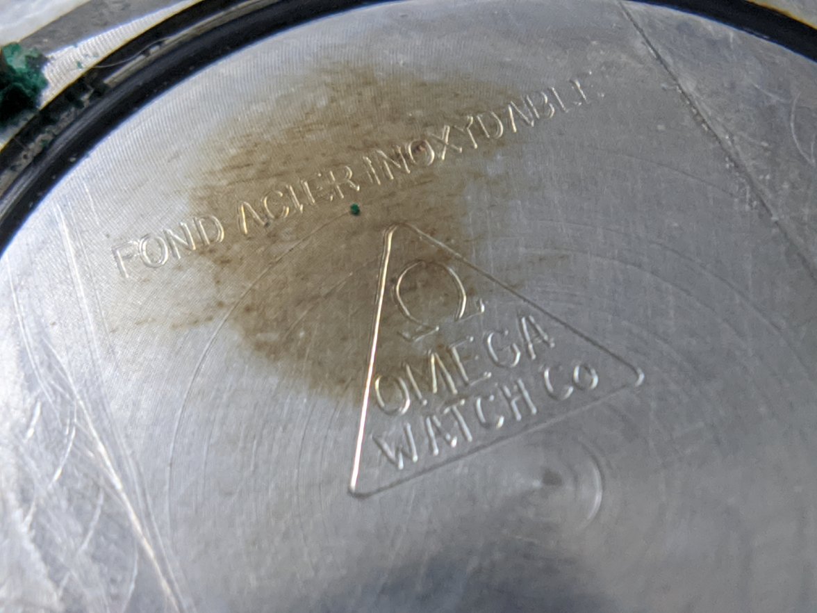

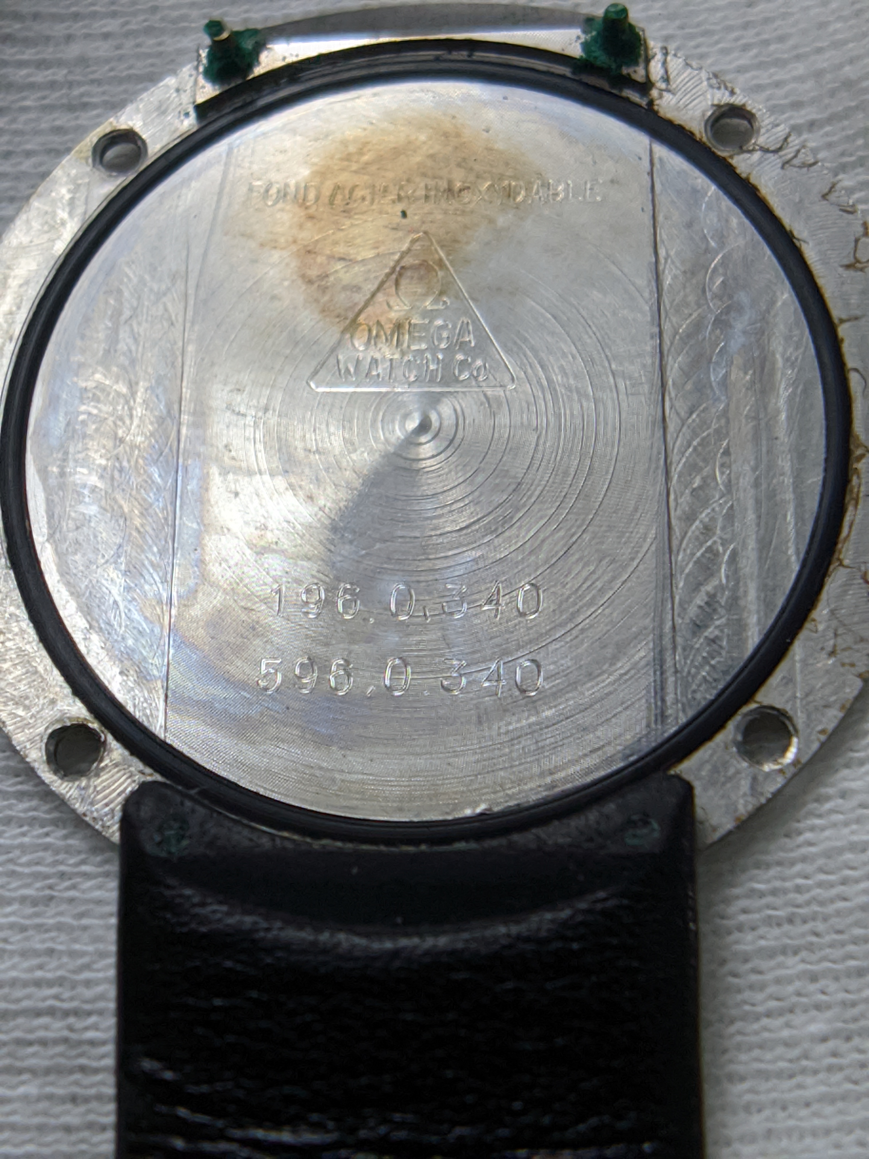

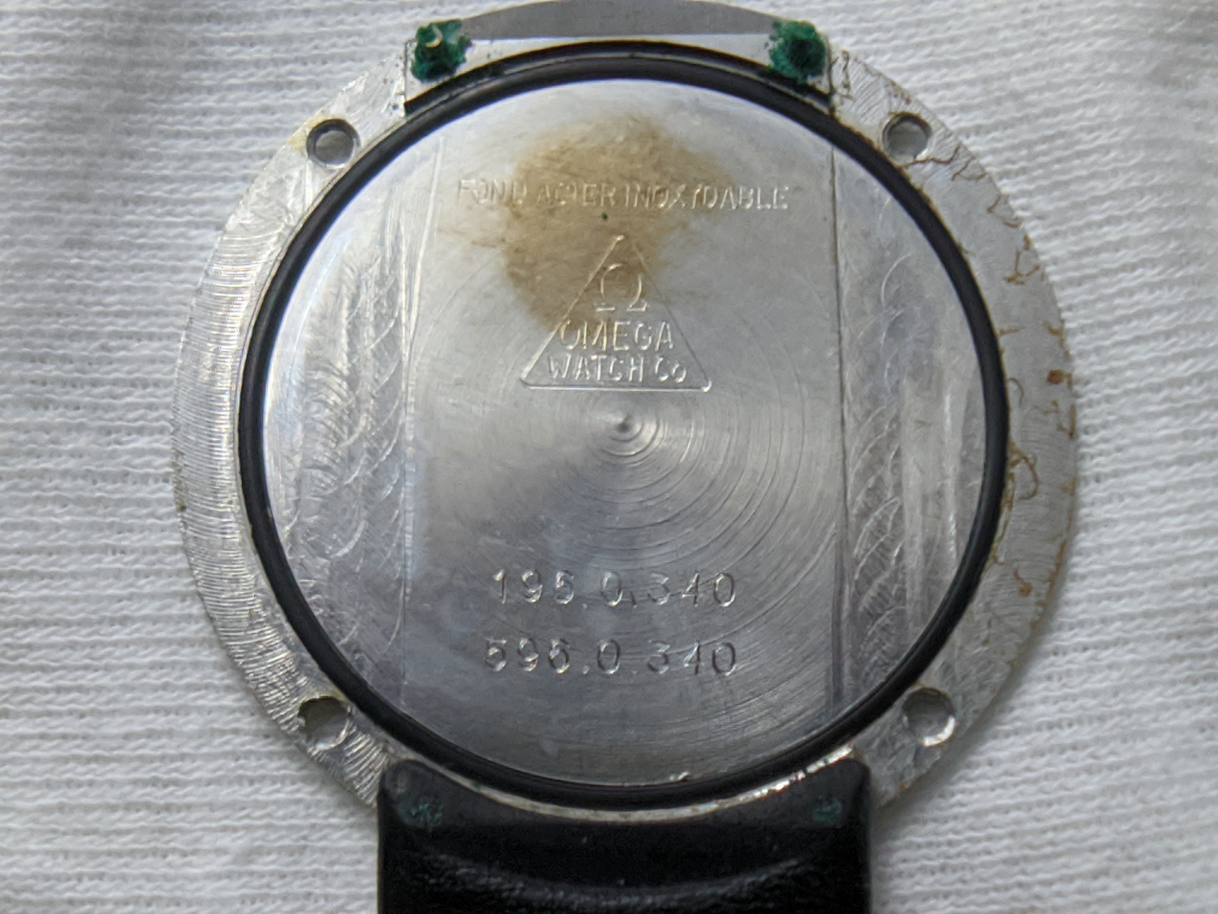

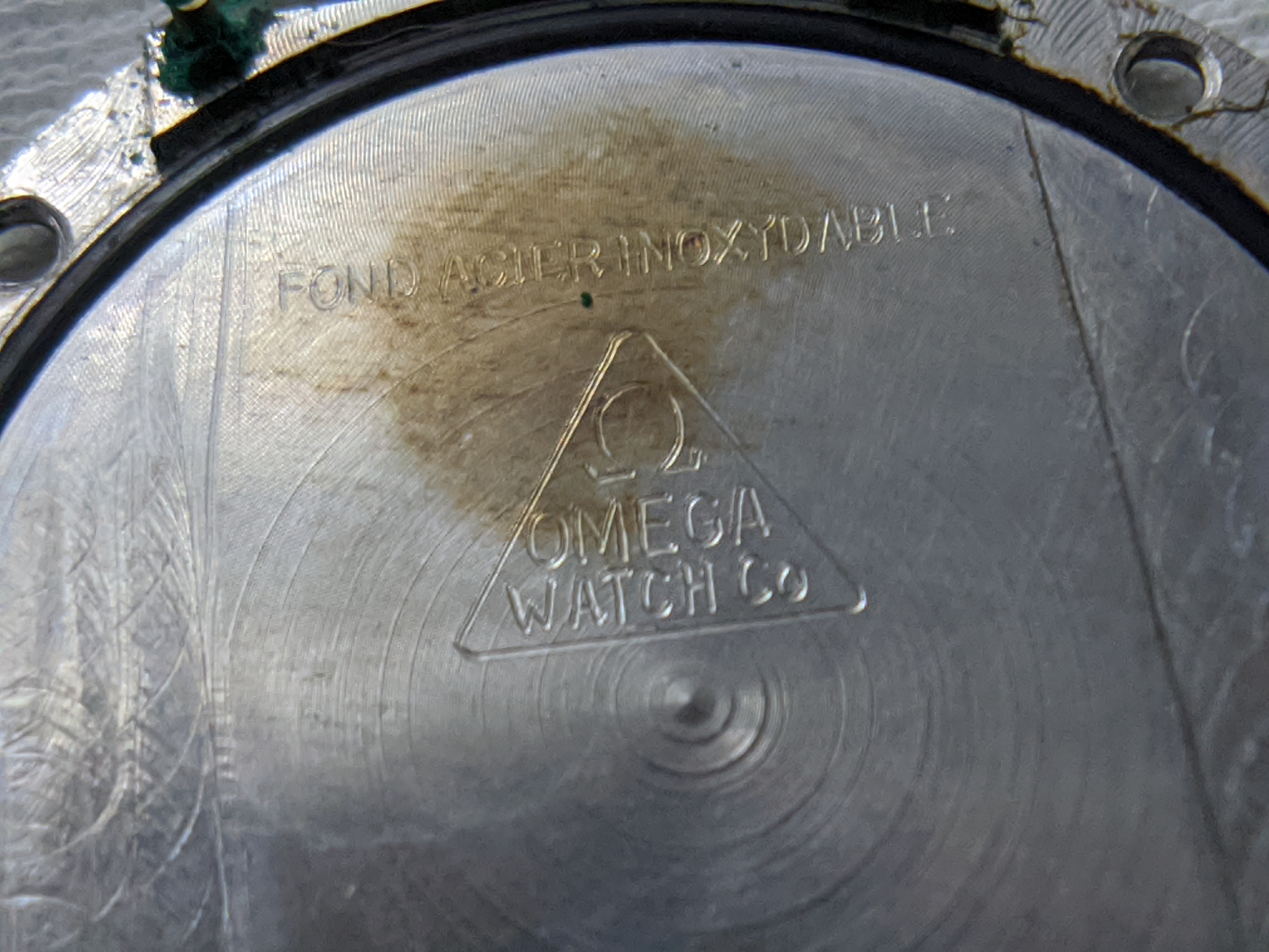

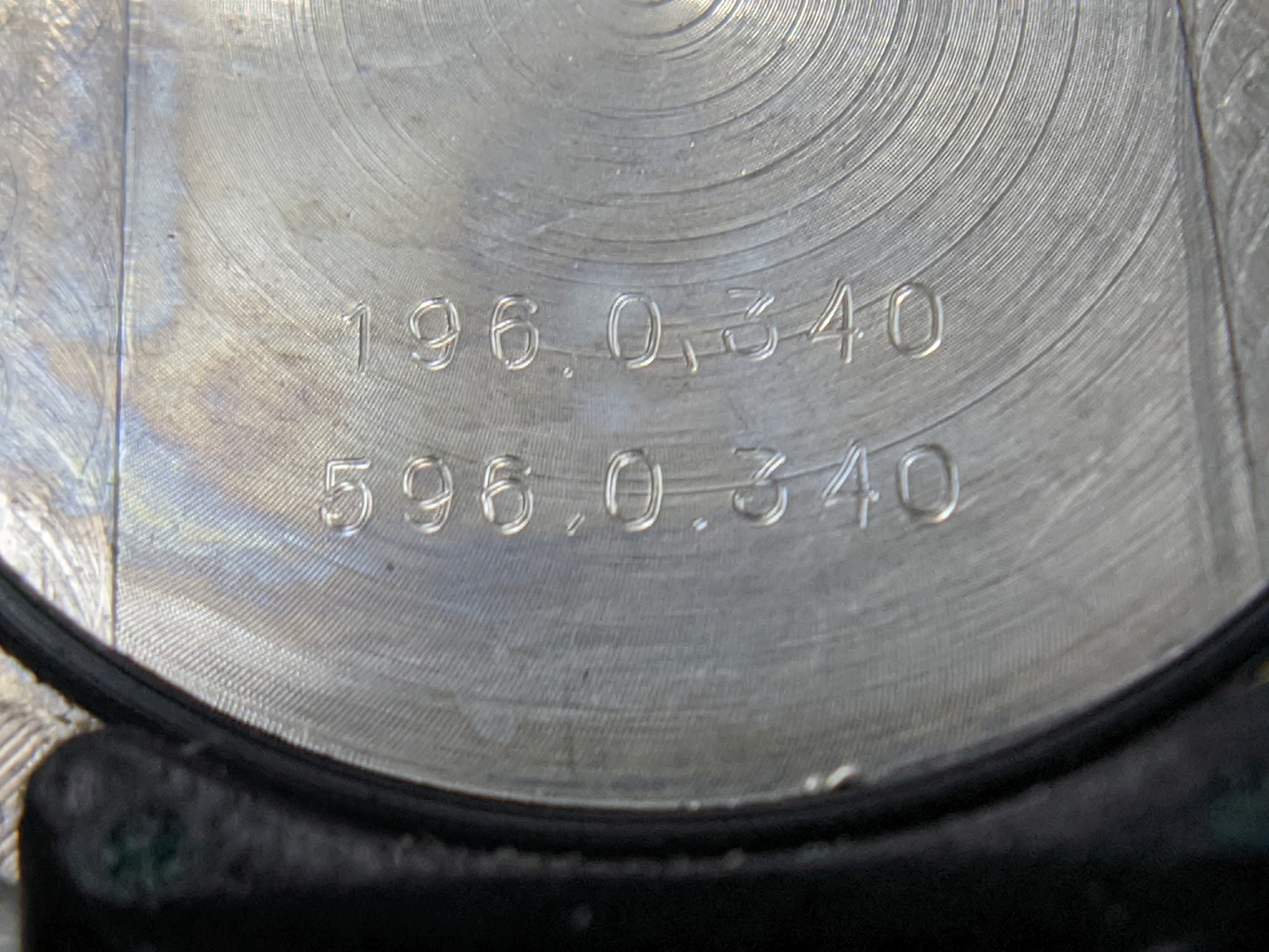

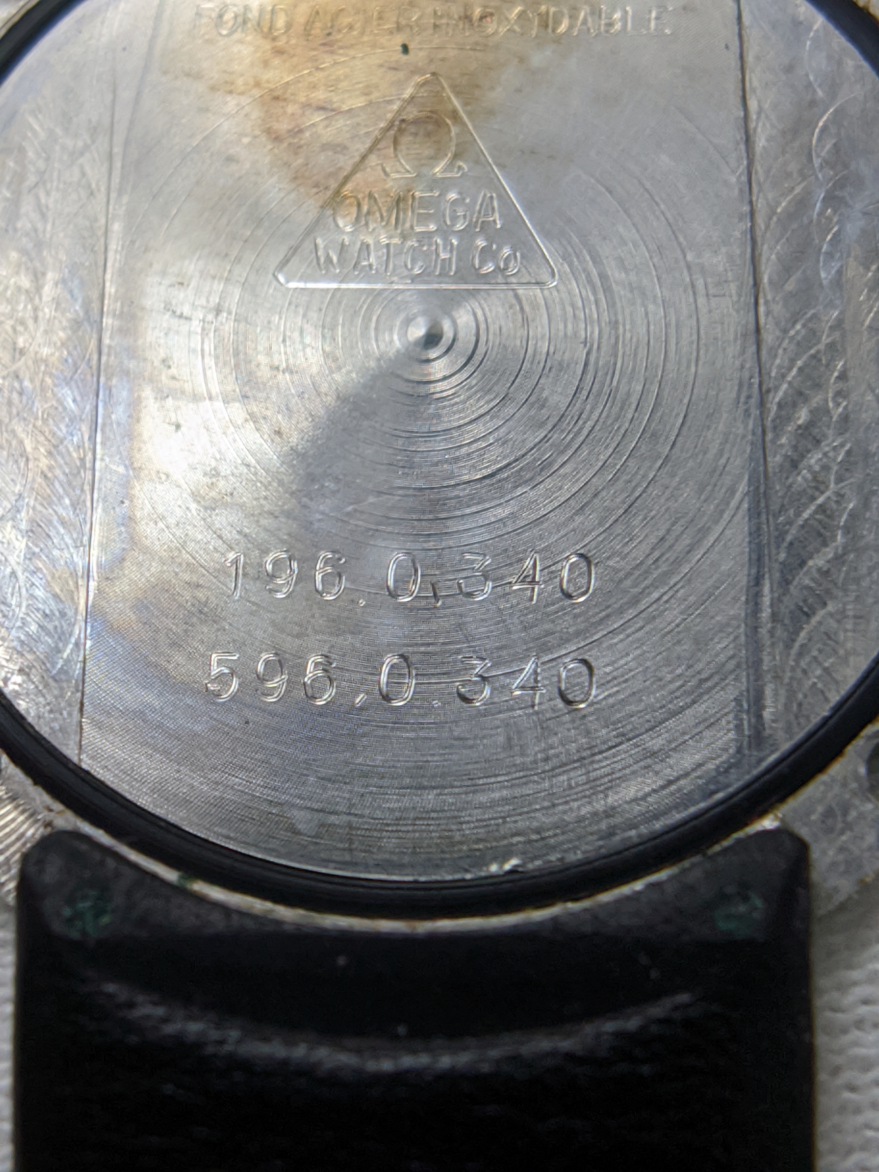

As previously mentioned, the art pattern of the caseback seems inverted. Also, on the inside there is an Omega engraving (I know the fake thread mentioned it'd NEVER be on the outside) and the following reference numbers: 196.0.340 and 596.0.340. However, on the Omega site, I see no evidence of such numbers.
Attached are pics I took of the piece.

Few things - first there's not a lot of information on the Omega Extranet (where people like me look up parts) for this series. But looking at the case numbers 1960342 and 5960342, both call out a dial that has a date window at 6, and I don't see a date on your watch in the photos above, so for me that is an immediate red flag.
Second, typically Omega quartz movements would have the Omega name and caliber designation somewhere on the movement. If not on the base plate, it would be on the coil cover, or sometimes on the circuit, and here is an example of a Cal. 1438 so you can see what I'm referring to - in this case it's printed on the circuit:
The circuit is also black, rather than blue, and I don't recall seeing a blue circuit on an Omega quartz movement before, so the movement is another red flag. In addition to help confirm this is not a correct movement, in the chart you posted above, where it shows the watches without date, the movements do not use a date, and here we have what appears to be a no date version of the watch, using a movement with a date - Omega doesn't do this generally.
So for me, this is at best a put together watch from what I see.

As I mentioned in my original post, I acknowledge my movement is not an authentic/Omega movement - it's definitely an ETA 255.441. I did find it weird it had the date complication but no window on the dial., but since it's not original, nothing surprises me at that point.
So the caseback engravings check out then, in terms of legitimacy? The watch looks to be a frankenstein?
Do you happen to have any leads/insight on the Talman artwork on the caseback? That's the only/biggest red flag to me. I can't find any pictures of another one other than posted above. The inverted color pattern is driving me nuts!
It's a legit case number, but clearly not the right dial for the case. I don't have any other information on this one...
