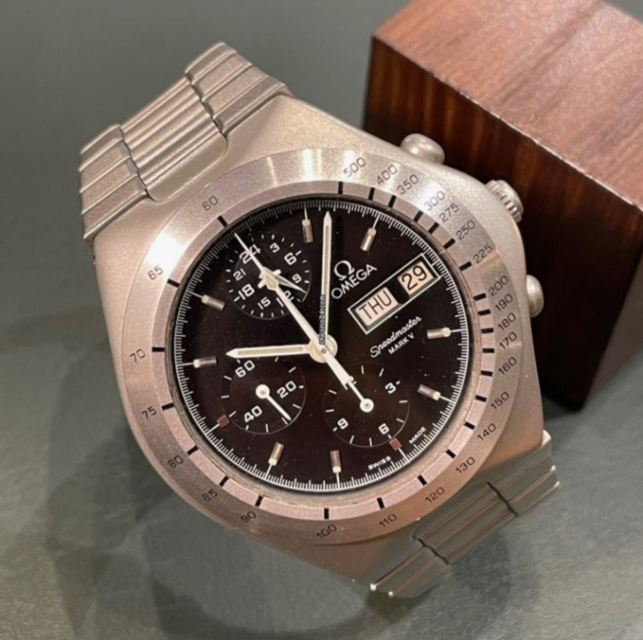

Looking into a watch for sale online currently, it's a 1984 Mark V Speedmaster teutonic (376.0806, presumably), looks really nice, but the seller says the case and bracelet are titanium. Were these watches ever offered like that? I know the moonphase models were, but the Mark V? I don't see any TI or Titane markings on the case. How would I verify if the case/bracelet is titanium or steel, have the seller weigh it? What would it weigh if titanium?

Referent to this particular model was offered in different materials including titanium.
The reference is correct and is a fantastic Teutonic Mk v.
Others models with calibre 861 are not a MK V and are a Teutonic variation.
Case with differents cases measures ( millimetres), brazalet and calibre 1045 is ok.
Problem: the price!

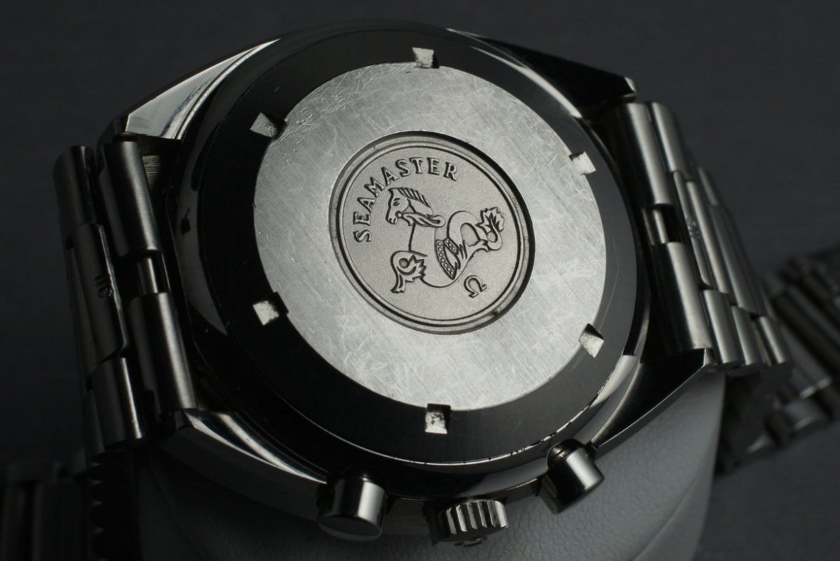

Am I the only one concerned by the fact that the caseback says Seamaster, not Speedmaster? Seems like a red flag.

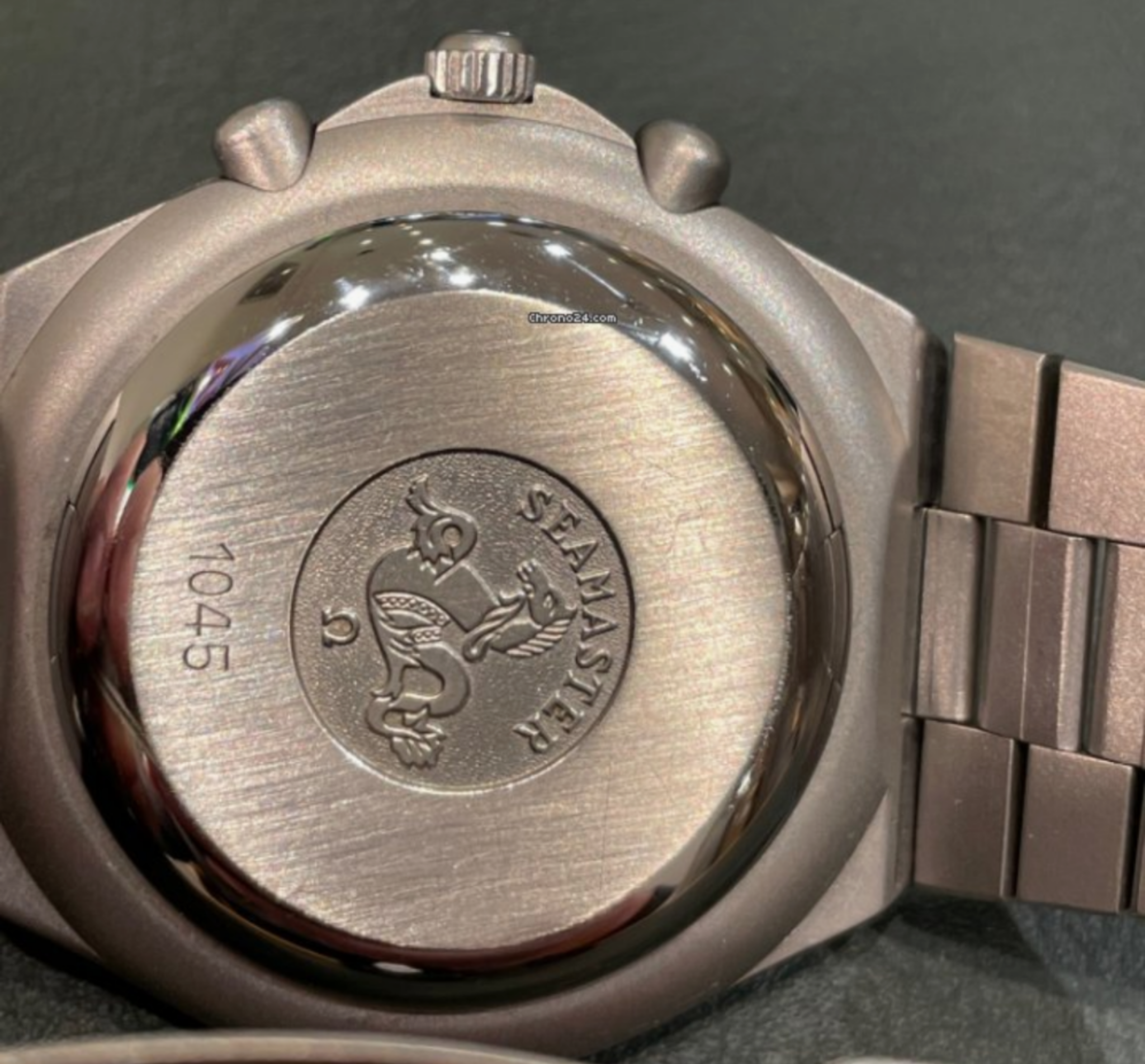

Is ok .
The case back says seamaster and in the case of this MKv says 1045 and the variations 861.
All is correct.

Is difficult to know if is blasted steel or titanium only by photographs, check the brazalet reference and case back marks.
The cases are diferentes in dimensions between 861 and 1045 movements and the original Mark V is with calibre 1045 and dial marked with Mark V.

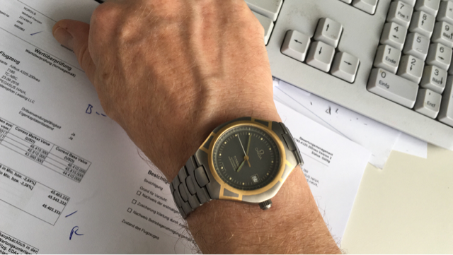

Wouldn't go too far confirming that the Teutonic is SS sandblasted (with only the extremely rare moonphase LE being titan). Weightwise the Teutonic is much heavier than my TI Grade 2 Polaris from same decade.

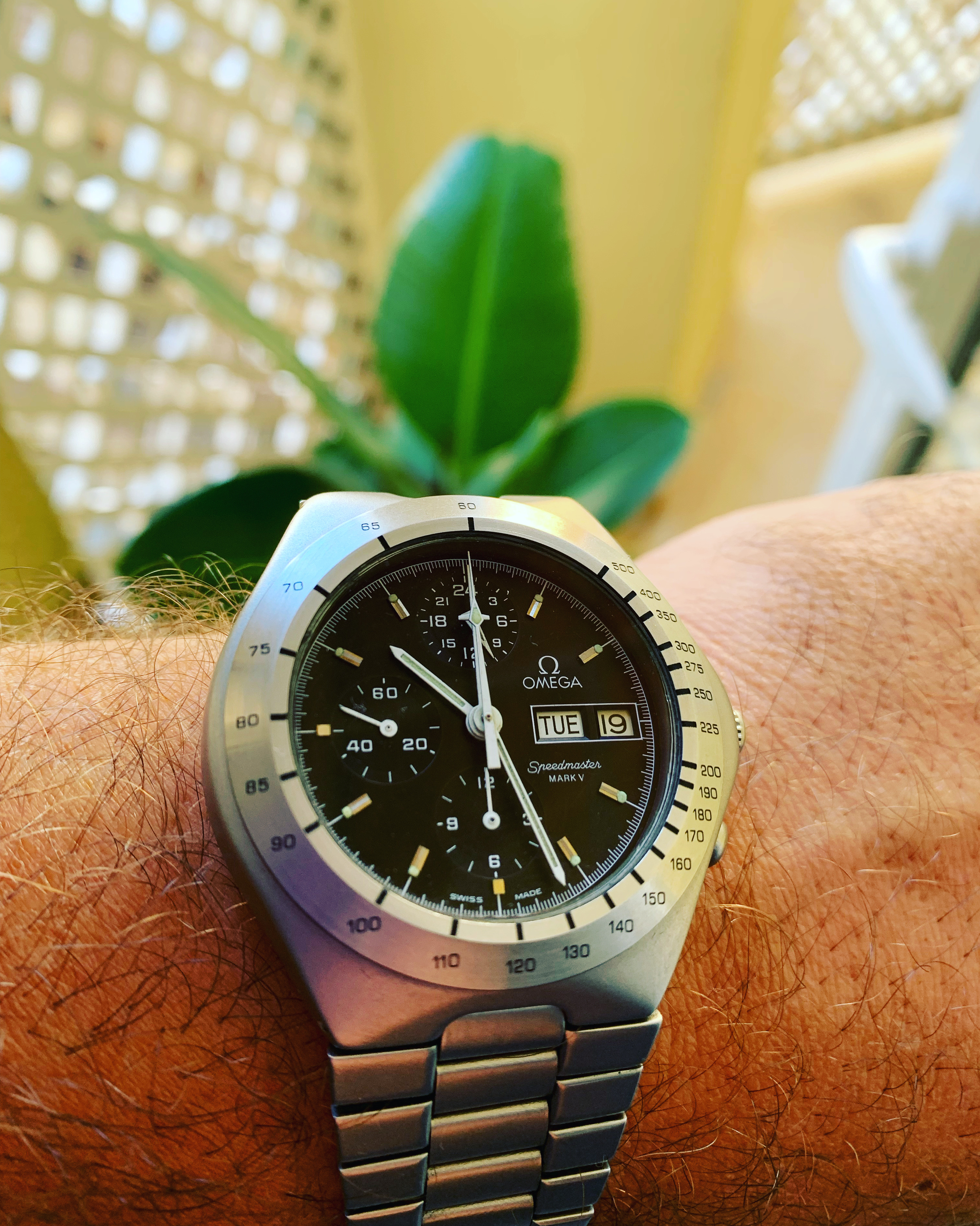

Good morning, after checking my Mk V I can confirm that the construction material is SS.
Not titanium !.
Looks like Titanium but is sand showers SS .
Speedmasters are in the Seamaster family.
Back of a Speedmaster Automatic Mark 4.5
