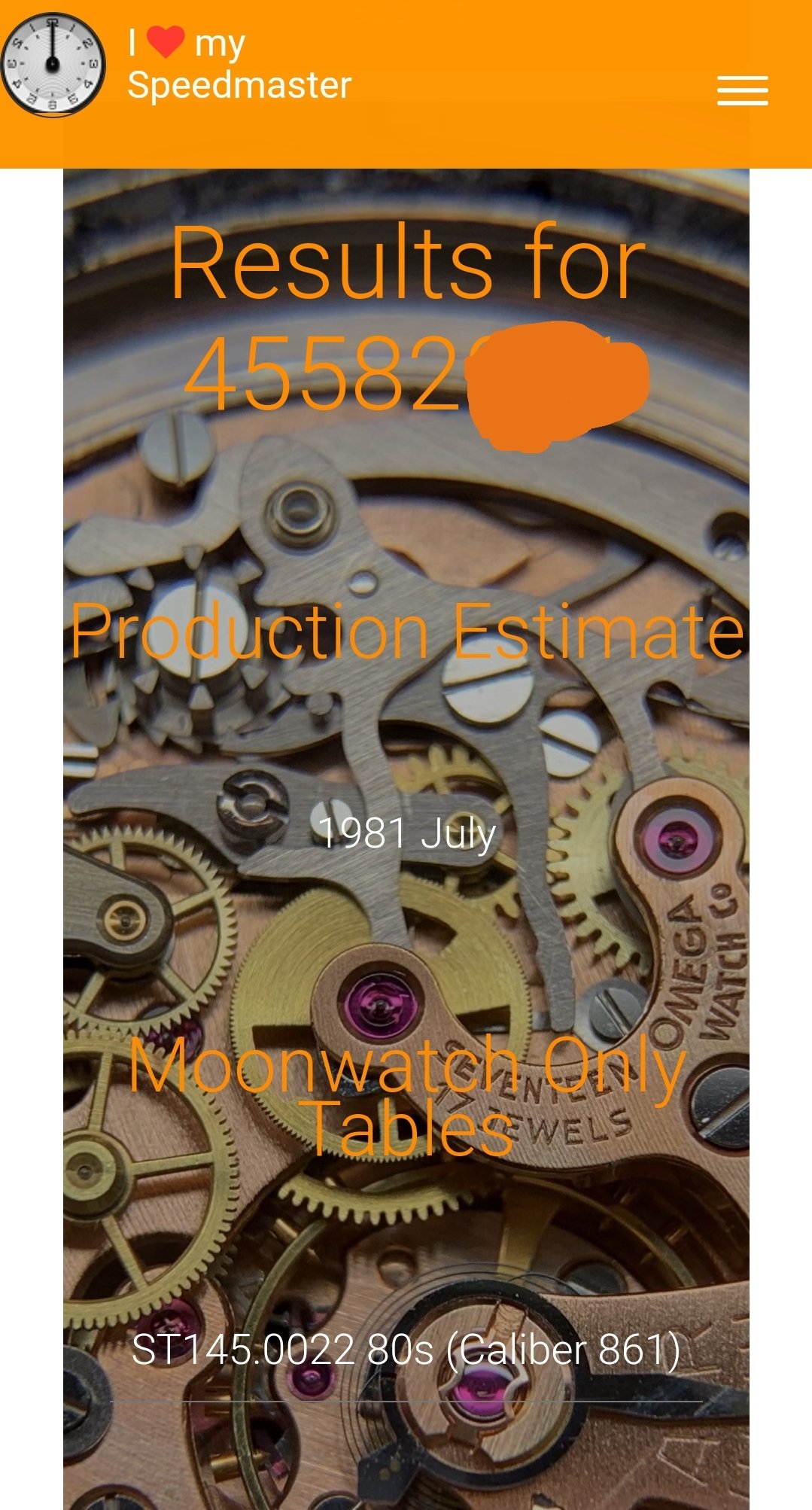

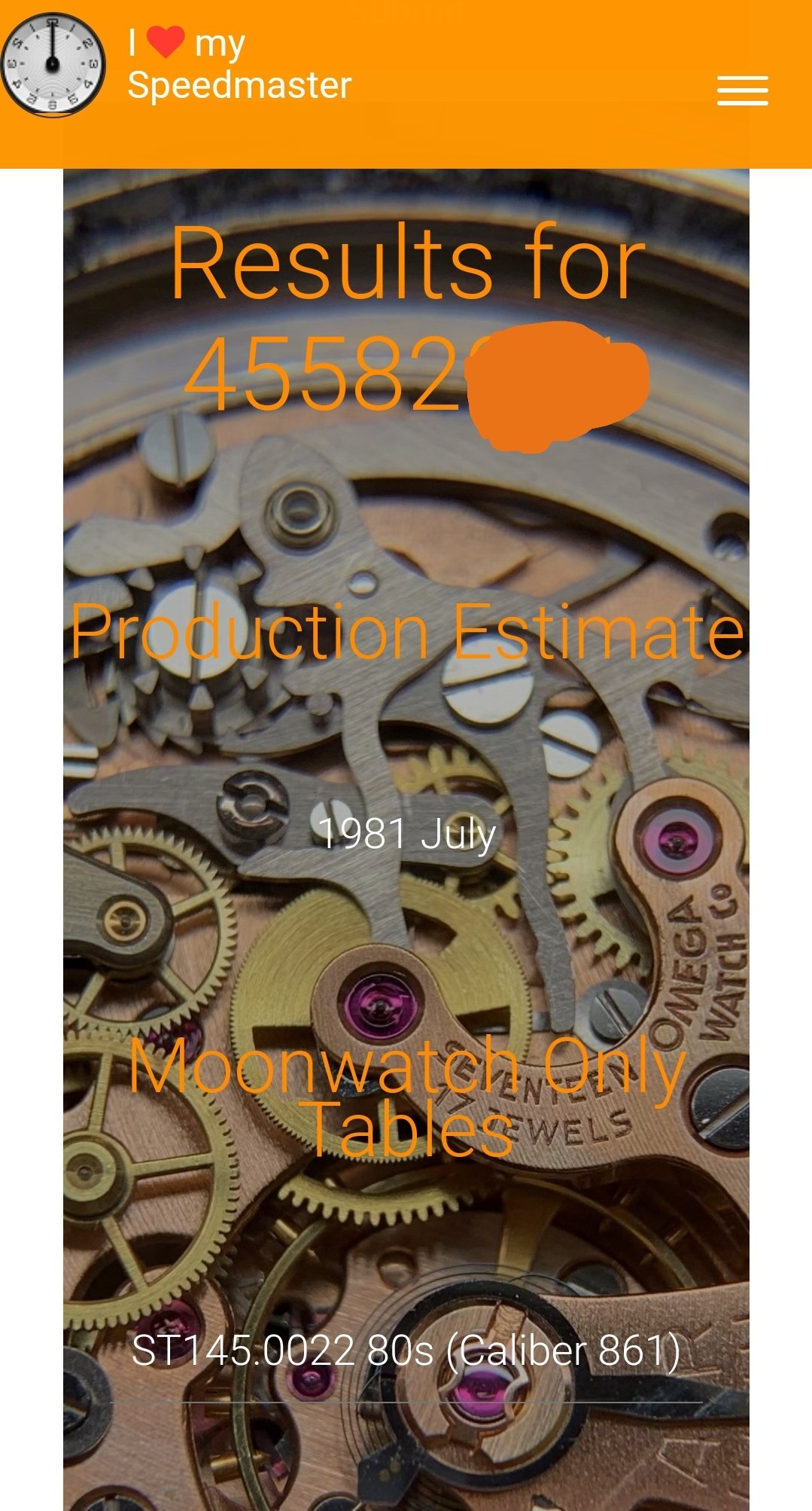

And of course use https://www.ilovemyspeedmaster.com/productiondateprediction/ to check serial numbers 😉

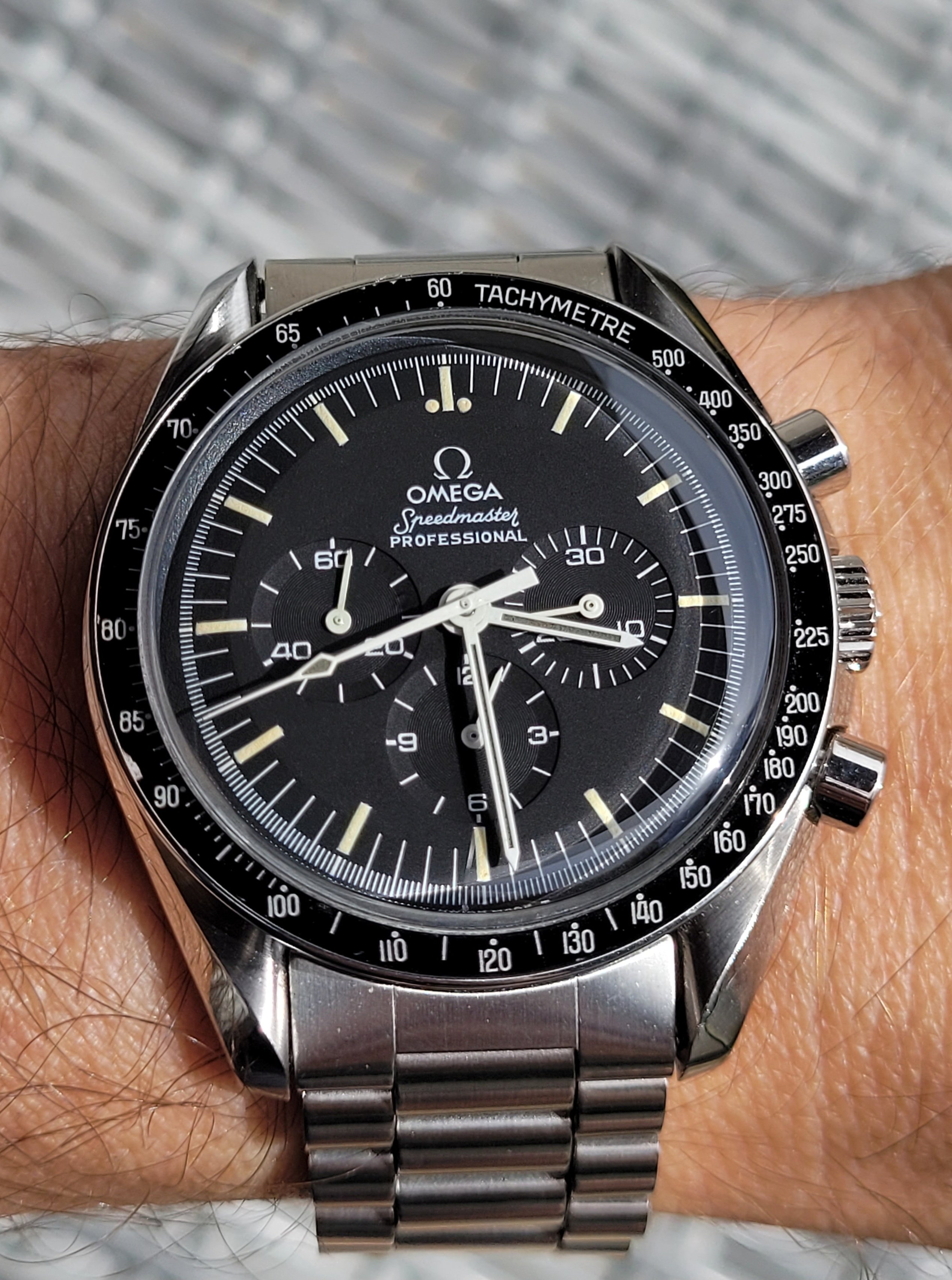

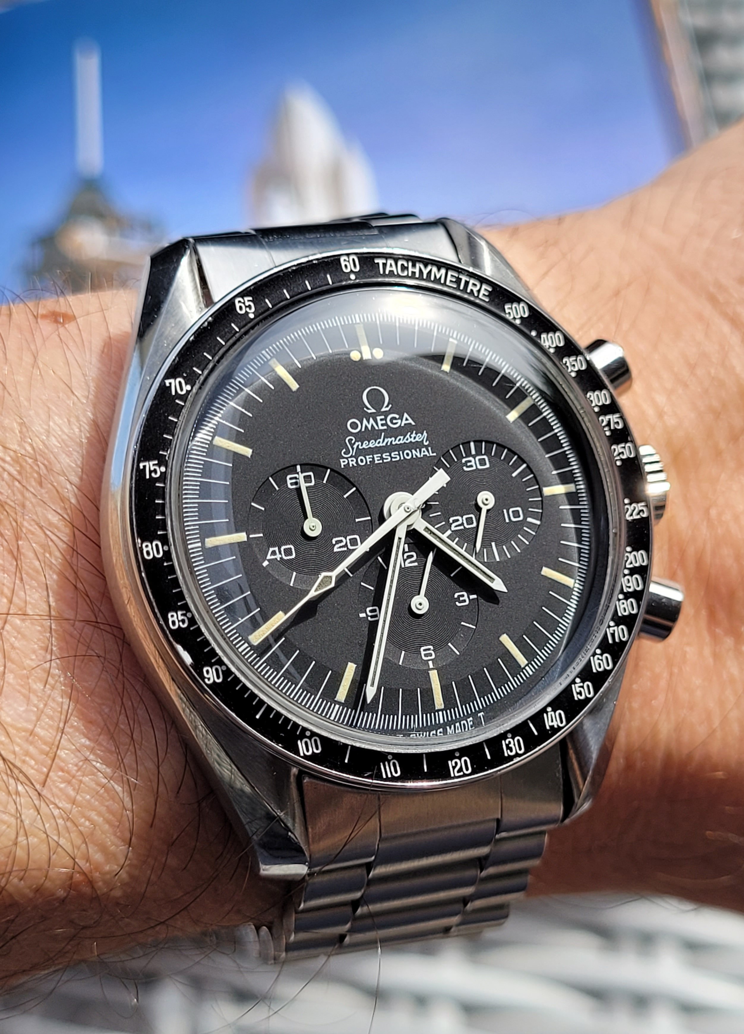

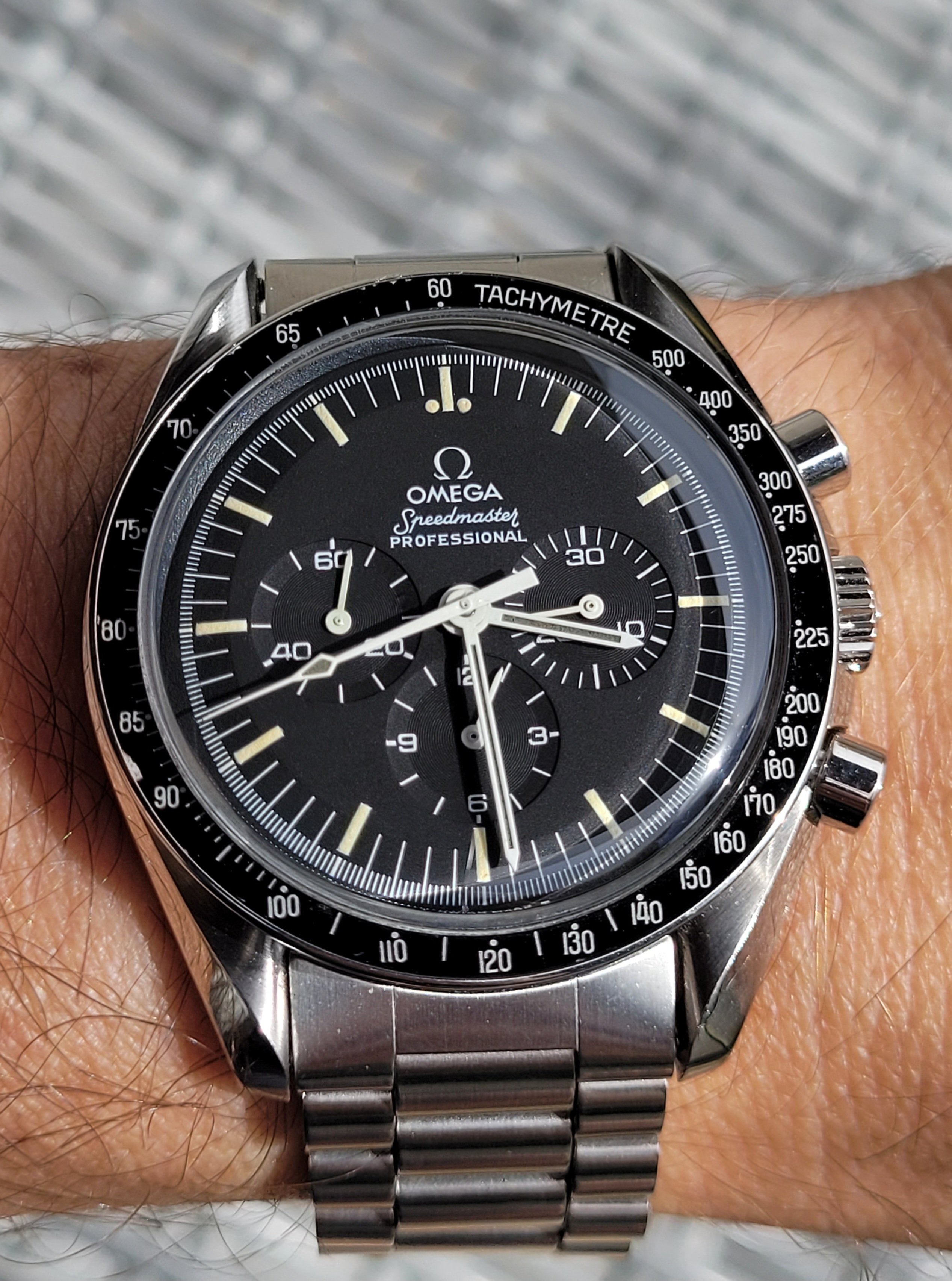

My '81 Speedmaster:

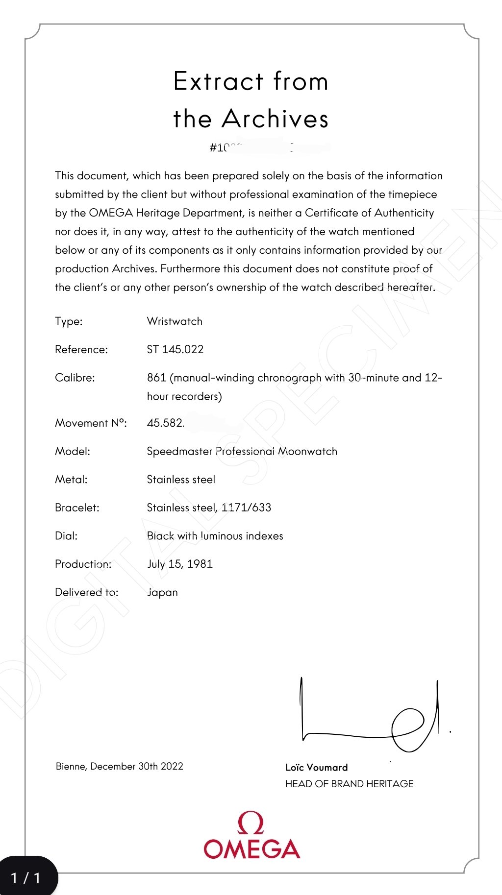

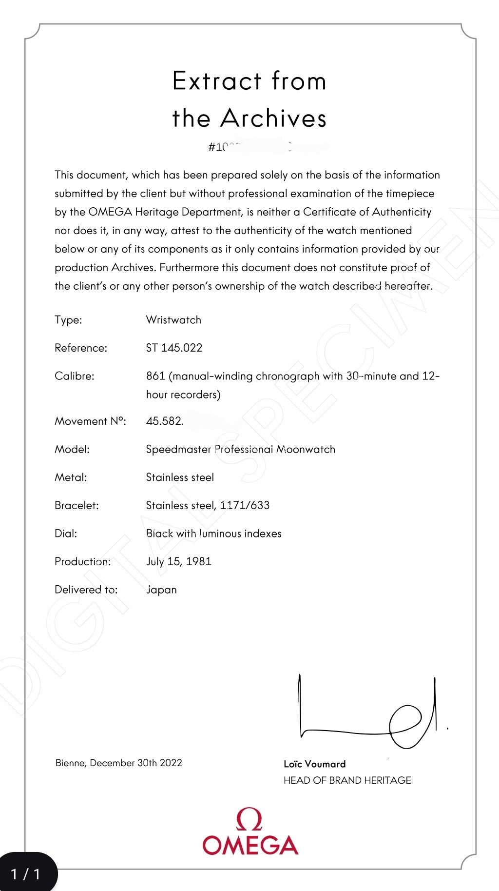

Did you receive an extract to confirm that date? I only ask because if I recall correctly, Eugene has said his site is more of a best guess prediction for 80’s references. I believe he said his prediction is more reliable for the more popular vintage references as he’s received an abundance of extracts. Whereas, he’s received extracts for 80’s references but nowhere near the amount that he’s received for the earlier references. For example, his site predicted my Speedy was from 85, which was close but the extract dated it to 84. Not a big deal as his site was close and I wasn’t after a birth year watch.
OP- finding a ‘81 birth year Speedy can be a long process. To really zero in on that year, you’ll need an extract, which is something Omega no longer issues for the foreseeable future.
24,836
55,255
And I'm guessing relatively few people request an extract for 1980s watches, since they're not terribly collectible.
2,707
48,918
Yes, in my case the prediction was pretty much perfect and maybe more safe because we are talking about mid of '81.
10,804
16,814
As the posts above hint at, your big problem will be in confirming 1981. You need to decide how you are going to date it, by ILMS, by extract (not currently available or by papers (if present). Many have bought their birth year watch only to find out later than one or other of these is a year or more out. The contributor above was lucky, indeed it may have been his extract data that ILMS is using and is only one data point after all. It is a bit of a fools errand really. I guess if you find a Speedy with a 45,581,XXX or 45,582,XXX serial you might be most of the way there but you'll only know for sure when the extract service resumes (if ever). Note when you use the ILMS birthdate (ie reverse) lookup for June 1981, you get a totally different nonsensical answer, indicating that there isn't much data to go on in that range, possibly only one or 2 extracts only.
