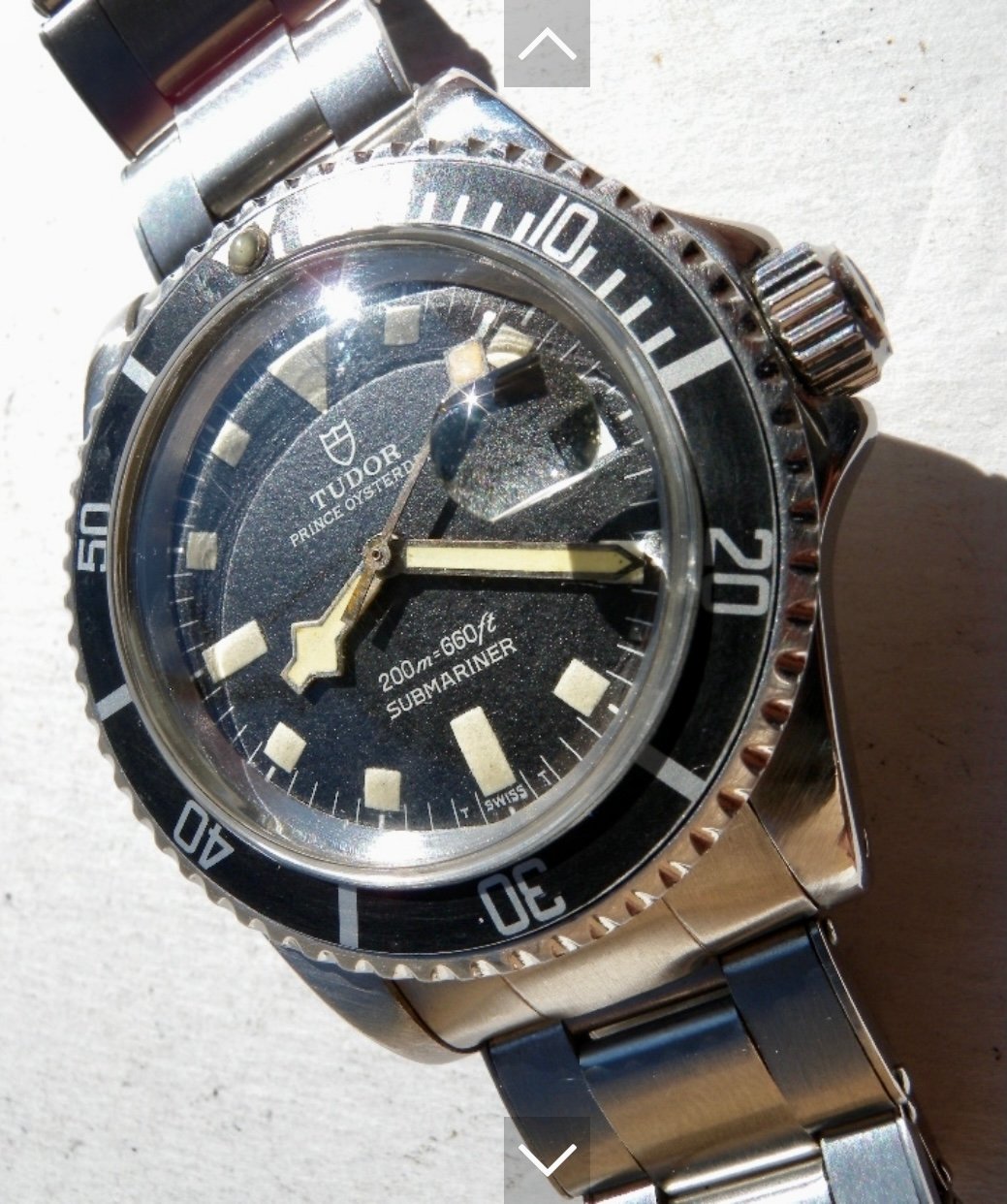

Hello,
I just won an auction for a Tudor Sub ref 9411/0. I have not received the item yet but I reviewed the details quite closely but then after winning the auction I noticed some details I missed.
Specifically, the 2 in 200 = 660ft is positioned above the S in Submariner. The t in ft is positioned in between the E and R in Submariner. Also the T's in T SWISS T under the 6 are positioned away from SWISS on both sides. In addition the O in Tudor is round. The = sign is positioned above A in Submariner which from research online indicates is correct.
When I compare these details with most of the 9411/0 references online, they are different. The 2 in 200 = 660ft is positioned above the U in Submariner and the t in ft is positioned above the E in Submariner. The O in Tudor seems to be an oval shape. The T's under the 6 seem to vary in position across the watches of that reference. Furthermore the numbers on the bezel of the watch I won seems to be different to the same in some of the same reference online. The movement checks out ok from the photos. I also did a search of the serial number and that came out ok as well.
There seems to be two to three different configurations especially with the T's below the 6, the 200 = 660ft and the O in Tudor. Does anyone know whether this is the case and can someone urgently help me to understand if what I won on auction is a fake or authentic.
Thanks in advance. I attach photos of the item I won on auction - the photos are from the listing.

Calling @Linesiders. In the meantime, please post a high quality straight-on photo in good lighting. All the photos are weird.

I am very sorry but it's not original.
Case and insert aren't original either.
203
107
Yeah that's because they (very poorly) copied another watch's serial number.
Engravings are naively fake, so are insert, dial and movement.
It would be interesting to know who was the seller.
I really hope that you are going to have your money back.

521
980
I am Japanese and can read Japanese.
It was probably a Yahoo auction item, so I checked it out and found a sold item with the same photo.
The item description on the auction page said that the dial had been redialed.
In the product description, "[リダン]" means that the dial has been redialed in Japanese.

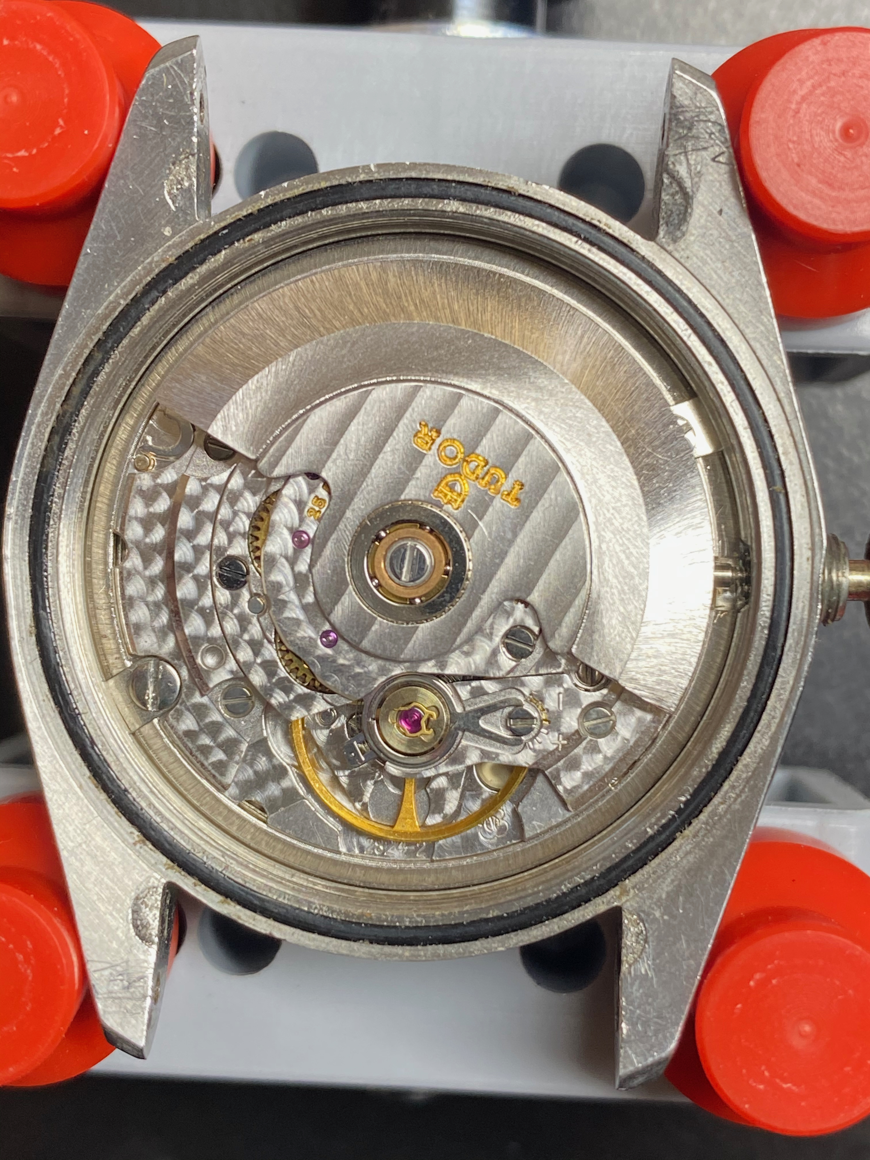

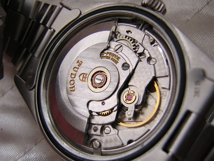

944
2,453
The movement is very obviously not a Tudor ETA. Look for a kif shock absorber or a triovis regulator. Sometimes there is an etachron regulator, but always a Kif.
10
Thanks - appreciate the photos and good to know.
10
