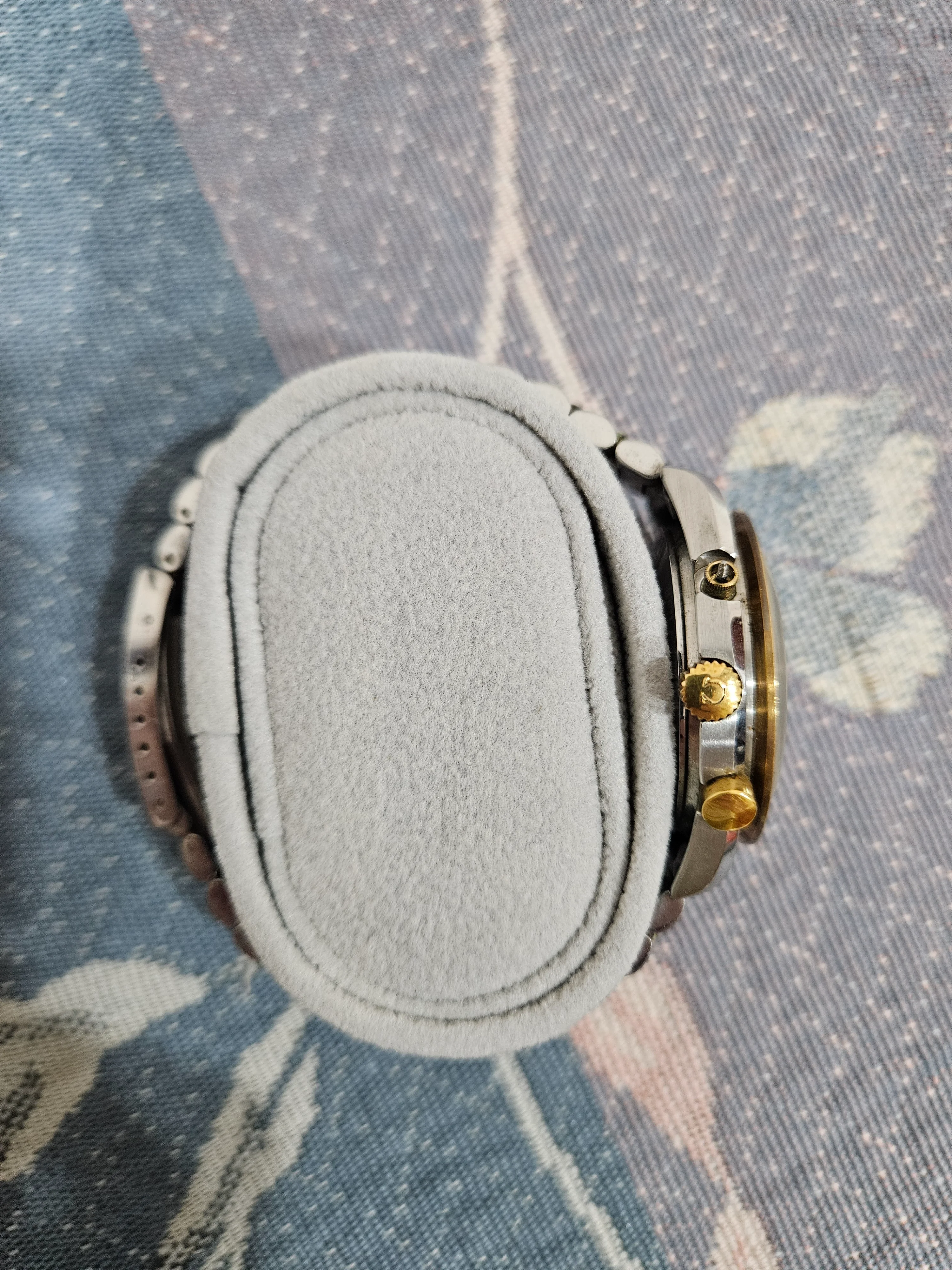

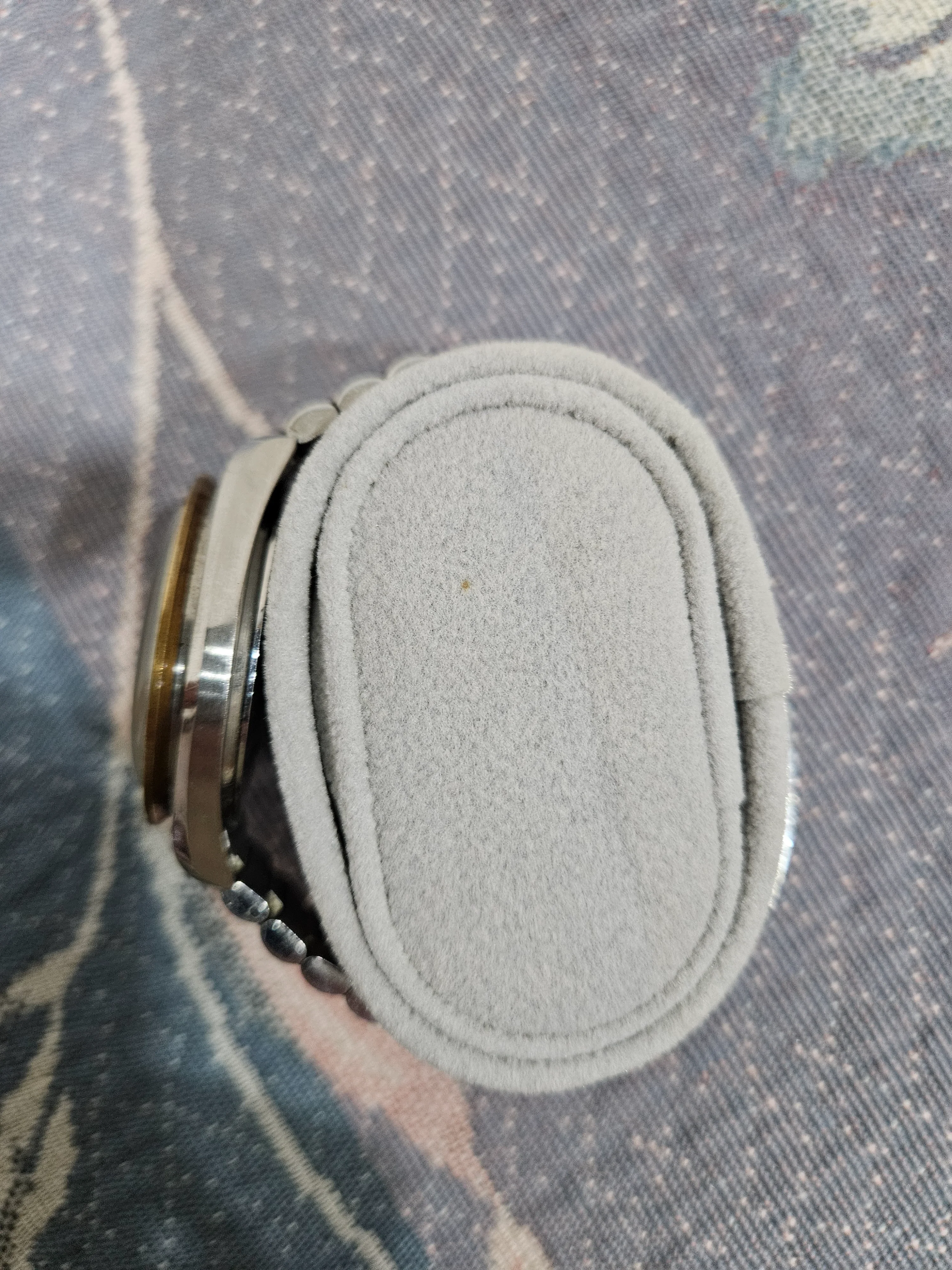

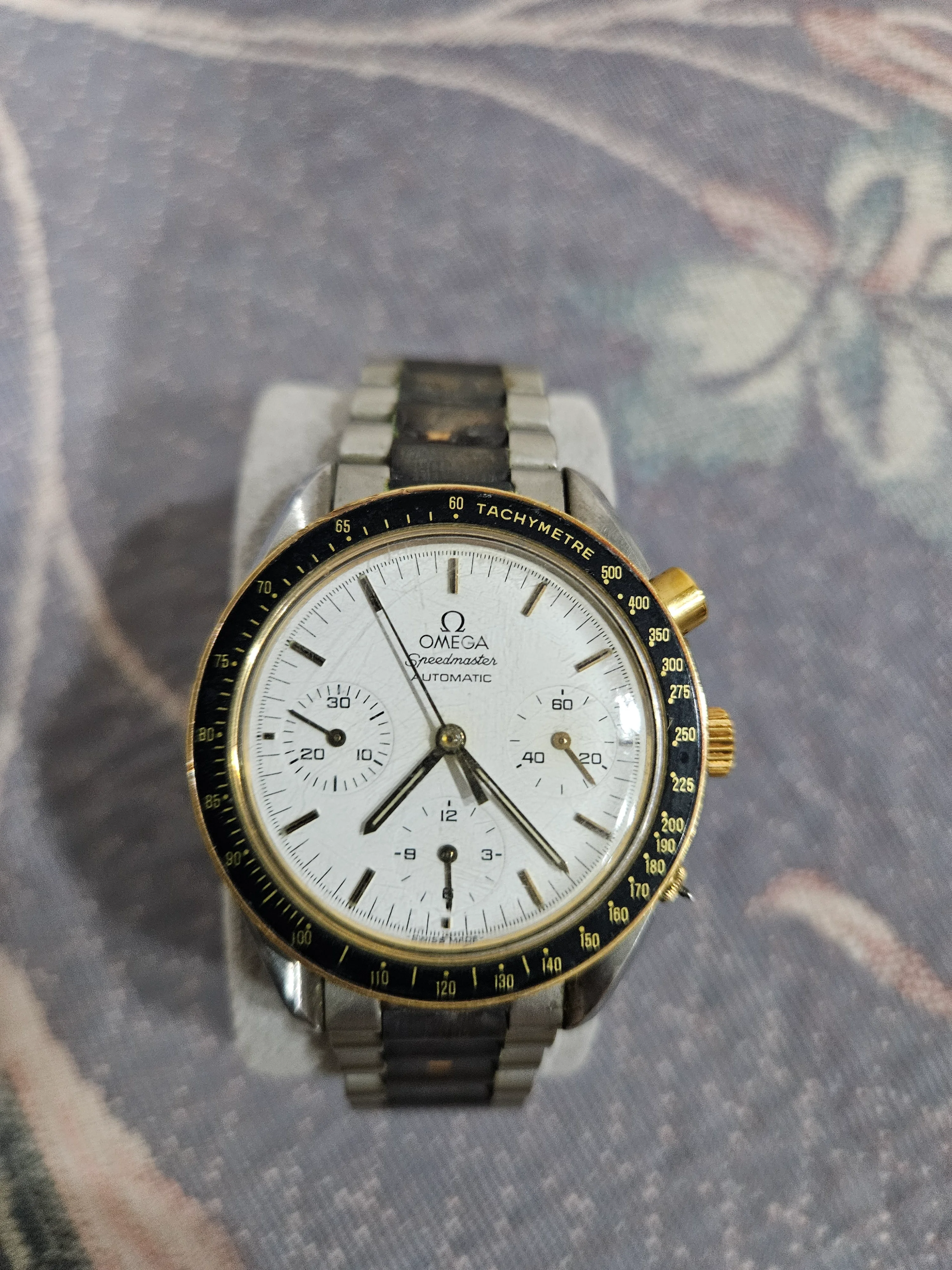

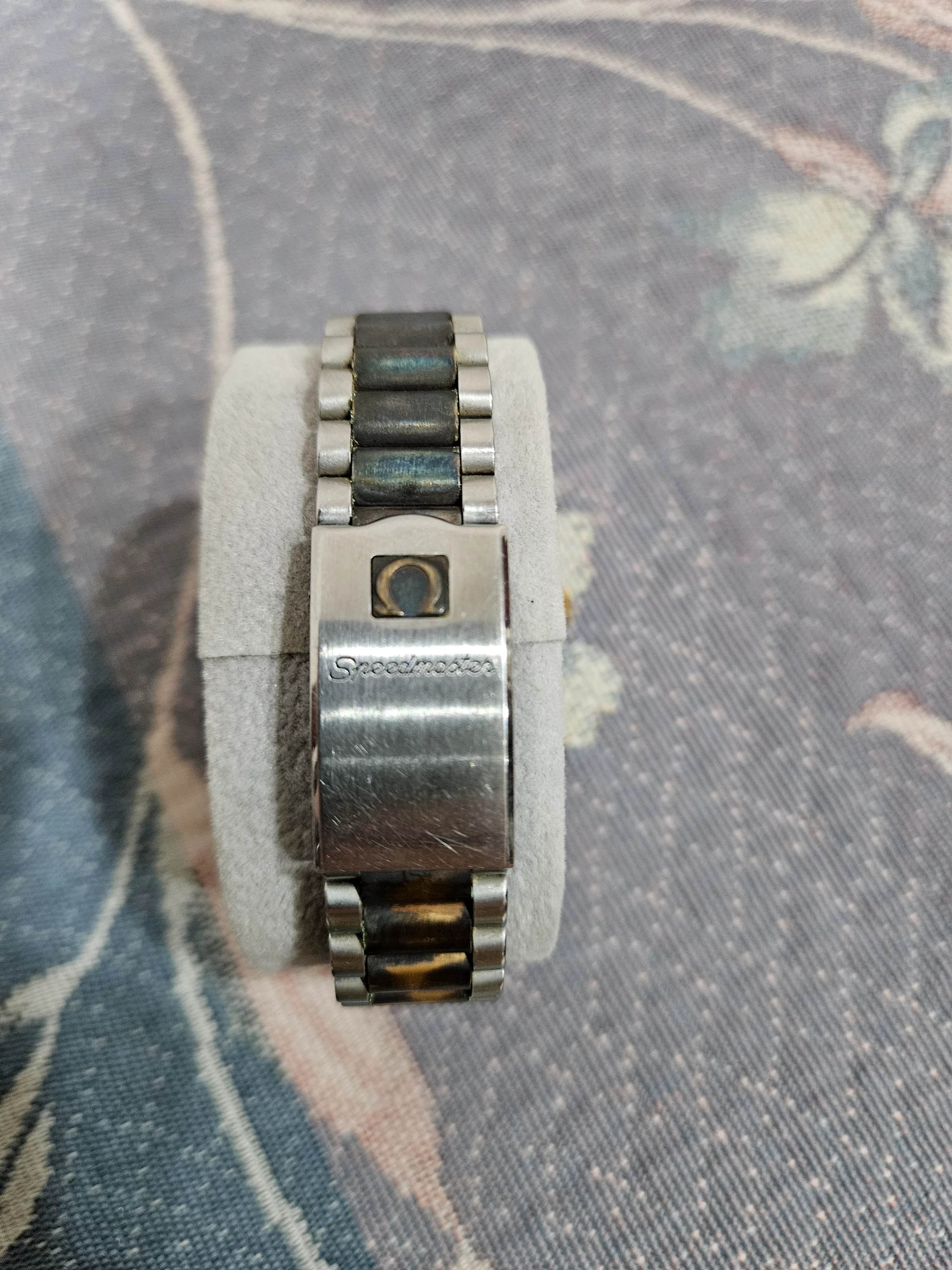

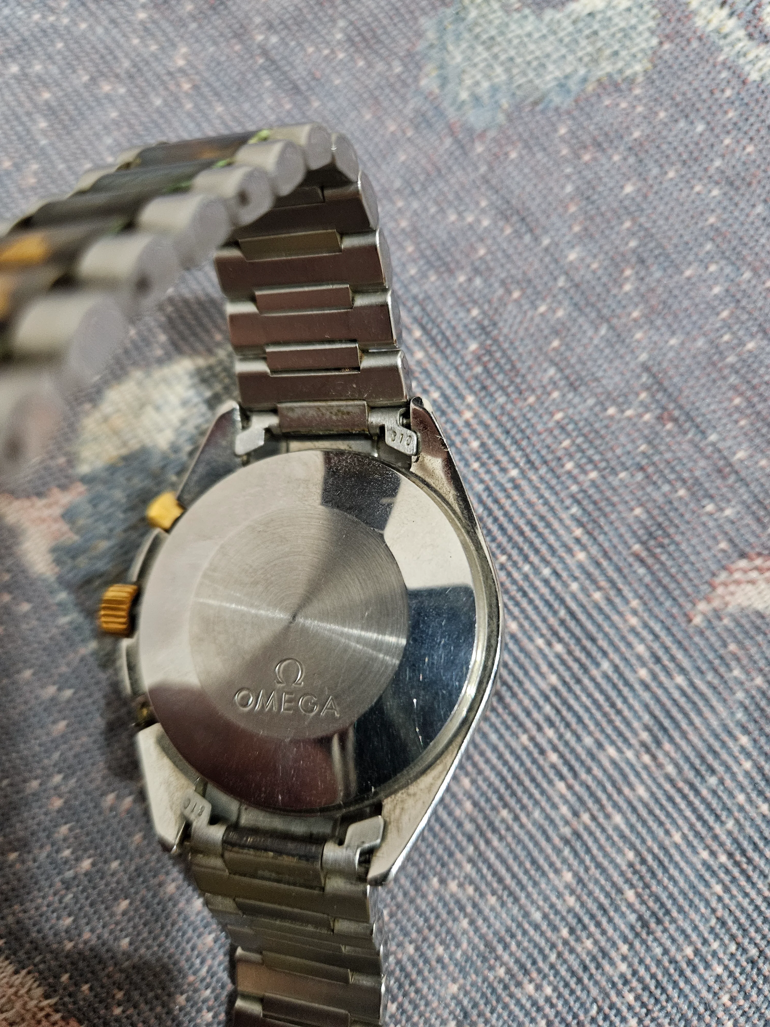

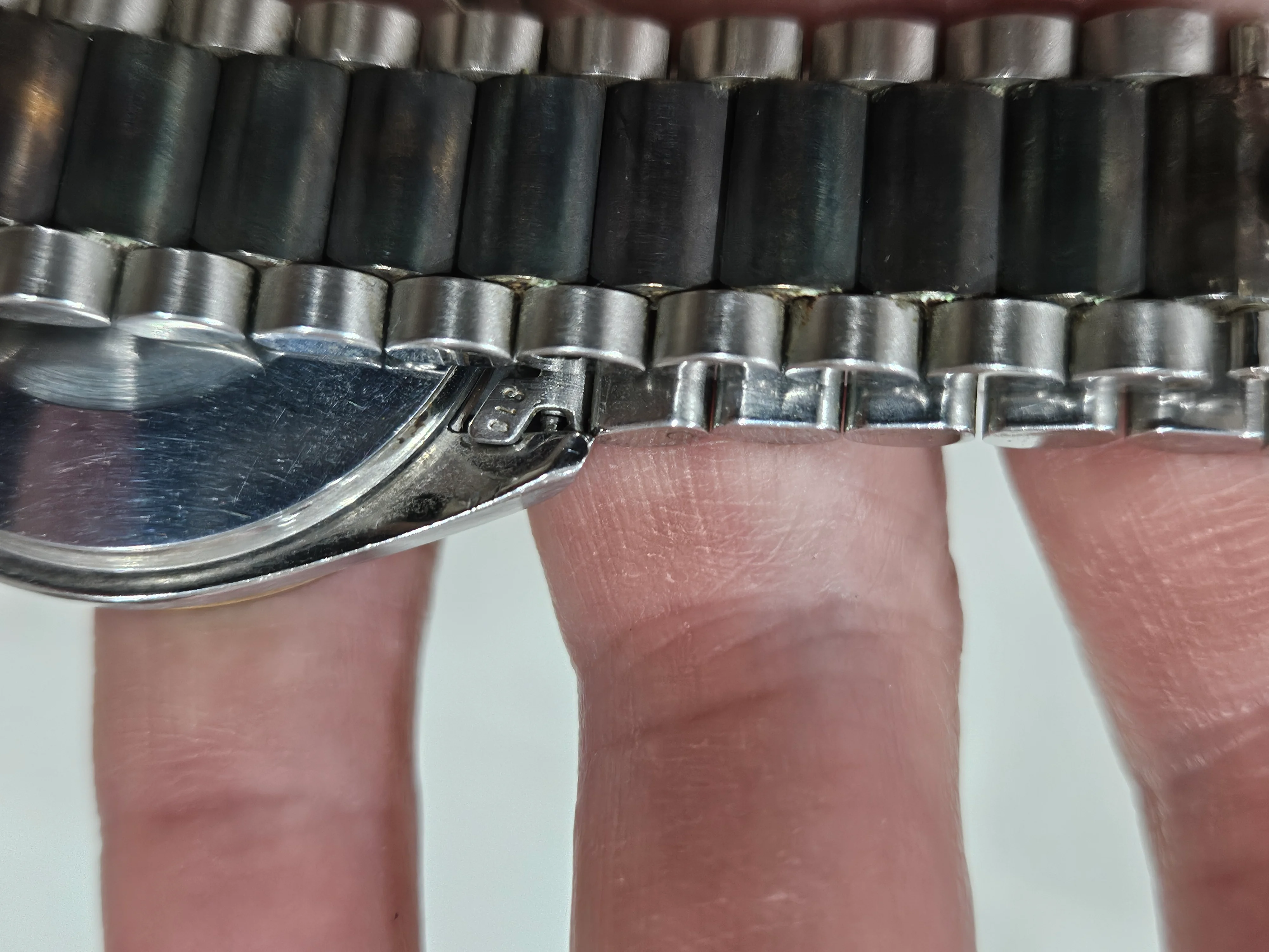

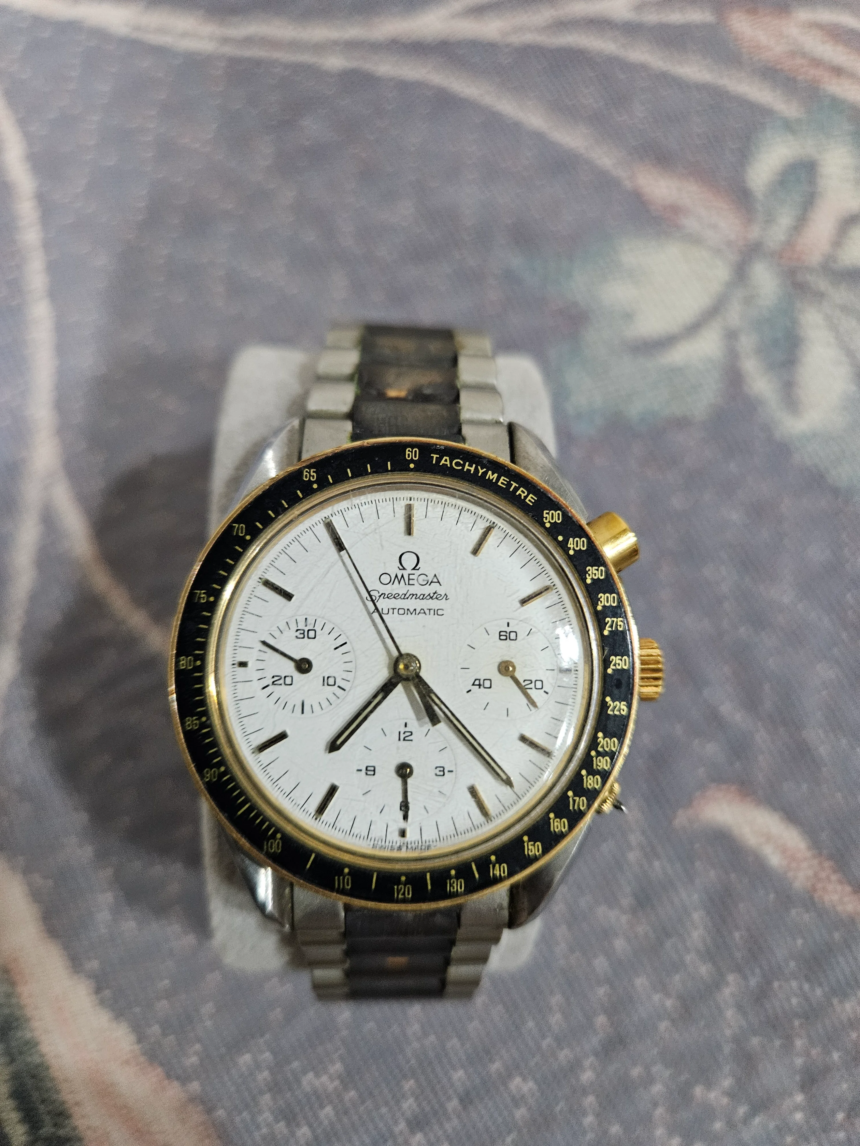

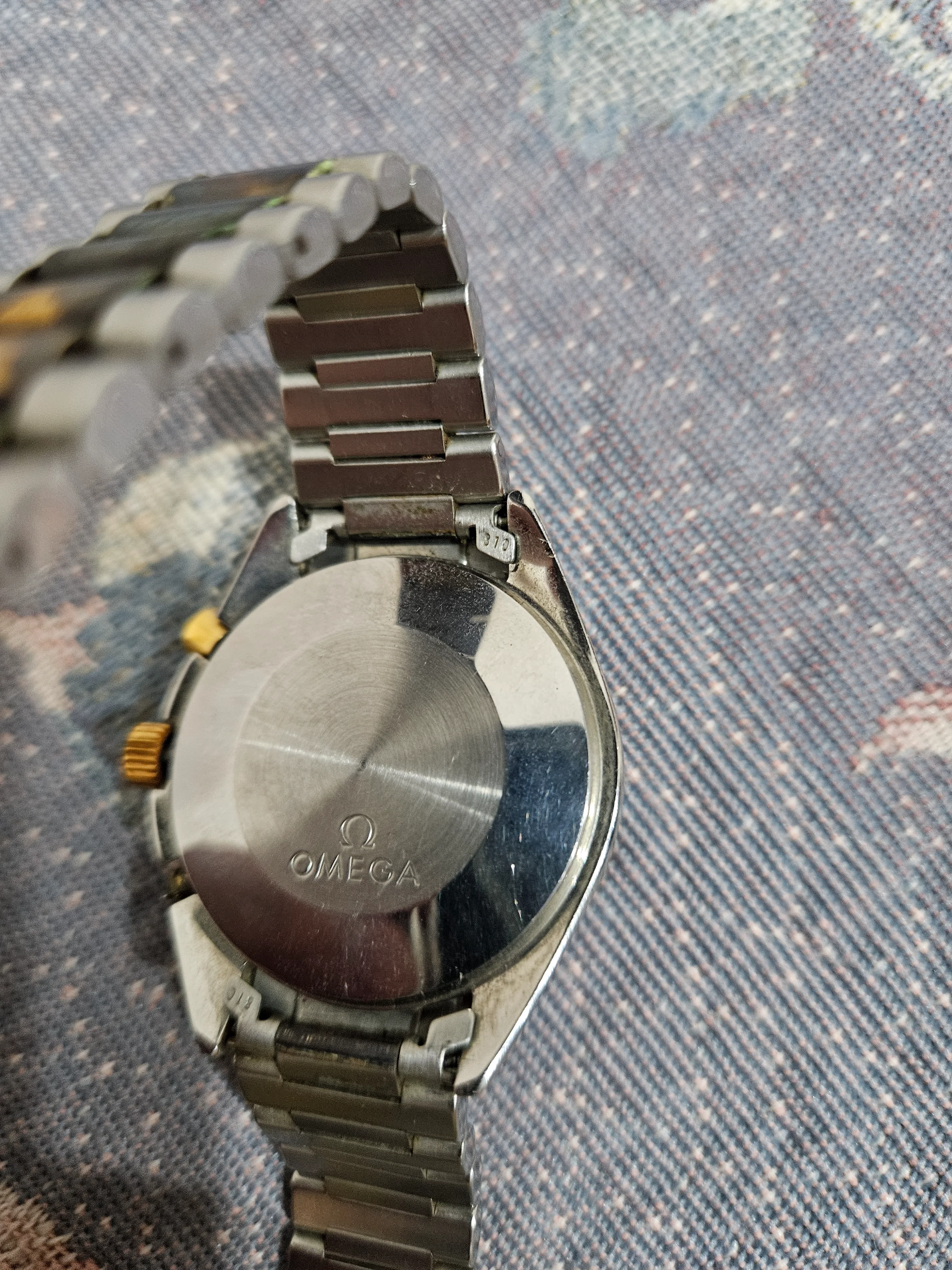

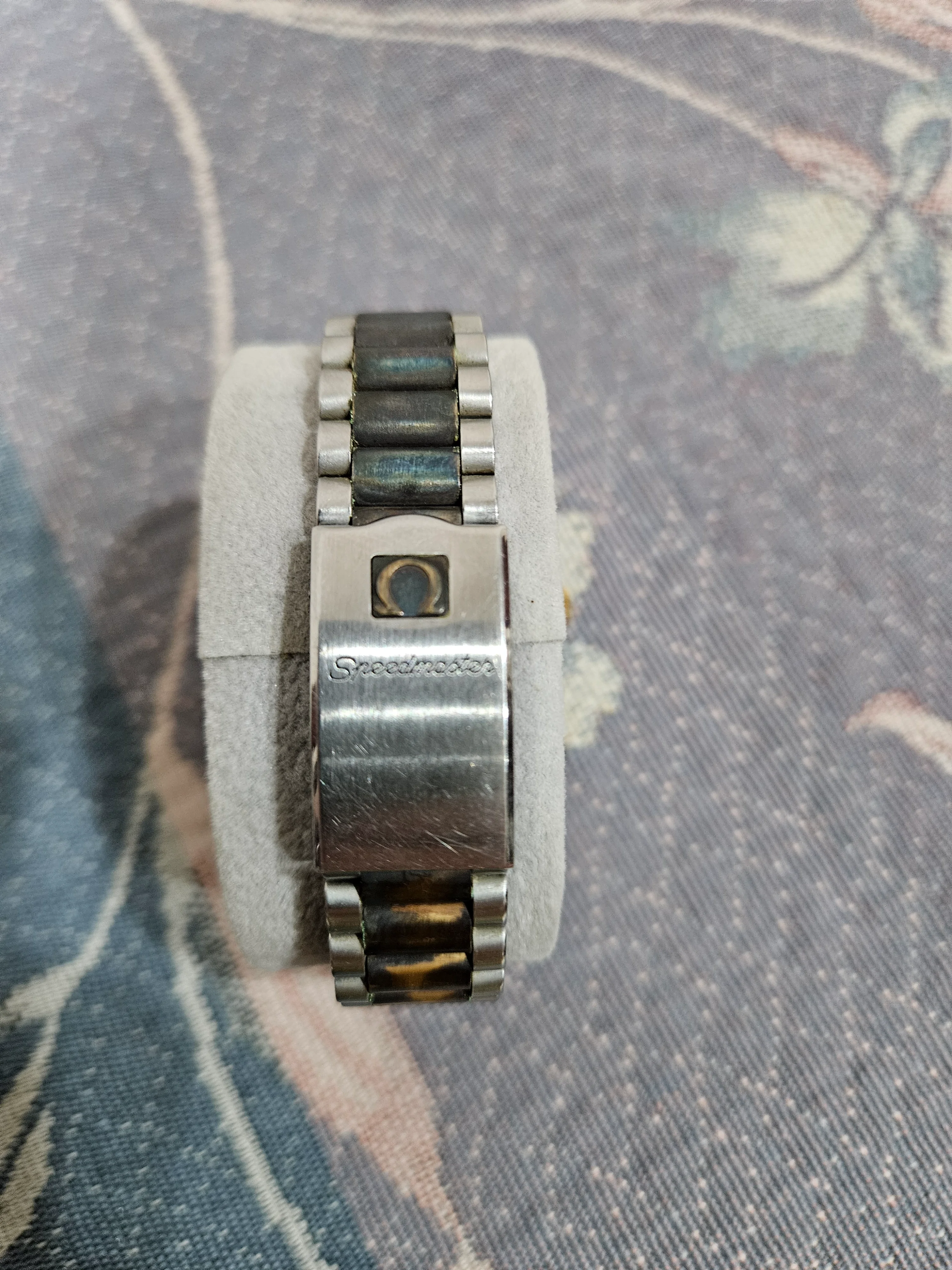

Hello everyone. I recently inherited a watch and would like to know what I have on hand. I'm entirely ignorant to watches and all advice is appreciated. Below is information I received. This information came from the original owner, a senior citizen, so may be incorrect.
  • 1969 Omega Speedmaster, purchased in 1974, likely at an Air Force base in Alaska.
  • Part of the band is 18k gold, tarnised

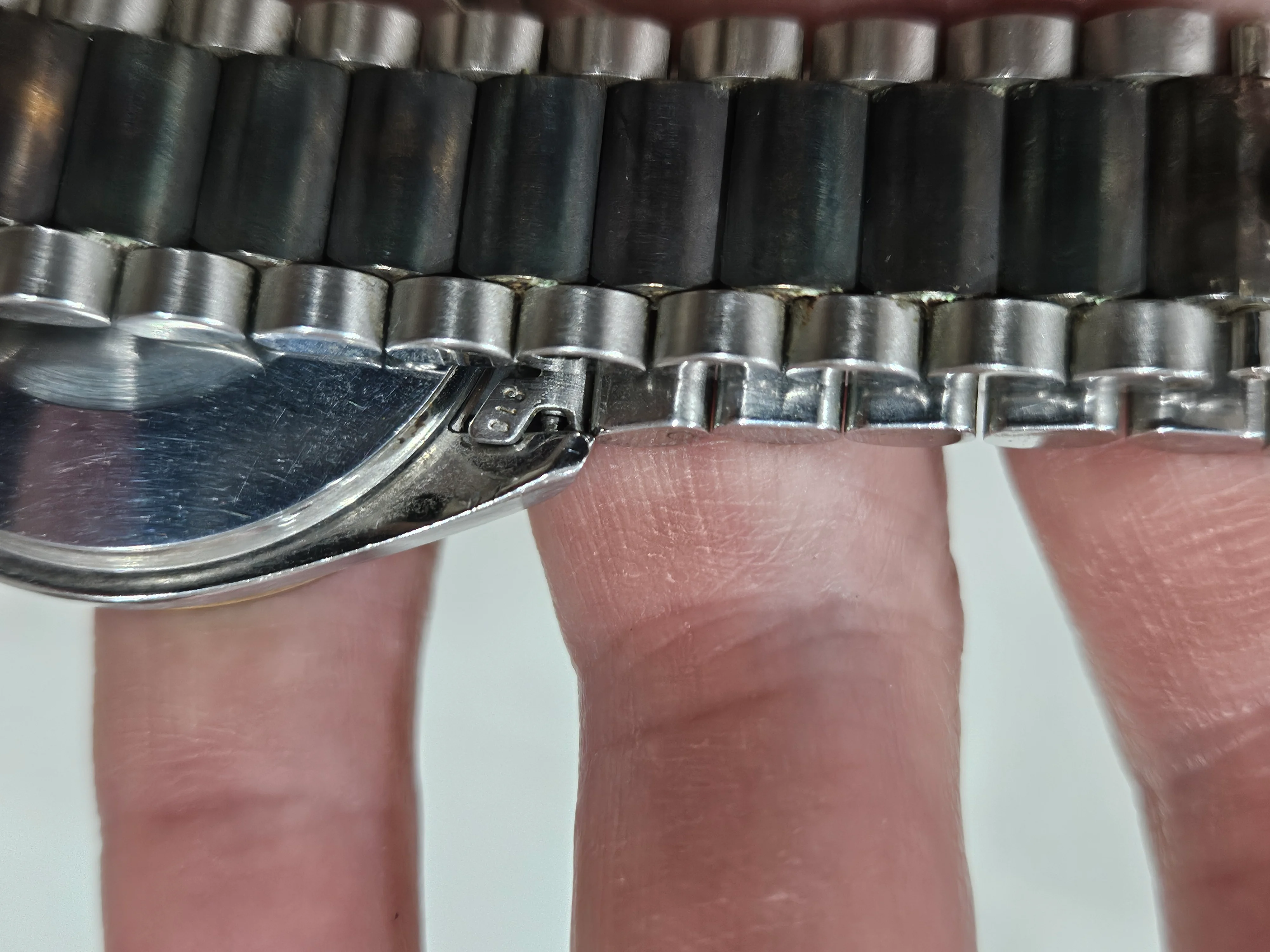

  • There is a 018 or 810 stamped on the band where it meets the watch.

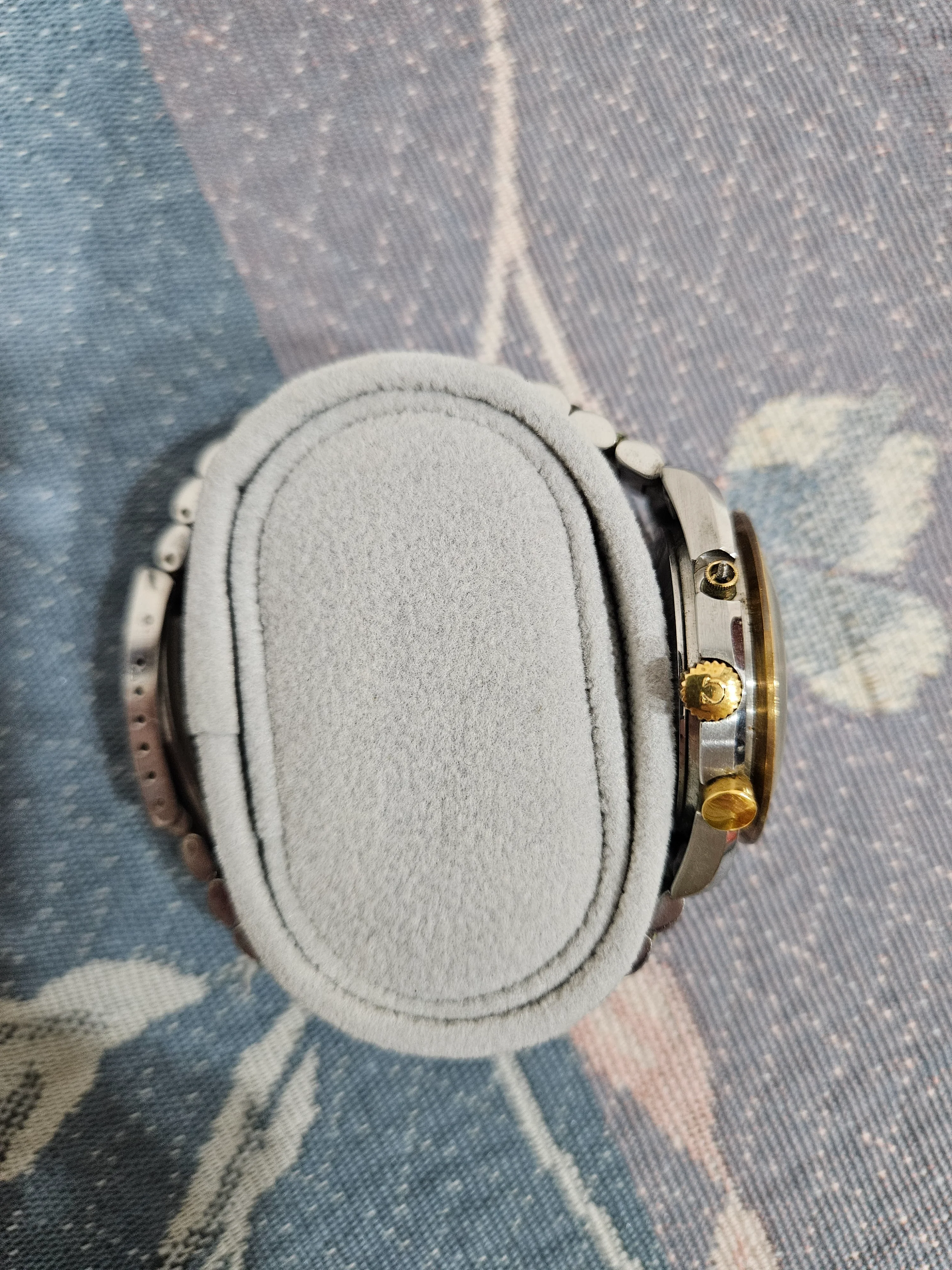

  • Missing a knob
Who should I send this to for refurbishment? I plan on keeping and wearing it. Possibly changing out the band to something lighter like leather. Is it possible to make an educated guess on the worth once refurbished based on info/pictures given? TIA

Very much appreciated, big case.
it is a 175.0032 launched 1988
810 is the endlink-number

The two tone bezel gives it a great vintage charm.
Agreed. I love the look and it has sentimental value. Any advice on sending it into Omega to be cleaned up vs finding a local shop? I'll be wearing it and am considering switching the band to leather.

Any local watchmaker can work on it, but sending it to Omega might be a better option. The watch band looks very worn and probably will need a replacement one sourced. Same with the missing pusher. Definitely needs a service to make sure the movement get cleaned, oiled, seals replaced, etc. so it will run great again.
Sending it to Omega will make it look brand new. It will be about $800 for the service and then the cost for pusher/bracelet. But they will have everything in stock rather than a watchmaker having to source it.

What you have is commonly known, and sometimes even by Omega, as "The Reduced". Popular with some and not with others. The most comprehensive history I've seen is by threequarterplate referenced here by @KaiseRRuby a week ago.
Servicing is a problem, very few independents will tackle it properly [*] and Omega charge heavily, but to my mind Omega is the way to go with this one. Otherwise you may have a long, long search to find the correct replacement pusher. Expect $1000 at Omega plus the pusher, or $800-ish from an independent, plus pusher of course. Value when refurbished I'd guess at $2-3000. It seems to be in good shape, is unusual and to some eyes very attractive, but being in an eddy rather than mainstream may be harder to find a buyer. If you are planning to keep and wear it then none of this matters.
[*] They will do the base automatic movement but not the Dubois Dépraz chrono module that drives all the hands.
