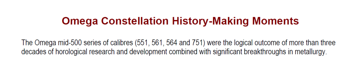

The cal 564, with the quick-set date is considered by most Omega collectors as the apogee of their vintage chronometer rated movts.
The quickset complication is considered as a bit fragile depending how it is used but all in all it is a fabulous movt.

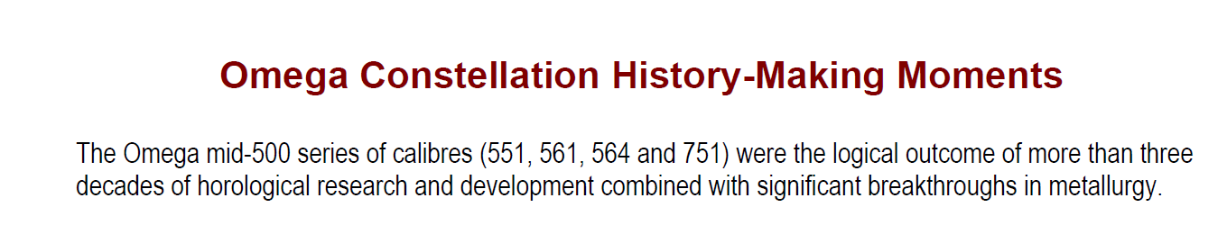

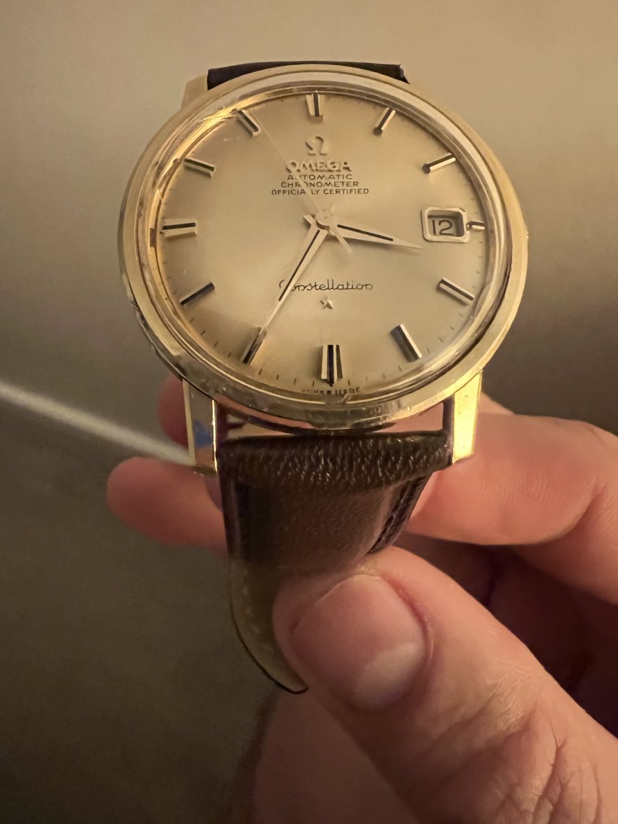

Here is the watch with a new leather strap on it. Looks quite smart.
Quick question - what could I polish the glass with to remove/reduce the minor scratches?

Polywatch is what I use although some on OF use other products, including toothpaste (although I don’t know which brand)
