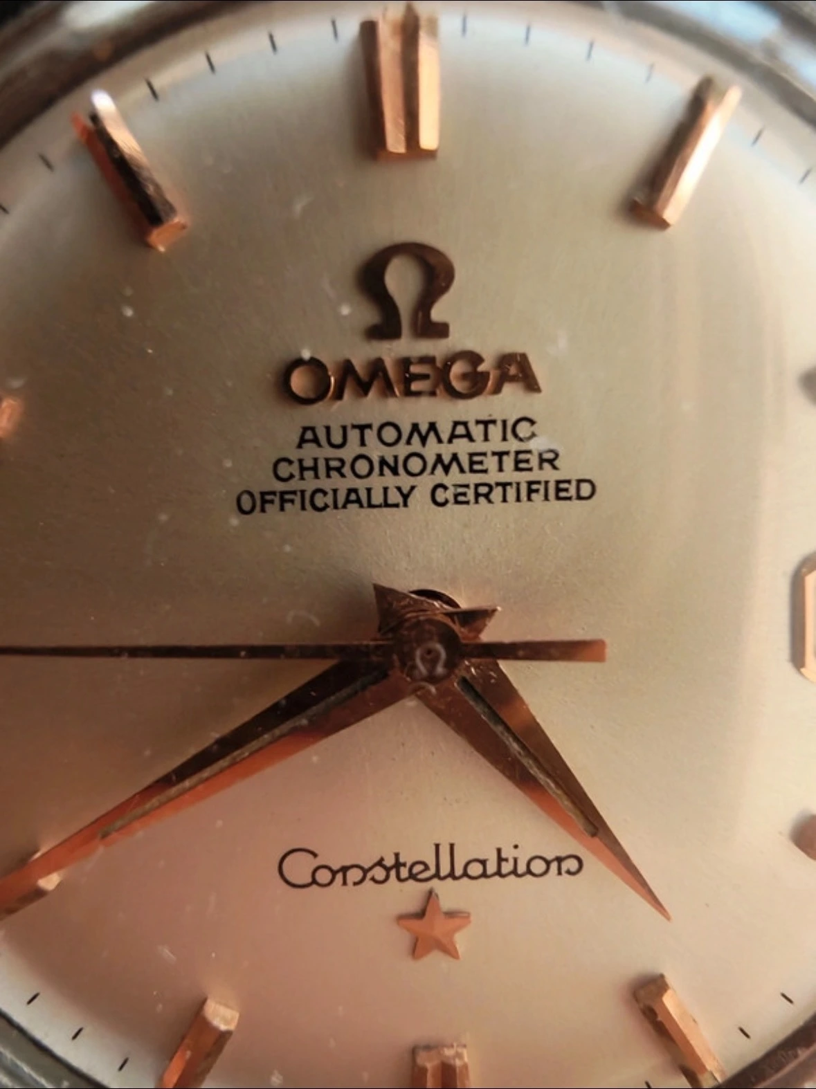

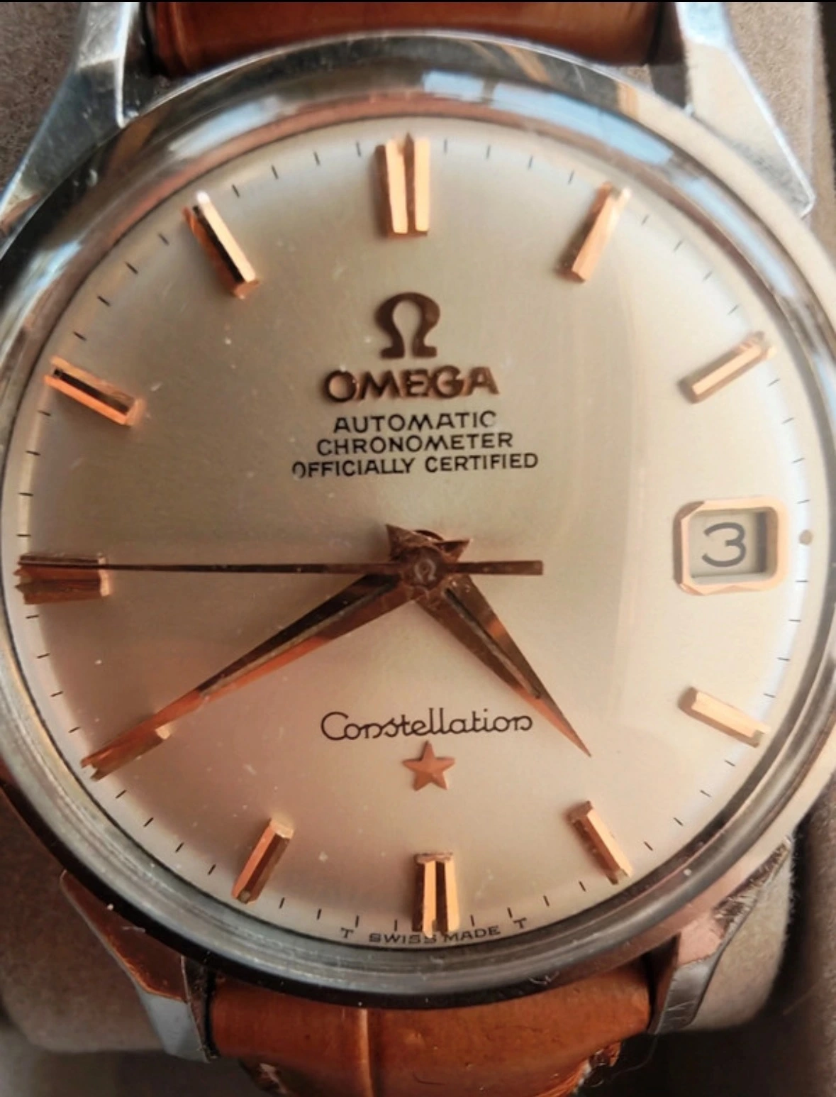

Hi everyone!

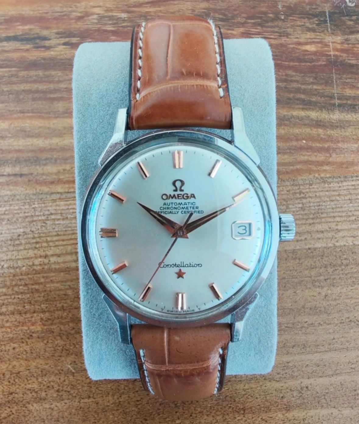

I'm in the process of buying this Constellation 168.005 domed dial. Those are photos from the seller. Could you please help me check the watch overall, the dial and other components for any signs of redialing/refurbishing? This would be my first vintage Omega so any help is really appreciated, thank you!
Michele
127
293
Hi, Michele, and welcome. This looks to me to be an honest example of a 168.005.
The dial is original (with a nice crisp font!) though it has some age-related spotting, the crown has been replaced (which is not a big deal), and the movement looks like it is a bit worn (which is, again, normal)
9,047
75,390
Hi Michele,
It looks nice and @Cartesianay well be right about the condition but to me, the dial looks a little too clean, and the photos are just not sharp enough for me.
Also, because the photos are not sharp enough, whilst I can see from the ‘T’ markings at the bottom of the dial that the indices should have tritium luminosity, I’m just not seeing it at the end of the indices.
Get a few more opinions from more knowledgeable OF members before you buy.

Thank you both for your kind replies! I'll wait for more comments from the community about the tritium luminosity!

Hi Michele,
I agree the photos are a bit washed out - and am more than willing to be corrected - though the difficult to replicate serifs on the font made me think the dial was original
On further inspection, it does seem hard to see the lume plots on all the indices but I think I see them on at least 1, 5, and 7 here:

I like all except the case has seen some polishing and the movement is tired, comes down to price.
Also, add in a service.

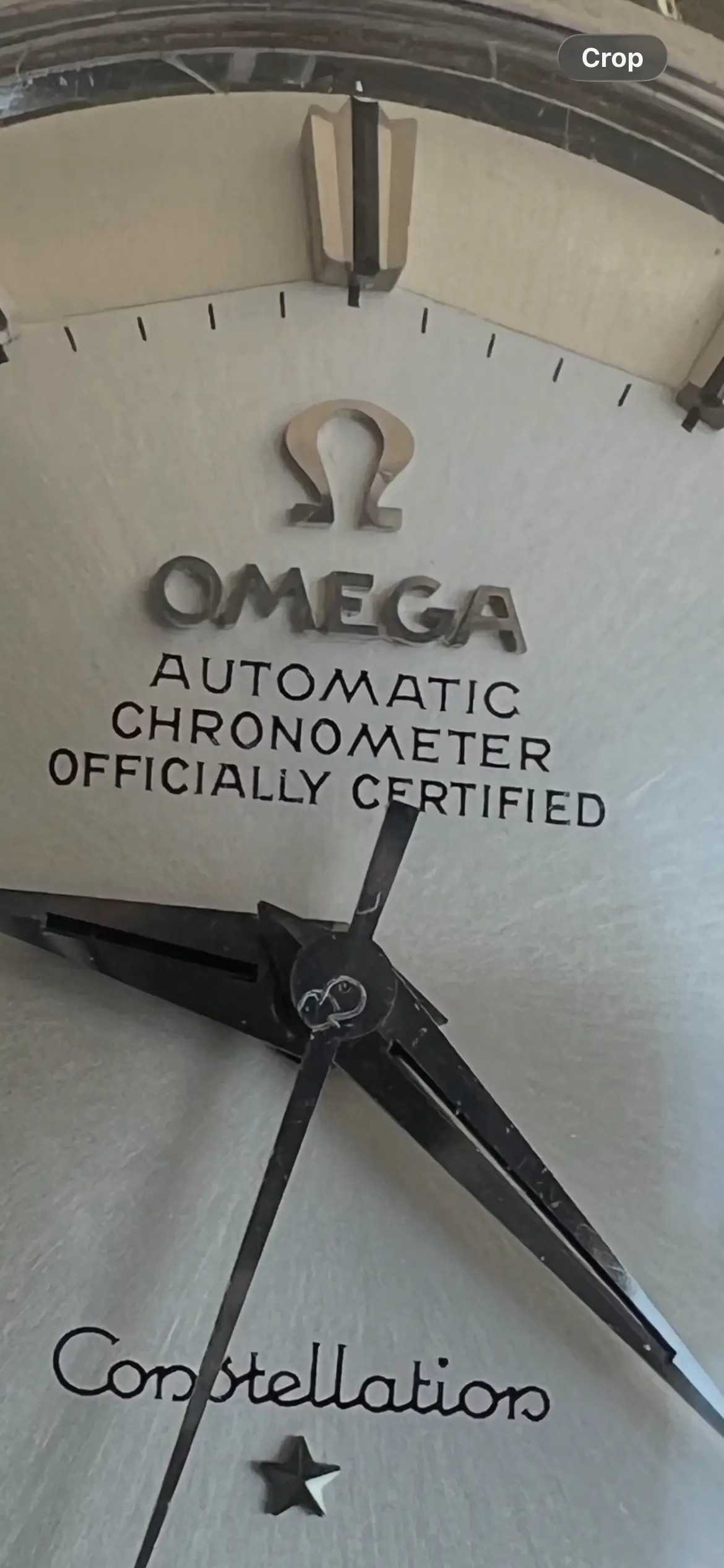

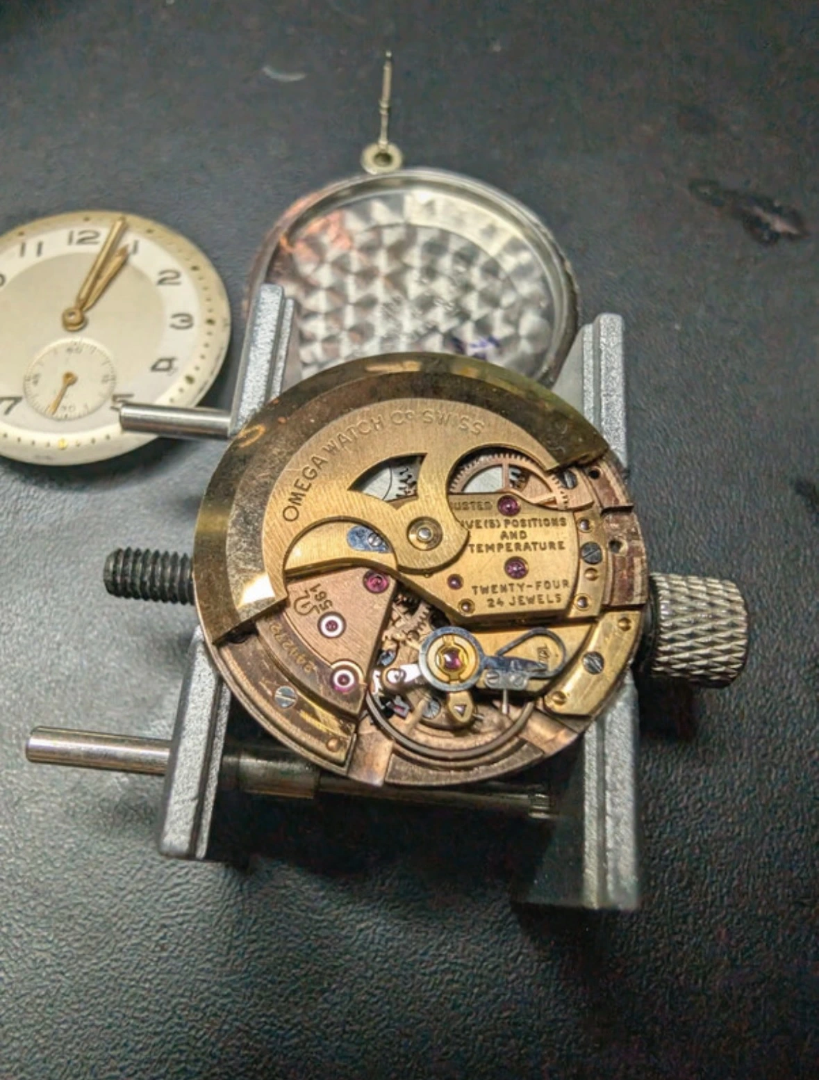

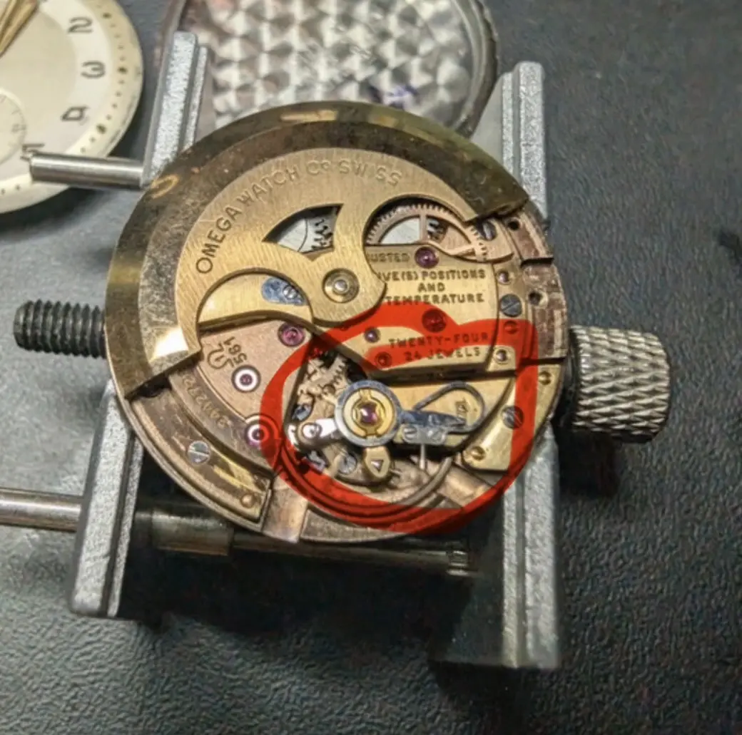

12 marker appears misaligned
Movement photo shows a different dial to side raising question whether movement goes to this or another watch.
Text looks quite bold and cramped together to my eye.
Compare text

Thank you! By "tired" movement you mean the visual appearance? I've got a servicing receipt from the seller dated December 2025
Movement has been through many hands to get in that condition, could be a fly-in, but if serviced, why is the micro regulator arm pegging the right edge to the limit?

Two more worries:
First, the movement photo shows an entirely different dial and hands adjacent to it, and
Second, the movement is mucky and clearly hasn’t been serviced judging by the position of the regulator
And, again, members who know more about movements will probably spot other problems.

Could it be that the photo of the movement was taken before servicing? The seller is asking for €1500

The text does look a little heavy and cramped but the correct different elements appear to be there - even down to the 'dodgy' Cs in the upper text.
If that's a redial - hats off to the person who did it.
The pink furniture is rather lovely.
None of the photos are good enough to assess the case properly.
The movt worries me - as one of our elder members once said, it looks like it has been ridden hard and hung up wet.
Different colours and grubby
Regulator hard (!) over
More importantly the rotor has been dragging severely on the movt.
If this was a pic pre-service, then ok - if not it's going to need one immediately.
(the errant dial is just in the pic for window dressing)

Two more worries:
I agree that the regulator arm being moved that far over is not a good sign, though sometimes sellers take pictures pre-service for some reason.
And, the dial in the picture has a sub-second hand, so it wouldn't go to the 561 movement, so it seems to be just an aesthetic choice
Overall, though, it seems like perhaps there are enough yellow flags to pass on this one
In your position, I’d keep looking.
It’s sometimes said that ‘you buy the seller as much as the watch’ and anyone reading this thread will be wondering why on earth the seller posted the photo of the movement.
And, just for your future reference, I have two 561 Connie’s and I append the seller’s movement photos when I bought them. One was serviced (and I made sure I got the receipt and that it was from a well known watchmaker) and the other was unserviced.
But, well done for checking here before you bought it 👌

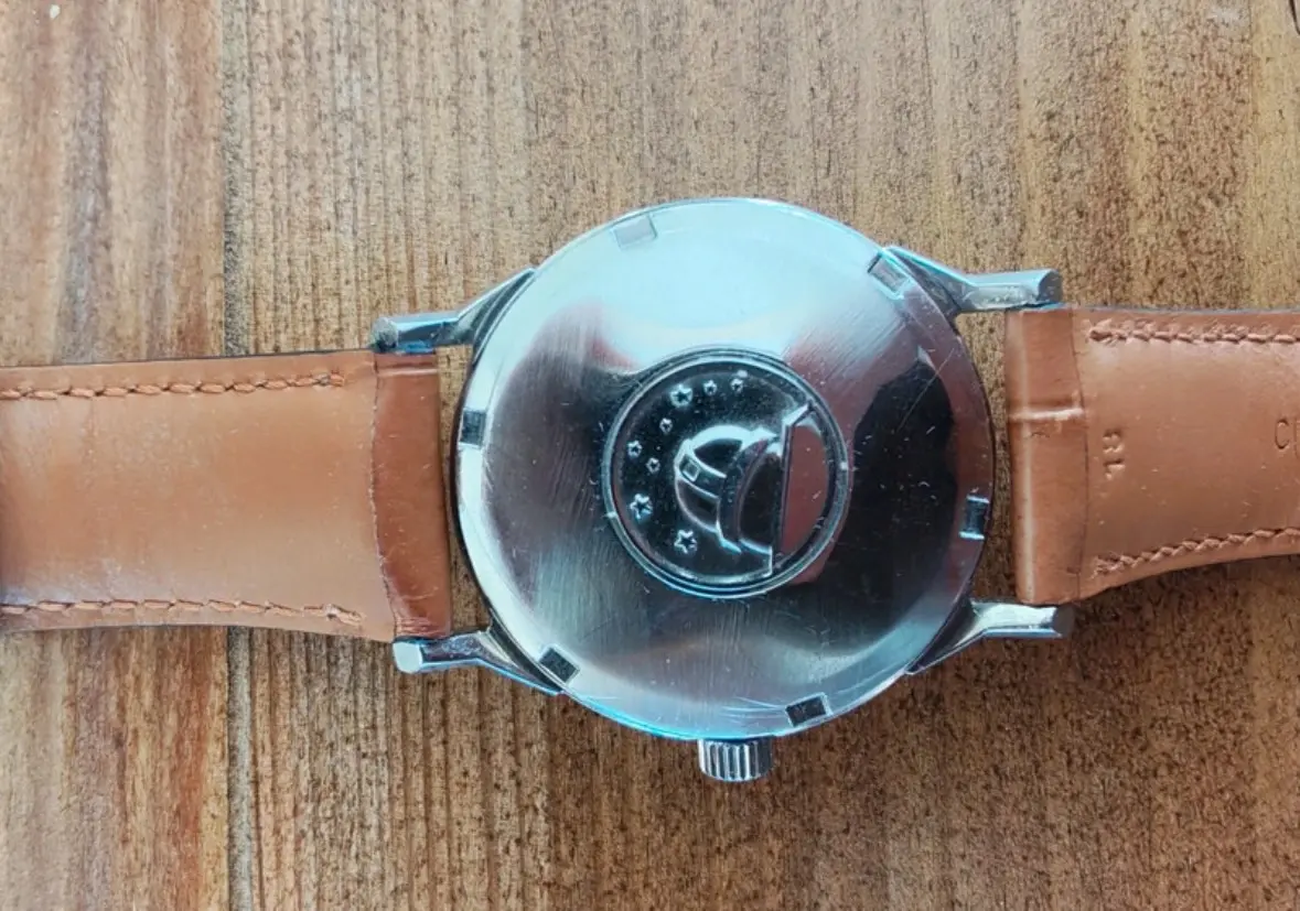

Thank you! just for my learning experience and just focusing on the dial: you think the heavy and a little cramped test is a red flag or there are proper examples with this heaviness?
9,047
75,390
Red flag - and the watch was no bargain either
6,671
10,306
It would, generally, be a red flag.
But there are instances of ‘heavy’ text being as being ok.
The point being - look for standards that you can be certain of.
