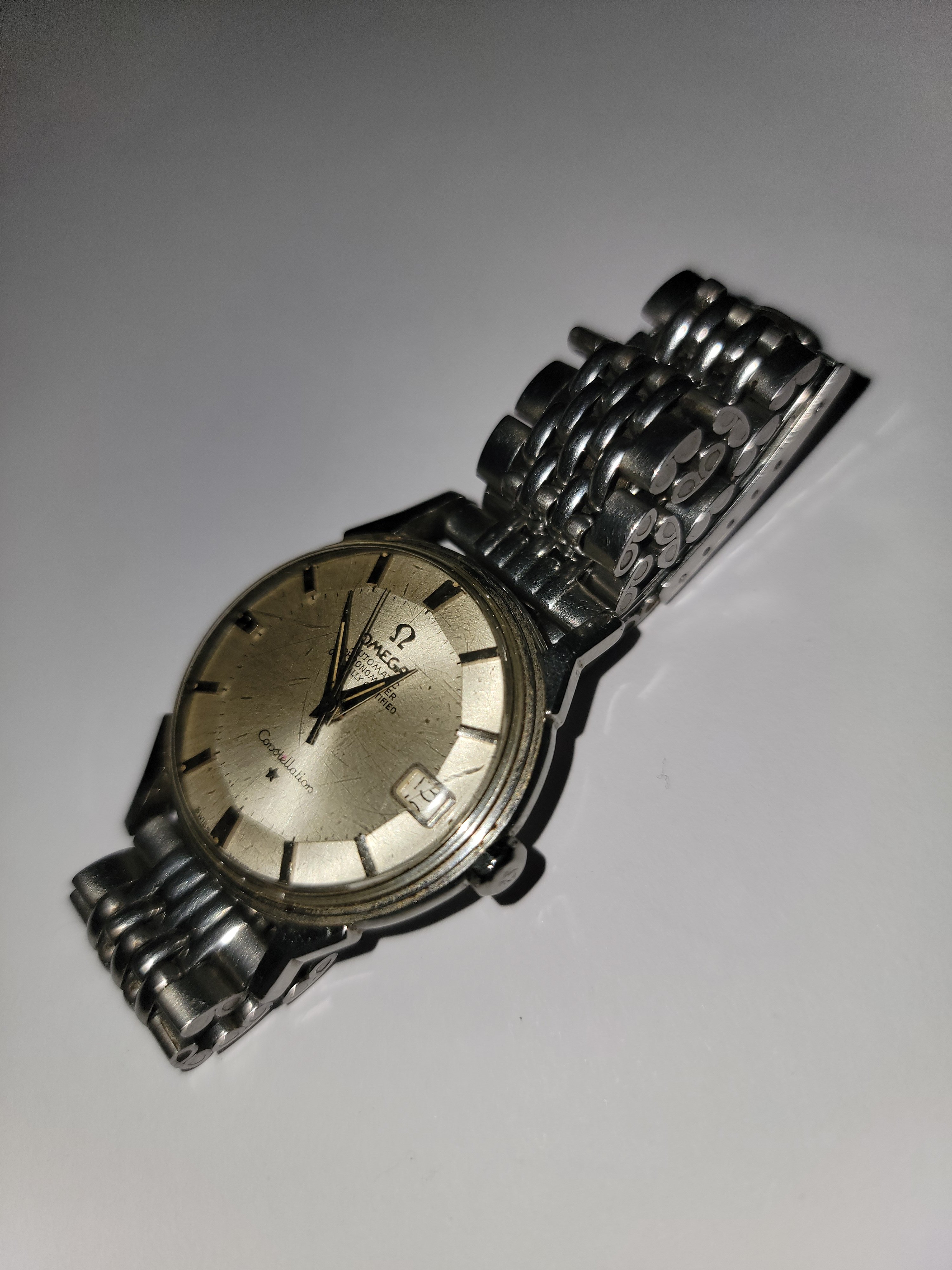

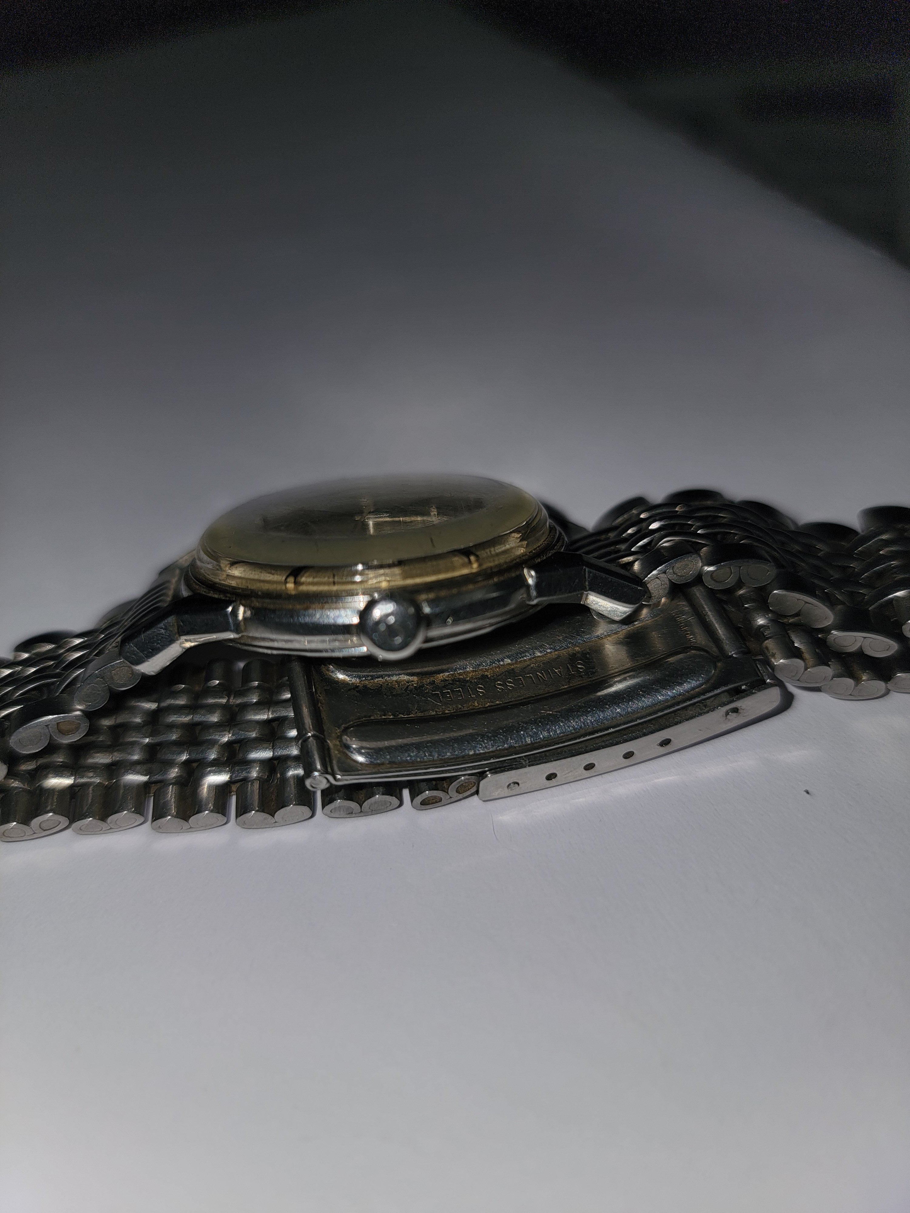

Hello I recently acquired my grandfather's Omega constellation And I'm looking to get it repaired as a gift for my father. Overall it is i fair condition after being worn for close to 40 years and then locked away for another almost 20. However i am missing the trim ring between the crystal and case and looking to purchase a new one as told to me by my local watch repair shop. My problem is im not sure what i am look for, on eBay i fond new crystals will have a Either silver or gold ring. Could this be the trim ring that is missing? I would greatly appreciate if someone can give me some information on what i should be looking for.
Thank you

What you are looking for is the bezel. (Not the crystal retaining ring)
These are few and far between I’m afraid.

There is a tension ring on the inside of this crystal, that is either colored yellow or white. What it seems like you are missing is the bezel, which sits outside the crystal. A tension ring, which is what is supplied with replacement crystals, cannot be used as a bezel replacement.
Replacement bezels are very tough to find. Usually, you end up having to salvage one from a donor/'parts' watch.
