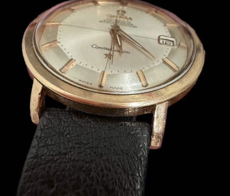

Here is another pic
that’s all I was sent. I will pick up tomorrow. I looked up values. It’s below what they are selling for
As @dsio says, the lugs look polished but on the other hand the broad-styled bezel appears to have survived reasonably well.
The watch has a really nice dial and I’m sure it will look great on the wrist.
You will notice the dial has pale lume but no Ts - this is because it is a early .004 and it sits in that short period when Omega was using Tritium lume but hadn’t yet started putting Ts on the dial.
(The hands may have been relumed - but then again lume on Constellation hands is often paler than the indices)

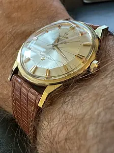

Constellations were the top of the line offering by Omega. All gold 50s/60s Constellations that are not solid gold are 14k gold capped, not filled or plated, which is a far superior finish to filled or plated. There is nothing wrong with a gold capped Constellation and they are quite durable. Here’s an example that I own:
