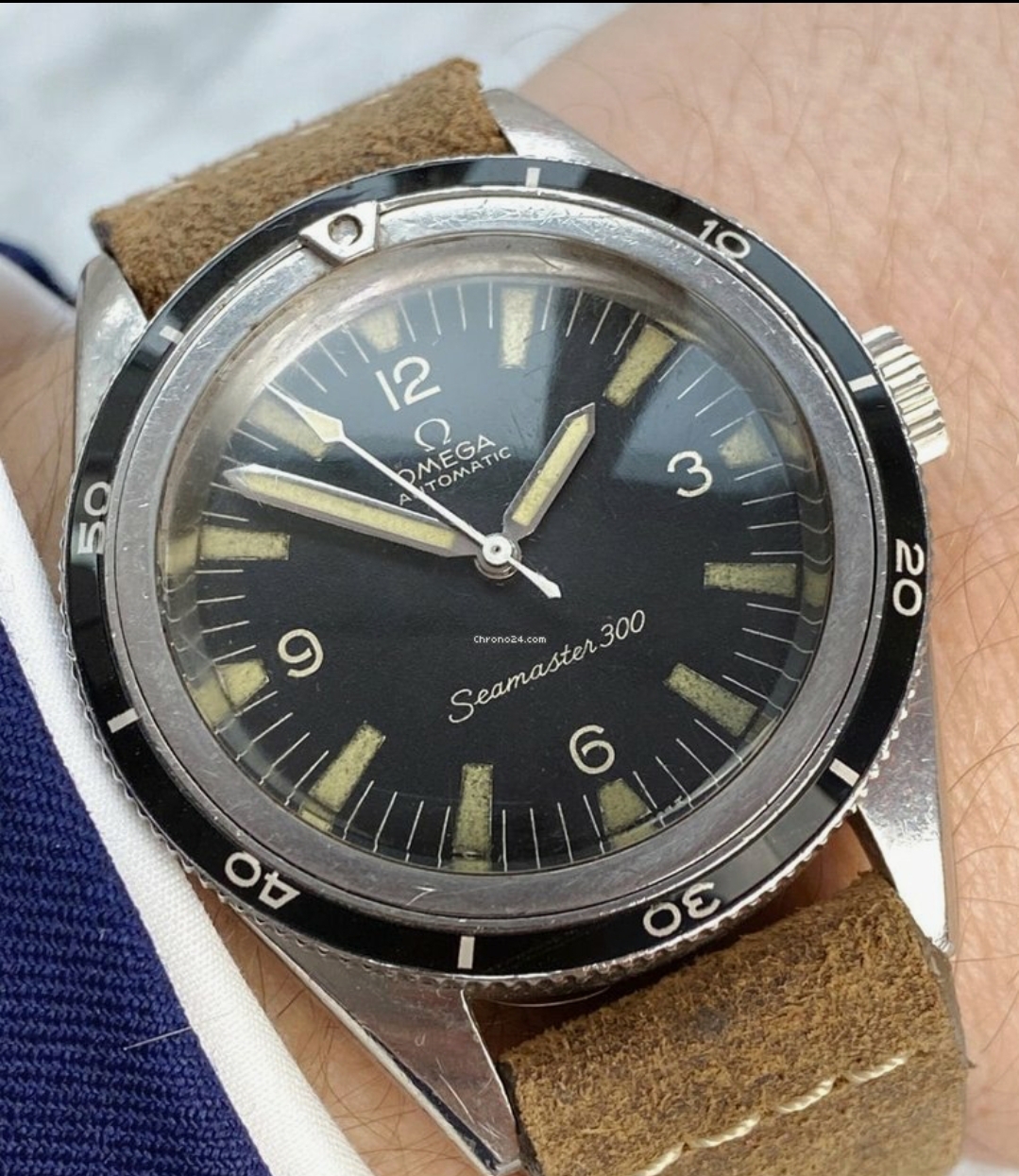

Hello,
I am looking at potentially buying a Seamaster 300 14755-1, with an Omega archive extract. This dates the watch to 1961. Movement number 18.xxx.xxx. All looks pretty good, however the watch has candlestick hands, which is a bit confusing to me.
Can this be correct / authentic? The seller indicates this is a transitional model.
Thank you for your help.

Yes that could be correct

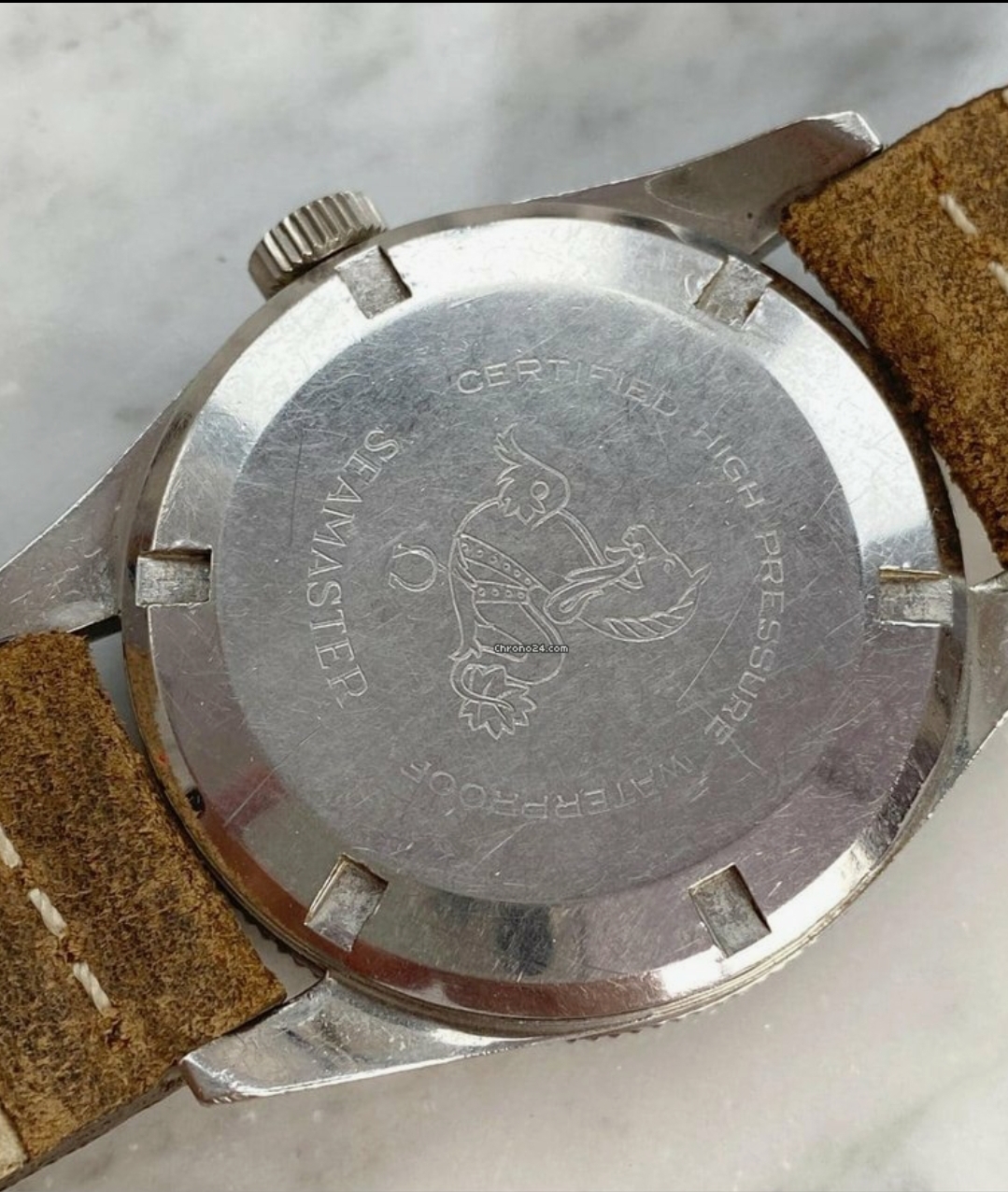

Here are the photos - somehow it does not work from my mobile, so I had to use my PC...

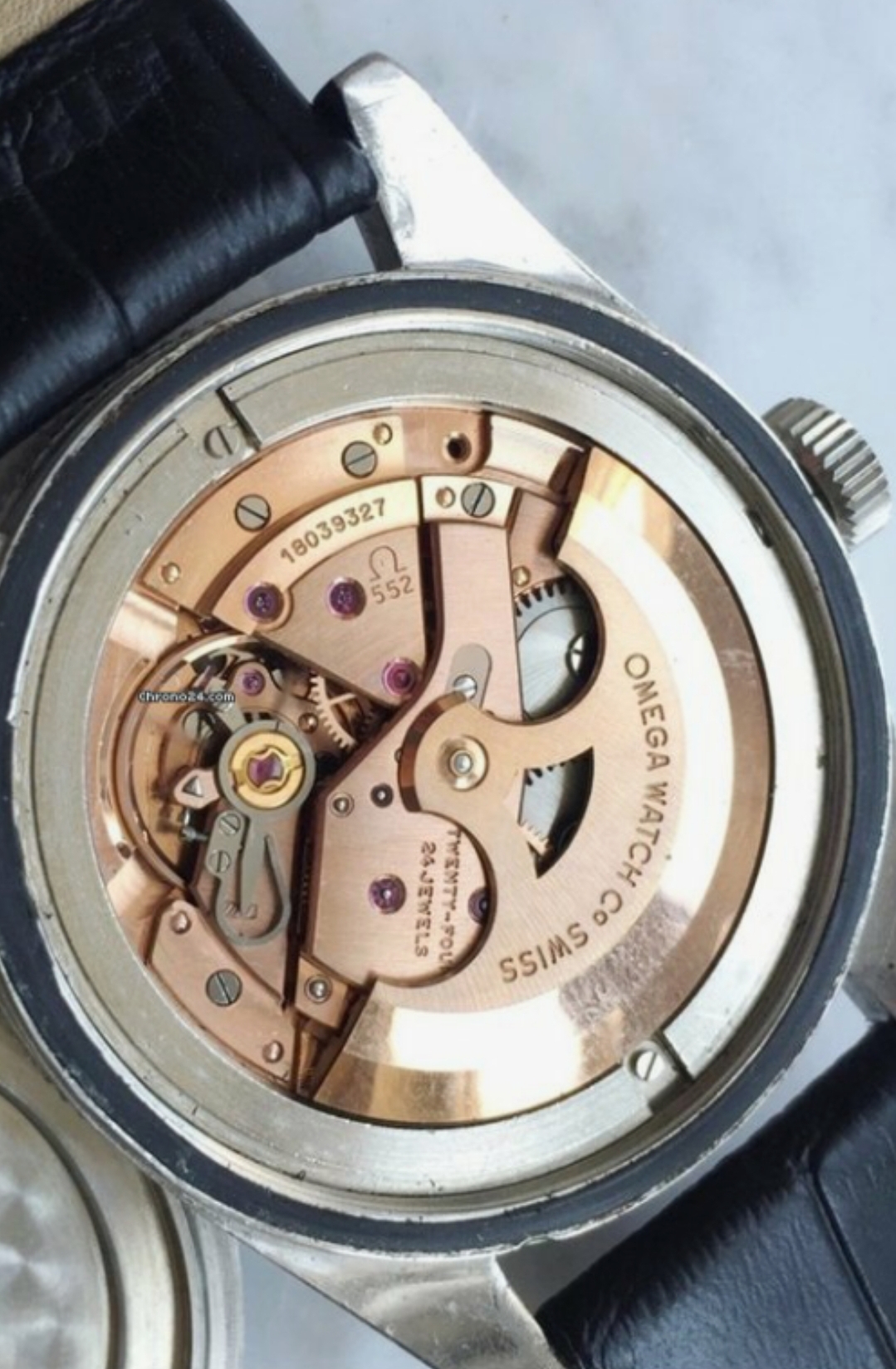

Movement looks amazingly clean, but the extract confirms this belongs to the watch. Thanks in advance for any suggestions.

Ps.: Oh, and good luck with your hunt. I am no expert but the movement does look actually good to me and it might even be ok but I wanted to let you know.

What's the first number in the serial number after 18? For a 14755-1 it should be a 2, in which case the dial and hands have been replaced with later versions. The seller is using some "sales talk" here, a 14755-1 can't be a transitional model when the -2, -61 and -62 all came after it before the change to 165014.
