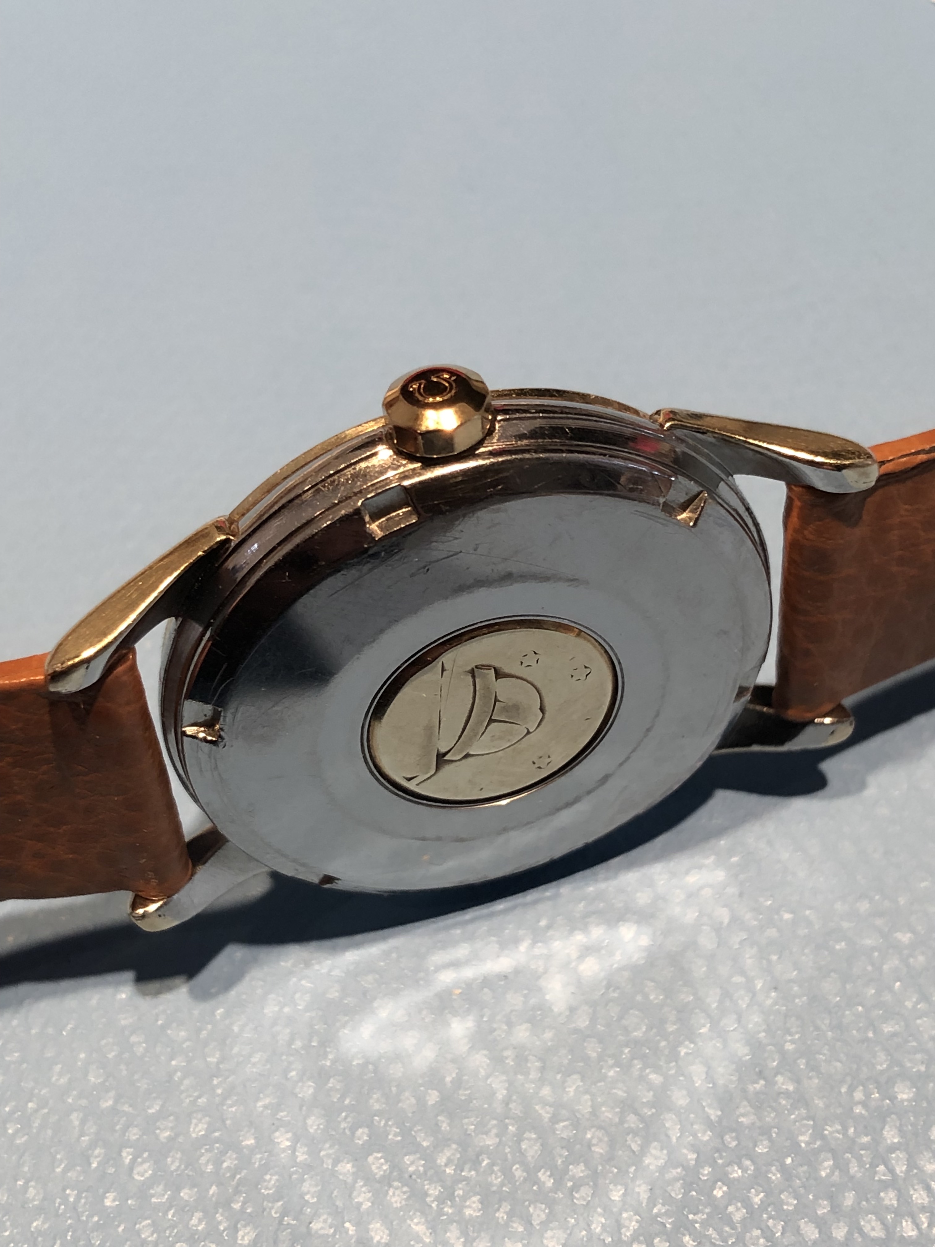

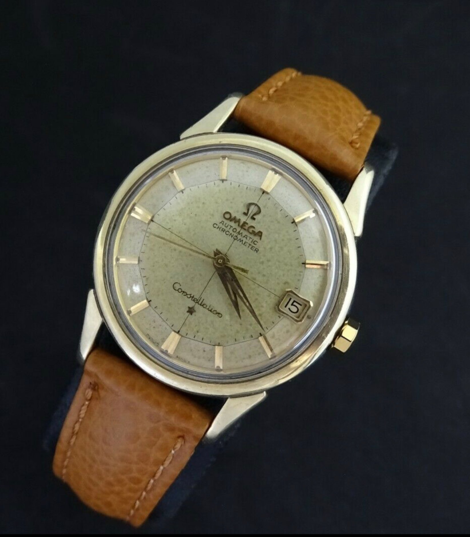

Up next for the collection is this Omega Constellation from 1961-62, I was drawn to the dial patina and gold tones of the watch. The case and dial with it's pie pan and cross hairs seem to present nicely, the back is over polished and has lost some of the stars - is that style correct for a date model as I've seen conflicting information, we have some crumbly hands but they look to be original. Crown seems good. I'm interested in originality, is it all correct?

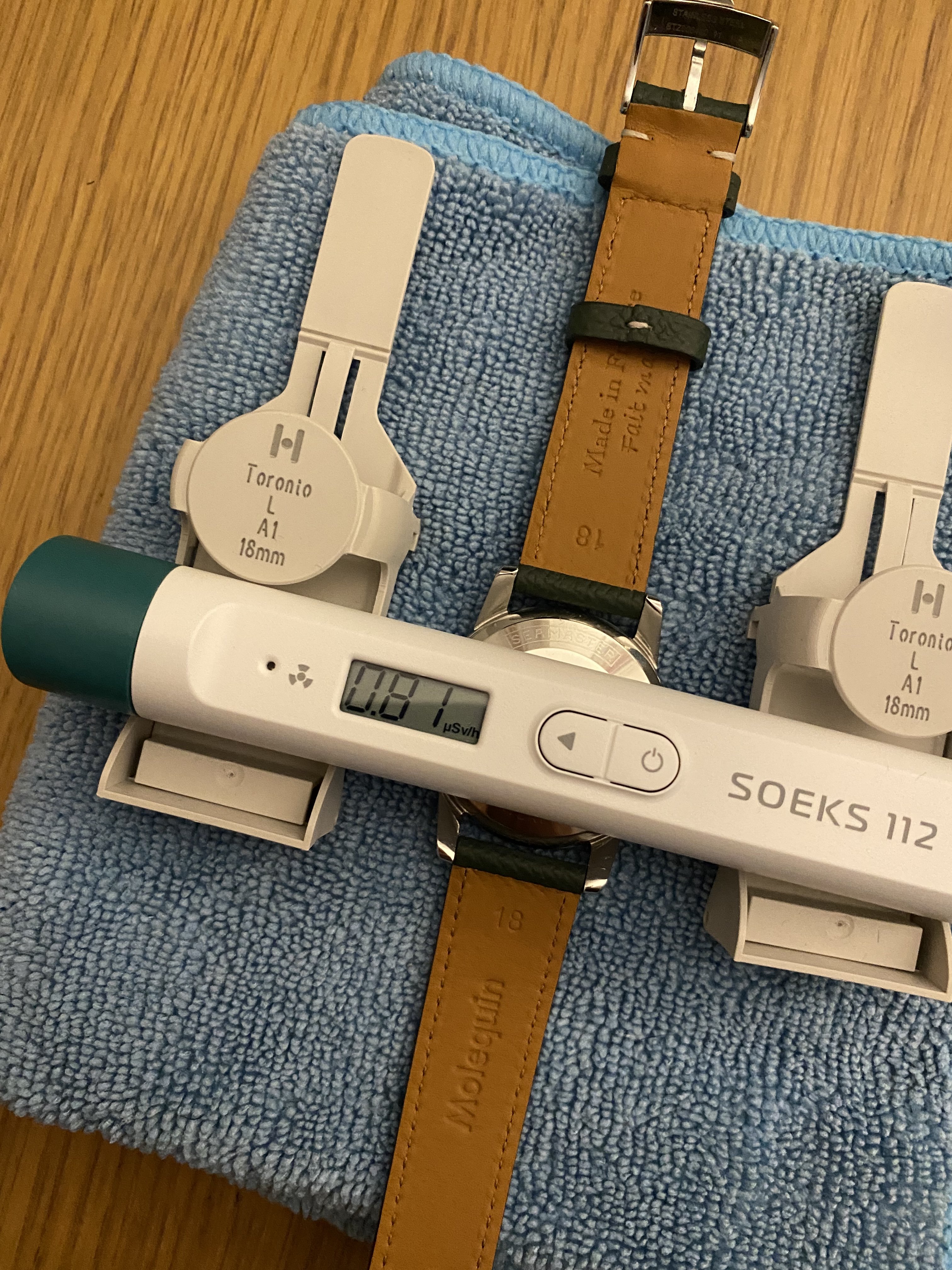

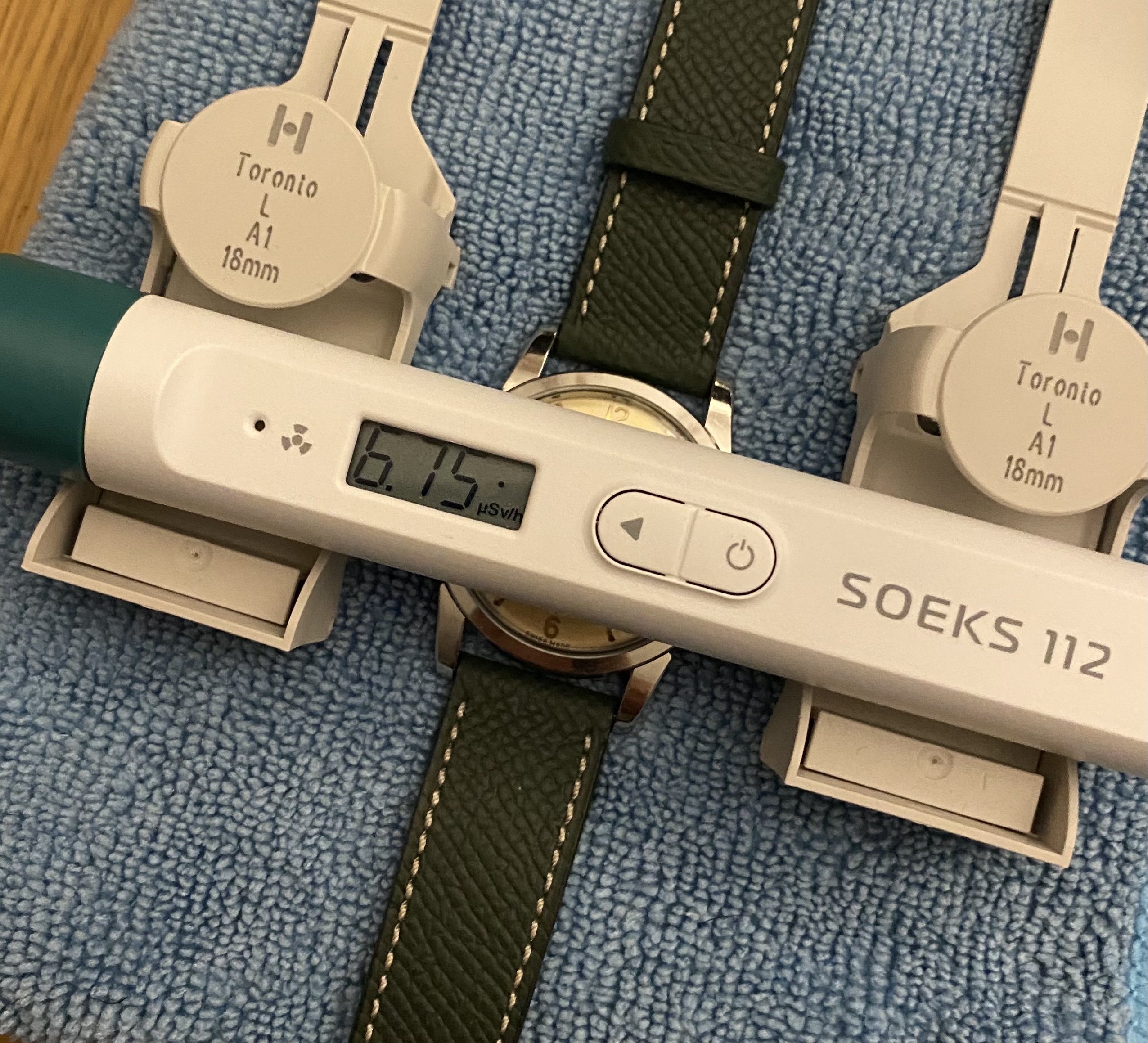

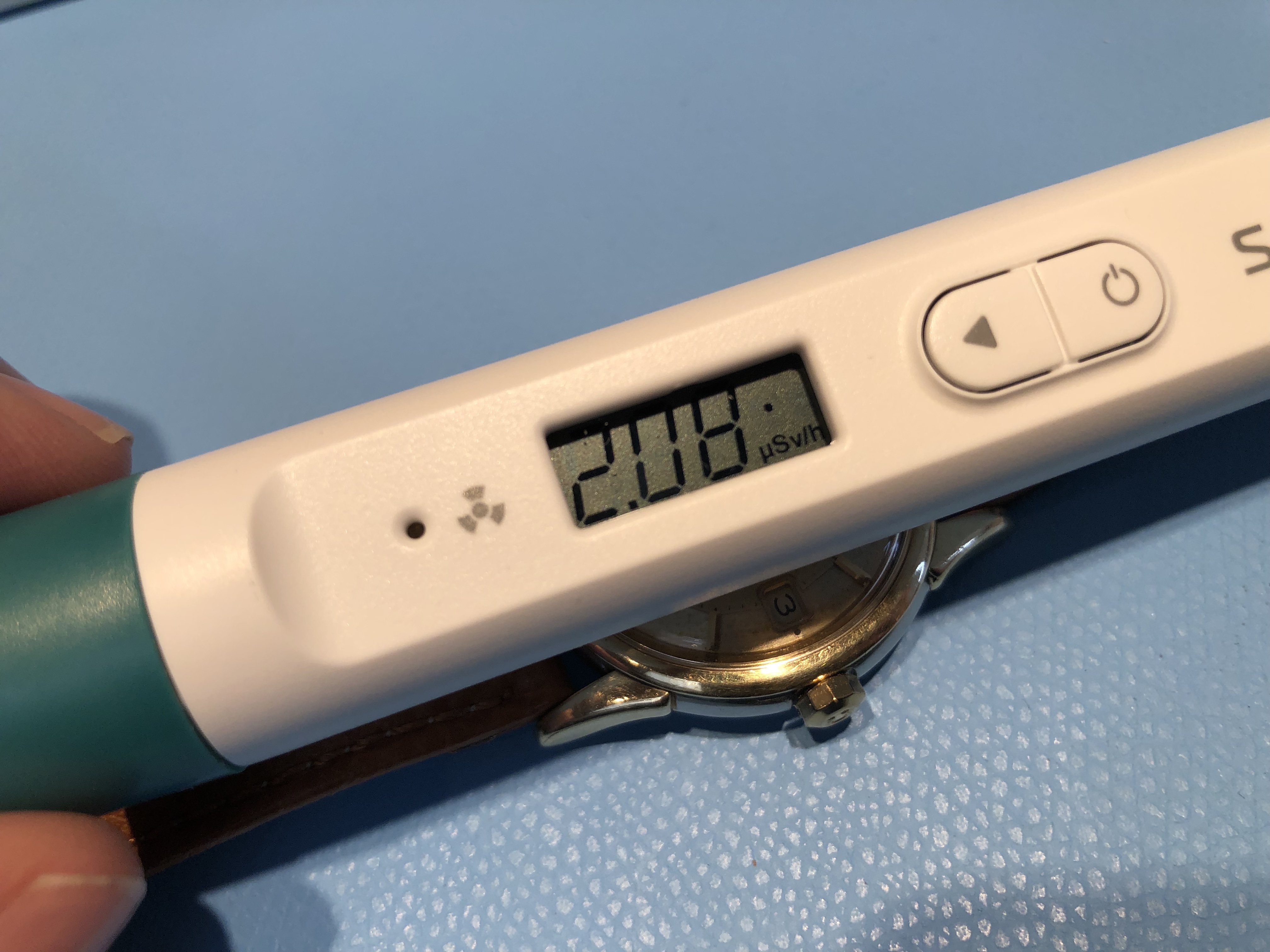

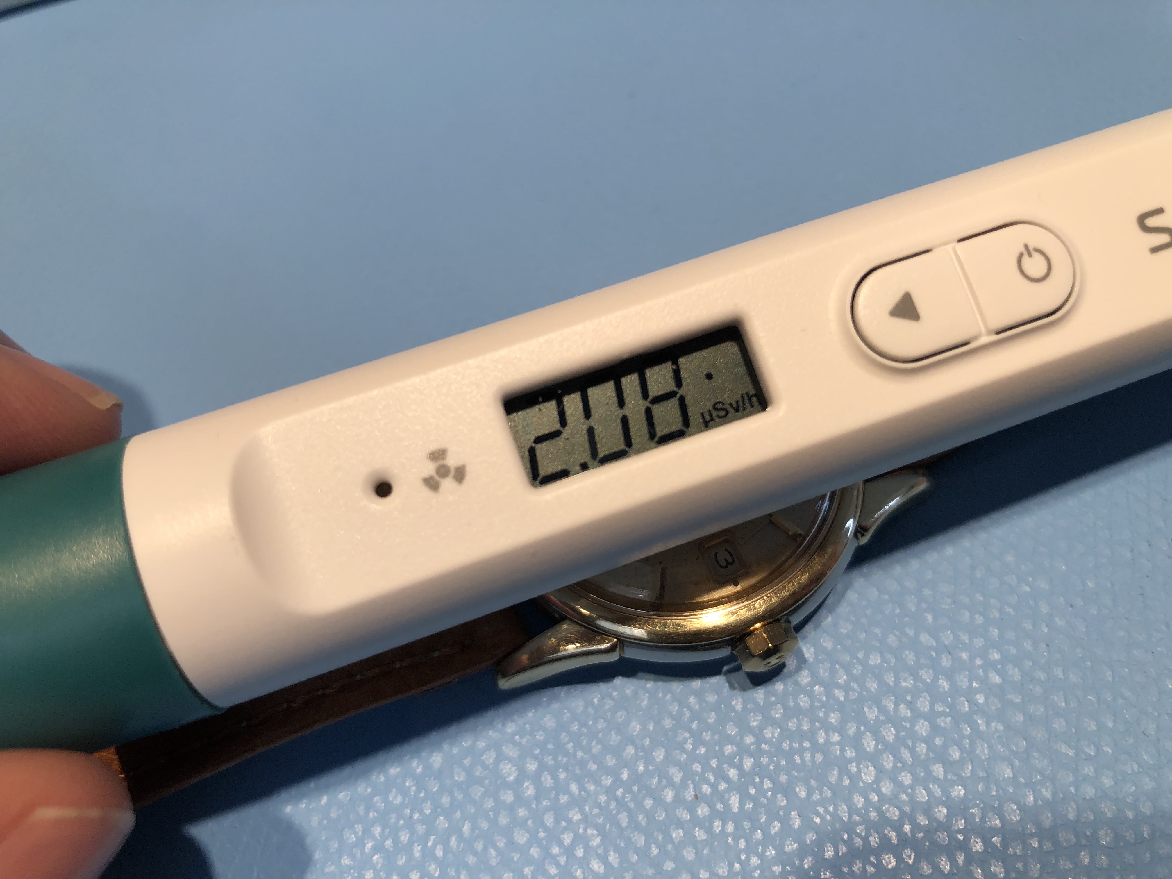

I've since learned that Omega started phasing out the radium dials around this time. A check with my Geiger counter showed 2.1 micro Sieverts / hour, not super hot and if anything demonstrates originality. I can't wait 1600 years to get this down below 1 micro Sv to start wearing it! That being said, I need to decide what to do with the lume in the hands which is crumbling away. I'm inclined to leave it, but appreciate your thoughts and comments.

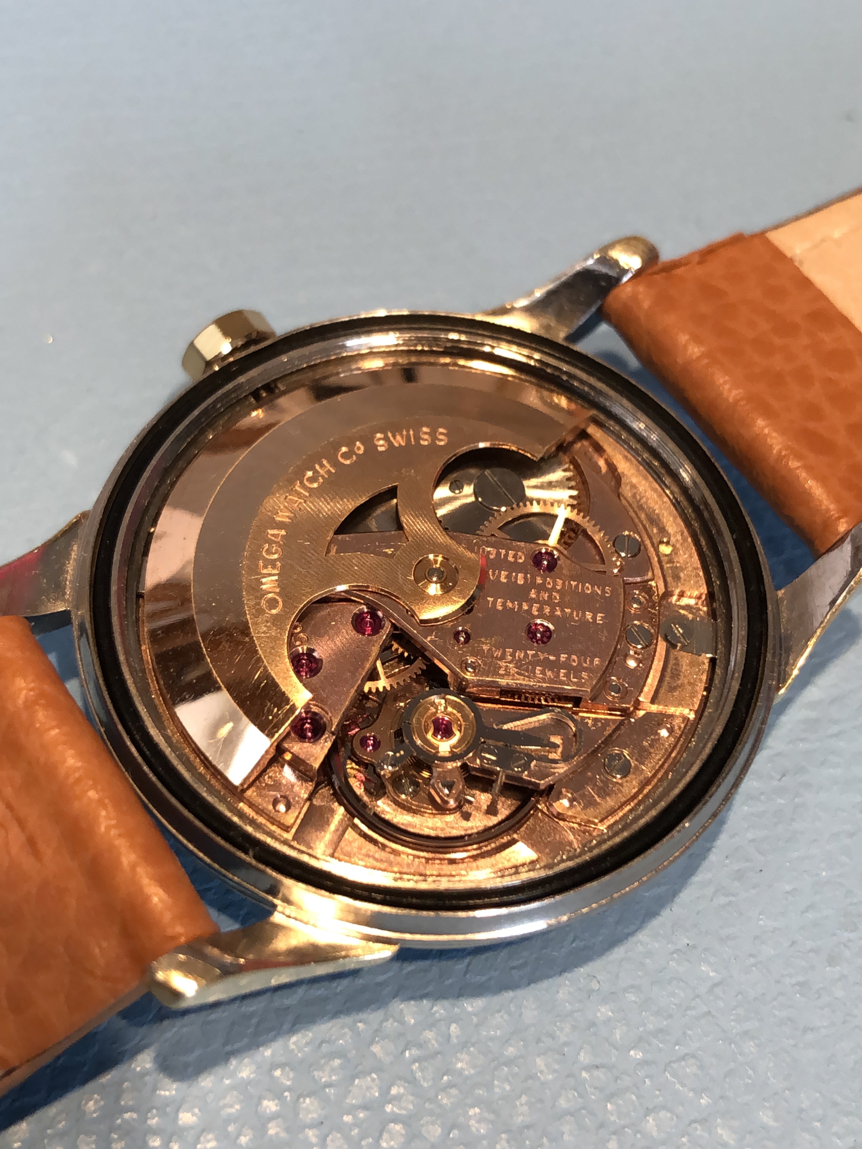

I think it looks correct. Movement parts have been swapped in/out since the finishes don't match up. The case has been polished quite heavily. Besides the definition in the stars, the bezel and lugs have been rounded off.
The caseback medallion is (or was) correct for the ref. Hands are correct and can be relumed, should you care to have it done - it won't make a difference to the value in this case. The crown is an incorrect replacement, the thick decagonal style doesn't belong on a 14393, but that's an issue that can be taken care of.

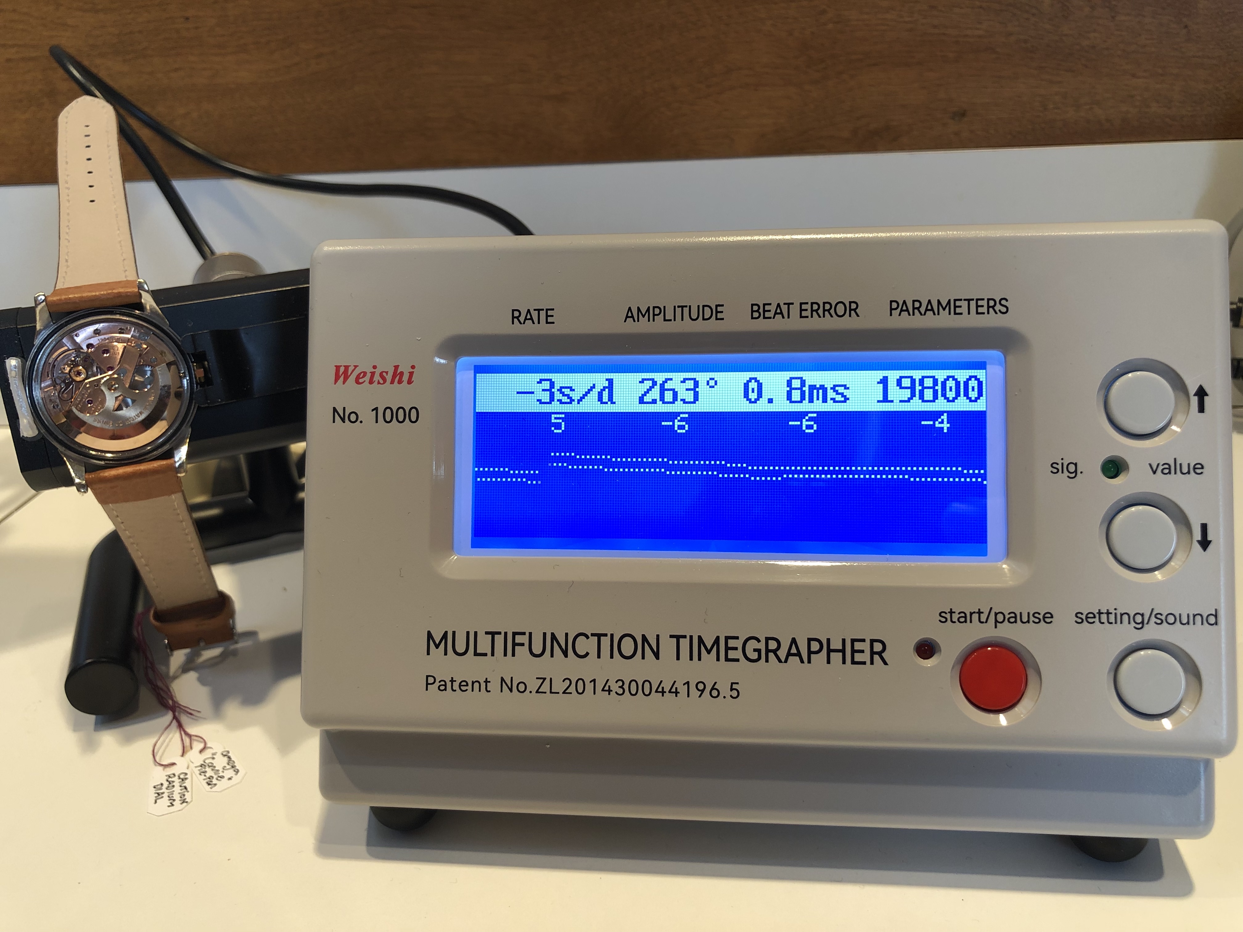

Stormsky10 - I agree on the polish level and think that is reflected in the price I paid, US$980 - does that seem reasonable, good, bad? I'd love a crispy case and medallion but expect that may be much more. I was intrigued by your comments on the movement, so donned the hazmat suit and opened up the back to get a better photo than the seller provided (see what you think). It also gave me an opportunity to regulate the watch quite nicely as it turns out.

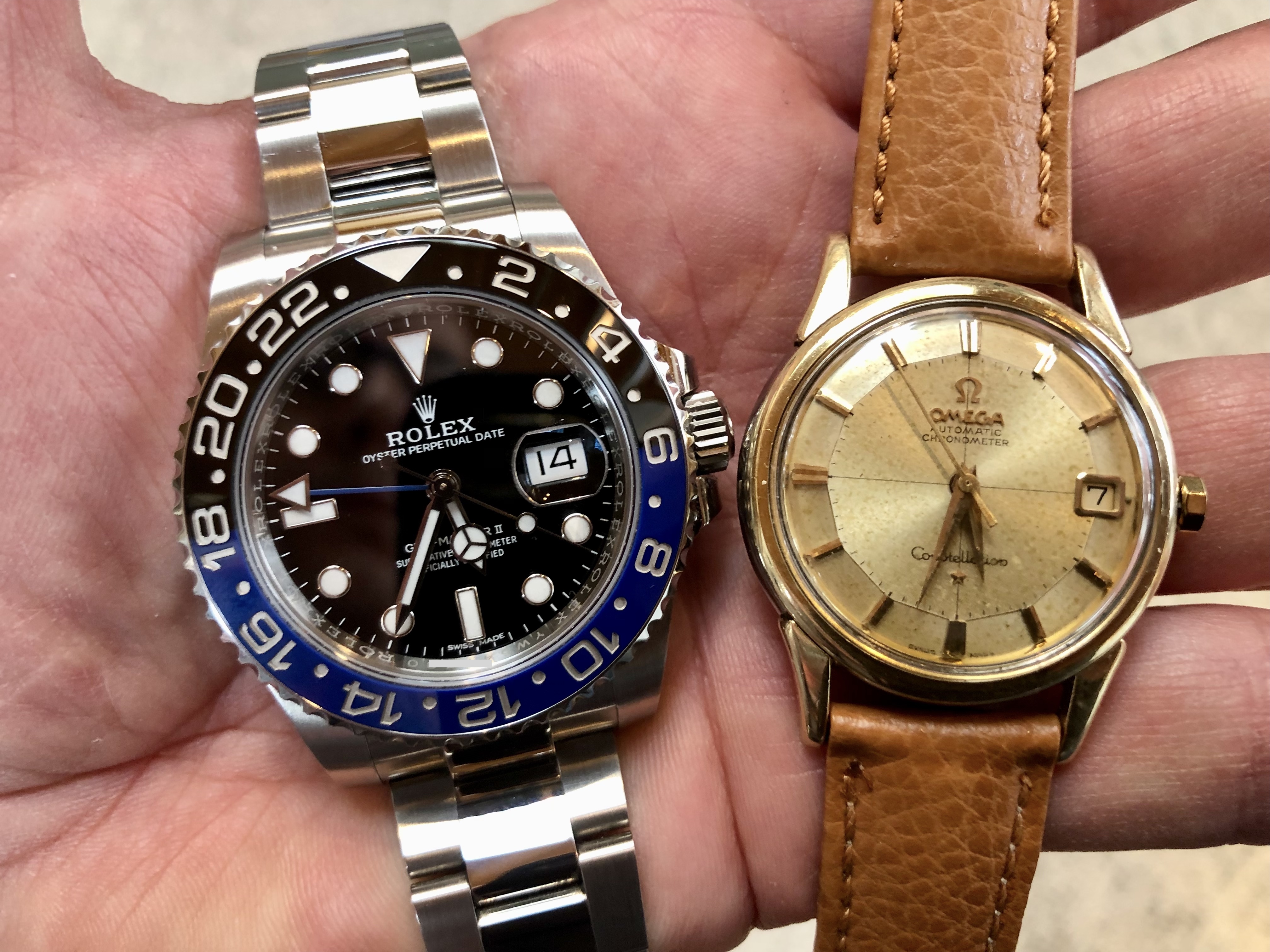

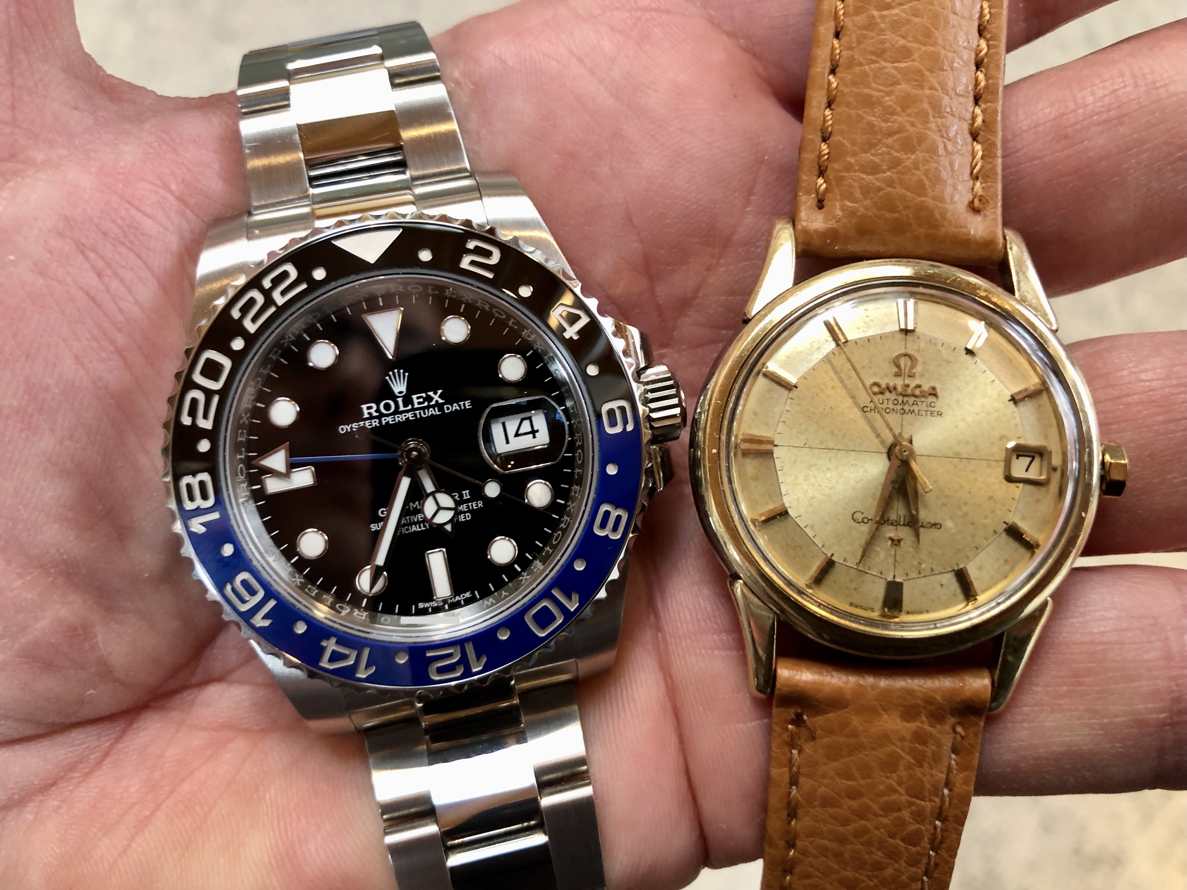

This is my first venture in to the smaller diameter cases <35mm, I'm getting used to it but thought I would post a comparable with my recent travel companion, a Rolex GMT II BLNR (the "Batman") at 40mm. .
Congrats - I'm sure you'll get used to the size (and lightness) of it very quickly.

I have a few radium dial watches. I do not wear them everyday and I never open the caseback myself. I would sell before even thinking of reluming. I have the same counter.
