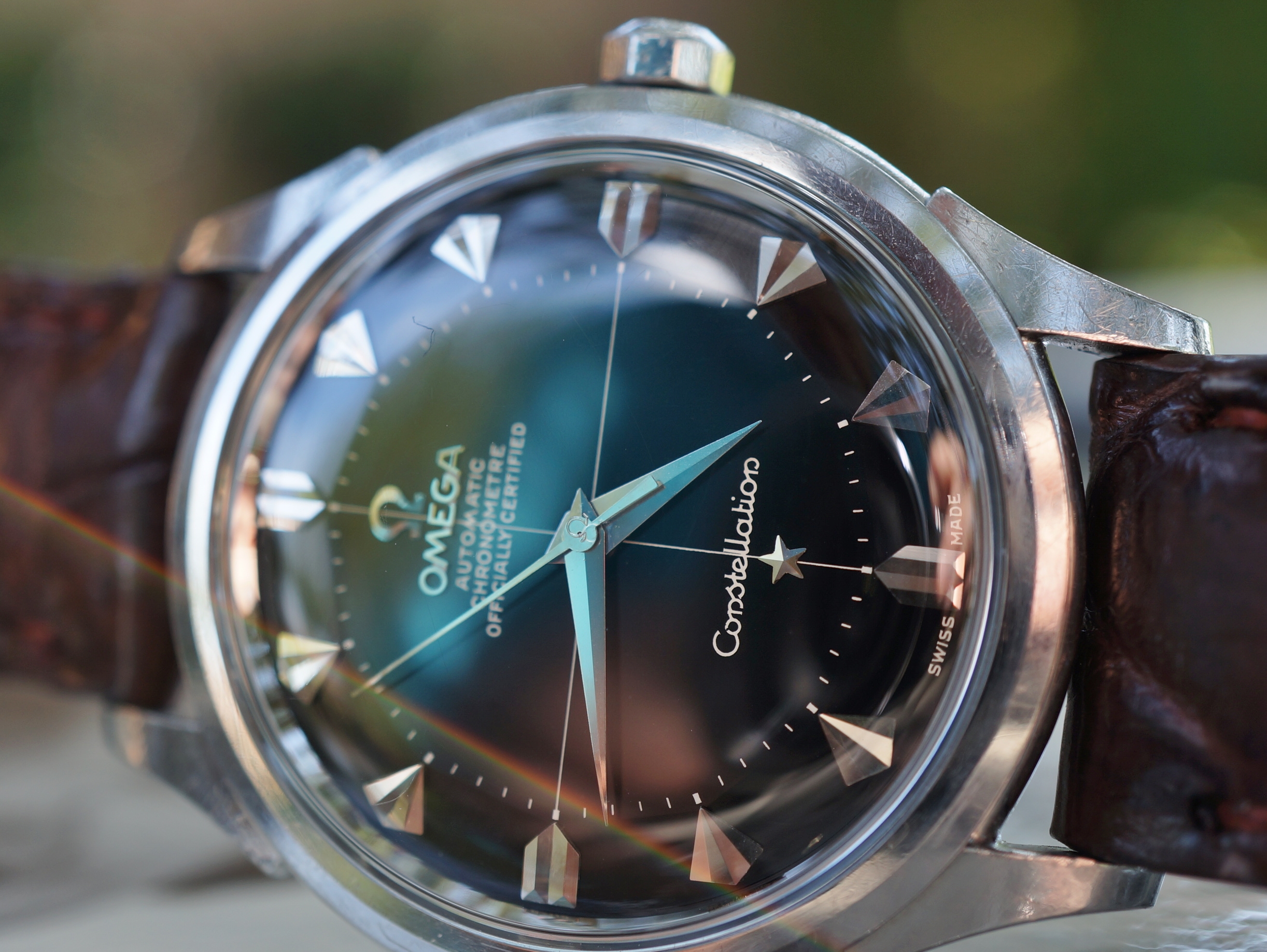

1957 Connie Pie Pan 2852 Cal.505 Gold Cap Black Dial

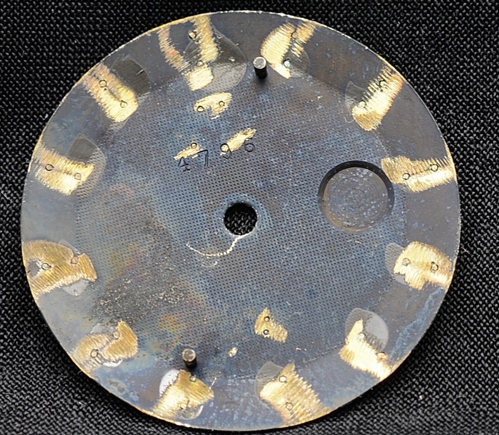

Looks OK to me, the color makes me pause if the fonts are indeed yellowish in person.
Last way for proof is to take a peek at the back side of the dial.

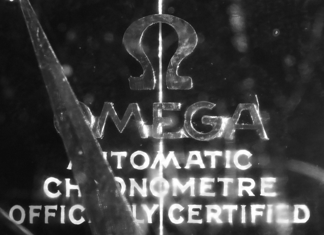

Thank you for your pictures! Glad to see the same curve with the minute markers on your piece. I shall be positive and reassure myself that the dial on my watch is original. The last thing I want to do is scratch that dial. 😁
8,880
62,875
Curve of minute markers are #16 on my list for things to look for on originality. My list ends at #15.

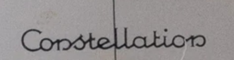

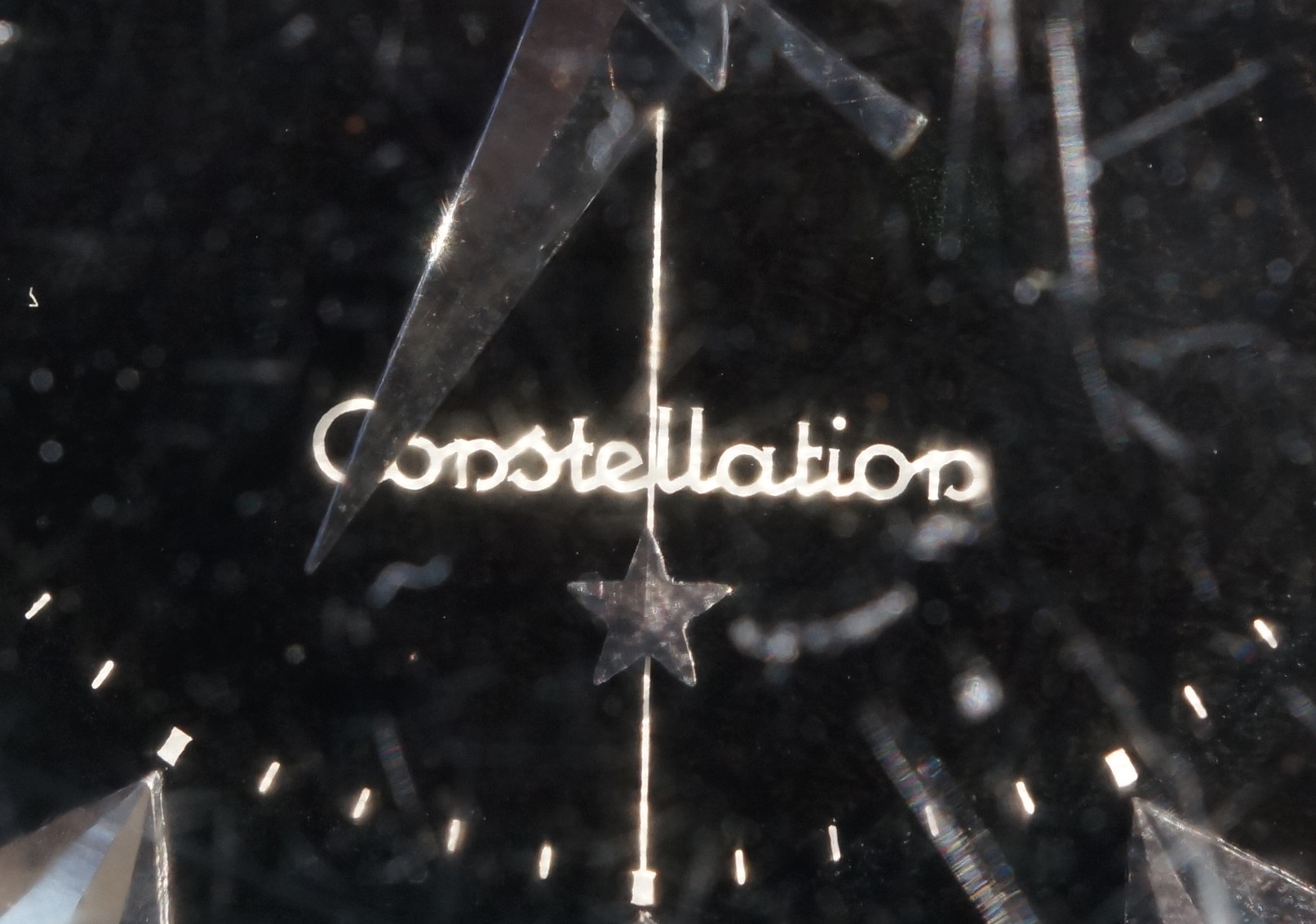

I could be wrong, but I think a strong indicator of originality is when there is a slight space between the cross hair and the "l" in Constellation.
8,880
62,875
Bingo, #4
Just to add to your nugget of wisdom.
You’re quite right, but depending on the reference and dial type it can be a little more nuanced than there just being a space to the ‘L’.
The crosshair on a pie pan dial should be slightly further toward the ‘E’ than on a dome dial.
On 2852s the crosshair on a dome dial is often pretty much hard up against the ‘L’ (but still maintaining a small gap.)
For later references the crosshair tends to be (very) slightly further to the left on each dial type but still maintaining the different positions between pie pan and dome dial.
Note - The crosshair should never touch the ‘E’ or the ‘L’ on either dial type.
Edit:
The perceived closeness of the crosshair on the 2852s may be due to the thickness of printing on both crosshair and text.

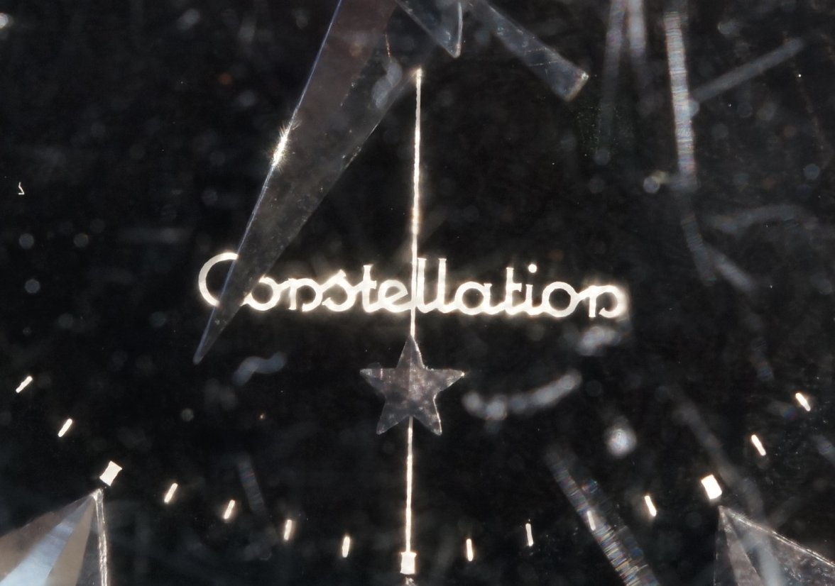

can we see the whole dial?
I presume the 'wavy' cross hair is an artefact of the photograph?
912
1,255
Thanks for sharing @Hensley, it’s the same font as my black dial😀.
At first, I thought there is some problem.
Interesting to see that even on genuine dials, some of the words/letters look slightly misaligned. It’s being very picky but that it’s pretty visible in the super close-ups there. For instance how the letters CHR look lower than the rest of the word.
It might be the angle though. And I guess impossible to notice without a mega zoom.

Hi, I need some advice.
I intend to put my black pie pan connie up for sale after I have accumulated enough posts.
Any thoughts on the market value for a piece like this?
