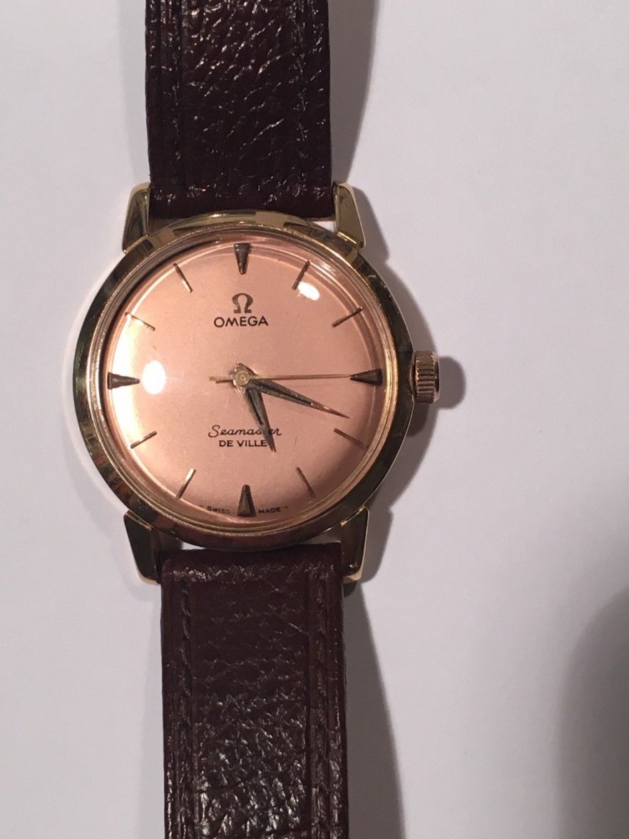

You are basing your stance on many rocky assumptions. Firstly how can we assume the dial originally said DV when no other 2846 with it has been seen. Secondly the 15m serials ran into 1957 so your certainty over date is also flawed unless it is a particularly low serial. You haven't stated why you are so convinced the dial is solid gold. That is occasionally seen on Constellation models but not to my knowledge Seamasters, even solid gold cased ones from 1956/7. I have one by the way, a solid 18K 2846 with a non chronometer 501 movement so am not just pissing in the wind with my comments. You say you don't want opinions but facts. Well the learned opinions on here that there were no mid 50s SMDVs is rather telling. Yes it may have had such a dial in your memory but I bet it didn't leave the factory like it.
Fair enough,
Fair enough. When I had the watch apart, I was looking for a way to remove the face, have always liked taking things apart and putting them back together, didn't see any way to do so but, did see that the back of the face was gold. Not brass, not bronze but gold with machining marks on what I could see, which granted wasn't much. Don't currently have $200 to spare for some papers from the factory but when I do, I will just because I like to know stuff. Going to keep digging. Thanks for your input, still digging.

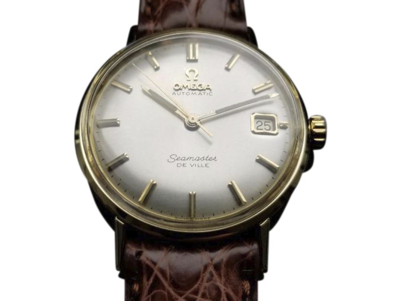

Hey, I found another (refinished) Seamaster DE VILLE dial on a not Seamaster DE VILLE. 😁

This is perfect - now the OP knows how his watch can look in the future. If only we knew who refinished the dial ...

Ew! Didn't look like that, looked more like this, very fine script, Swiss made below the six marker. Very fine lines for seconds.

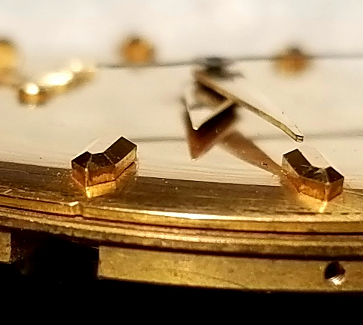

Pulled it apart again, here's a pic of the face/dial from the side. That's gold. In the early sixties, when gold was relatively cheap, it's quite possible the face was upgraded from a gold "De Luxe" to a gold "De Ville" and I would have been too young to notice. I do notice now that all the De Villes I'm seeing have skinny legs... The upgrade would have been done by Omega however so does that make it a franken or an original?
I've also noticed that unlike all the De Villes, the hands are stubbier and do not go out over the hour markers. Learning as I go.

I can only agree with the rest of the guys here. Your watch is not a De Ville and has never been a De Ville. Period.
The fact that the watch had work done doesn't make it less of an heirloom, and its definitely a great way to remember your father!

Can't see the back of the dial unless there is a spot through the movement that isn't obvious to my eye. The thickness of the face and its obvious makeup should be clear. Have a pictures of a different form of gold face? I notice much cynicism in the forums, everyone is quick to shout 'fake' or assume that there is something underhanded afoot when something that doesn't fit the mold pops up. It is interesting to see that the evidence does appear to point to a refacing in the sixties, it was certainly not a hack job and was, knowing my father, as a result of regular service from omega. He use to complain about it being expensive but, he loved his watch and saw that it was well cared for. In the 80's maybe earlier, we lived two doors from a watch technician, last name Kalmar, had the hots for his niece, who took care of it for years. I believe he has since passed away. Was fascinated by the little machine that he used to set the speed with its little ticker tape output. Notwithstanding, the watch was never in the hands of a butcher, until me anyway, and has been serviced only by qualified craftsmen. Rather inclined to see what Omega has to say about it, maybe a Christmas present to myself.

Noticed something in your picture here:
There is a notch on the dial. These were generally made by rediallers in order to re-orient the dial properly once the original printing was removed.
Not saying that I have any proof that this is what happened here.
All we can do is make conclusions based on the evidence presented. The more evidence, the better the conclusions.
Dials are typically made of brass, so the fact that it is gold in colour does not mean it is actually gold...
Absolutely no one has claimed that your watch is a fake. No one has been cynical either. They have simply told you the truth about your watch, based on their years and yeeeeeears of experience in the field.
