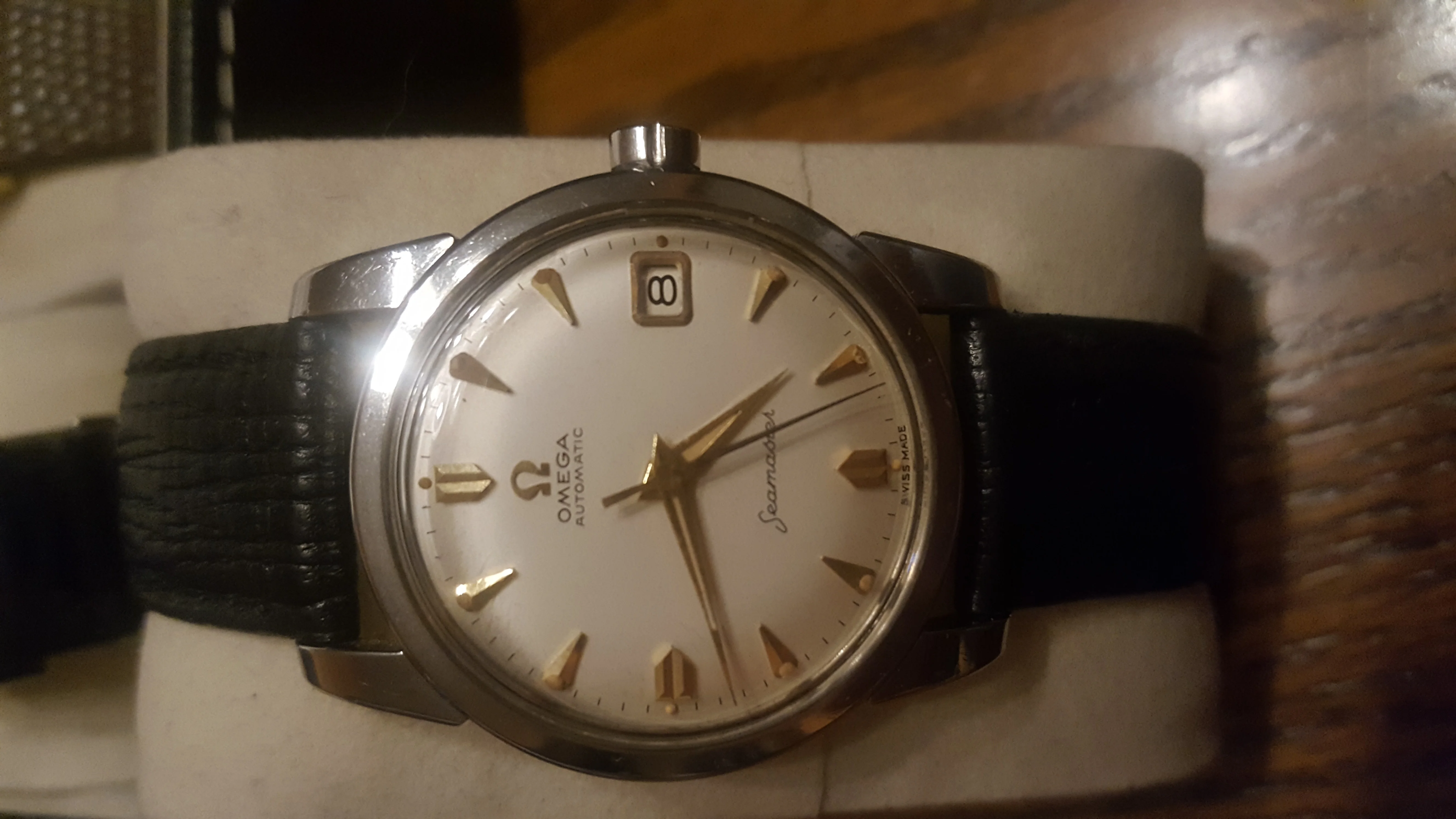

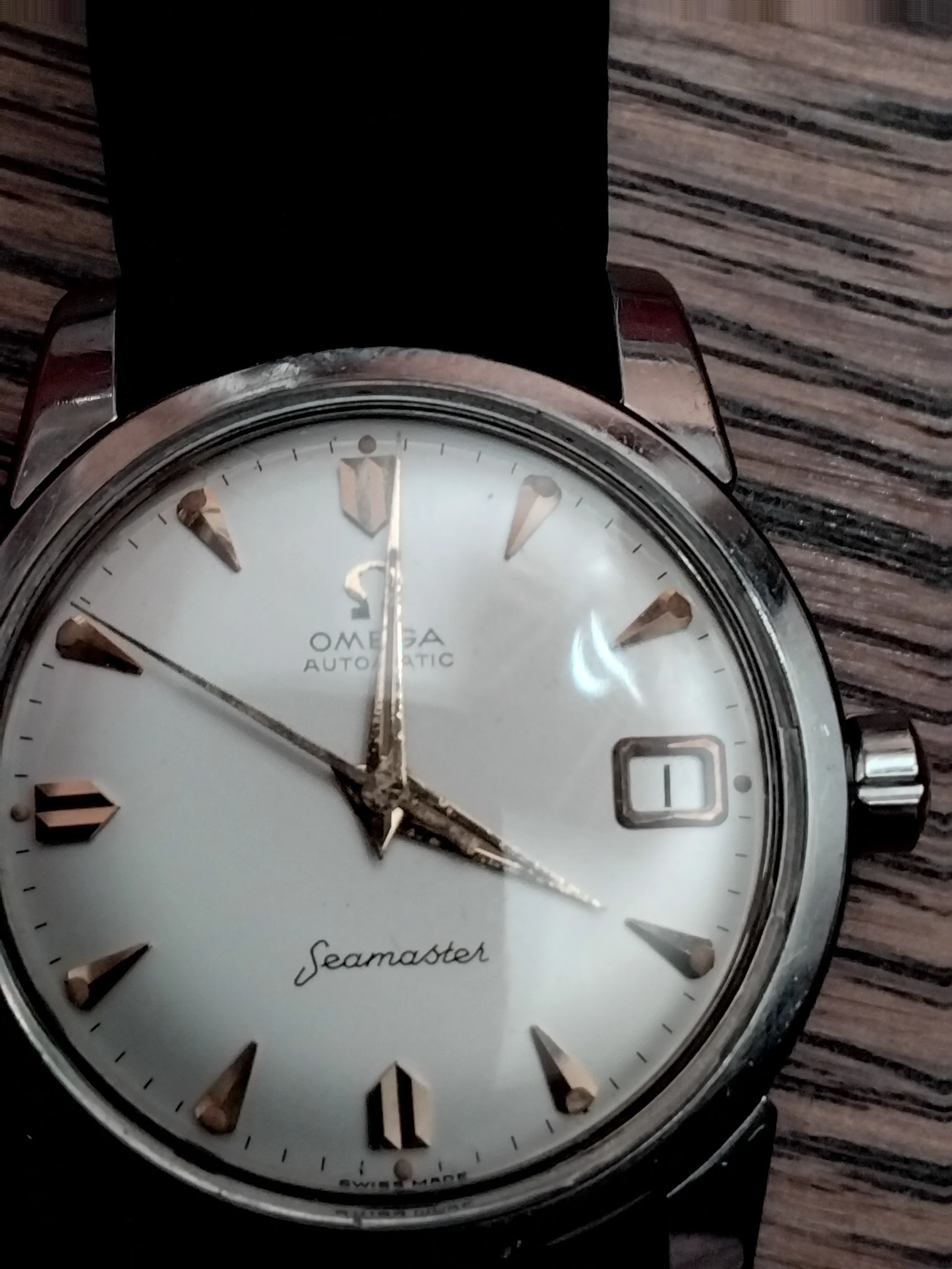

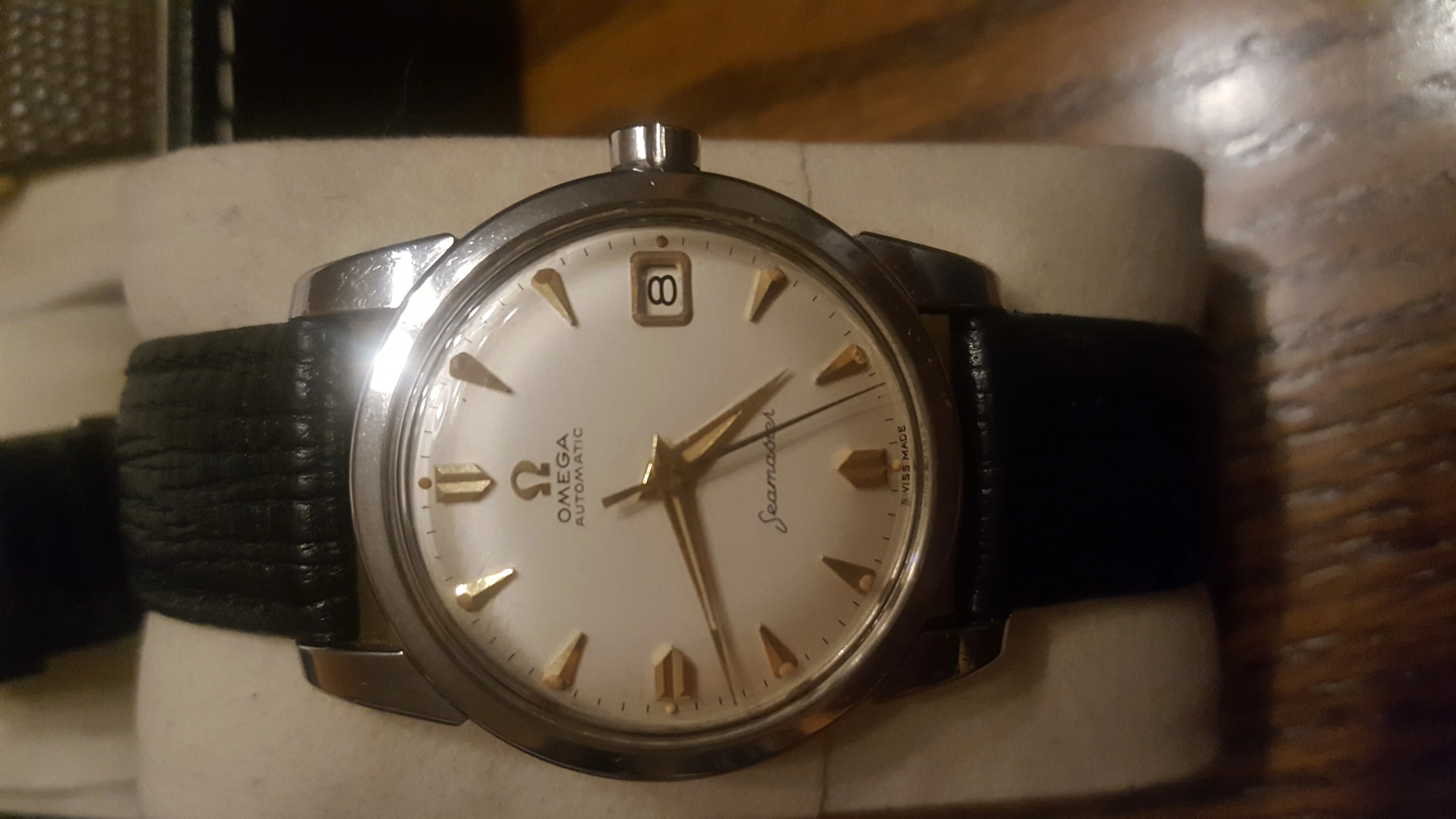

Hi to everyone..I'm new today and have posted this thread on another site in the group but don't know if ifs gone through..I'm Internet illiterate TBH.My questions are..it has a 505 movement which I thought went in constellations ...it has a date window but doesn't have calendar font on dial...it looks like it's original radium is still present in blobs of now caramel coloured lume...any info would be great..many thanks

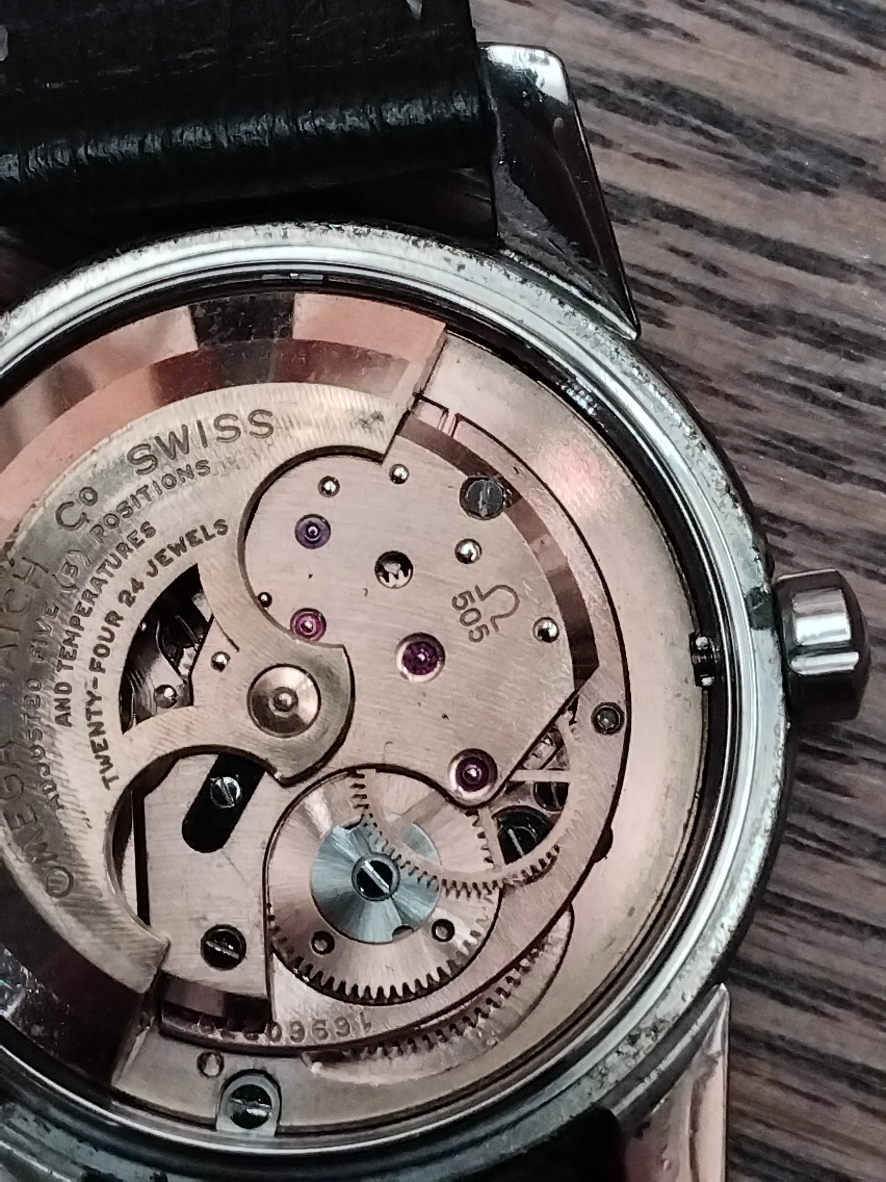

Thanks again for replying..there a photo at the top of the thread...this is my worry that I've bought a Frankenwatch

THe photo of the movement folks are asking for is to pop the back off and show it. As they've mentioned, if you have a real 505 movement in there then you DEFINITELY have a frankenwatch (or a fake!) since that movement doesn't have a date.

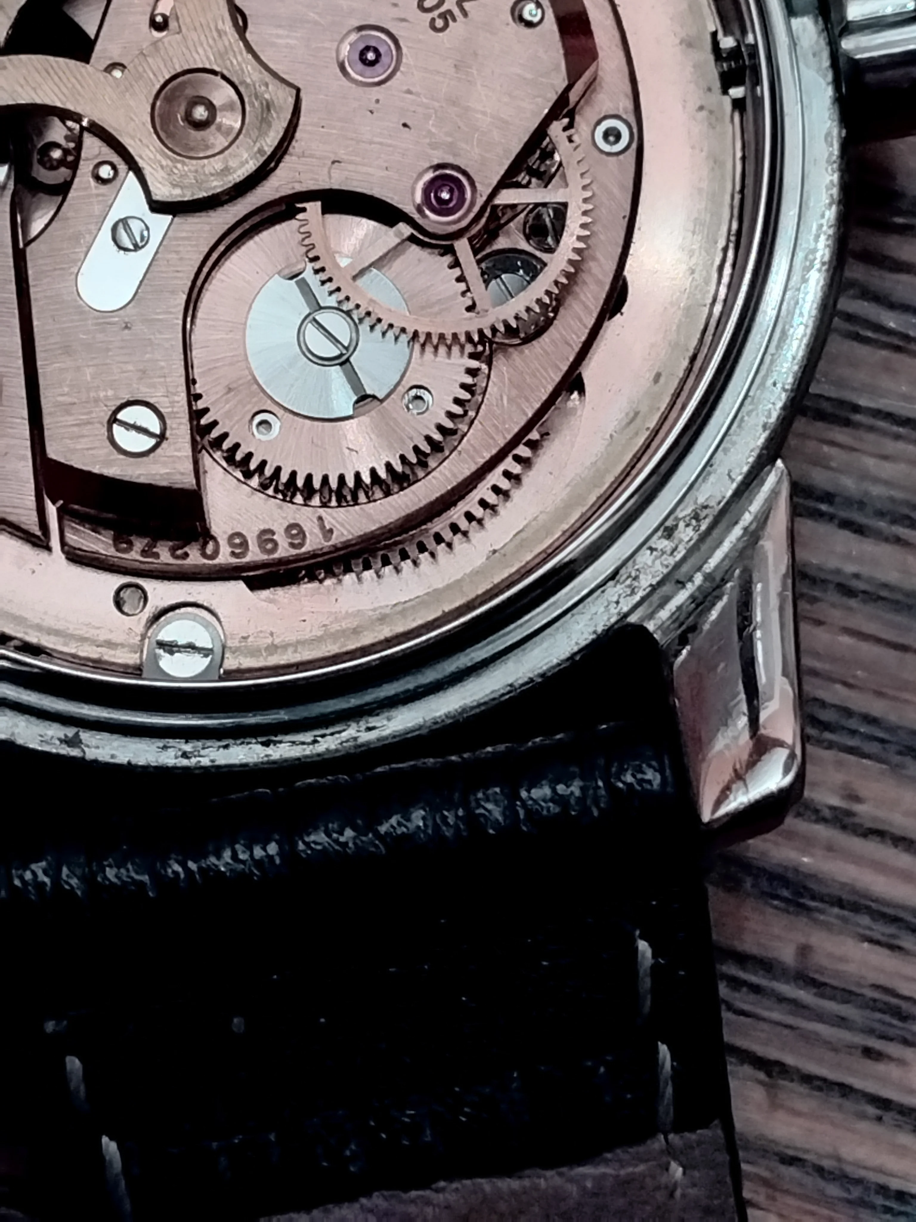

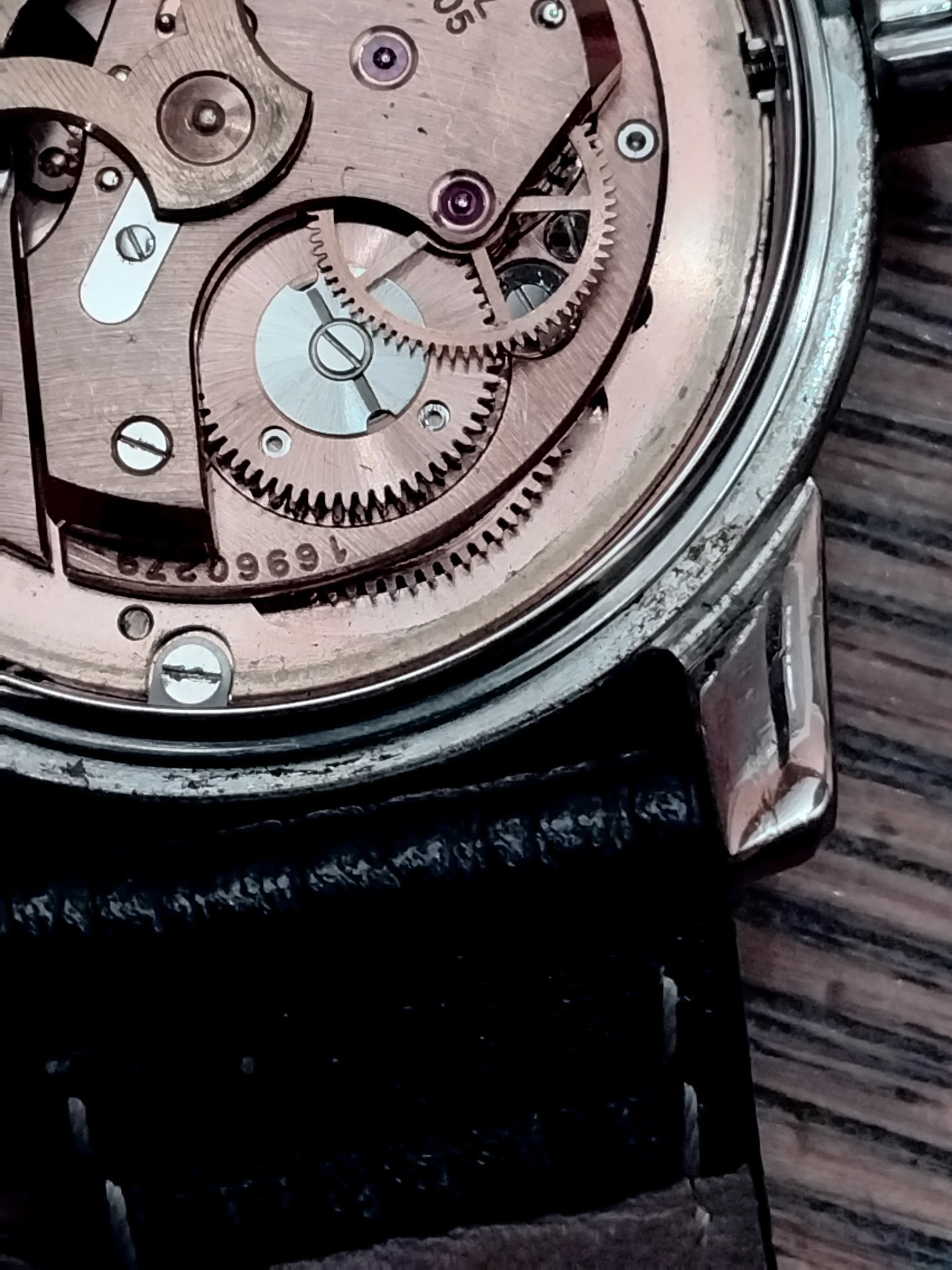

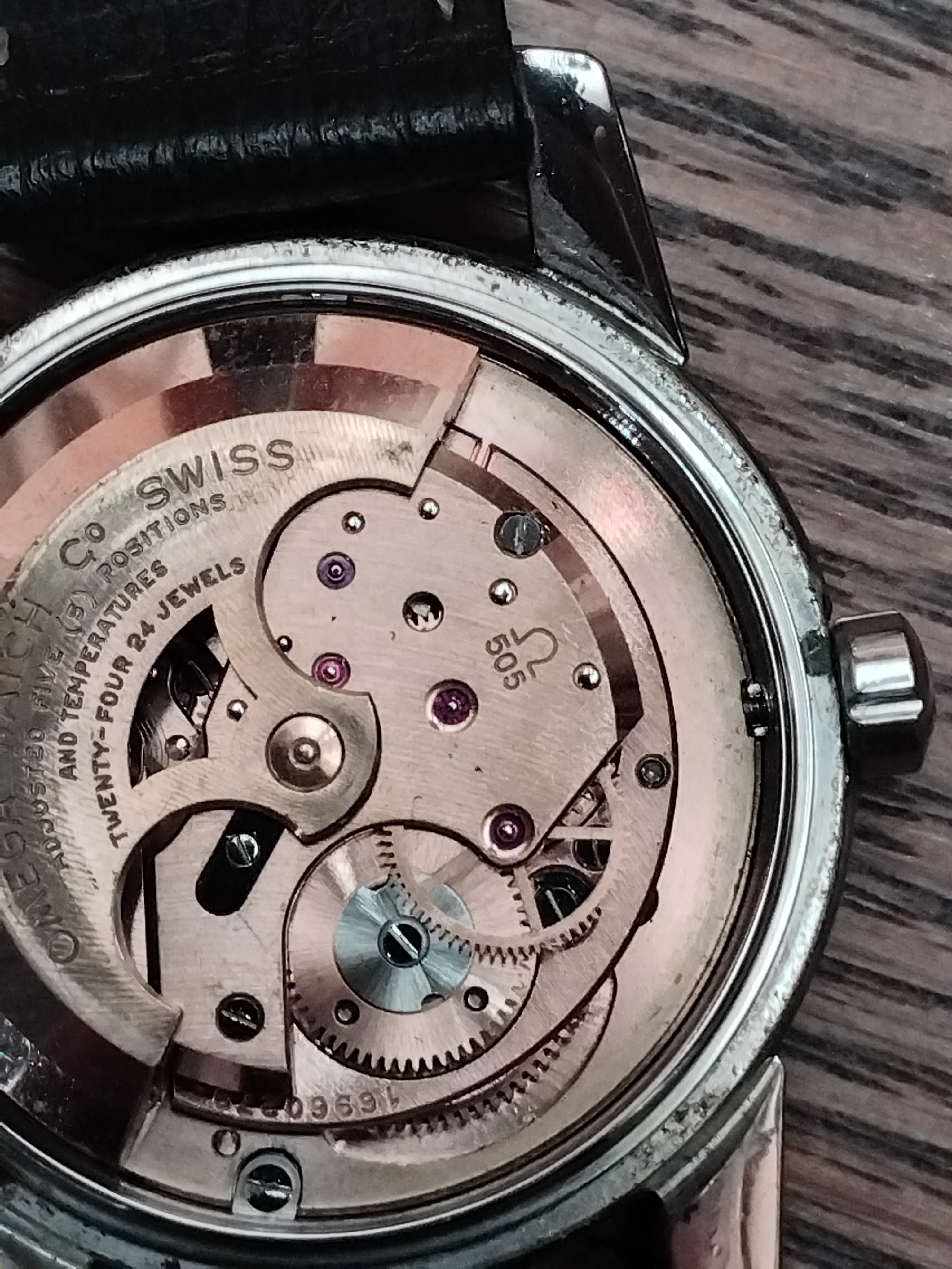

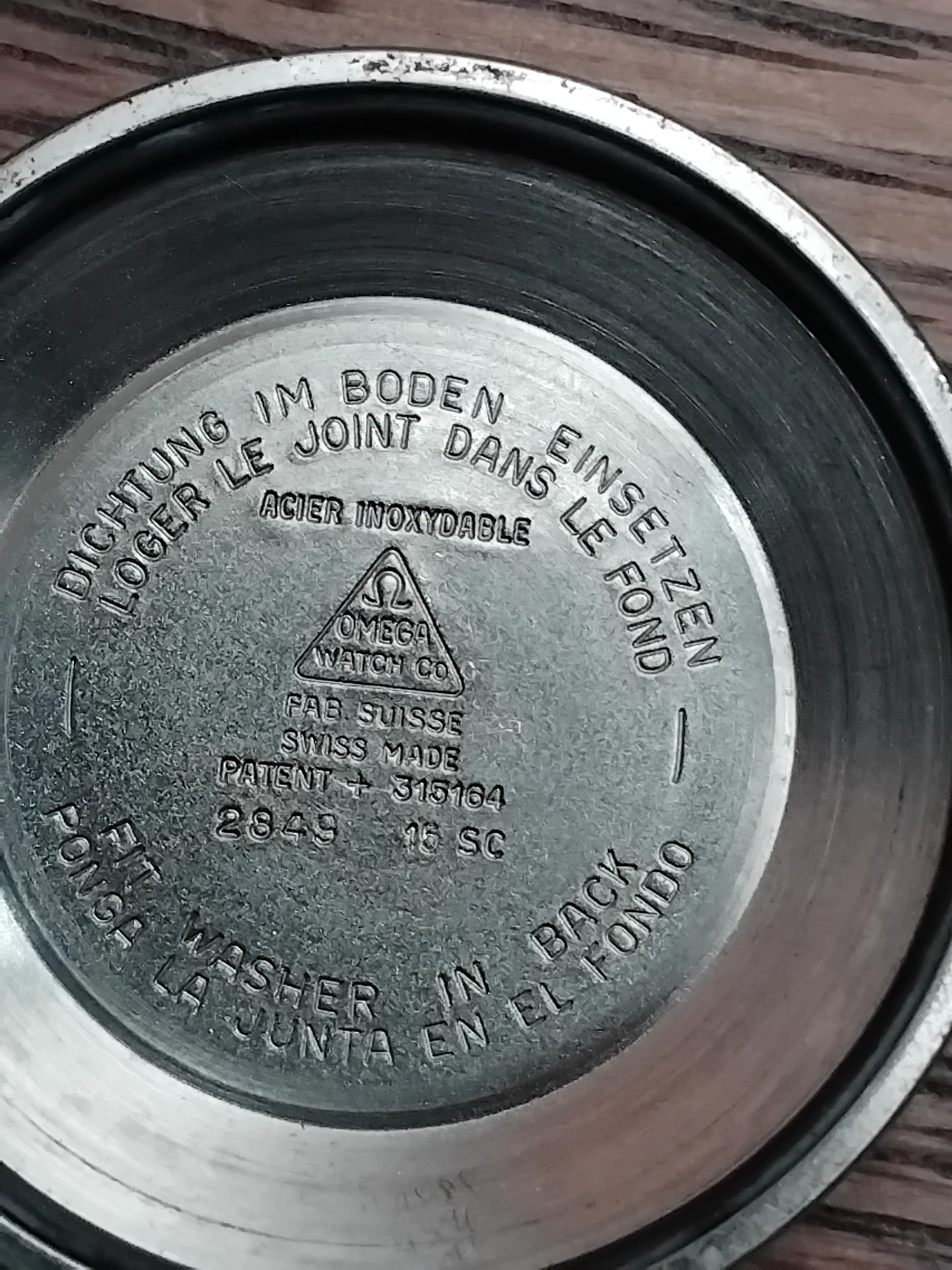

Here they are
Actually ..cross checking the serial number it's a 1958..so the jewellery got the gead wrong as well...it's a good10 years since I bought if so I'll not be returning it.. you live and learn..I'm glad I've asked you all anyway.. many thanks

It seems to be basically a correct 2849 re case/dial/crown/hands, but powered by a chronometer-grade 505 modified to have a date. Strange watch.

Could it just be a bridge swapped from another movement? Are there any similar movements that would have a date?

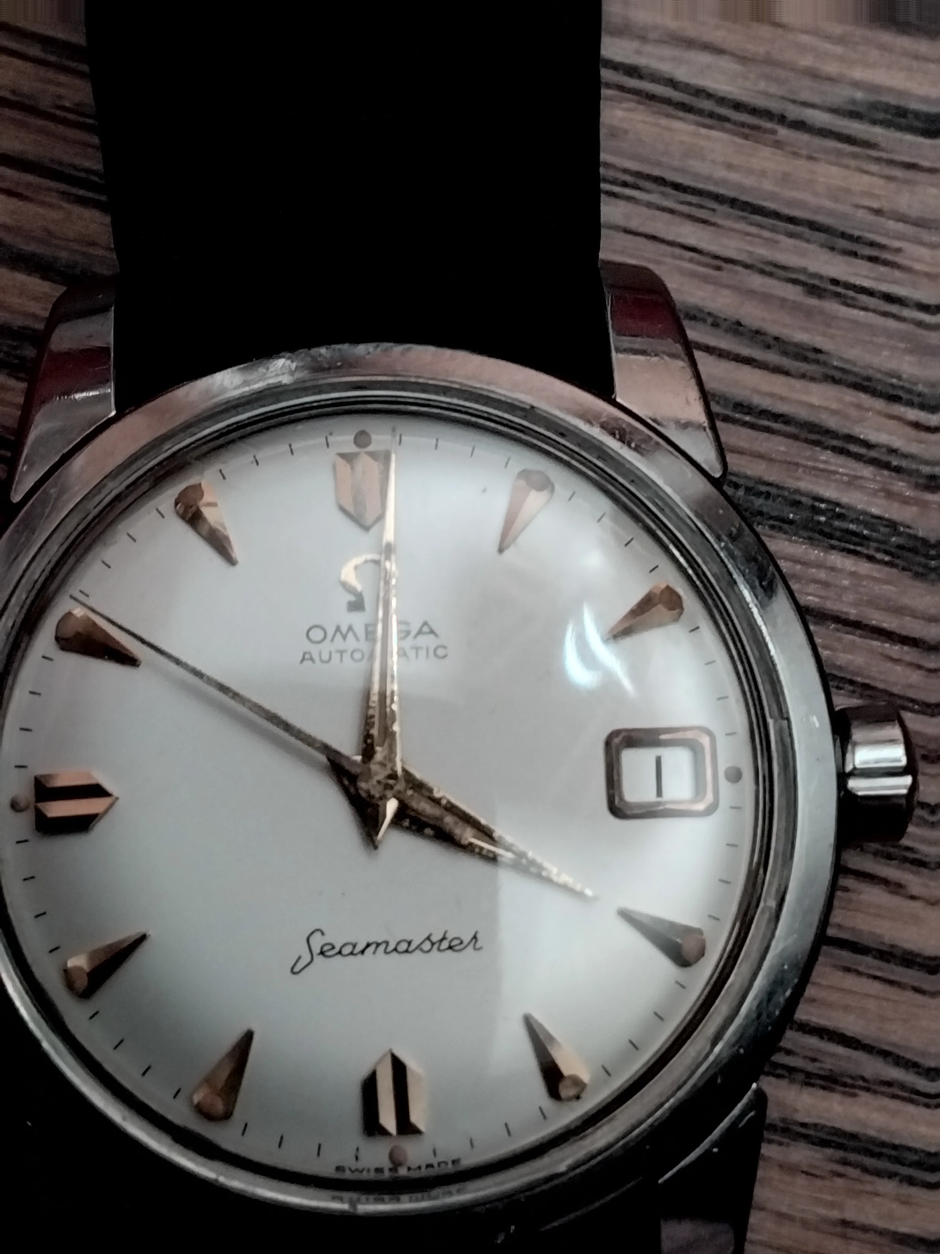

It looks like it's still got its radium so I don't think it's a redial as such but obviously it doesn't have the calendar font which I find odd.Its also got its Omega symbol on the plastic crystal and Omega crown..so it's not like it's a real butcher job other than the obvious 505 on the bridge.

The rotor and bridge were swapped from a 505. It was a 503 when it left the factory.
