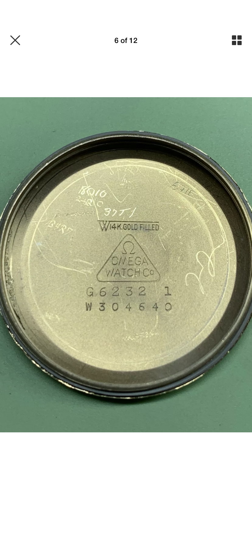

Hello, this is my first post but I’ve been lurking for a long while. I just purchased this 1952 Omega Automatic and would like your opinions and help. I don’t care about value as I don’t intend to sell it but more the background story on it and the movement and your opinions as to it being from the era or if it’s been changed along the way. From the serial number I was able to find that it was made in 1952. I tried using the numbers from the case back on Vintage Omega but nothing came up for me. I did see that some models of this year were Seamaster models but did not have markings on the face. I don’t care much about it being one or not, but would like to know how water ressistant this model may be. I don’t plan on swimming with it, but if moisture getting in is something that I should be concerned with I would like to know. I tried searching for tips on caring for the watch but I did not find much general information as I guess that would vary by model. The watch shop that I purchased it from just did a complete service on it. Any help or information would be highly appreciated. Thank you kindly!!

Show the case back...this will clear up how it’s attached. If it screws on, there will be notches for a tool. If the case back has no notches, it will be a press on back.

Wadsworth made the G6232 in two versions, a straight screw back (with notches) and a press in back with a screwed retainer ring. The issue with water resistance will be the condition of the mating surfaces of the case/back, was the gasket replaced at time of service and was it the correct type. Either of these screw cases would use a flat nitrile seal (perhaps lead originally) not an o-ring as seen in the photo. Also the condition of the case tube and whether or not a new crown of the correct type and size was fitted.
