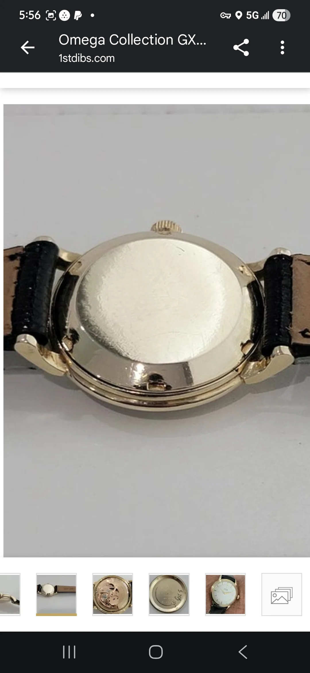

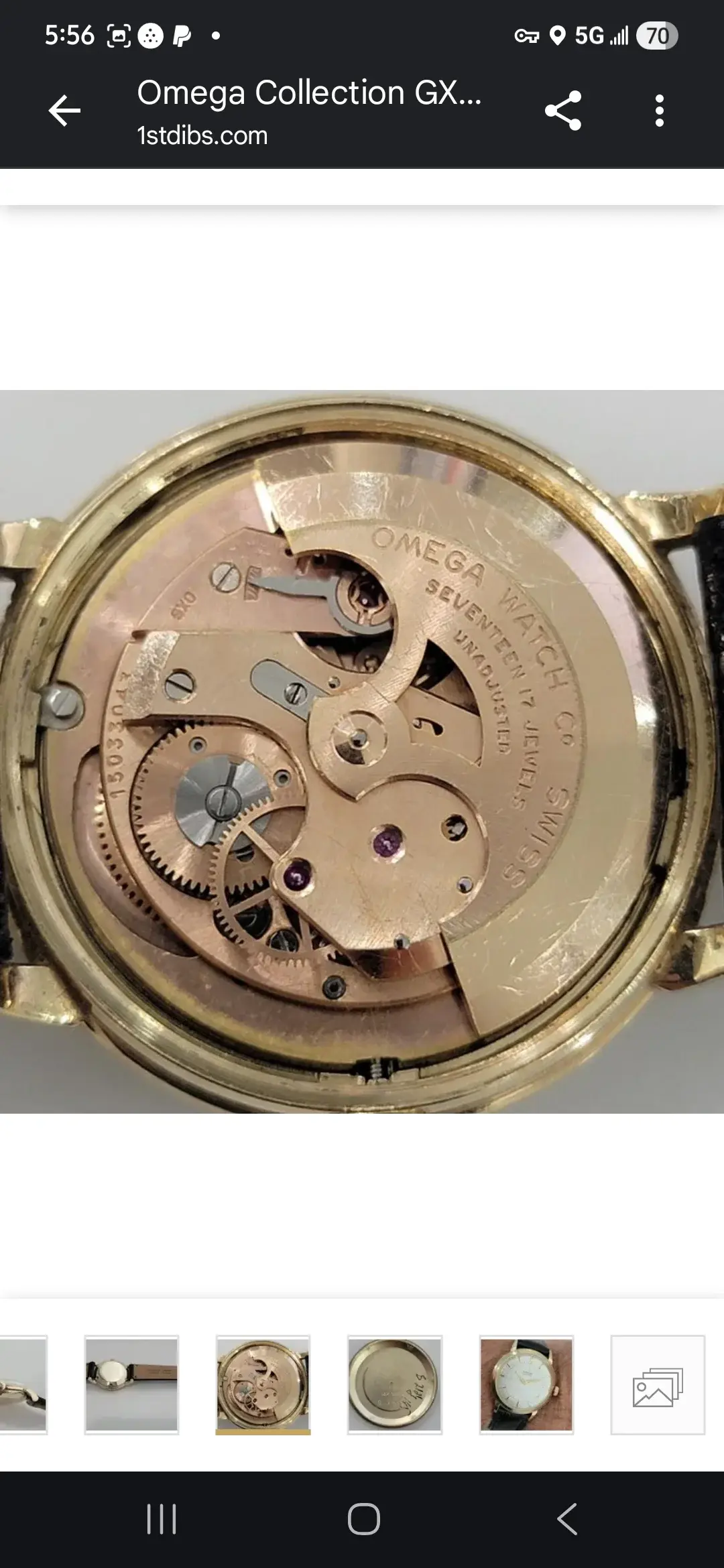

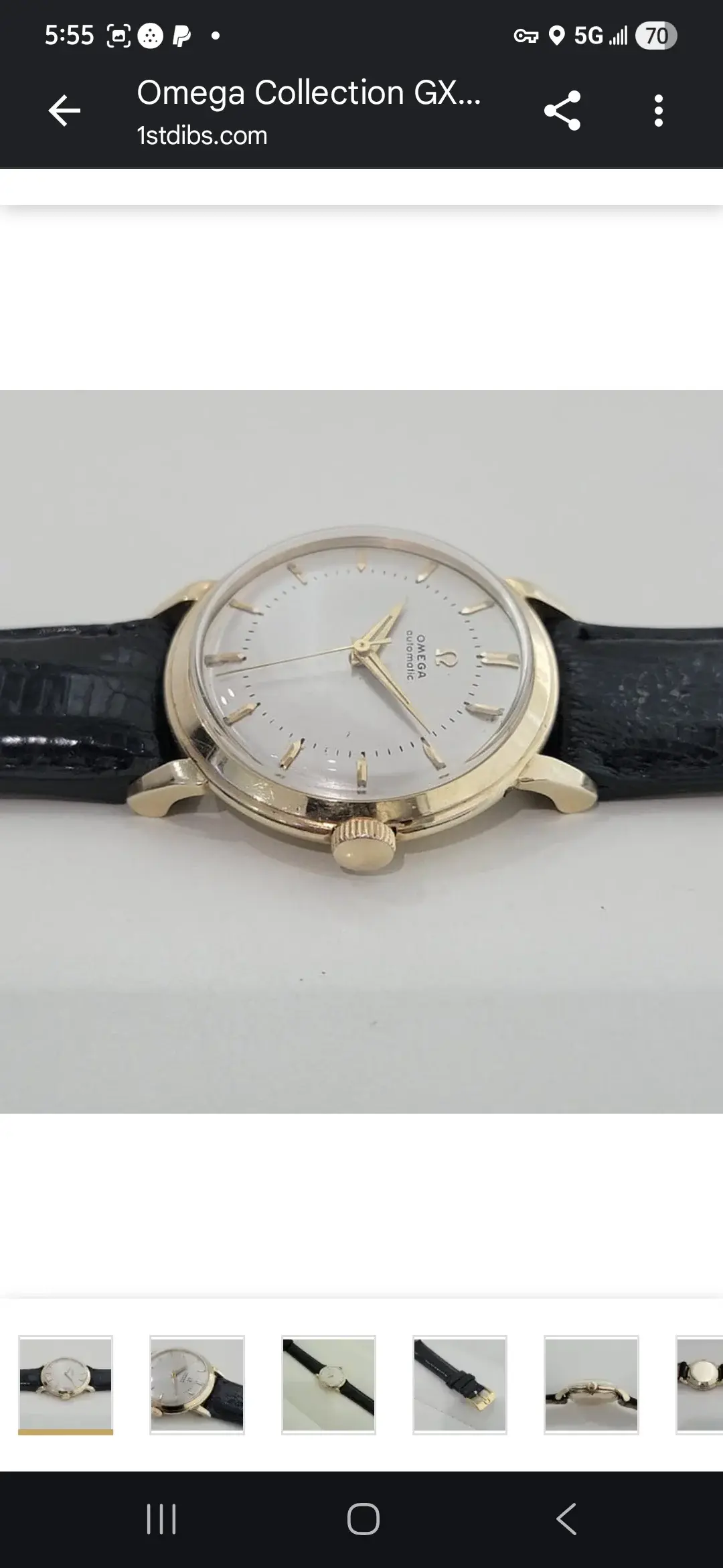

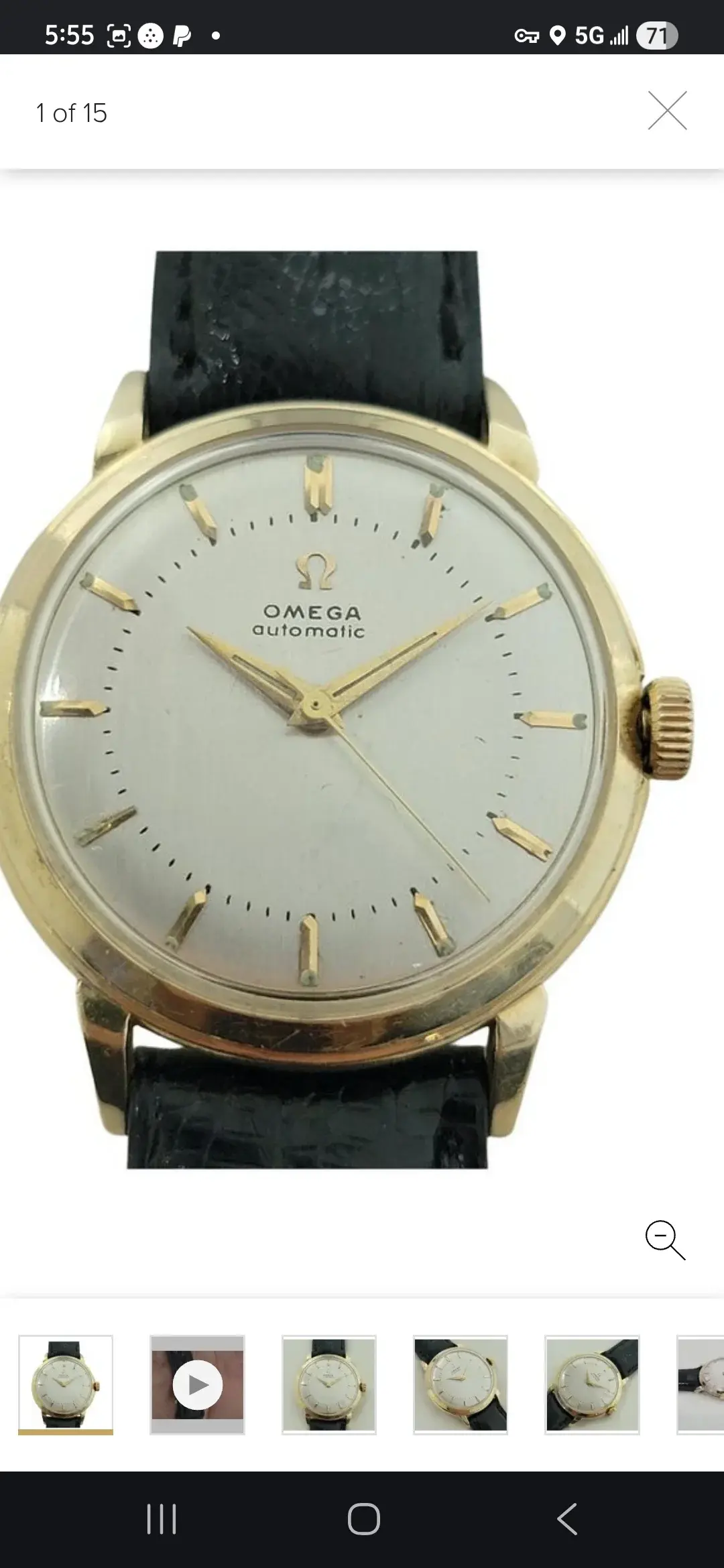

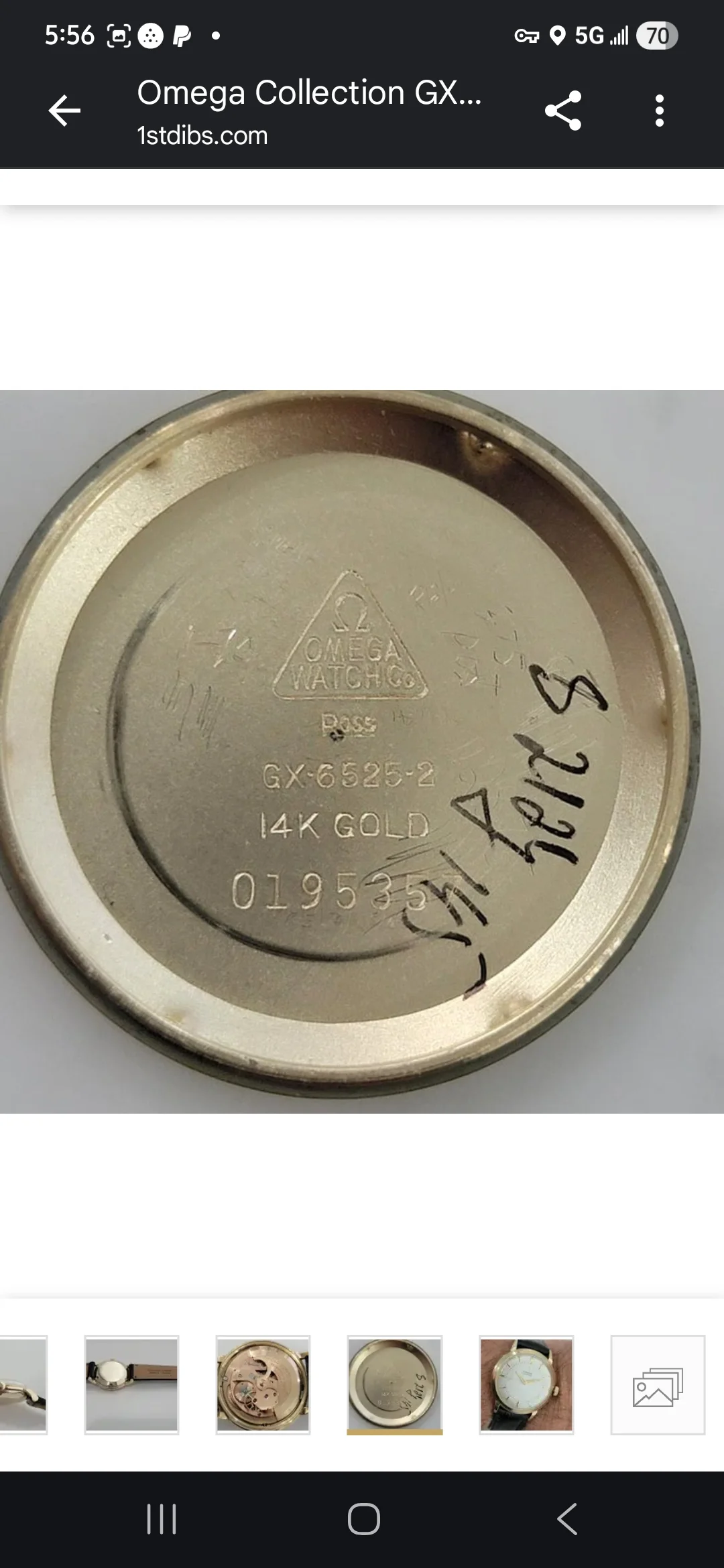

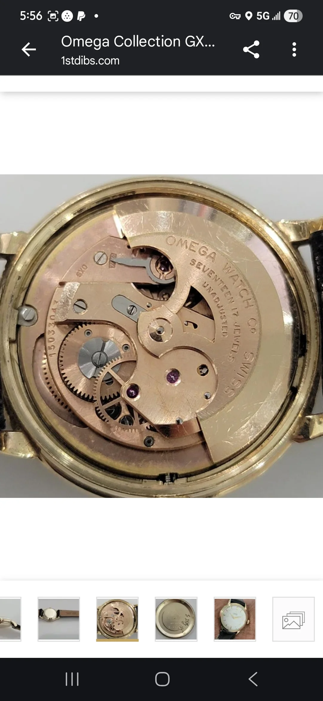

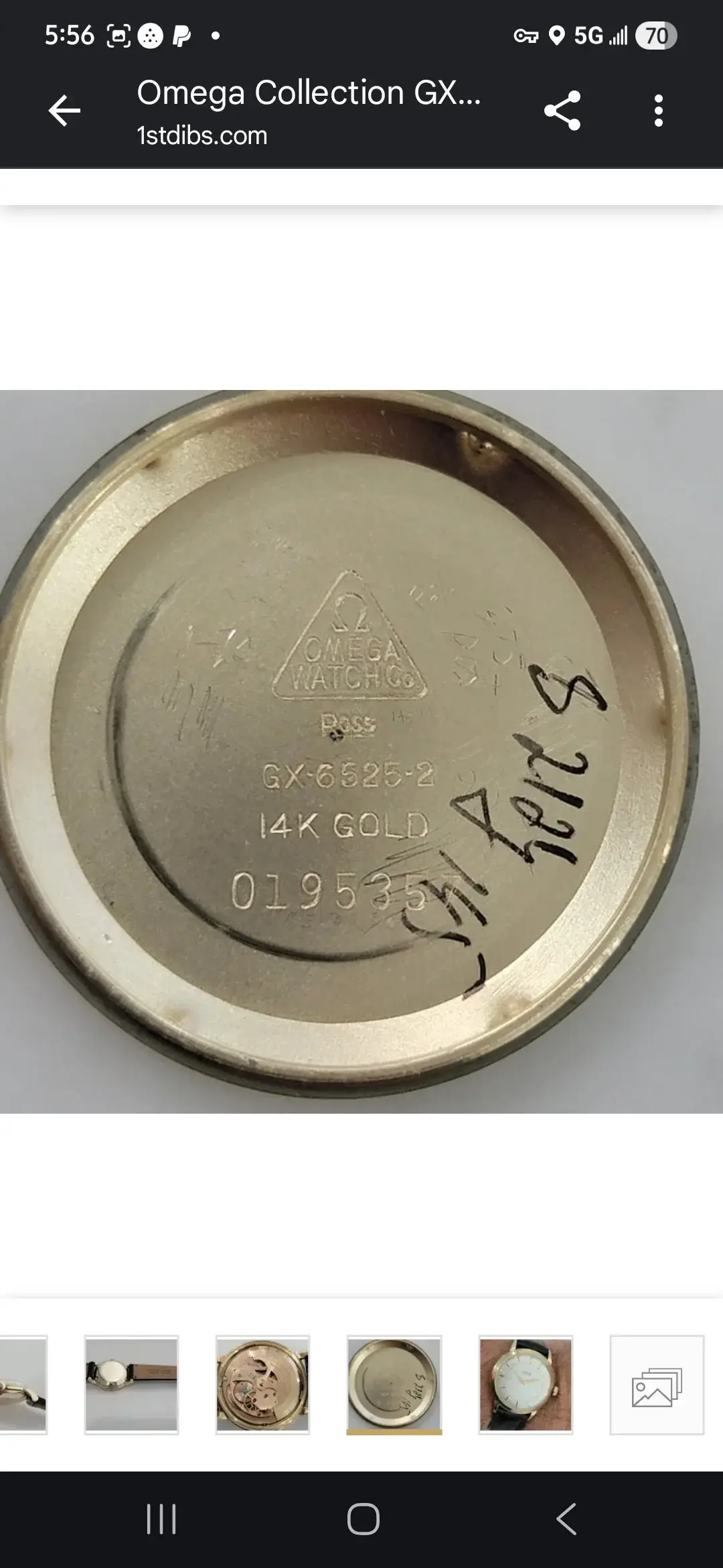

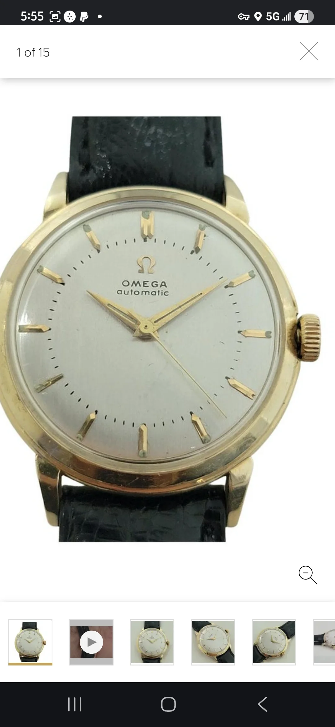

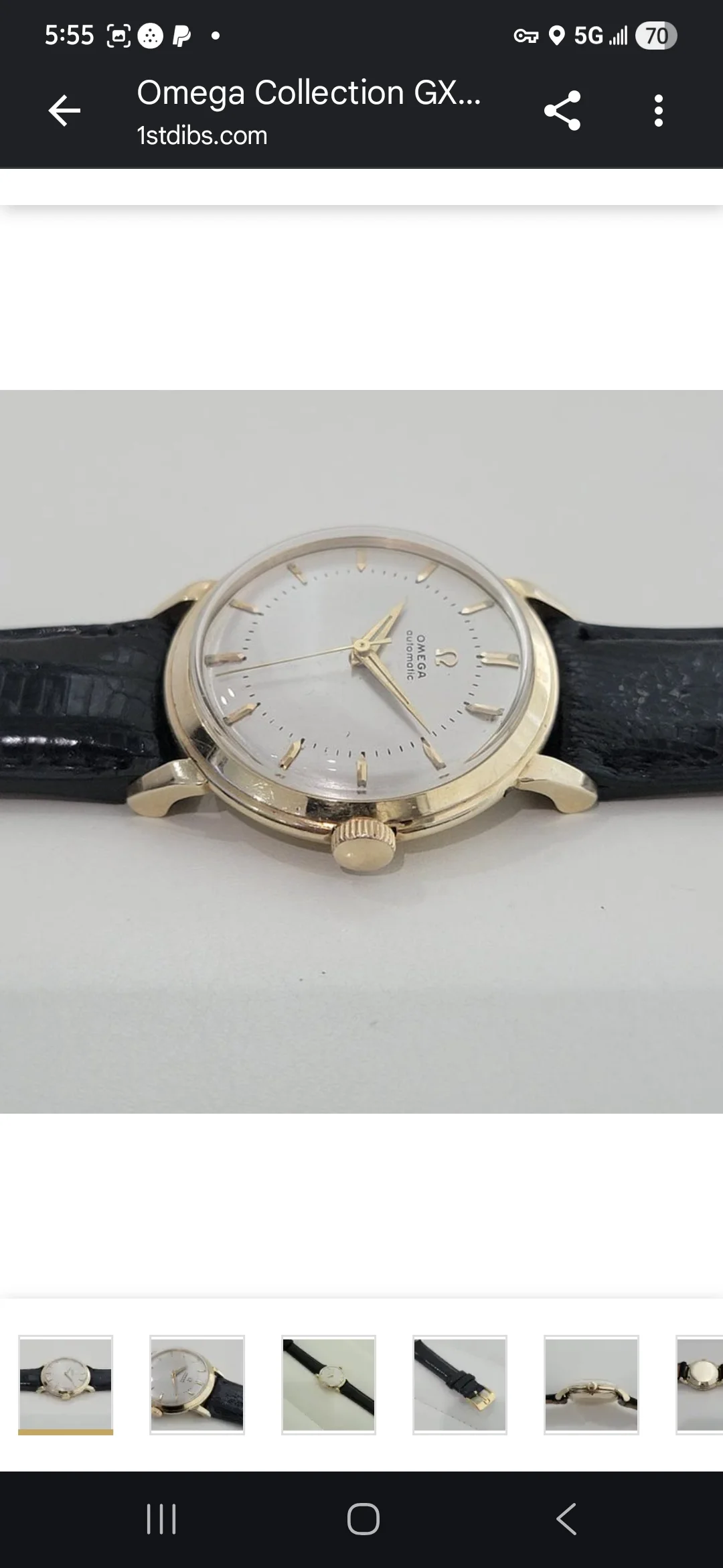

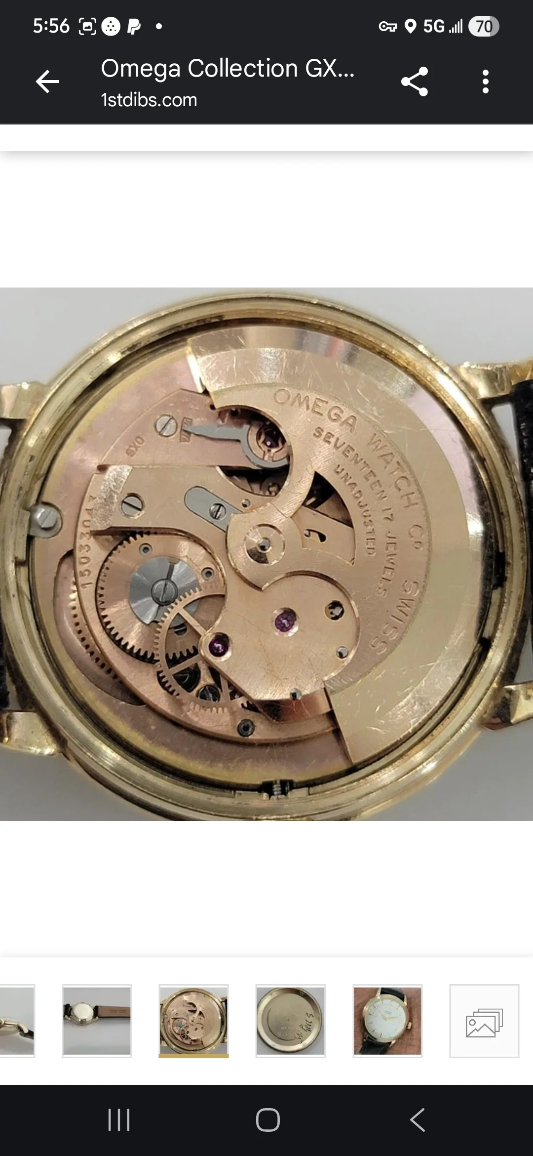

Nice classic Omega bumper in a 14k US-cased Omega Watch Co. case (GX-6525-2). However, the dial appears to be a redial - printing and minute track look inconsistent with original factory examples, and the lume plots appear replaced. Radium in the past? The movement also shows noticeable dirt/oxidation and does not appear freshly serviced. Solid vintage watch overall, but originality and condition don’t seem to support a premium valuation. I know gold is up but this price is unrealistic. Aftermarket crown?
Of course welcome thoughts and opinions.

Shockingly bad redial, didn't investigate further.
24,837
55,259
Yep, dial is no good. 🤮
Melt value + $150, IMO. Do you have a good dial to replace it?

For learning purposes, you can tell this is a redial because:
1. Applied gold indices do not align with the printed hour markers
2. “Omega” font is off
3. Missing “Swiss Made” or “Swiss” at bottom of dial
In particular, most “Omega” logos in 1950s-60s watches should look identical. This won’t rule out a redial, but if you familiarize yourself with the logo it can help you spot the obvious redials. Most redials get the font wrong.
