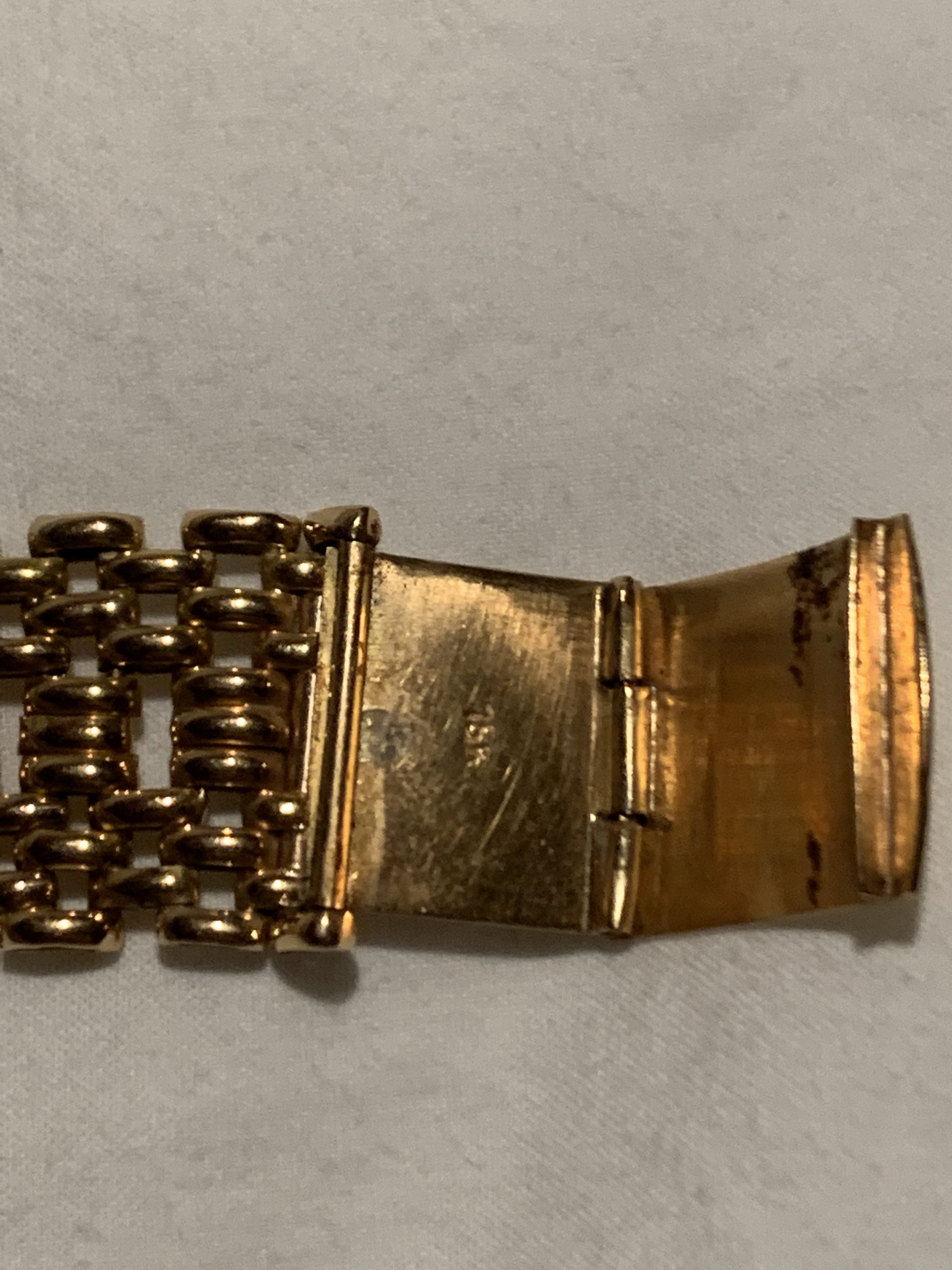

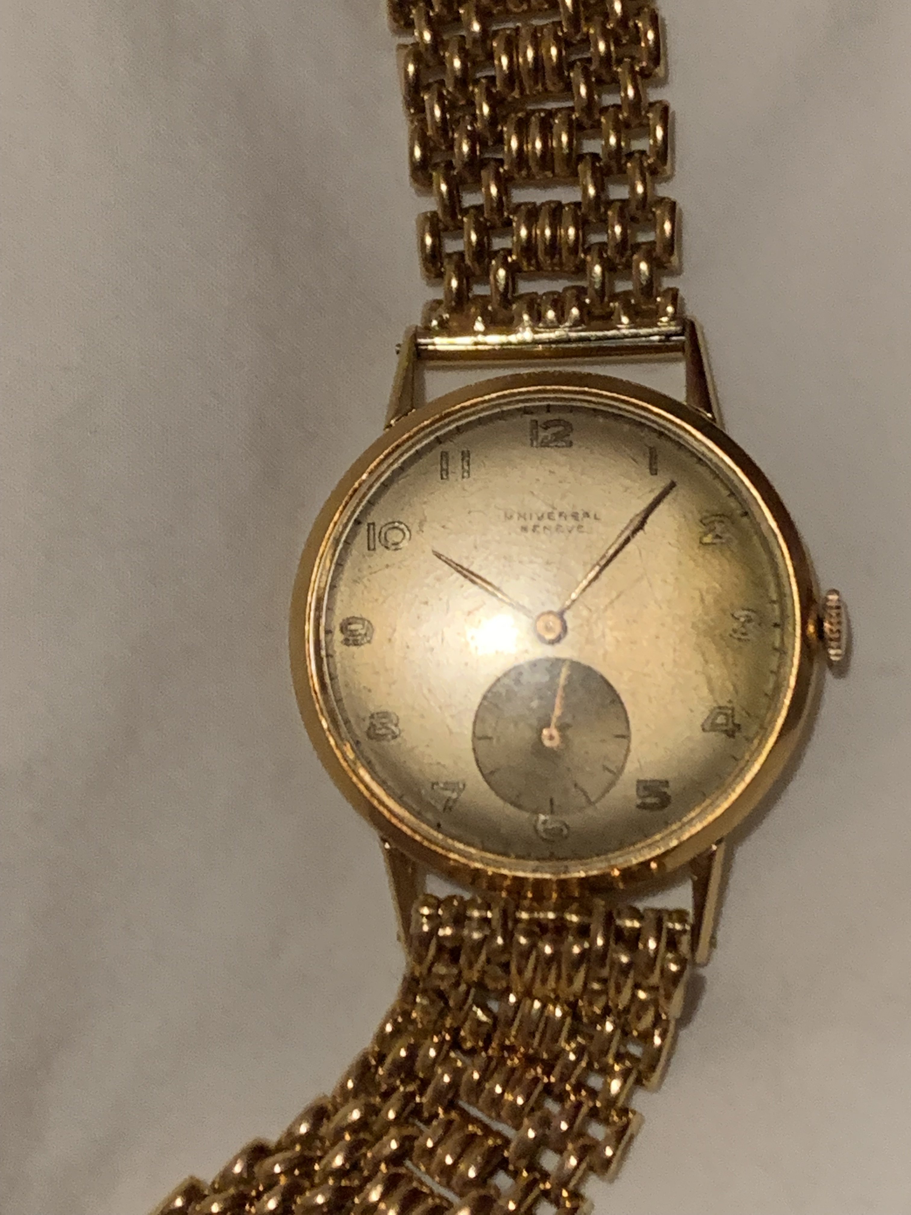

I have an 18k gold watch that appears to have been made in the period between 1946 and 1949 based on the serial # (starts with 135). This is consistent with the history of the watch as it was given to my grandfather in November 1951. The model # is 112140 and the first three numbers are consistent with the standard model numbers at UG. The first "1" indicates that it is an 18k gold case, the second "1" indicates that it is a time only watch, and the third number ("2") indicates the calibre (either 281, 283, or 481). The final three numbers would suggest that the case design was a "140".

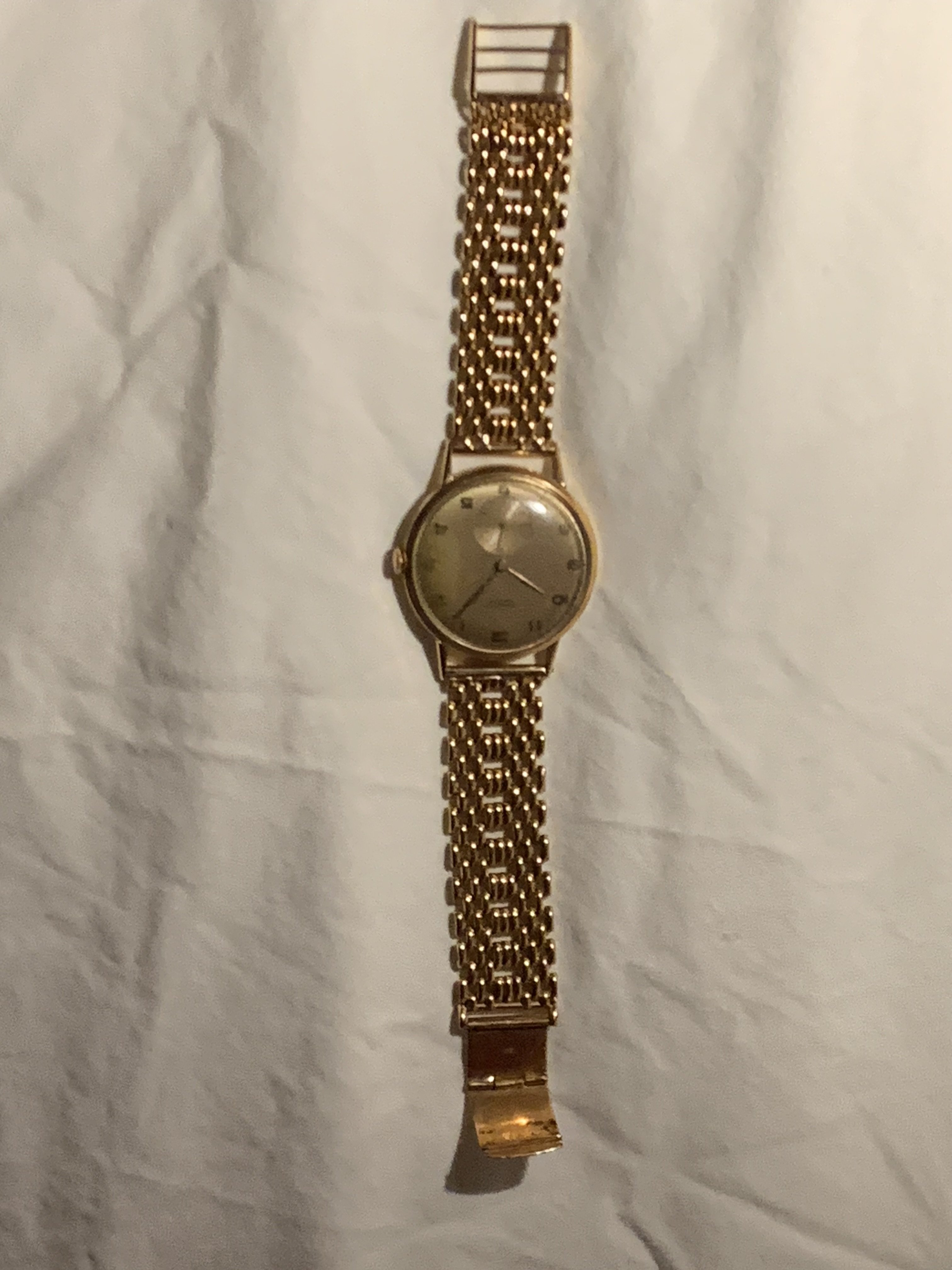

It was given to my grandfather (who lived in Newton Massachusetts) by the husband of a patient of his. Frustratingly, my father (who tends to hoard lots of useless things) did not hold onto the links when he had the bracelet downsized for his wrist. Now I would like to expand it for my larger wrist and I may have to have the links custom made and it could be quite expensive.
I am curious if anyone would be able to 1) identify the watch beyond what I have discovered 2) provide any supporting documentation for it (or point me in the right direction), and 3) tell me if they have ever come across a bracelet like this one that I could cannibalize. If not, I am wondering if someone might be able to refer me to a jeweler who I could trust to make extra links for the bracelet. I am in Pennsylvania but I go to Boston, New York City and Philadelphia periodically.

Talk to RGM.

Personally I’d park the bracelet, get it serviced and put it on a nice strap.

The point of owning this watch is actually specifically that it is as unaltered as possible (playing into the nostalgia part of it being a family heirloom). On the rare occasions that I do wear it, I would rather wear it the way my grandfather wore it even though my style tends to be more understated.
Also, who is RGM?

RGM Watch Co. Mount Joy PA. They make fine watches and do restoration..

Try reaching out to Rolliworks about the bracelet, while they’re typically more well known for their work on rolex bracelets, it could be worth a call since its one of the few shops that are consistently recommended for bracelet repairs/restoration/etc.

I can't help with the bracelet but your interpretation of the reference number is not quite right - I think that decoding only works for chronographs. It won't be a cal 281, 283 or 481 as they are movements for chronographs.
I'm not absolutely sure but I suspect it will be a manual wind cal 262.

Ahh yes. I see my error. I assume I can get the final answer when I open it up then? It is in fact a manual wind.

yes extremely likely to be a cal 262

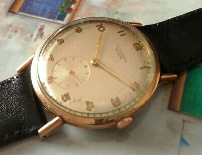

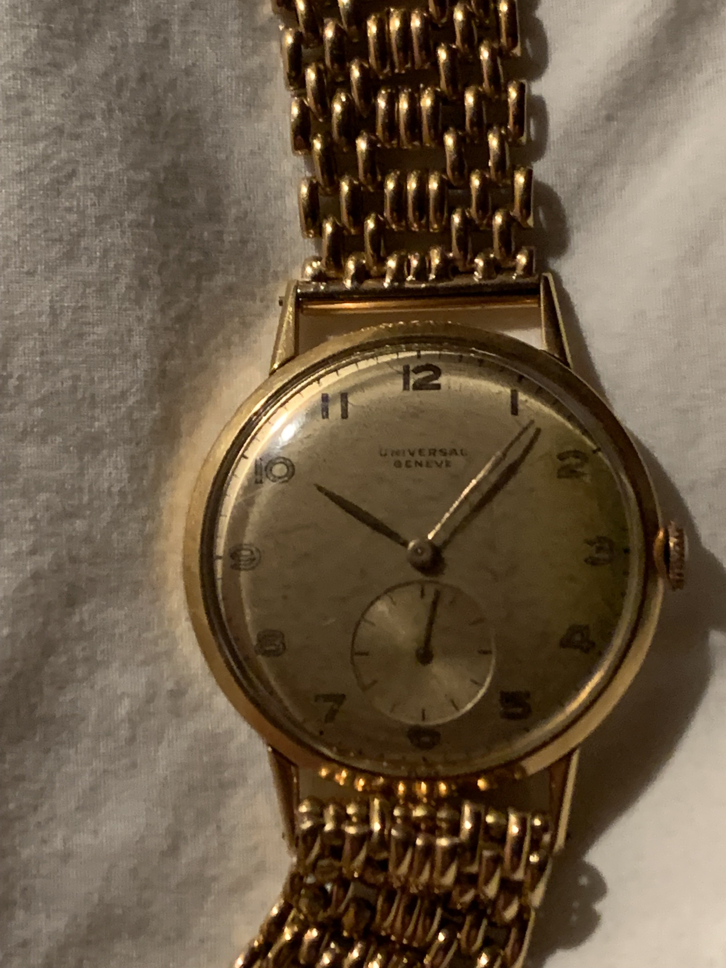

A few things:
1. The hour hand of your watch has been replaced at some point in its life. Probably many decades ago during a service.
2. The dial looks to be nice and original (as it was when sold almost a century ago).
If you can manage to remove the caseback and photograph the movement and inner side of the caseback, we can tell you a lot more. I wouldn't recommend you do this yourself if you've never done it before to avoid risking damage. Maybe go to your local watchmaker. They might do this for free.
I have attached a (shitty) photo of a watch with identical dial and correct (leaf) hands.
Your watch is beautiful and I'm glad your family will cherish it.
