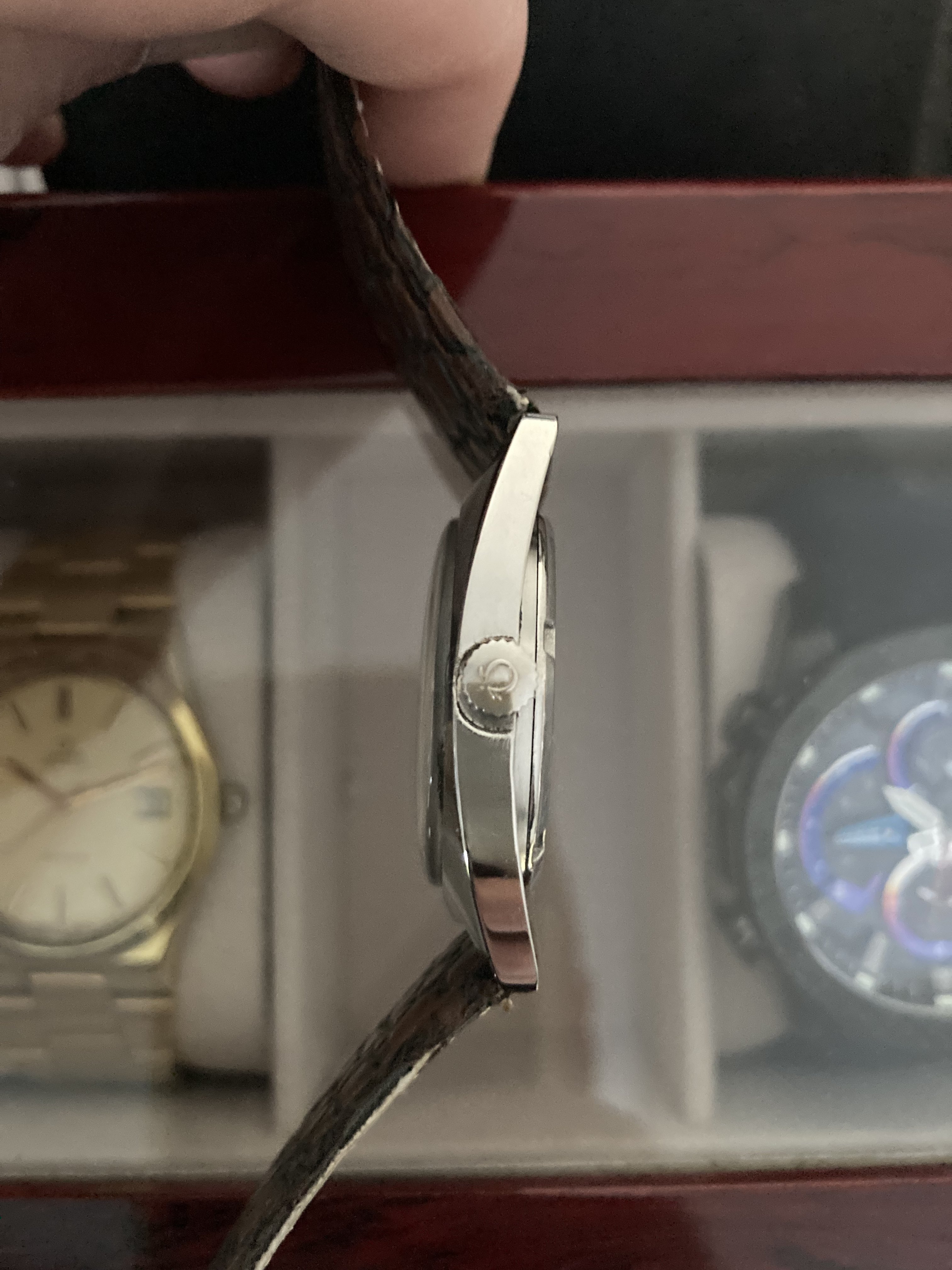

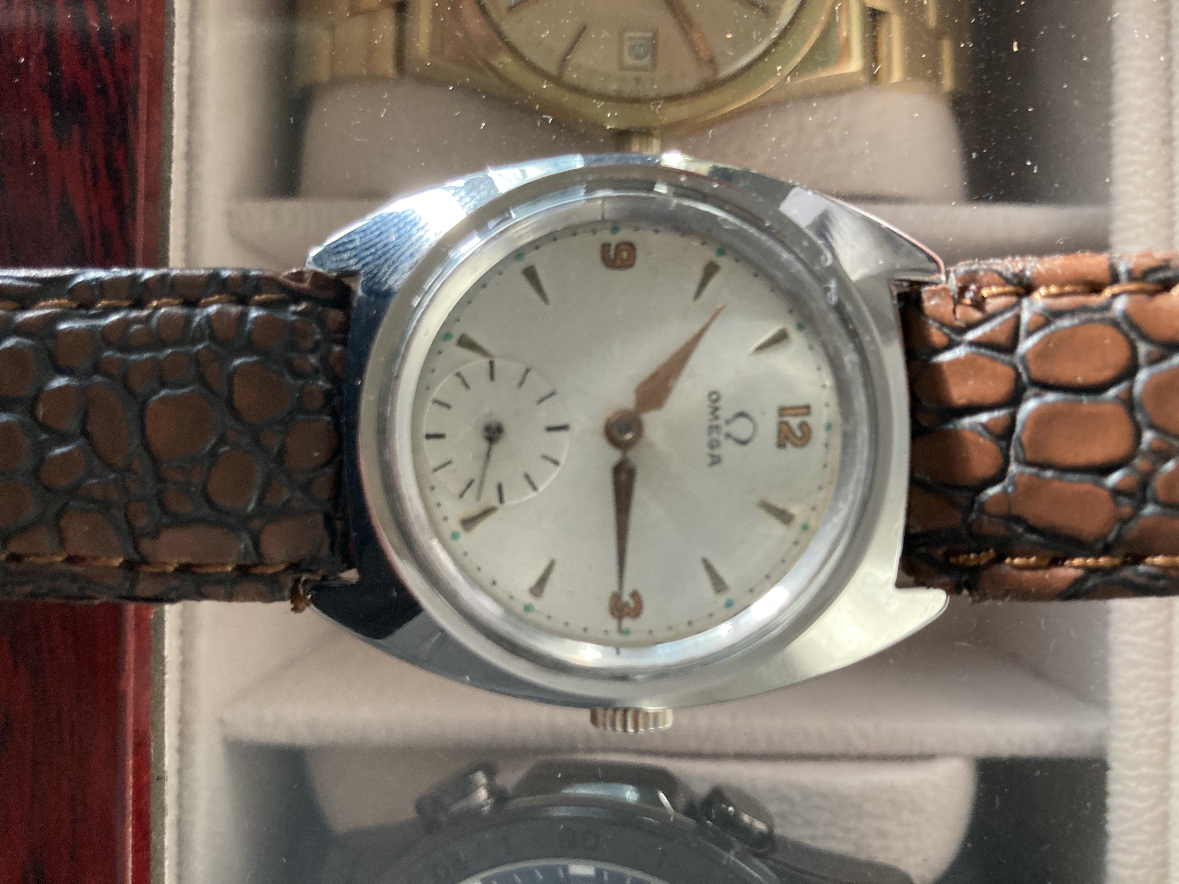

Second is what I believe to be a 1942 Omega, which I bought a year ago for my father. It was keeping very poor time so we had it serviced thoroughly. The watchmaker tells me it has a rare movement which was difficult to find parts for, so he did a manful job restoring the original parts where necessary. I don’t have the servicing paperwork with me but it may be it has more relevant info on there.
Anyway, I’m really struggling to find much info on 1940s Omegas, so I was wondering if anyone would have any insights or information on this type of watch?

If the 1940s watch you're inquiring about is the one in the photos I have serious doubts about it being from that era.
The case is commonly referred to as a "C" case and didn't arrive until the 1960s.
The hands also appear to be incorrect, and based on the photos, I think the dial has been re-painted.

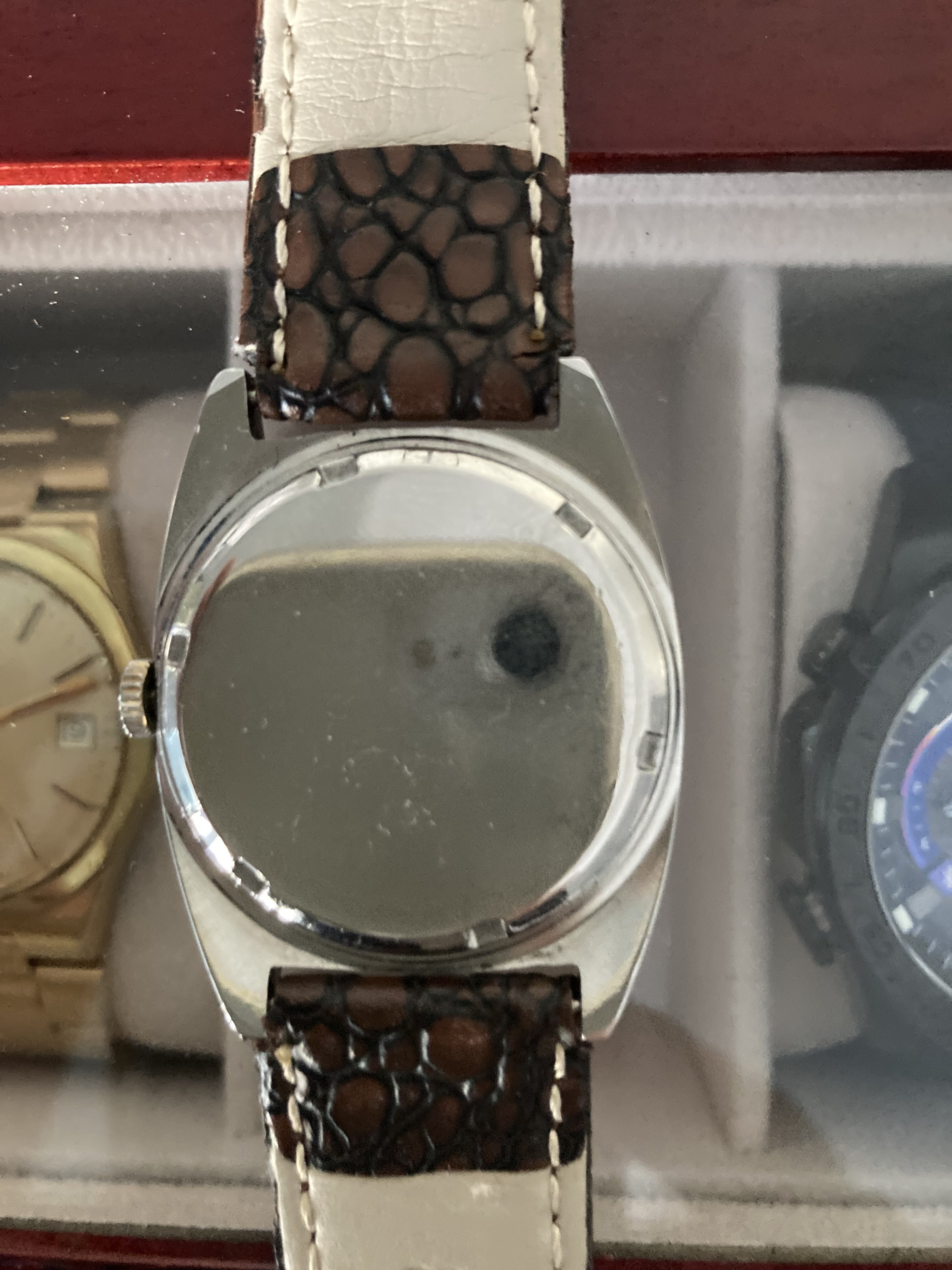

The only way to be sure is provide clear pictures of the movement and inside of the caseback.

Hmmm. Not even close to 1940’s or even original. The hands and repainted dial were well out of date by the time that case was made. Sorry, thanks for playing😉

I don't recall a "C" case Omega with sub seconds. I'm curious to see what's inside.
