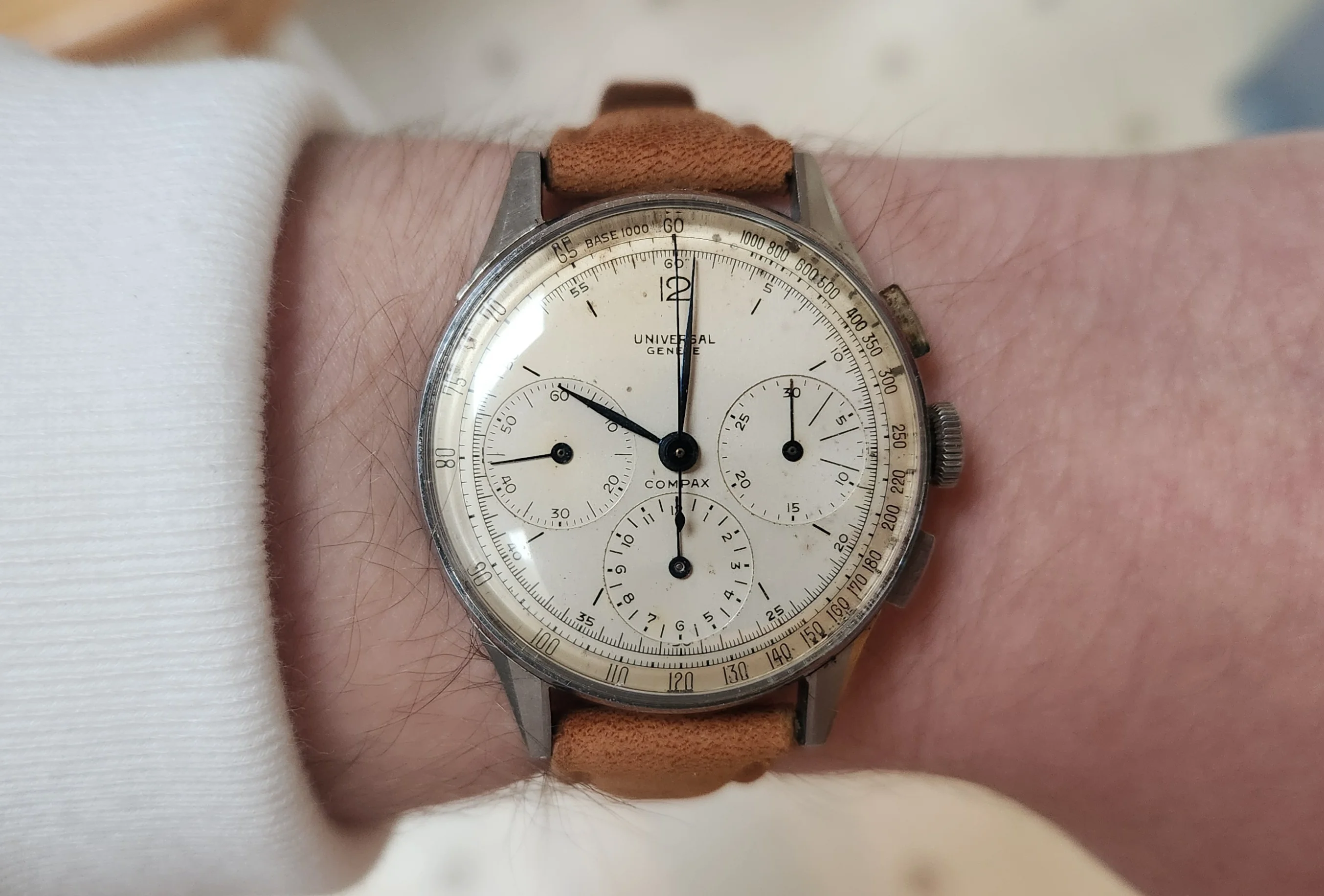

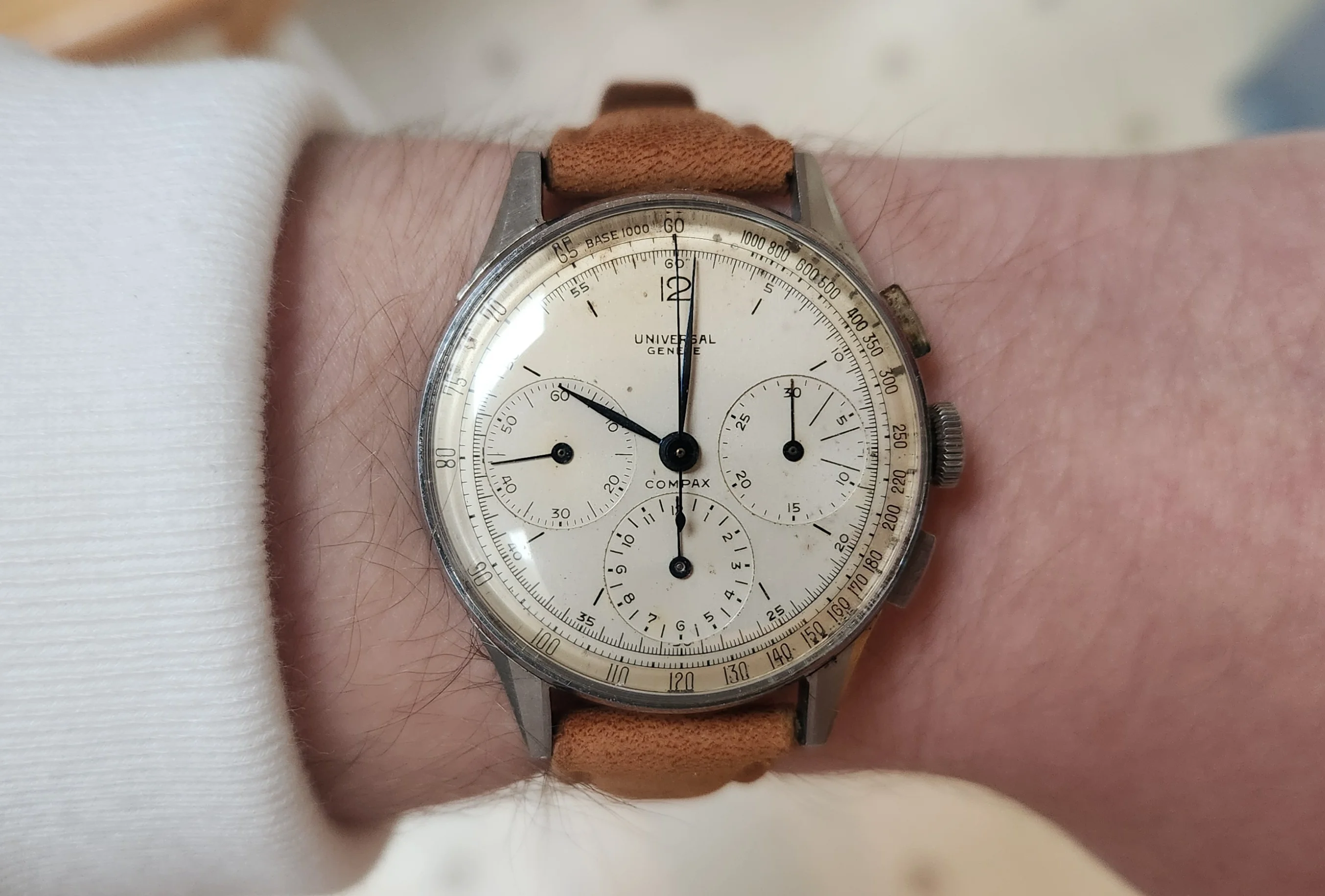

Im getting this watch back from servicing soon and was informed that the chrinograph hand doesnt reset back to 12 exactly it's a bit off. The hand is a bit loose on the post probably from wear over the years. Is this a problem? I dont plan on using the chrono function, thoughts?

Not an uncommon problem. Probably a crack in the tube. I’d recommend having it fixed

I cannot fathom that this info is coming from your watchmaker without a solution proposed.

What would be the best solution to this problem other than replacing the hand? The tube has enlarged over time and isn't a tight fit anymore thus not resetting back exactly. I dont want to replace the hand all together

Normally they crimp the tube if possible, or if it’s cracked, replace the tube, but keep the hand.

Oh okay crimping the tube was actually what they suggested but I decided against it because of possible damage? Replacing the tube wasn't an option as it is very long and they couldn't find one like it.

Damaging what?

Here's the final watch! It looks amazing. The only thing that isn't 100% is the top pusher. We got as much of the rust and corrosion off through just cleaning it.

Love it. What was the resolution re chrono hand tube?
