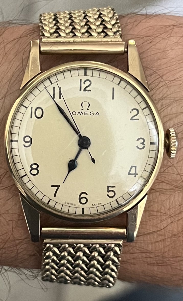

Hi Guys,
I was going to pick your brains for information please.

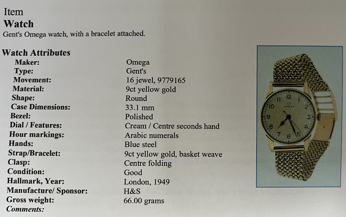

I have recently received my grandfathers watch as a birthday gift from my mother. The watch has sat unused tucked away for over 30 years. I have had it appraised for insurance reasons.
What I do know about the watch is the ref. number, that the bracelet and crown aren’t the originals and I have the serial number, I have no doubt that it’s genuine. But after some online research I haven’t been able to find any similar watches in gold. May it be the watch was reworked into a gold housing and bracelet?
Please if anyone can share some information I’d really appreciate it.

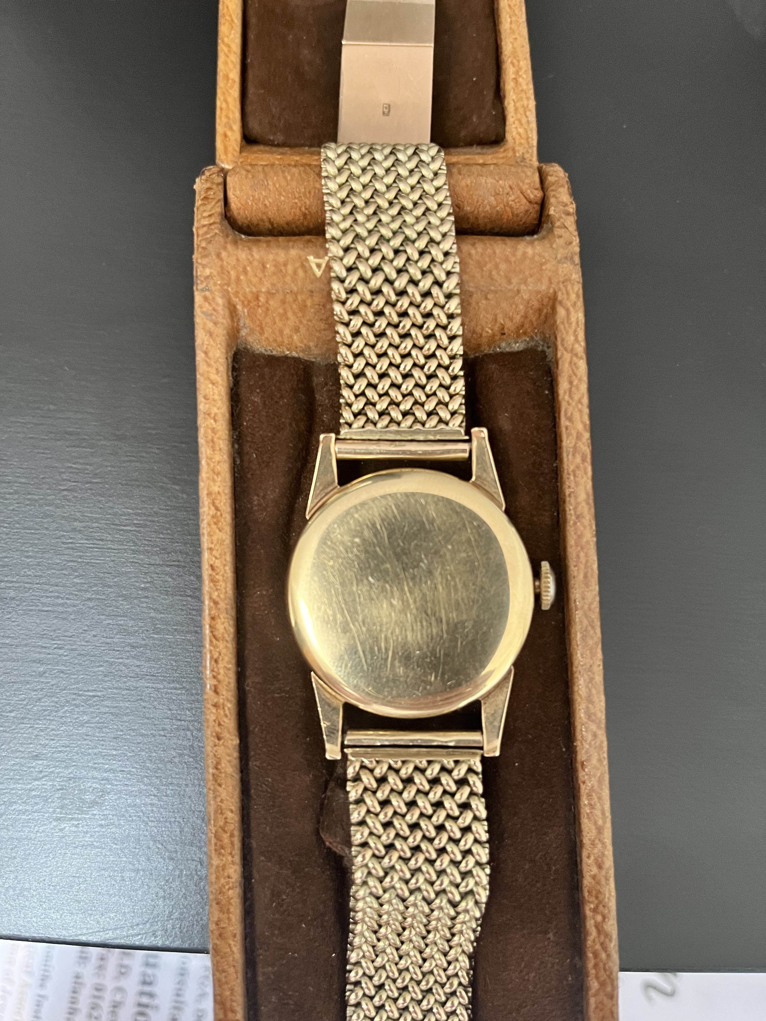

I assume that you have seen the inside of the caseback - any pictures of that or the movement? It would help a lot... I am guessing it is an English made case?

Yes I can appreciate that it’s a grey area and that peoples opinions will be split. Although no I haven’t seen the watch with the caseback off, it was sent away for valuation. But I do have a detailed report from that, with serial number off the movement which I have checked and is from the 1940’s and the hallmark on the gold is London 1949 which is why I believe it has been re-cased.

I'm not familiar with H&S cases. Perhaps some of the forum experts can say if they made cases for Omega, like Dennison. If so, it would be very helpful to know if there is an Omega stamp inside the caseback.
Perhaps the appraiser can send you the photos he took.

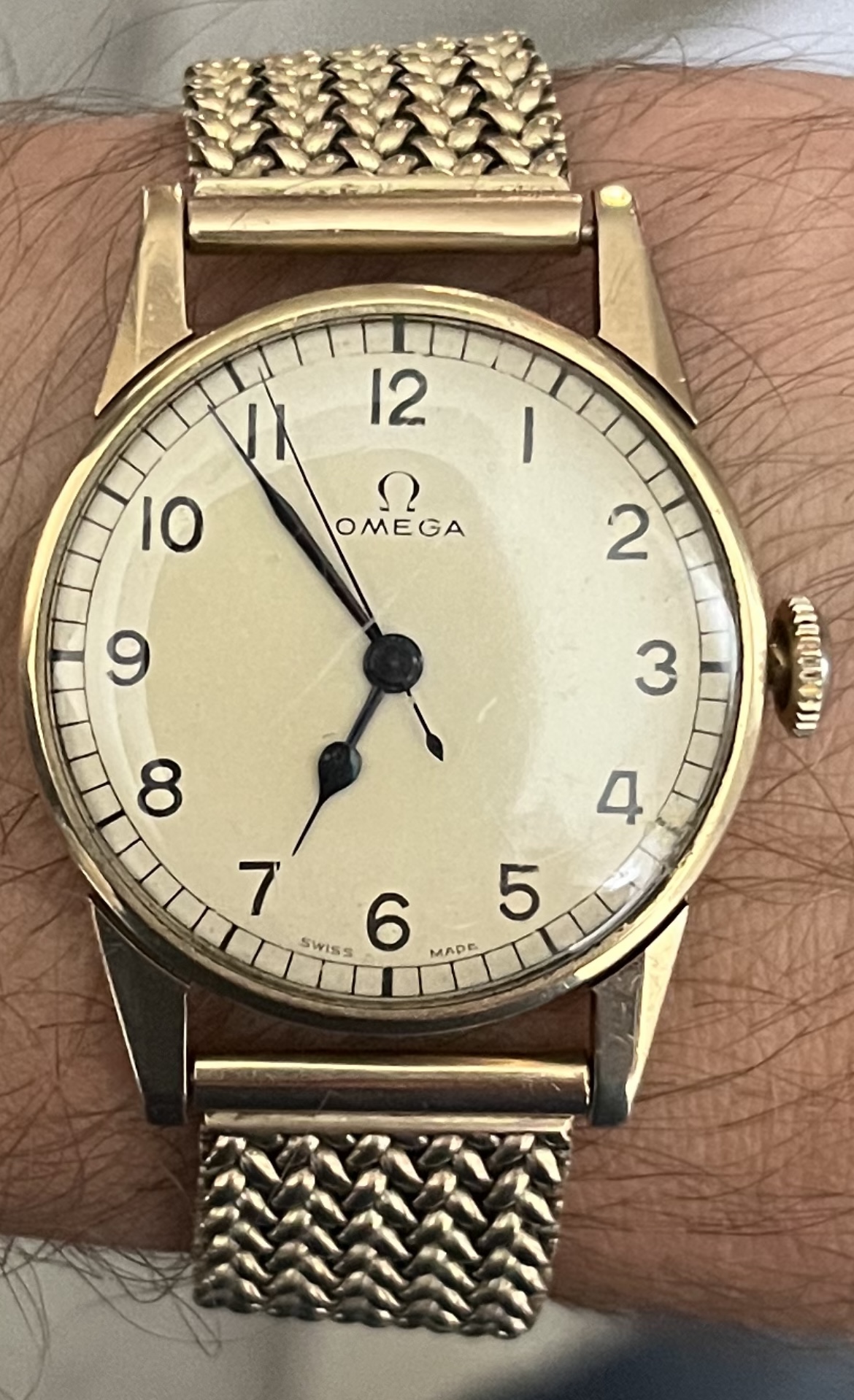

Interesting. The dial and hands look original. The dial looks very clean - at a guess, less that it's been cleaned and more that it has never had tobacco/dirt/moisture build-up in the first place.
It hard to see how it could be other than a re-cased civilian or military (HS^8 or 6b/159) watch from 1943.
I've not seen another like it. Perhaps, it was a one-off re-case? I'd like to know the opinions of the experts on OF.

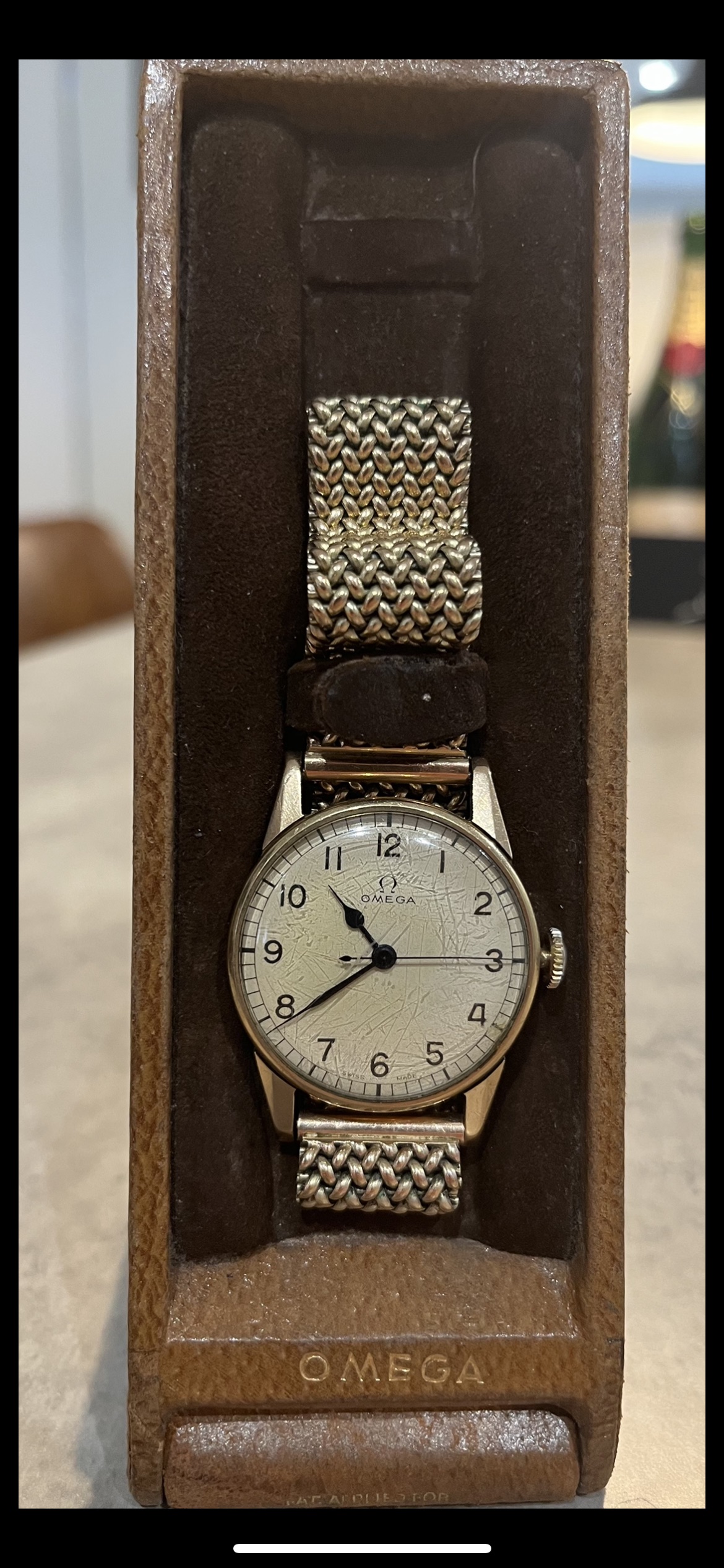

I agree it is very clean and knowing my grandfather it will have been work for special occasions as only as he had a Datejust for his day to day watch. So this will have been stored away for the majority of its life.
It is very clean, here’s a closer picture

From what I know, this is an RAF specification dial, with rail track around the edge and spade hands. This was used in the ck2292 case, and later Dennison cases. Some of these were sold after the war, as just movements, and people would put them into gold cases or stainless cases, so they could have an Omega watch. The 2292 case is an alloy of Aluminium known as Duralumin, and it is very hard to buy an empty caee, especially undamaged, as the metal gets brittle with age. The movement should be a 30t2sc, nickel plated movement, so silver and not gold or copper coloured. The fact it is so clean could mean it was bought as NOS after the war. The dial discoloured with exposure to sunlight, and many show signs of one side being exposed where the other side was covered with a shirt sleeve cuff. The crown looks like the original mushroom shape, and it is a beautiful watch, with no real way of knowing if it saw action or not. Whatever, it is a beautiful watch. The case may be Omega, or Dennison, and the fact it was your Grandads is all that really matters. Congratulations on being the owner of a very nice time piece
The RAF insisted on a white dial, with the rail track. A sweep second hand was needed, they said, and the watch should perform to chronograph accuracy levels. Although these movements were not stamped Rg, I have read that they were known as SR, special regulator, and built and tested to chronograph levels of accuracy, but this is all just information I have picked up, and I can not prove anything, except I spend too much time looking at the old RAF watches.
