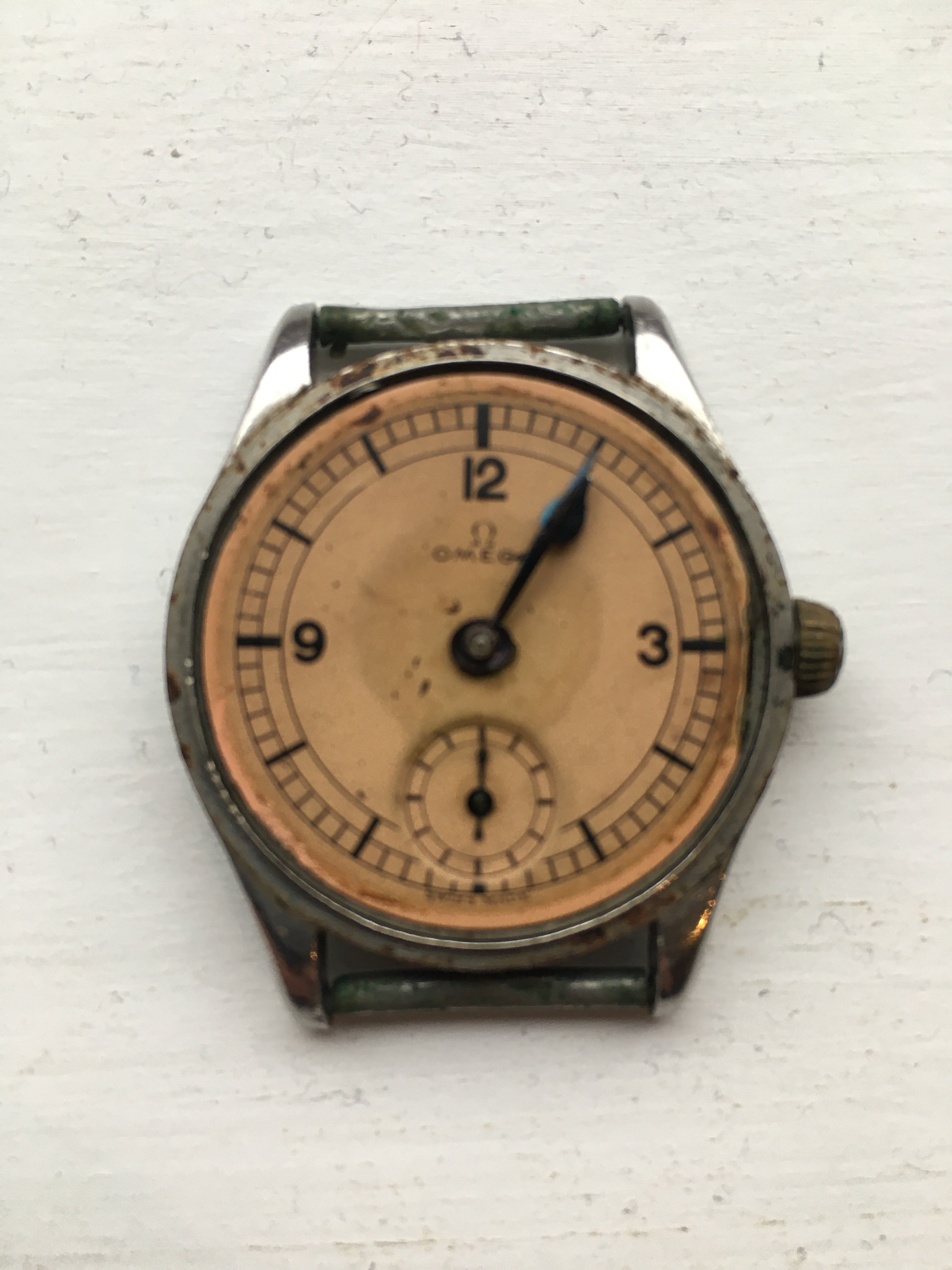

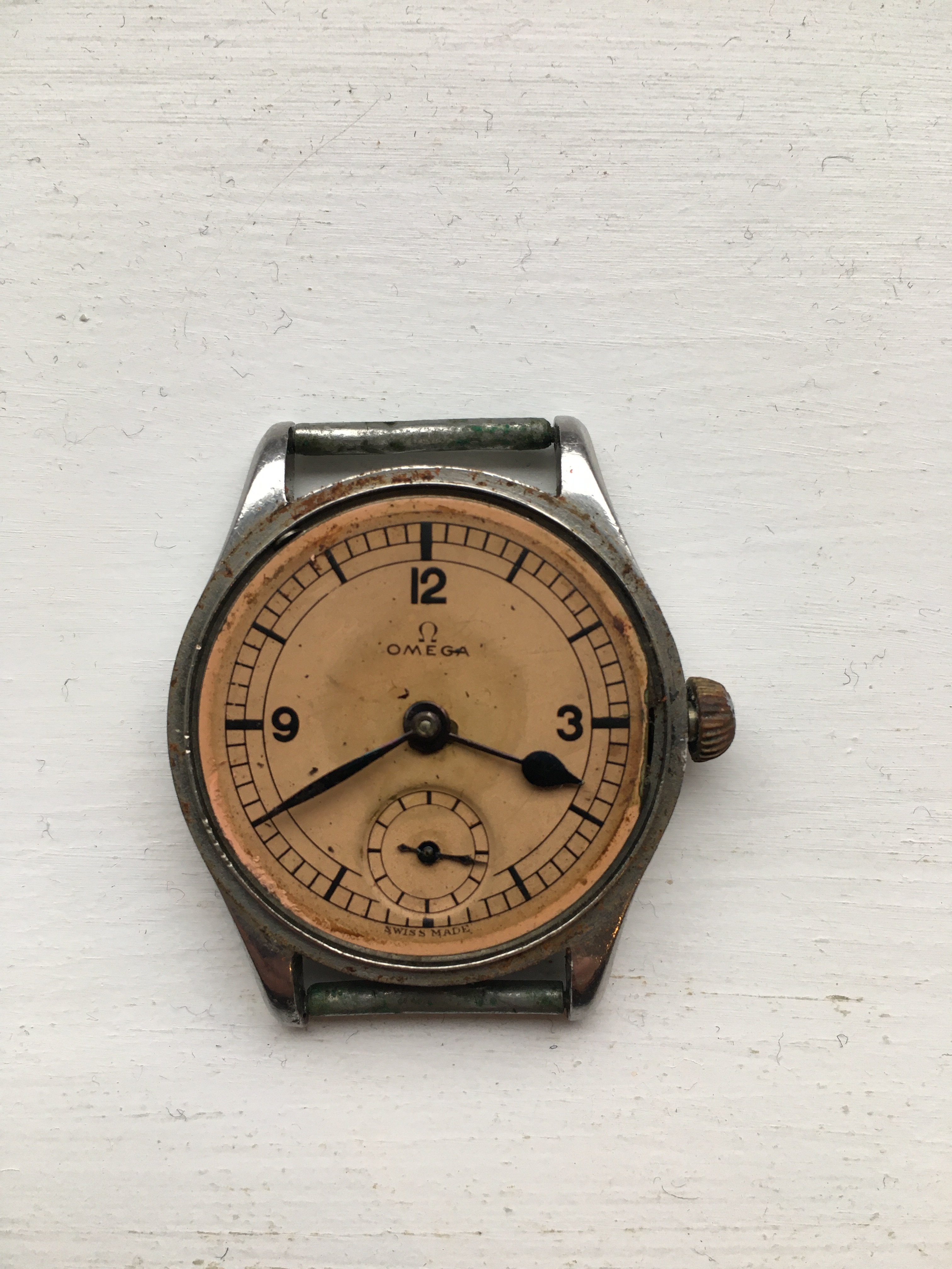

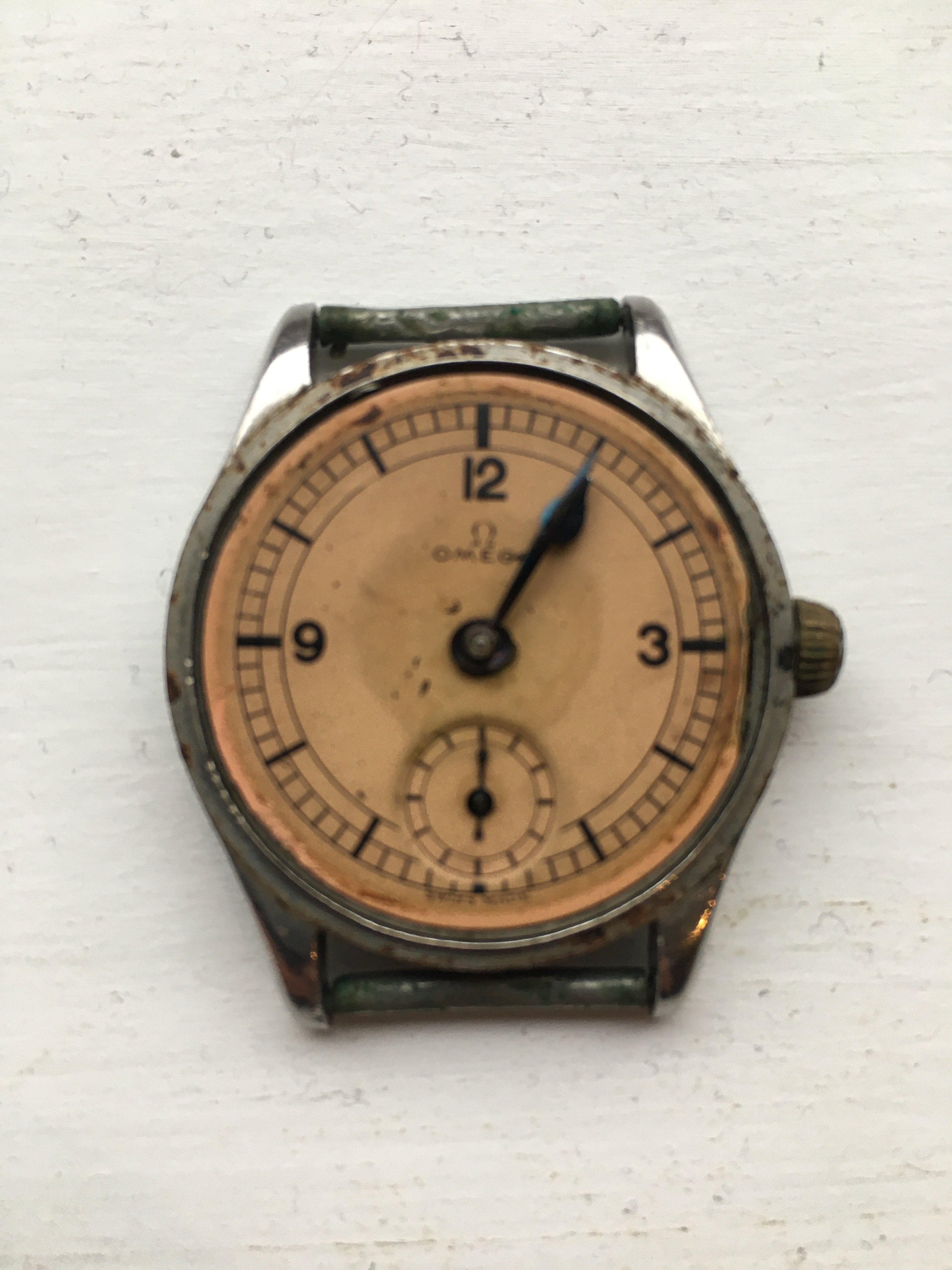

Hi all,
I’ve found this in a box that came from my late parents. They bought it for a few pounds & thought it was fake or worthless.

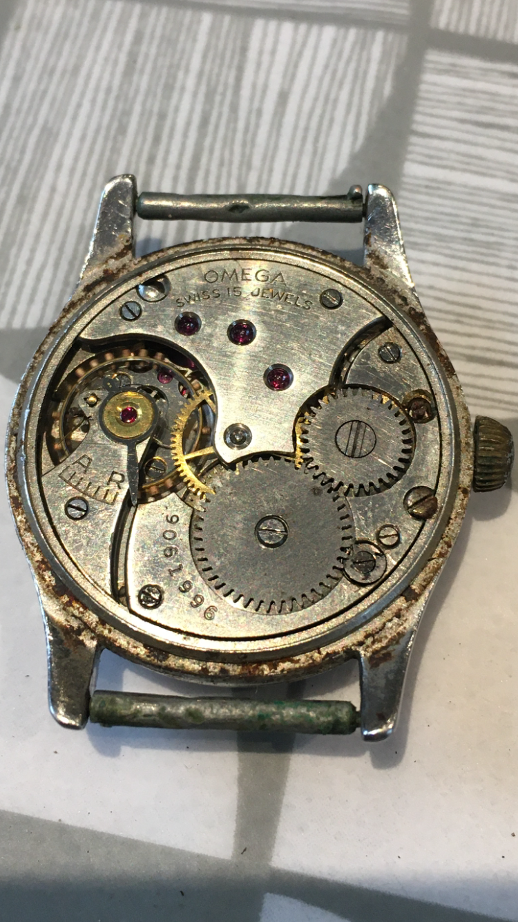

I’ve taken the back off this morning. The back is from a different watch entirely, but does fit!

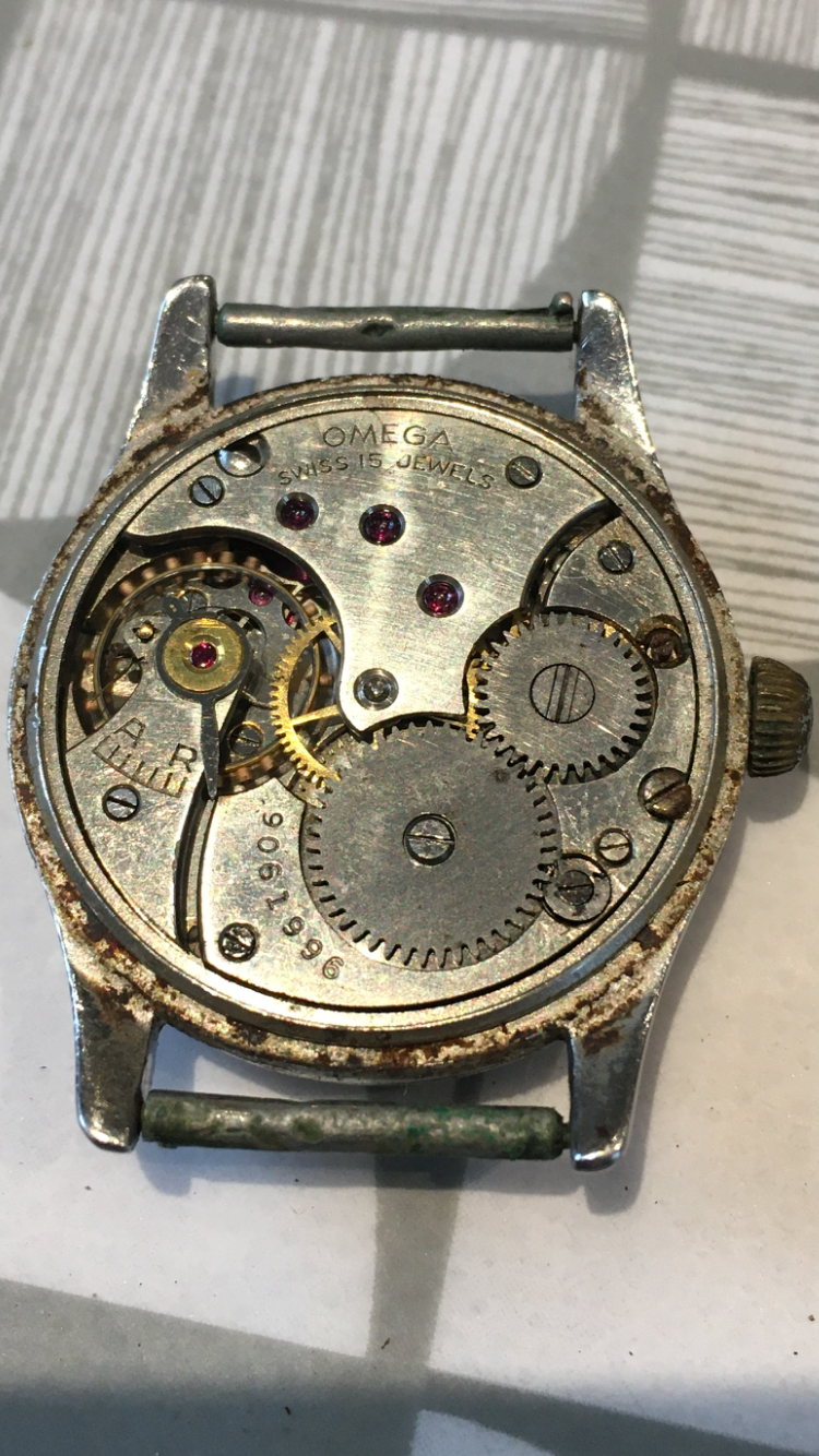

The number on the movement dates it to 1939.
It is c30mm across the face.
I wanted to ask you guys if you could provide any more information on it? Also, it has been unloved & not serviced for at least 50-60 years. Is it worth spending the time & money getting it sorted?
Thank you.

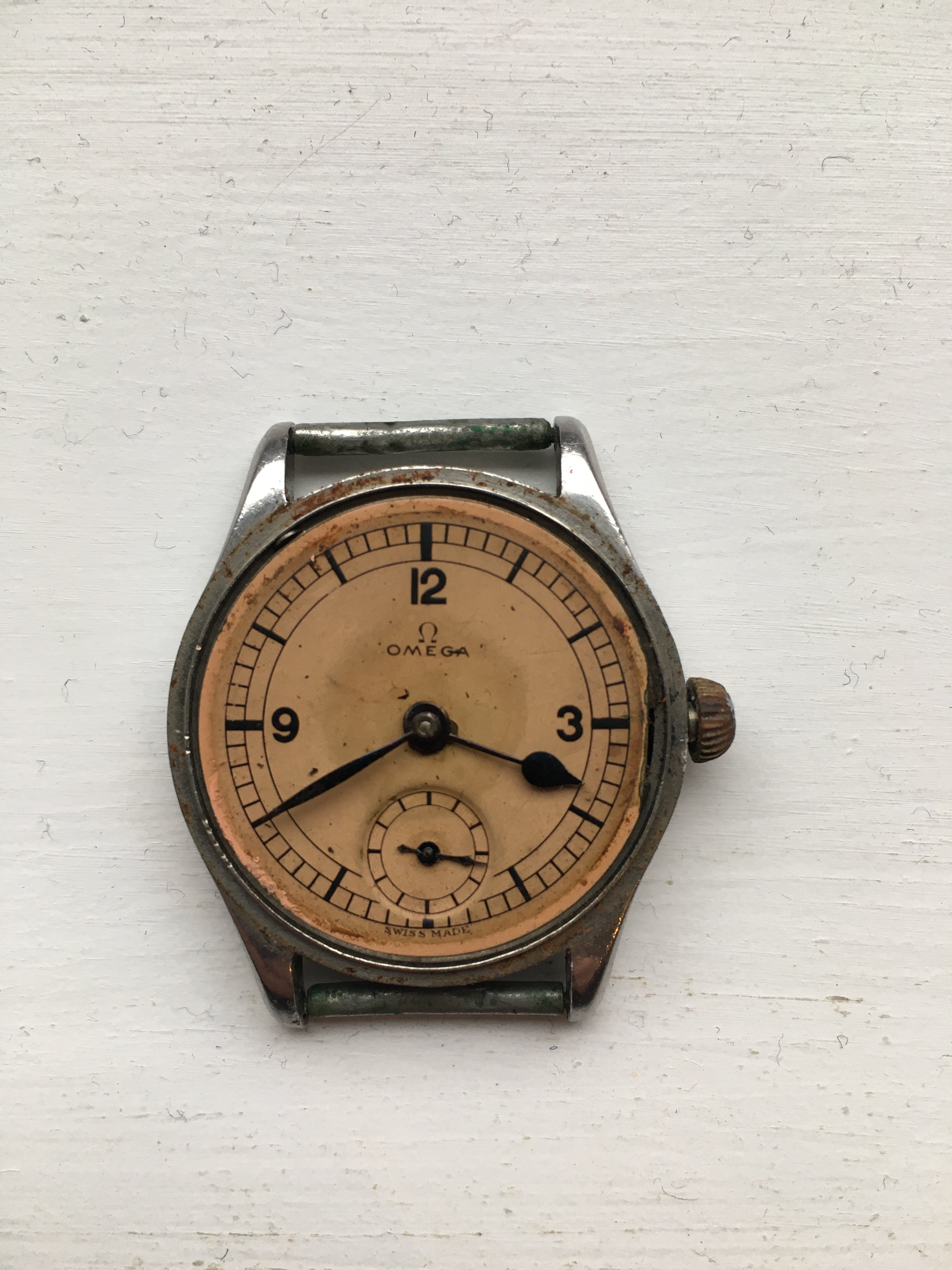

These 26.5 calibre Omegas with Sector dials are highly desired. Unfortunately, however there are fewer people who like these very small models. I have a similar one in a 32.5mm case, and that is on the edge of what I feel comfortable to wear. I think it's a lovely little piece. The dial looks good, however I would imagine the hour hand is a replacement. As it should be a leaf hand like the minute hand. I think it would be nice to see the condition of the dial without the crystal. If it's in good shape then I'd say get it serviced.

Thank you. I really like the one in the link you’ve posted! I’ll get it serviced & give the watchmaker that example of what I’d like it to be.
I thought the hands & the crown looked wrong.
Worth me trying to access the dial or leave to the watchmaker?

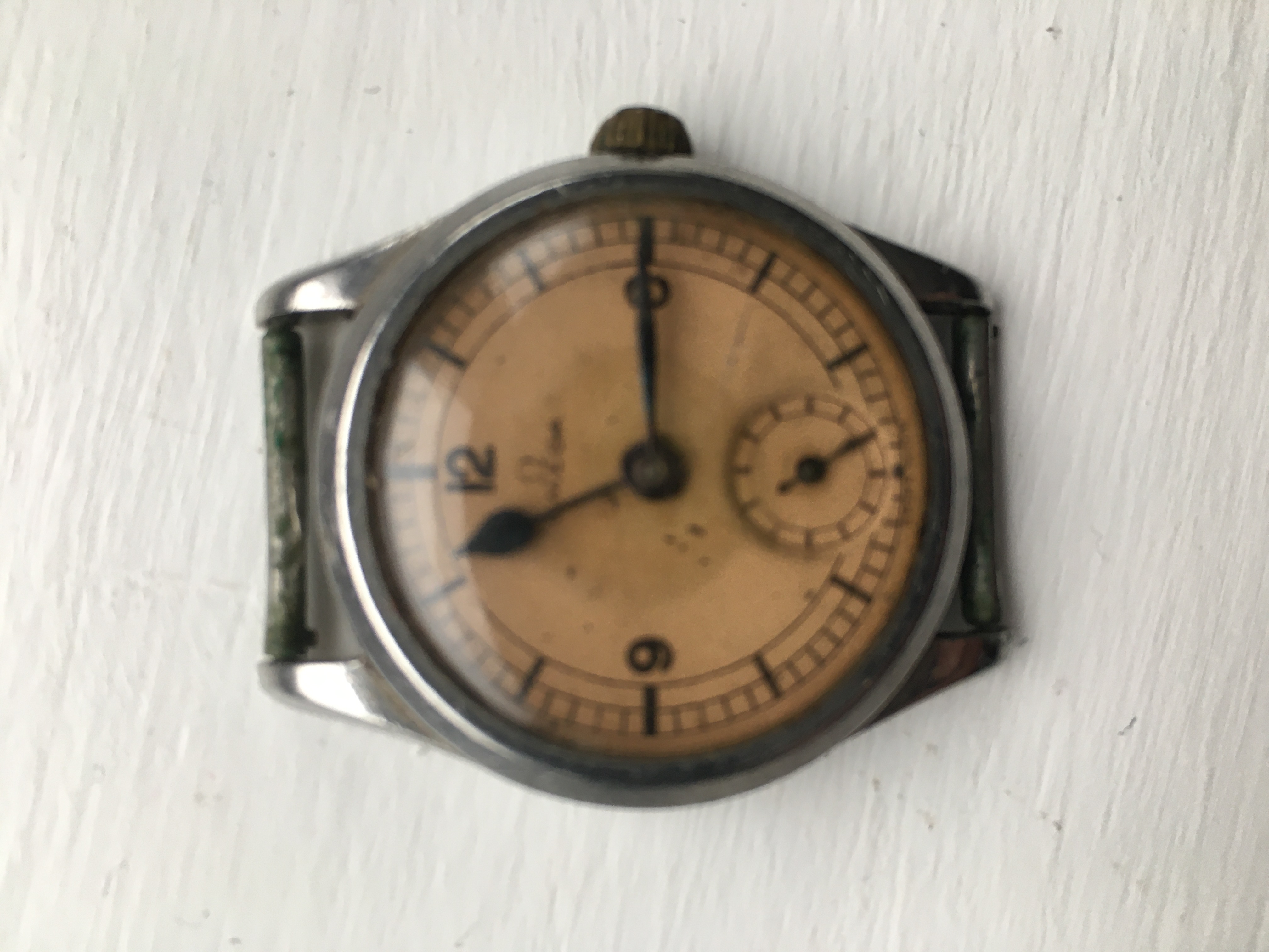

The minute hand and second hand are correct, it is only the hour hand that I would be concerned with and of course the crown isn't correct and unsigned generic crown of similar shape and size to the one in the link will be fine.
Just as you removed the caseback the front of the watch should have a bezel which can be opened with a caseback knife. This will remove both the bezel (and the crystal within which it is attached).

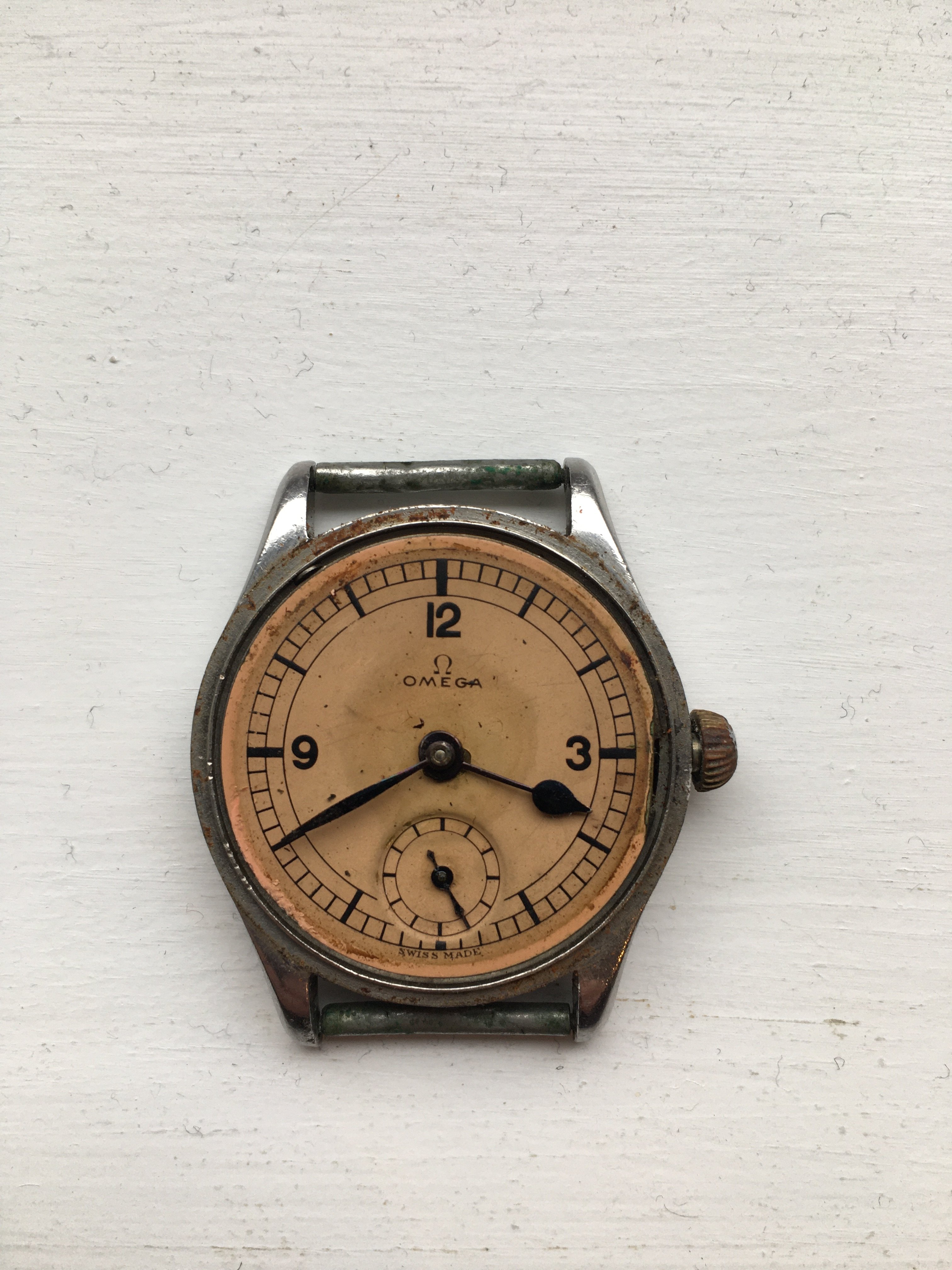

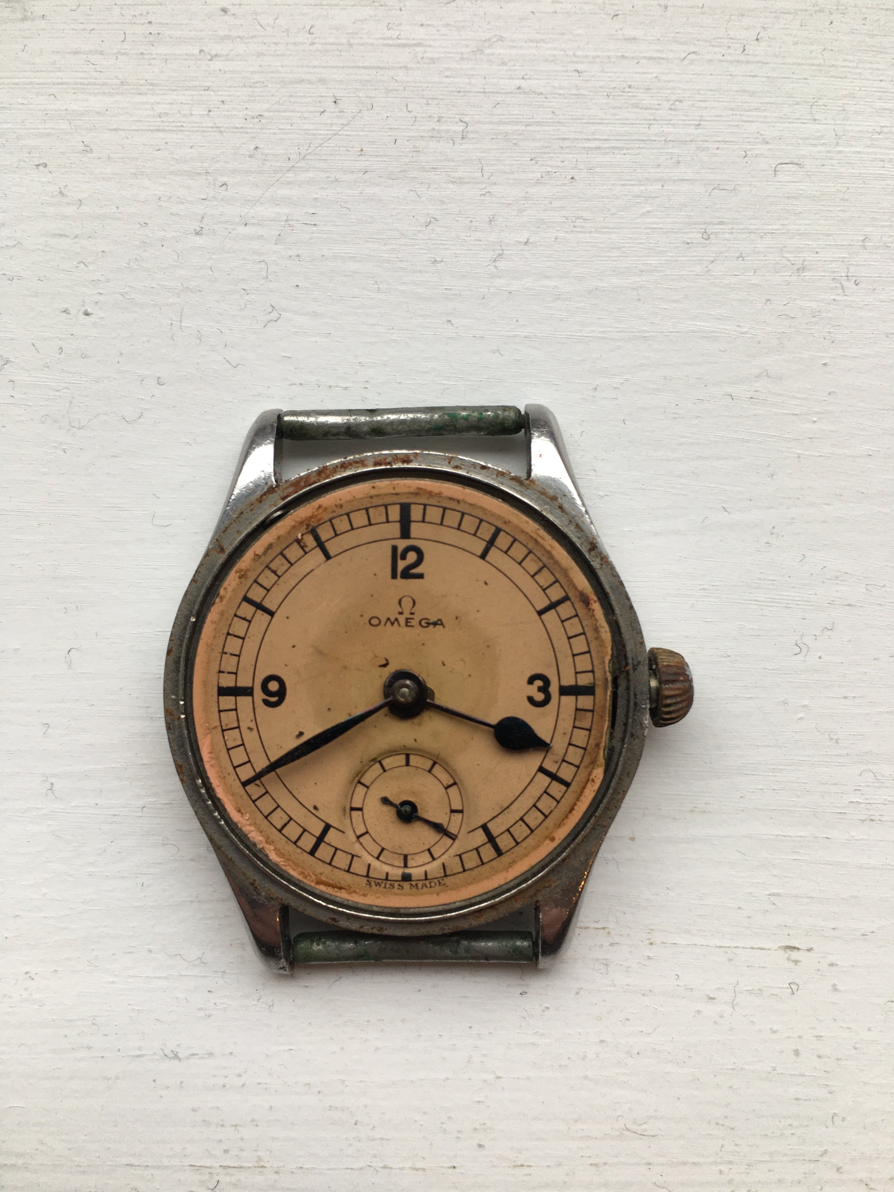

Please try to take a photo in focus on the dial and move the hands so they do not cover text
6,901
10,764

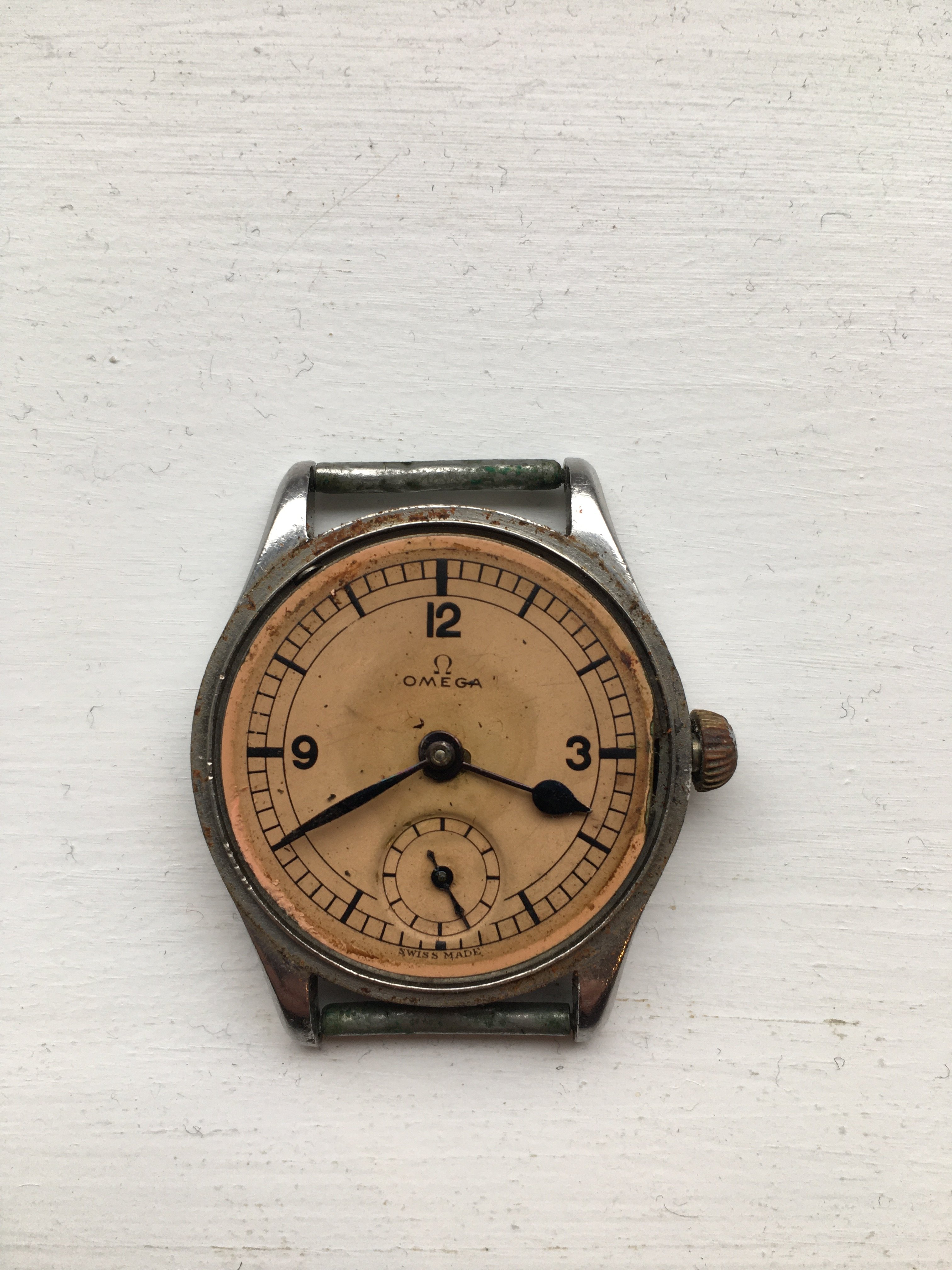

Redial (i.e. dial reprinted) I'm afraid

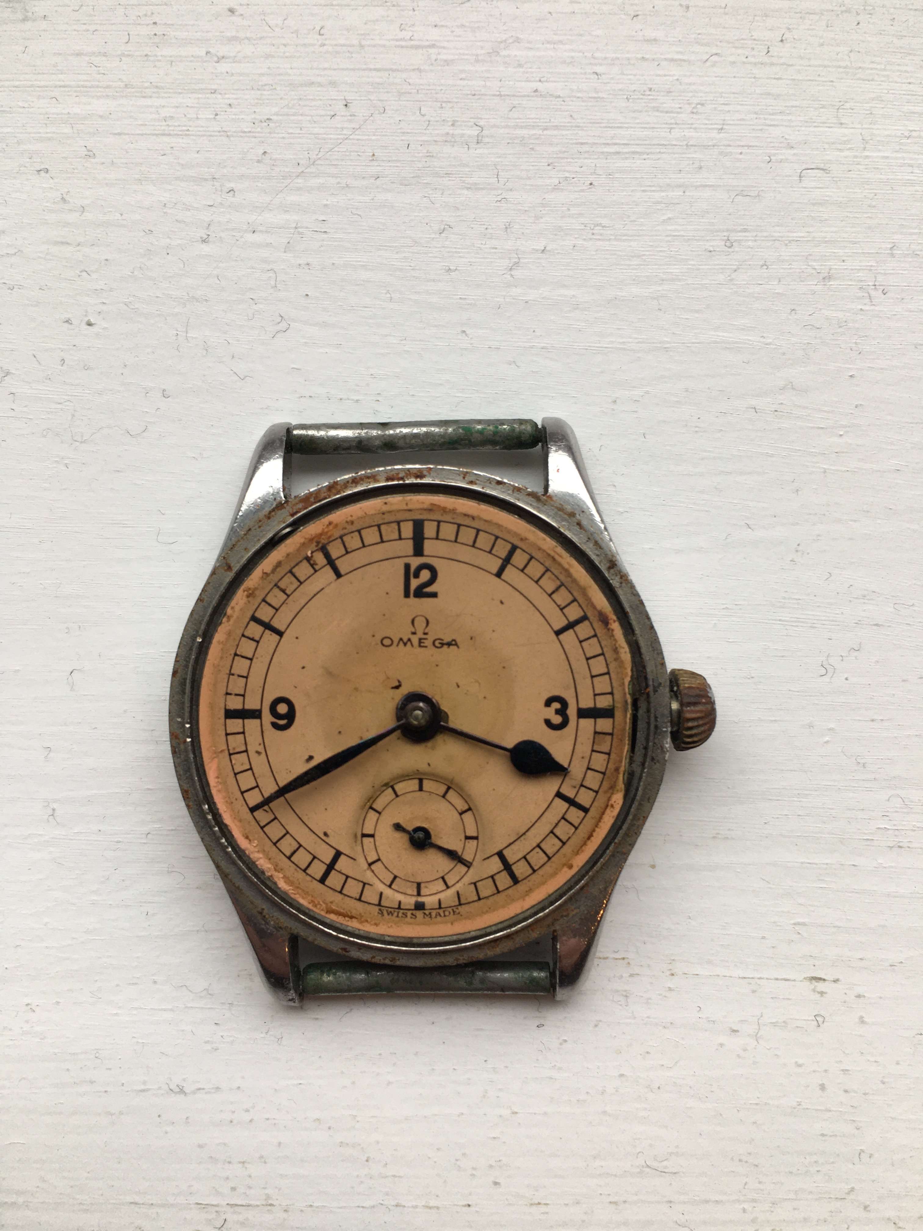

Thanks. Now you mention it, it does look wrong. Wonky ‘Omega’ gives it away!!
The whole watch looks wrong! Wrong back, hand, crown & dial!
Would the movement be a fake do you think or would that have just been amended over the many years?

Your watch is fine - the only faults which should be adressed are the hour hand and the crown which would be an easy fix.
Have it cleaned and lubricated by an expert watchmaker (not a battery changer) and you will have a fine watch and a heirloom from your parents.

Whilst the logo is wonky, this is sometimes found on watches from this era. I think it's got a nice character, and like Erich has said could be a nice little heirloom if you enjoy the look of it and plan to keep it yourself.
6,901
10,764
IMO its perfectly fine and original
never too old to learn but the wonky print made me think it is a redial
