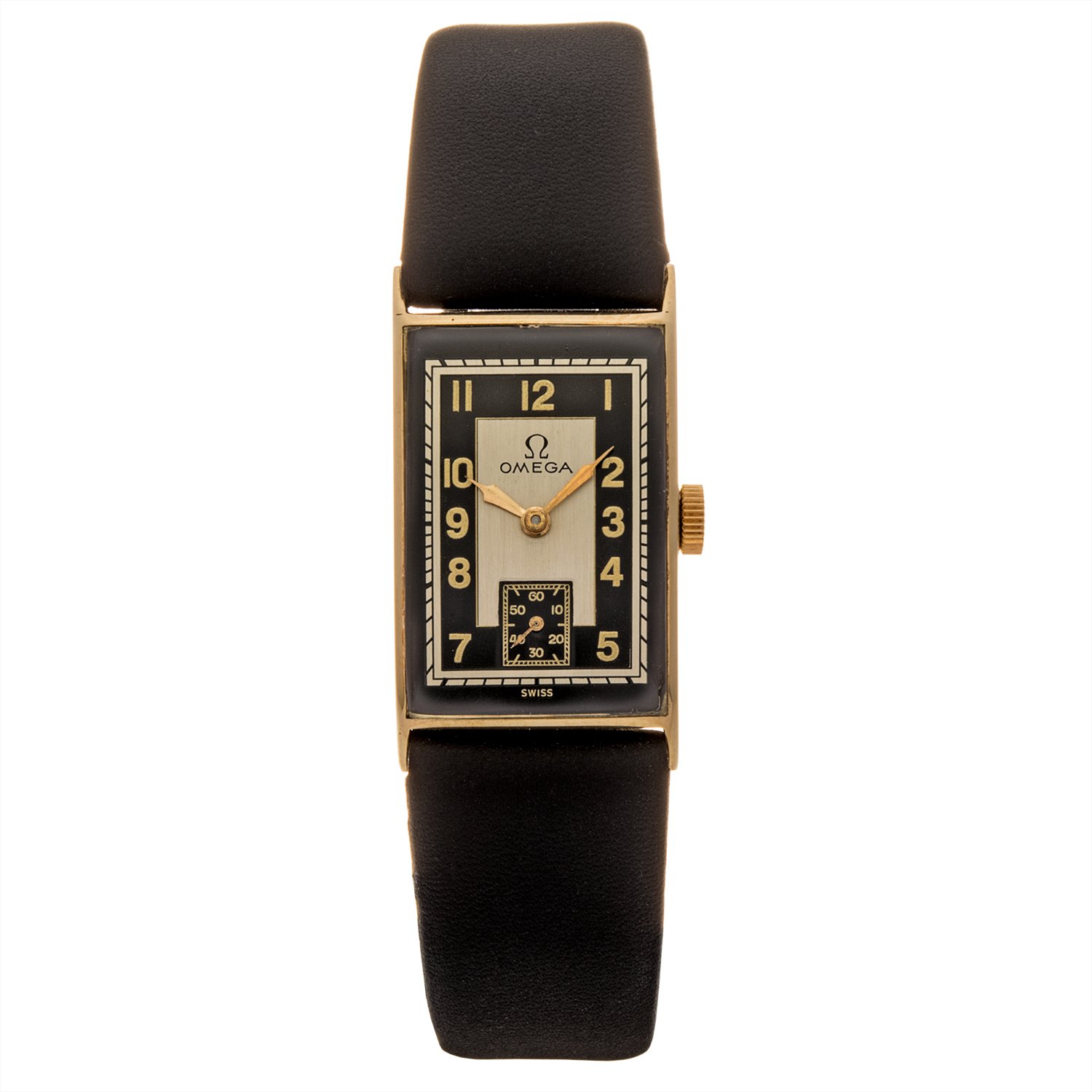

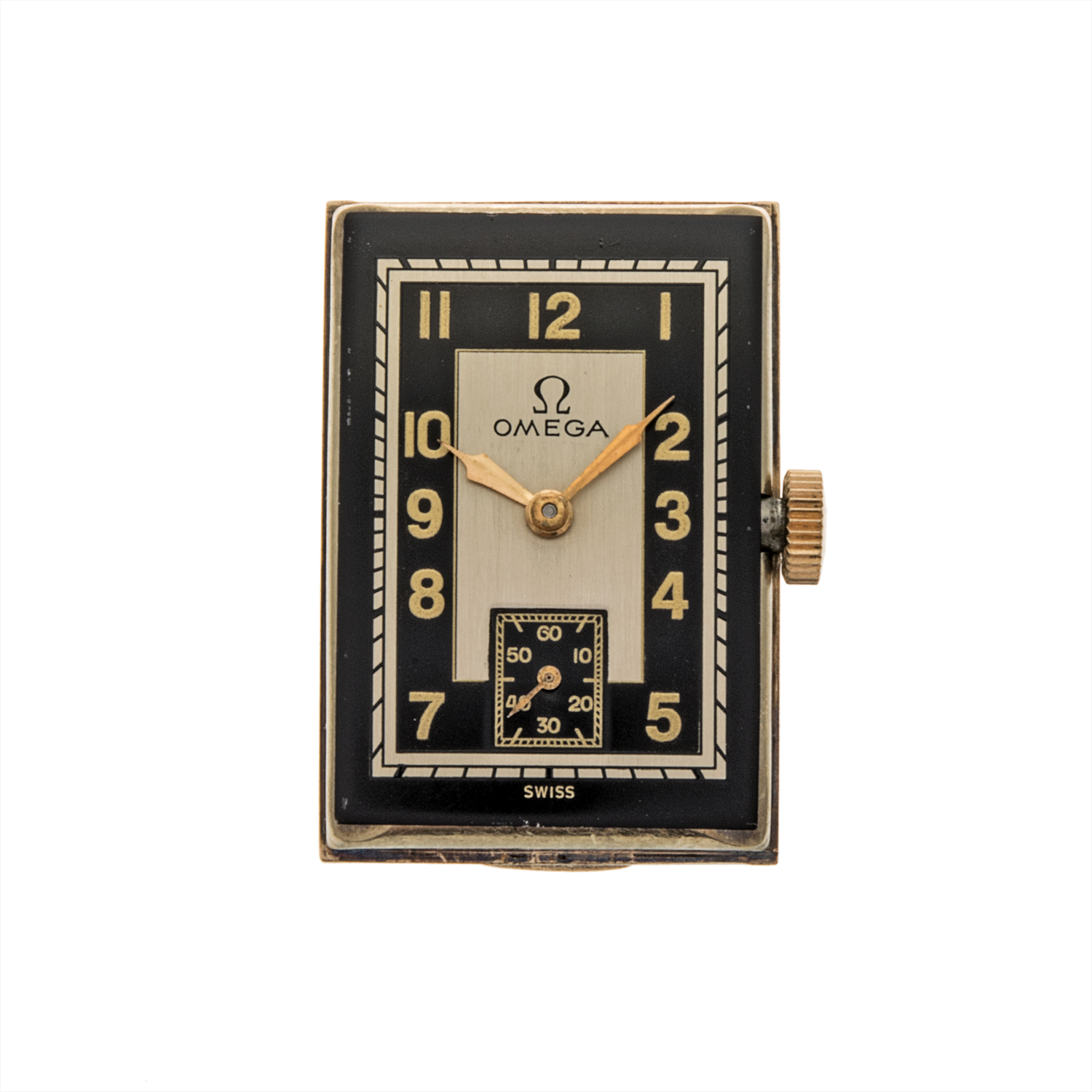

Hello! Newbie to collecting and I'm starting to learn more about/research redials to spot them. I think I found an obvious one today and I'm kind of sad about it because it is part of a watch with an escapement I really want in my collection. Here's what I'm seeing as the issues:
1) From my research, these "tanks" produced by Omega came in Black, White/Cream, some blends. However, I was unable to find any old advertisements or examples of this particular dial color scheme.
2) The black paint seems "bubbled" in a few places.
3) The Omega symbol has wings off the ends that are a bit thin and high in comparison to the logos of that period (1930's-1940's).
4) The font is off. The seconds dial has a relatively Art Deco style, including a split in the curl of the "6" in "60". Whereas the hours are noticeably...contemporary. Interesting too is the "5" which has a slant on the back of the 5 (slightly off from a straight 90 degree back), which is something it seems Omega consistently does not do...they tend to go for a very straight 90 degree back on the 5's in most fonts. The numbers also just seem like thick new-ish paint.
Anywho, would love to get thoughts from the forum. AND if it isn't too much people's personal feelings on whether they'd want it in a collection. Admittedly I love escapements...and want this in part for that purpose. However, I'm trying to start a solid collection and want to start it off right. Thank you for your help!

Short answer: Yes. Bad ? Depends . Have seen worse. Omega sign and writing incl. Swiss not correct. Colour scheme not bad. You should ask for a picture without the band.... Looks like too much lug wear and lugs very thin now....

Looks like a better than average redial to me. Regarding the case, it looks to me that the band might be slightly too wide for that case, making the lugs look thinner then they really are.
I would want to see pictures in a more natural light.

You've done your research and have already pointed out the issues with the dial, nicely done. It's really not all that bad of a redial. If I were interested in buying it, I'd want more pictures in natural light and I'd like to see what the lugs look like. Like @gatorcpa pointed out that band obscures the lugs, and makes it impossible to see what kind of shape they are in.
