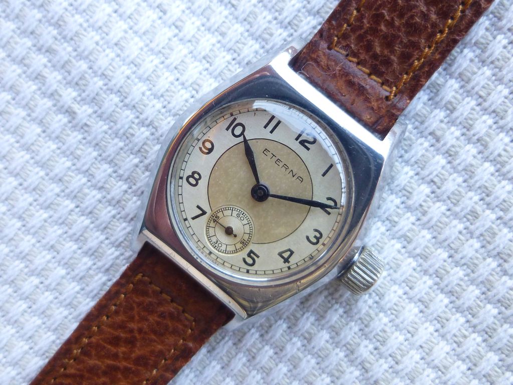

Hello,

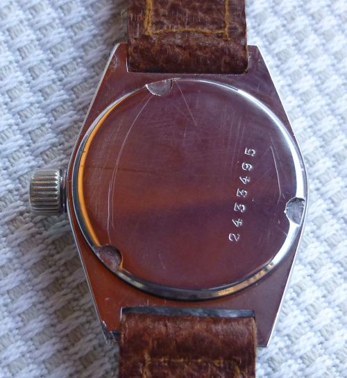

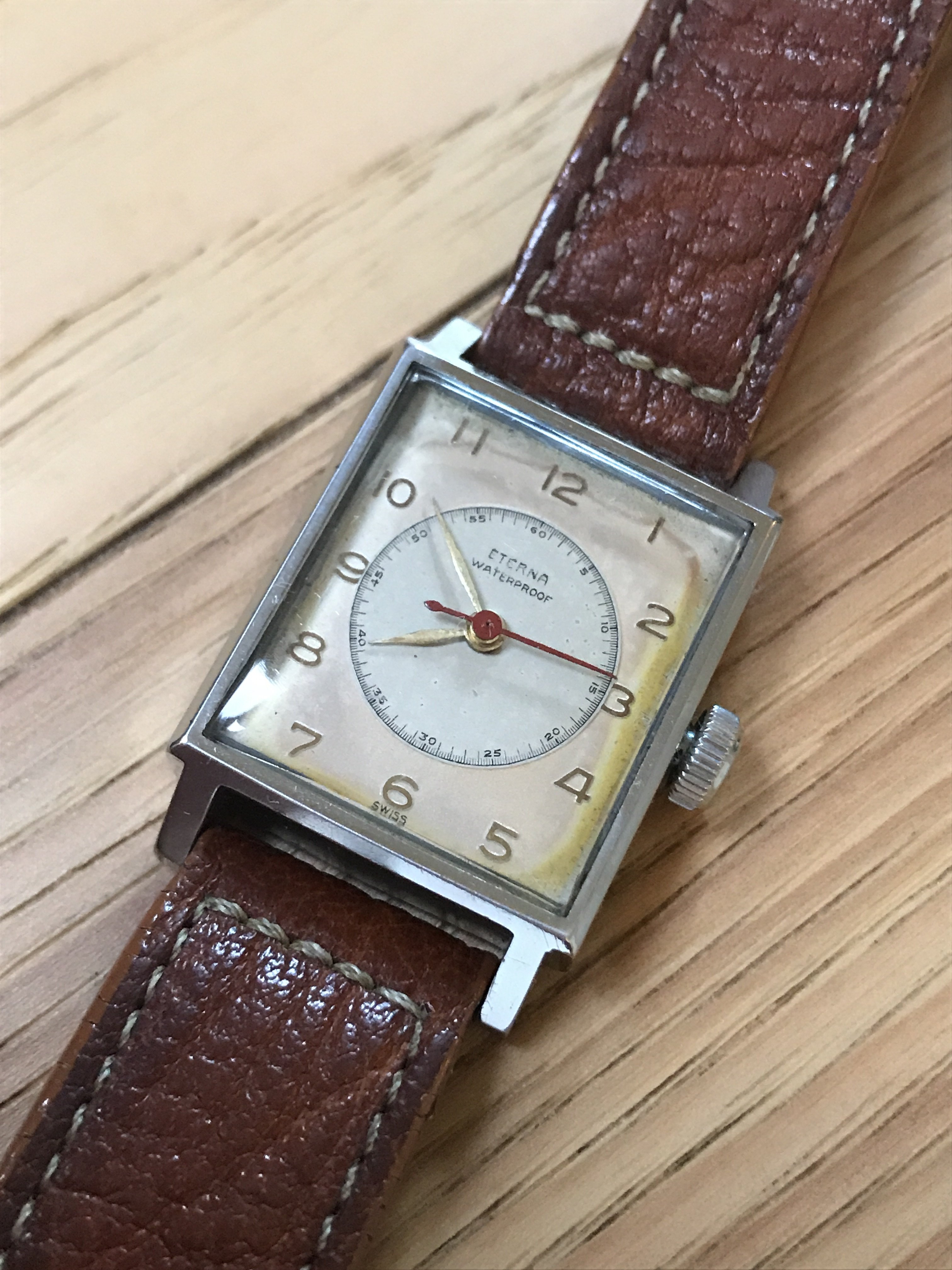

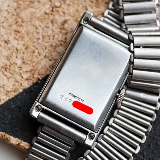

I recently purchased a 1930s Eterna that features a 'clamshell' case (serial 242xxxx so it looks to have been produced in 1931). It will need a movement service before it is ready to wear and I suspect the crown to be a service replacement from the past. I did some reading-up on the history of these cases (most notably: https://www.vintagewatchstraps.com/waterproof.php) but I was unable to find any information regarding the crown's part in providing water resistance in these '30s cases.
My example:

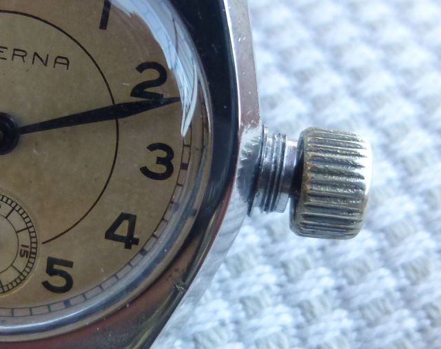

Crown close-up.

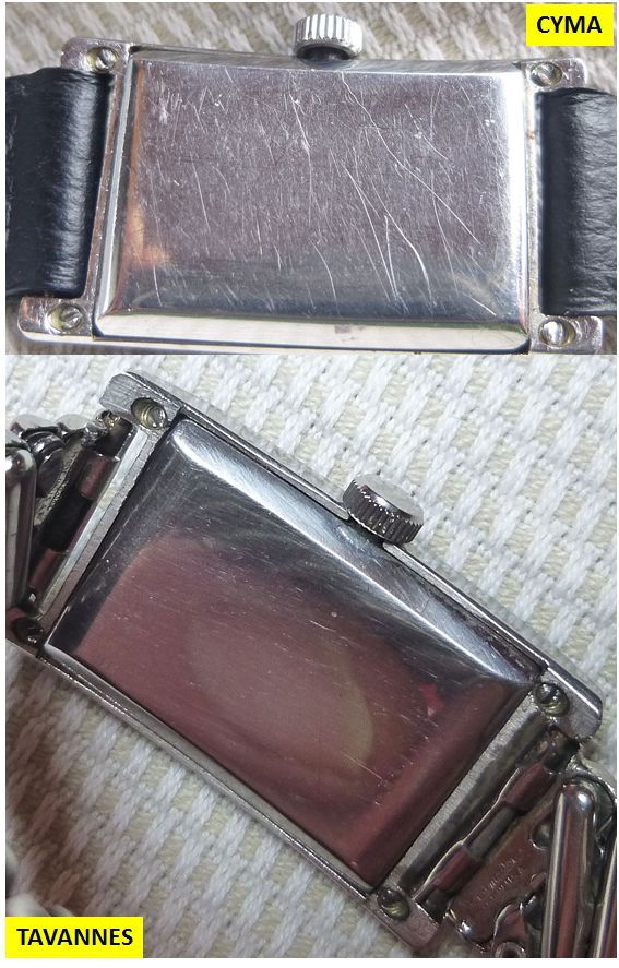

I did find some similar examples that all feature a sturdy crown, which leads me to believe my example has a replacement crown.
https://omegaforums.net/threads/cyma-watersport.92960/#post-1205178
https://omegaforums.net/threads/early-eterna-waterproof-need-input.90685/#post-1173976
https://www.ebay.com/itm/Rare-Stain...344672?hash=item4d9b8016a0:g:dpAAAOSwEAtdG7Kp
Hopefully our combined efforts can lead to 1) establishing the authenticity of the present crown; and 2) a part number of the correct crown or pointing me into the right direction to acquire one.
Kind regards,
Matt

The shape of your crown leads me to think your crown may be original, or at least it's the right style. Early "waterproof" designs like yours likely relied on stem seals, gaskets, and some sort of case clamping force to provide a little bit of water resistance. Other designs featured rubber gaskets inside the crown with a "screw-down" action, or double-case designs where the crown was protected inside a second case cover.
Have you opened yours up yet, to see how it is put together?

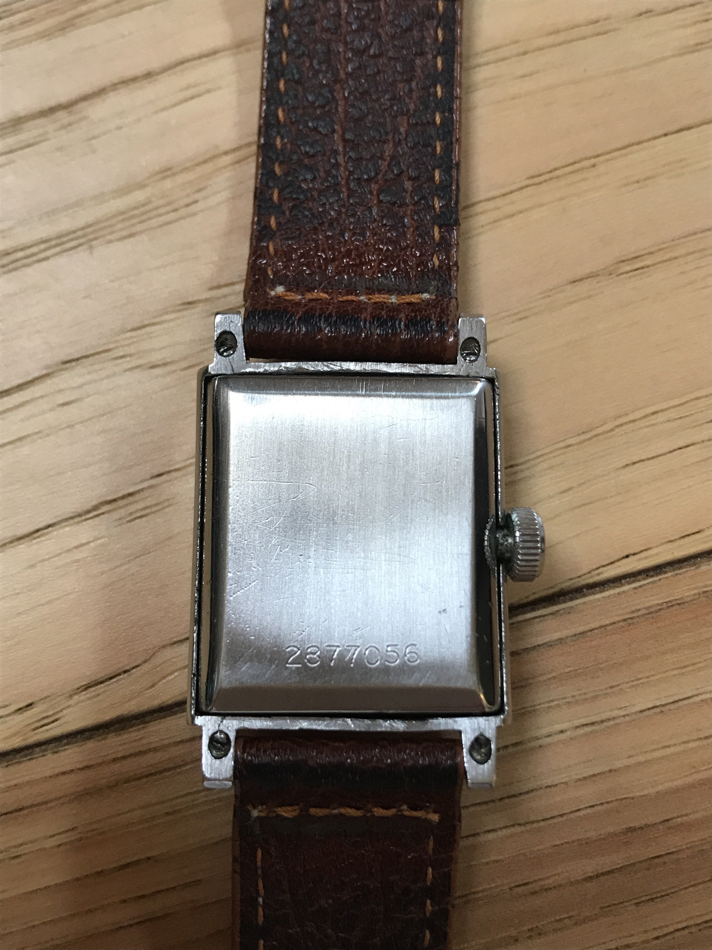

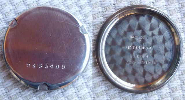

Thanks for your input. The watch is not yet in my physical possession and the two pics above were posted with permission from the seller, as is the one below. I don't have the means to properly open the case so I won't try in the first place. The watch is to be shipped to a watchmaker soon.
What sparked my theory about a replacement crown is the discoloration, which strongly resembles chrome plating wear. The case is Staybrite so I would typically expect a crown of the same material. Now that I consider it: it is a very early example so it's possible that stainless (Staybrite) crowns weren't available yet at that stage, due to manufacturing process limitations. Thoughts?
Here's a case back shot for reference.

That is not uncommon. Gold watches also usually don't have solid gold crowns except for some brands like Patek.

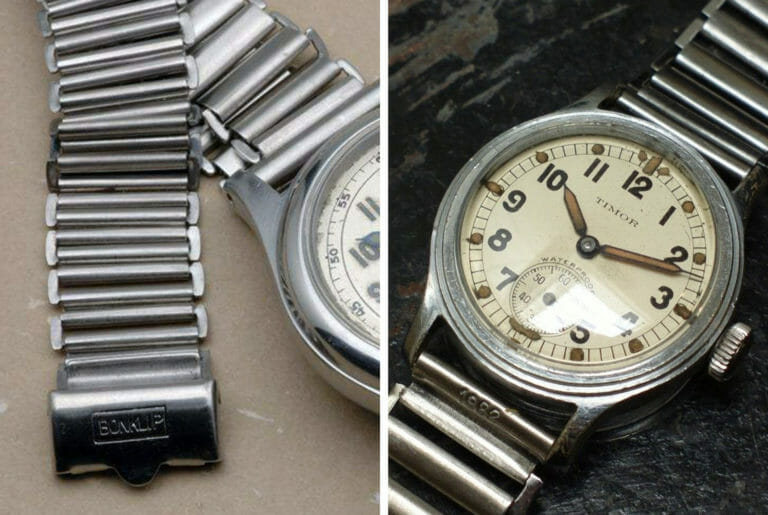

Bracelet may be original.
Looks to be a Bonklip.
From the web:
The Bonklip was developed in the 1920s and 1930s and was issued on British military wristwatches in the 1950s and 1960s, post-WWII. These bracelets were mass-produced, easily adjustable, and machined from stainless steel (in fact, they were some of the first mass-produced stainless steel bracelets). Though bracelets were generally not offered as a standard option on the earliest Rolex watches, there is evidence that some may have been sold with Bonklips in the 1930s and 1940s.

Thanks! The watch was a barn find originally and the bracelet was attached. The seller mentioned the bracelet is original to the watch.

Based on other examples I think the crown is a replacement. These watches
also feature a split stem patent that in some cases should be left alone.

Sorry, they are nearly impossible to find. And if you break the
split stem you are in trouble. Post some pictures when it arrives, I
have some crowns here but I need measurements of your tube. And the
lenght of the stem.

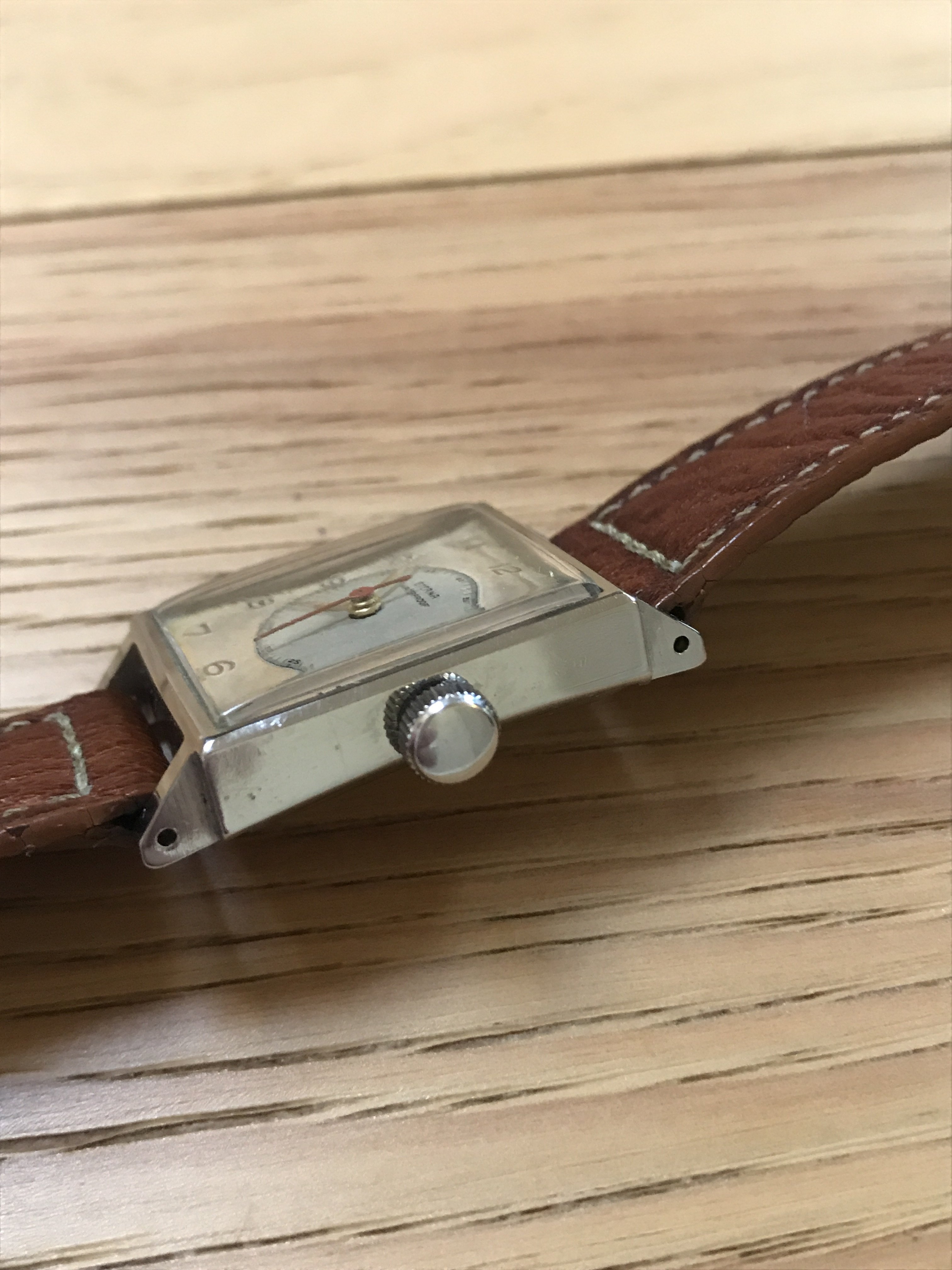

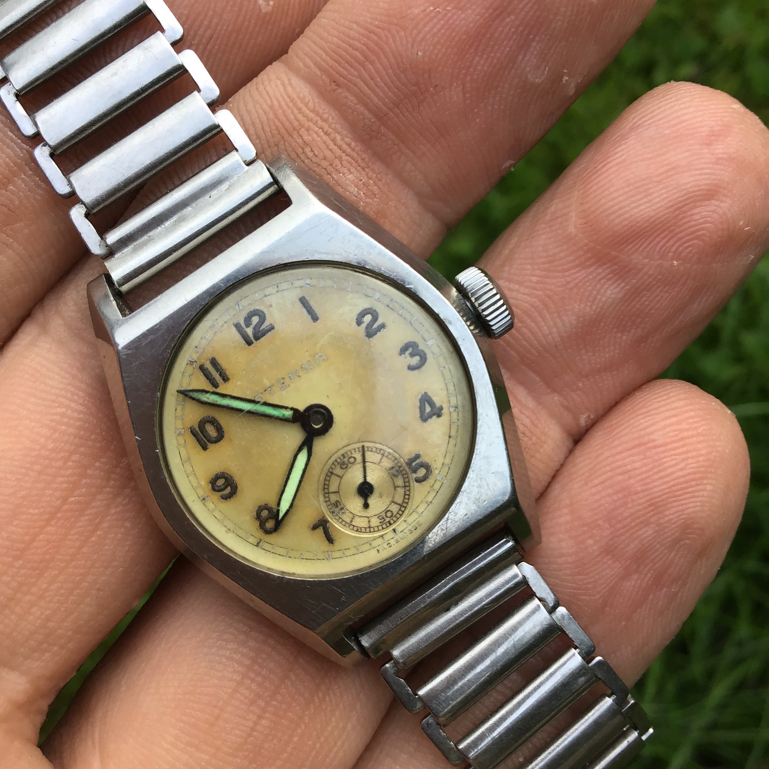

I have this little Eterna. It sits next to my Rolex Bubbleback in my collection as an example of early waterproof watches.
816
2,789
Interesting. This one also has the 'sturdy' crown but it is a later example.

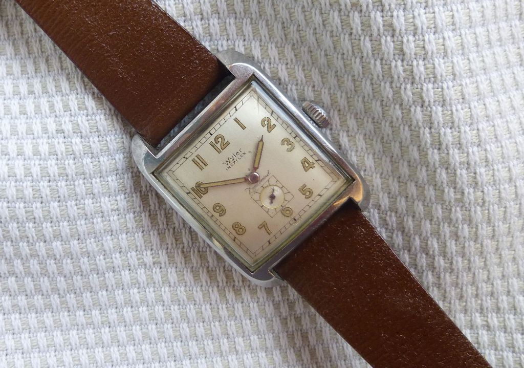

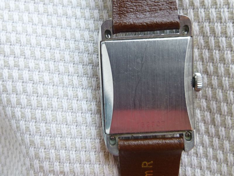

I have a «Roa watch co» in the same tre tacche case, cromed brass case right?
To get back on track with clamshells. I got this at the fleamarket the other day.
Got it mainly because of the GF bracelet, but I did not see it was a Eterna before
I got home😬
