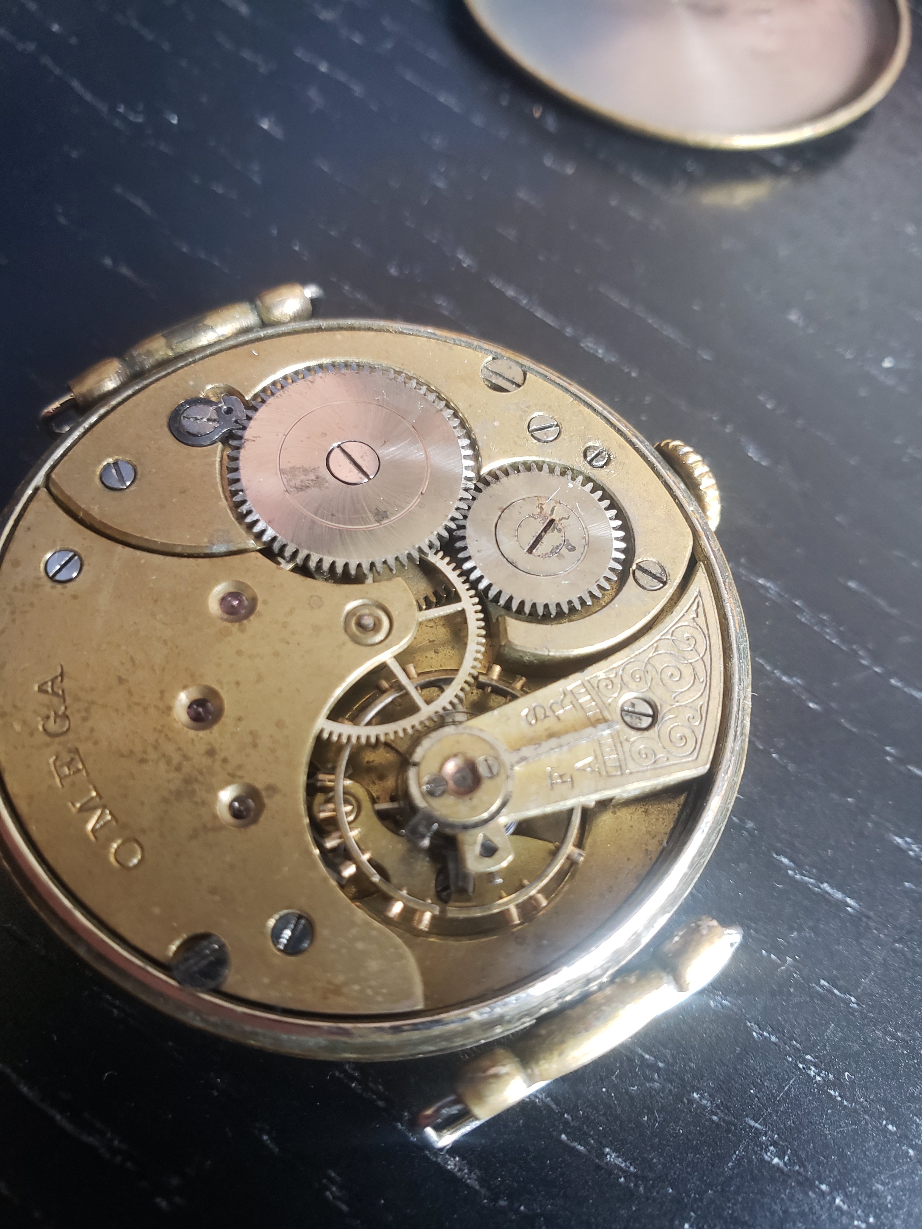

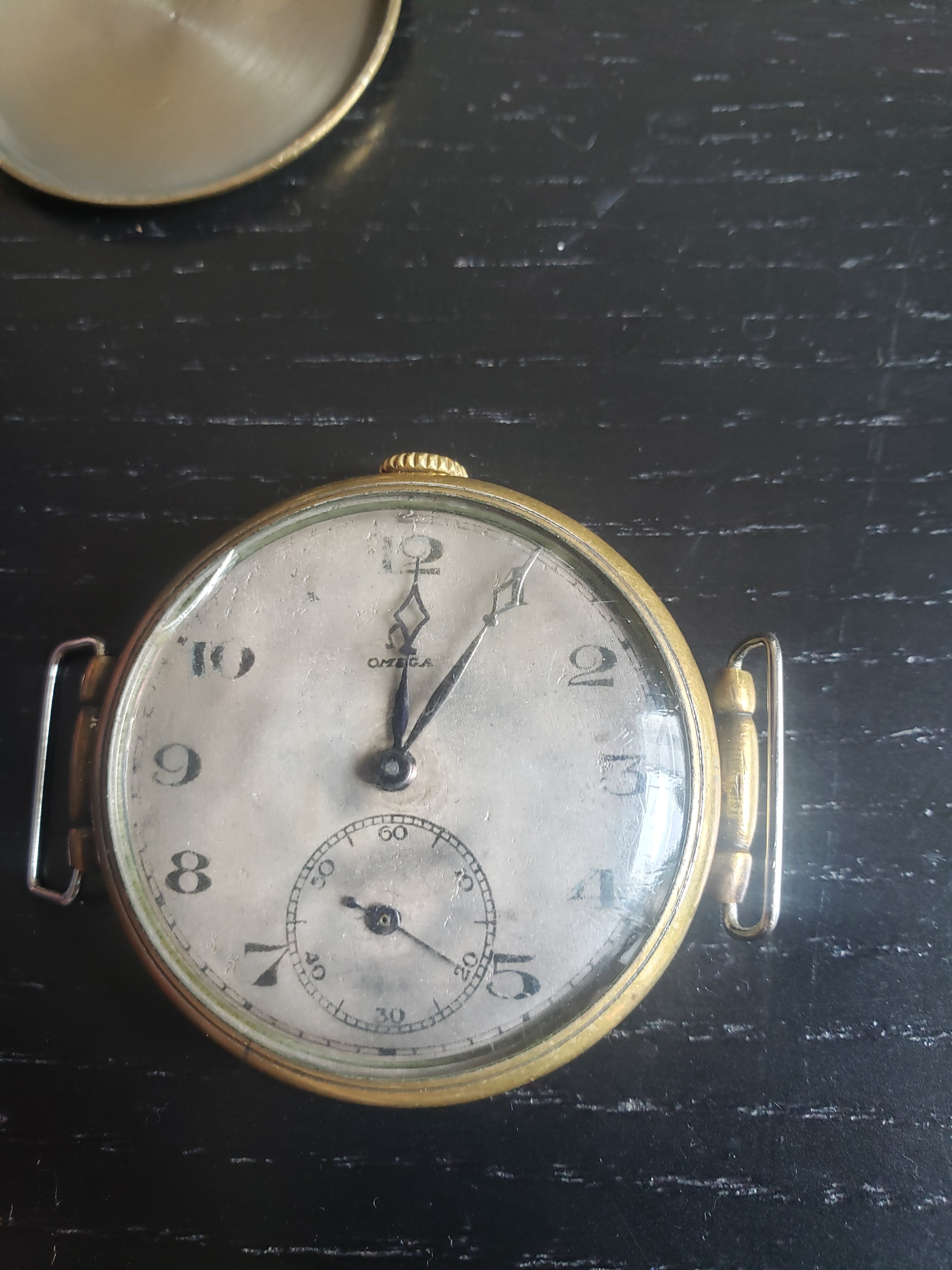

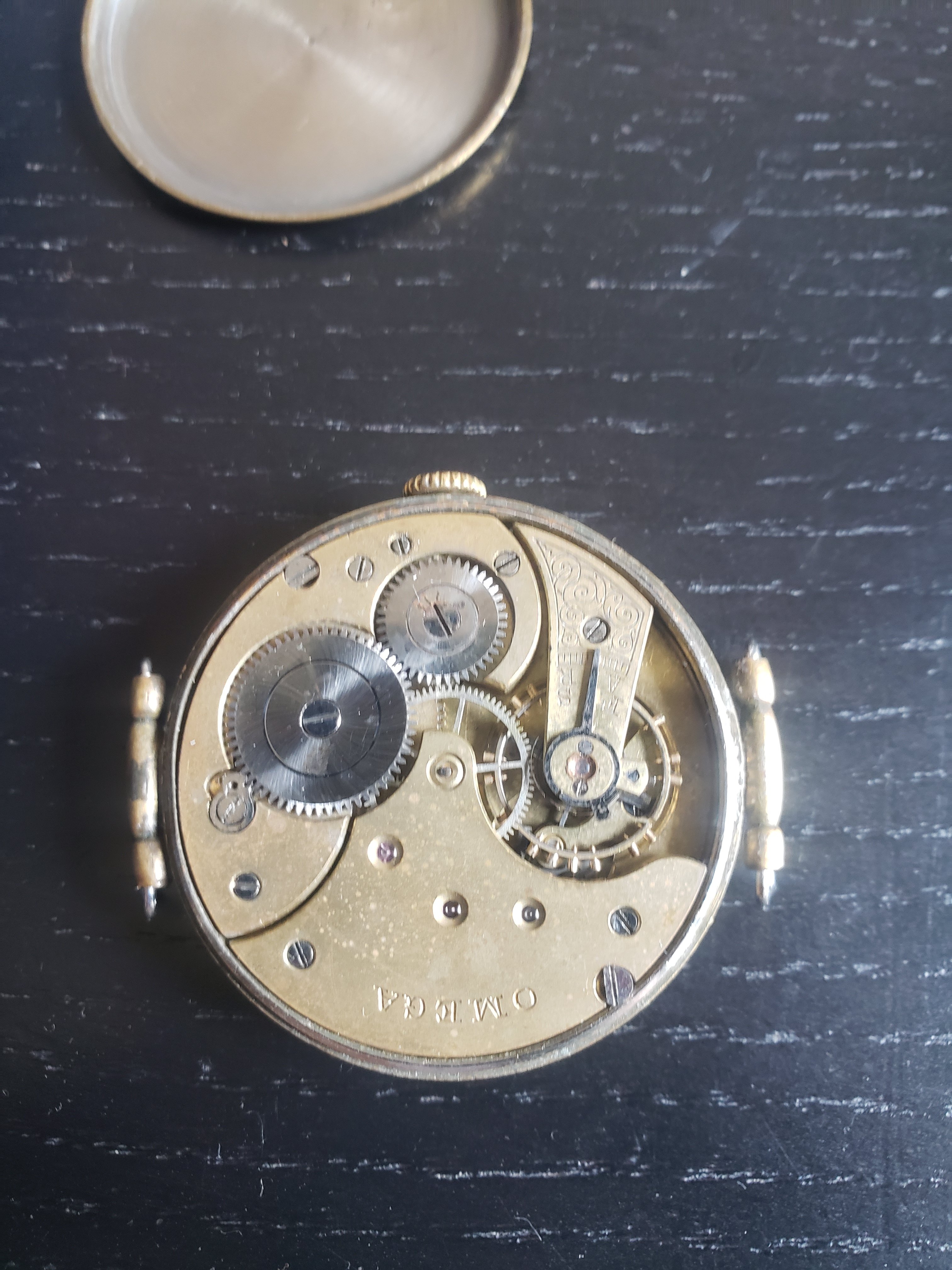

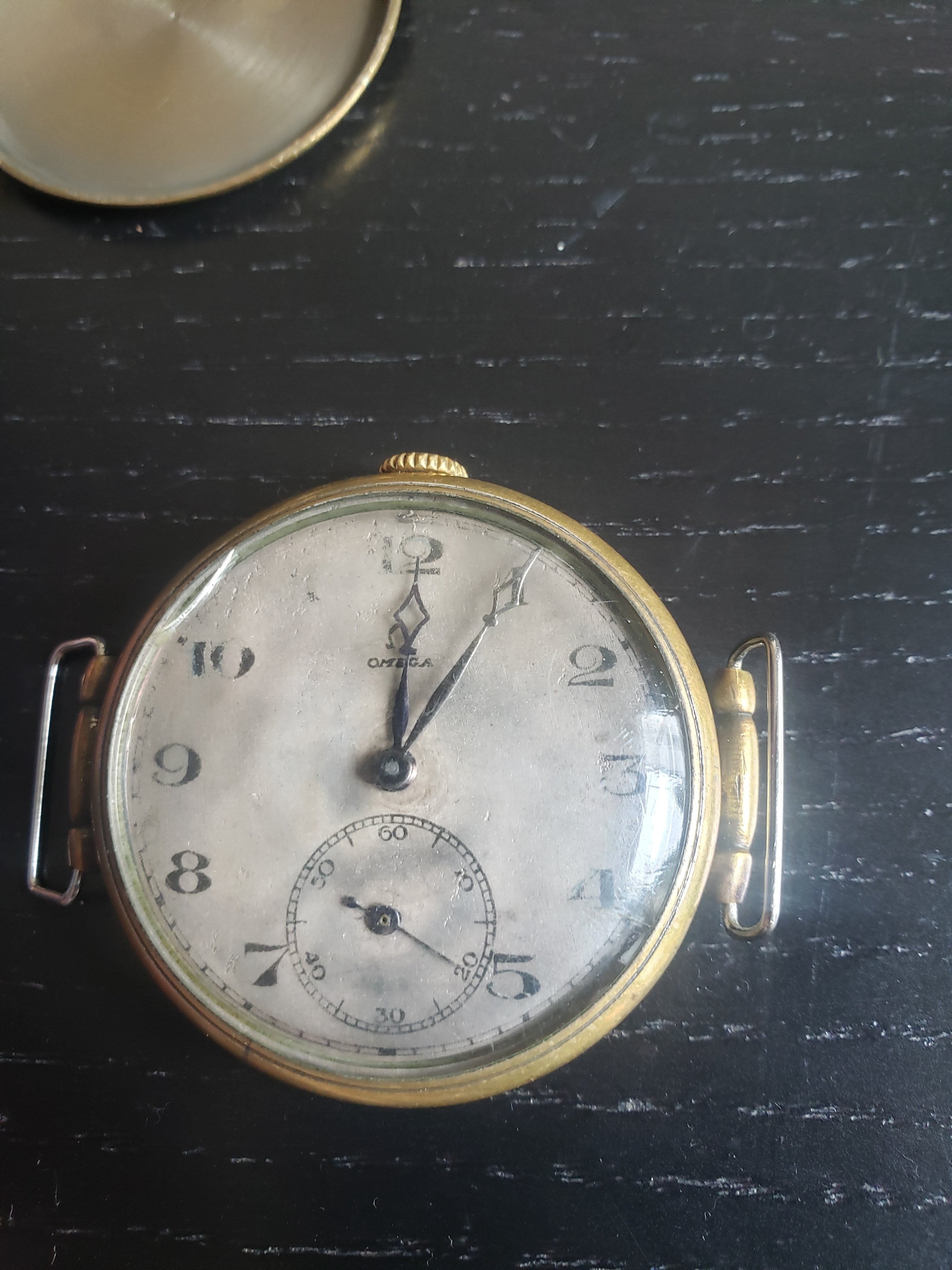

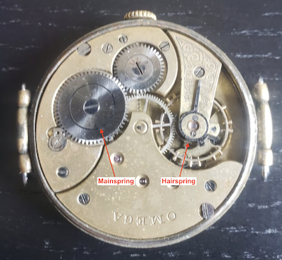

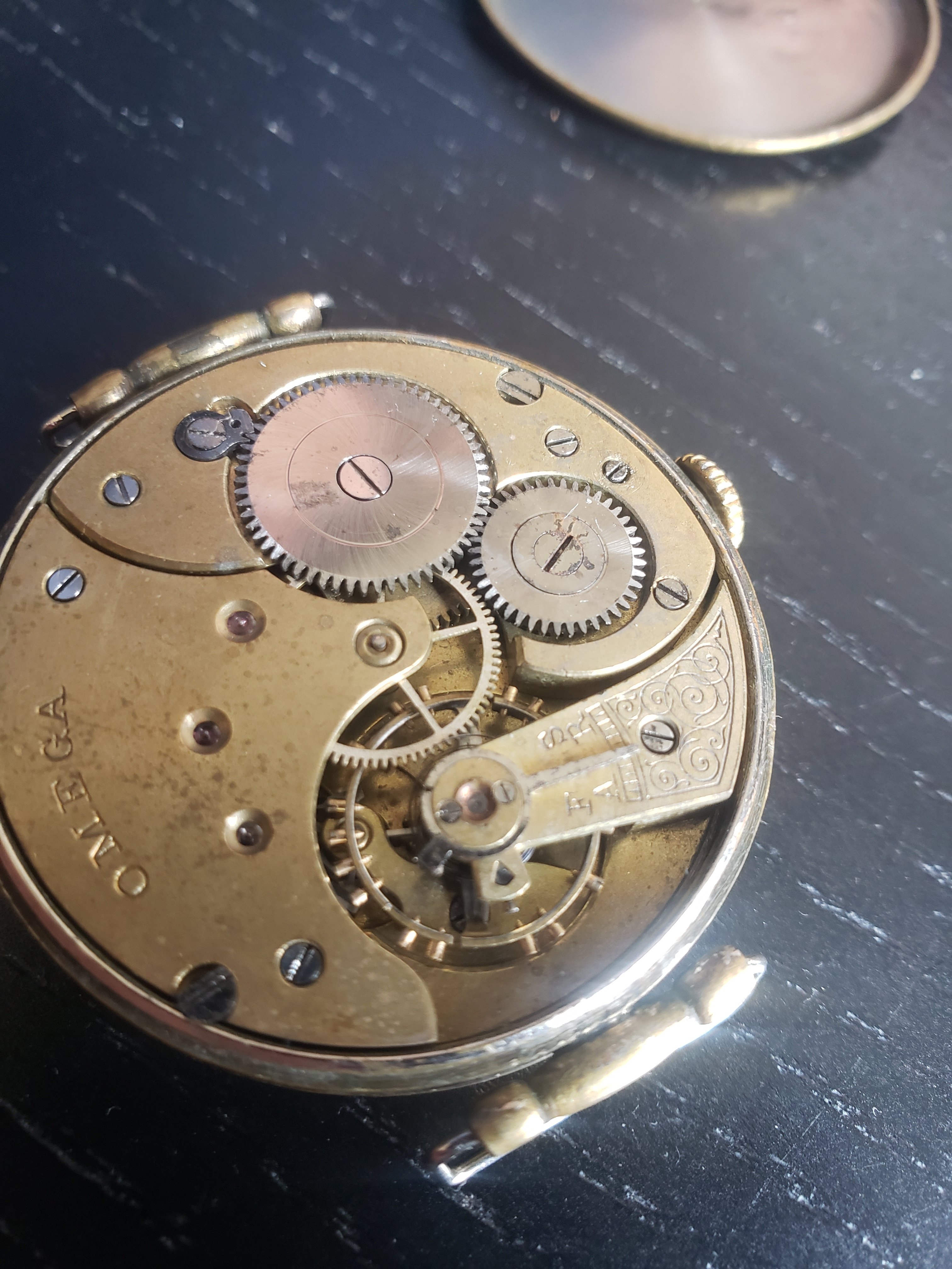

hello, I am new to this forum, and the omega life. My name is Nick. I have two omegas, one of them being this one shown in the pictures. I know nothing about it, and it needs a new hairspring. The old one snapped, but I do not know what size movement it is, so I am unable to find one to fix it. I believe its from the early 20s if not earlier. it did run for about 15 minutes after a cleaning until the spring snapped. If anyone has any information on this watch or a spring for sale that should work, please let me know.

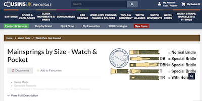

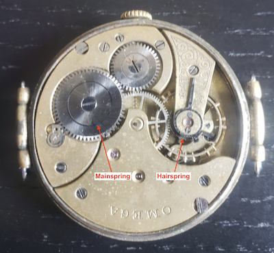

Hairspring or Mainspring?
If you need a new mainspring you can remove the old one, measure it (Length/Width/Thickness) and try to find a generic size that will fit.

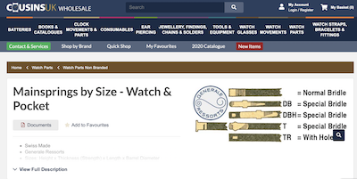

Cousins UK has a good selection.
Who cleaned the watch? You really need a watchmaker to work on it, they will be able to assess the issues and source parts. It is not really a DYI project. You can often find recommendations for watchmakers in your are by searching the site, or just asking.
3
i had a professional watchmaker do it. he said the balance spring broke, and that he cannot find parts for it, because the movement is unstamped.
it was the hairspring that broke. does that site do balance springs as well?
Makes sense, sorry I can't help. This is way outside my knowledge base. Hopefully others can help.
The movement can be removed from the case and measured. That will give you a good guide to what caliber it is.
Once you have that, you can search for a "balance assembly complete" for the base caliber and later variations.

Have your watchmaker contact this guy:
https://www.henningwatches.com
Do not do it yourself, he won't talk to you. He services the trade only.
He won't be vibrating a new balance spring...not part of his services.
This - the first step is correctly identifying the movement, which the watchmaker should have done as part of the service.
Then the search for parts can begin.
