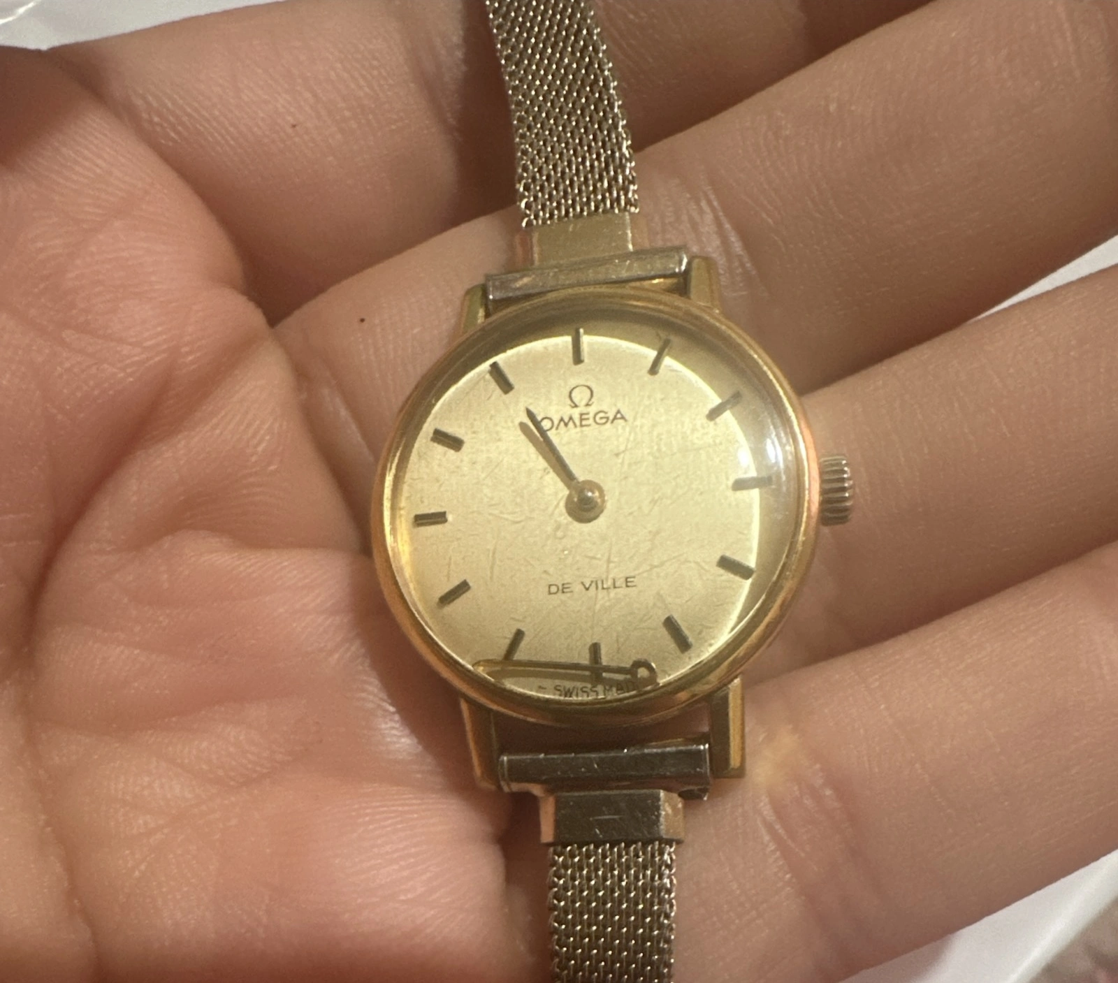

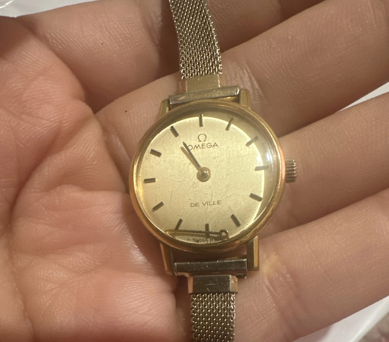

Hello, I am new to this forum but I need help with my women’s vintage omega de ville watch. This watch is very small and the watch hand fell off. It is now just moving around inside. Who would I be able to take for this fix? The watch isnt working now. Also just as a heads up what cost of this fix should I be expecting? This is my first time having to take a watch for repair as its my first watch.

You need to find a watchmaker, also called watch repair. It should not be an expensive or difficult fix, assuming the watchmaker is willing to do a piecemeal repair without a full movement service.
Until the watch stops, make sure that the minute hand stays at the bottom, out of the range of the hour hand. If it gets dragged around, it could damage the dial.
