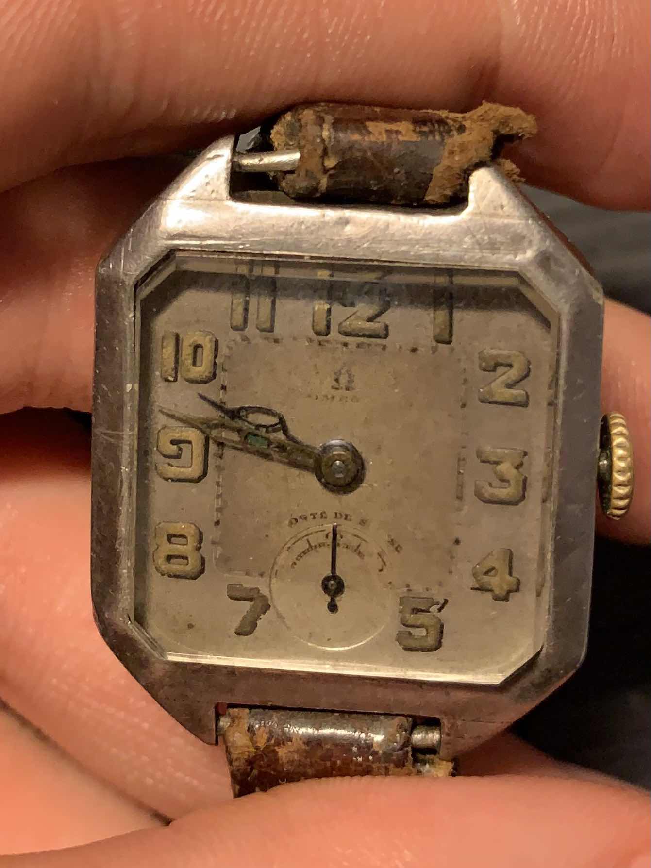

Hi,
I recently purchased this vintage WW era Omega from Ebay and was wondering if anyone has any deeper knowledge about this one, couldn't find any similar ones with a simple google search?
Also I'm worried about the radium, could I bring this to a Omega Service Centre for them to apply some non radioactive substitute?
3,653
7,770

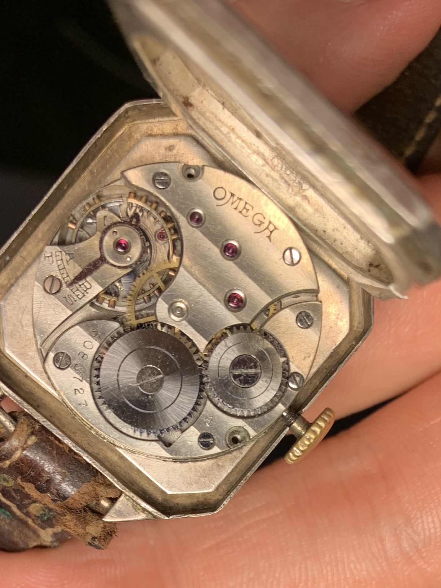

The watch looks authentic. Movement is a cal. 23.7
I would keep the watch as is. Radium is not dangerous for you as long as you don´t open the watch completely (inhale radium-dust).
Omega would ask hefty money for the service and you will lose the originality of the watch.
If you intend to wear the watch have it serviced by a competent independent watchmaker. If not, keep it as is...

Hello, are there some inscriptions inside (or outside) the caseback? If yes pictures would help determine if the case is Omega factory or a distributor one.

Hi, sorry for late reply but caseback says Fab Suisse

No serial number inside or outside the case?
Close but not exactly the same as this model, found in a 1925 catalog of mine (the case is named 'Tortue carrée', square tortoise in French
