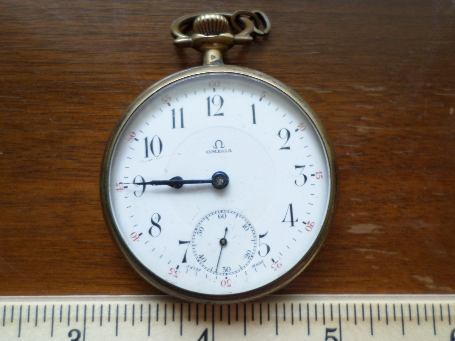

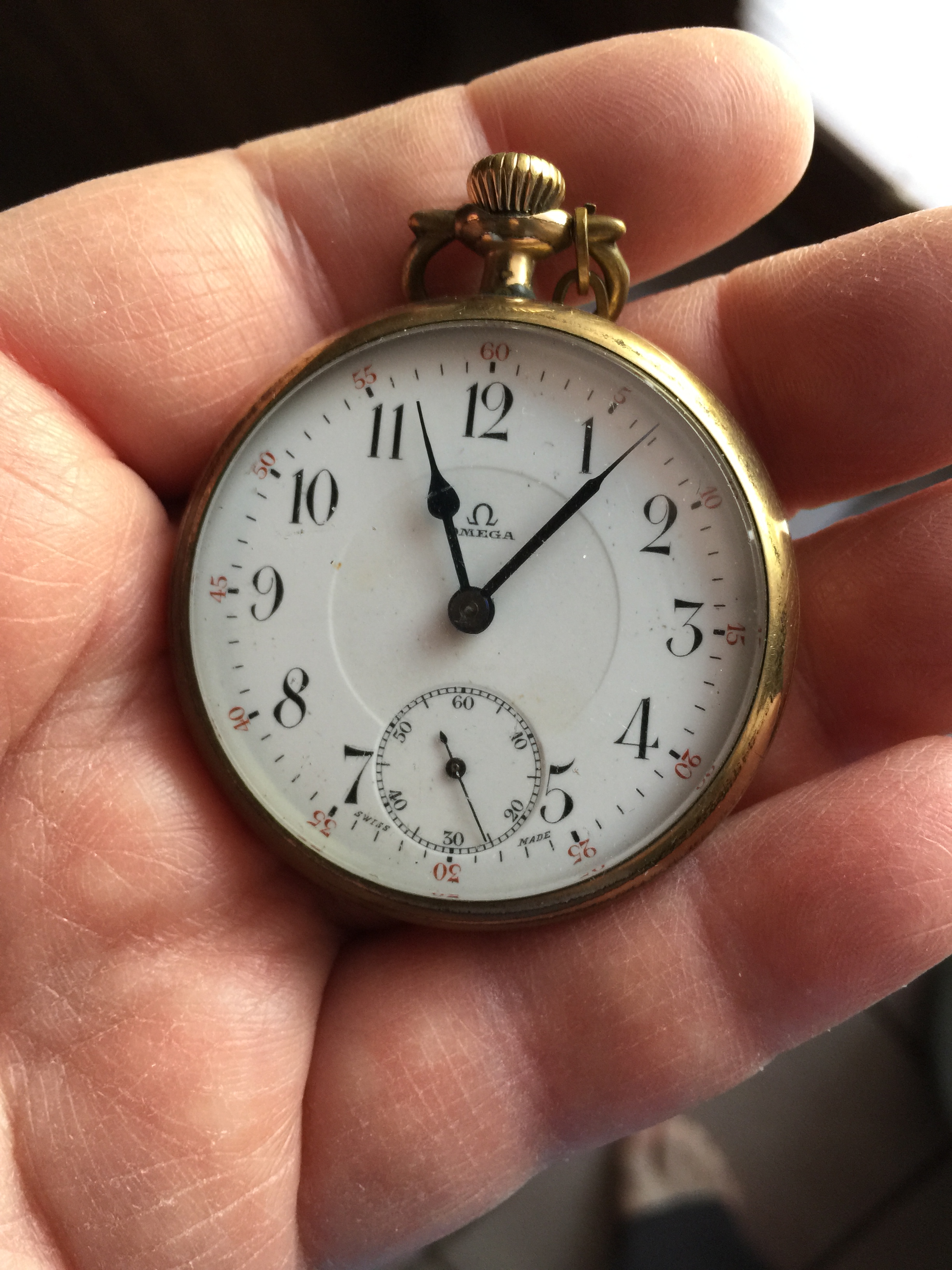

When I see a dial like that I always assume it's a redial
Thanks for replying. Is a redial bad? The dial does have a hairline crack going from the 4 to the sunken seconds sub- dial.

A redial is considered bad as most collectors don't collect redials
I'm not an expert though, someone more experienced can make a more definite comment, but logically it's a redial too as the condition is just too good for 100+ years
Not really an issue if you're just going to enjoy the watch as a watch

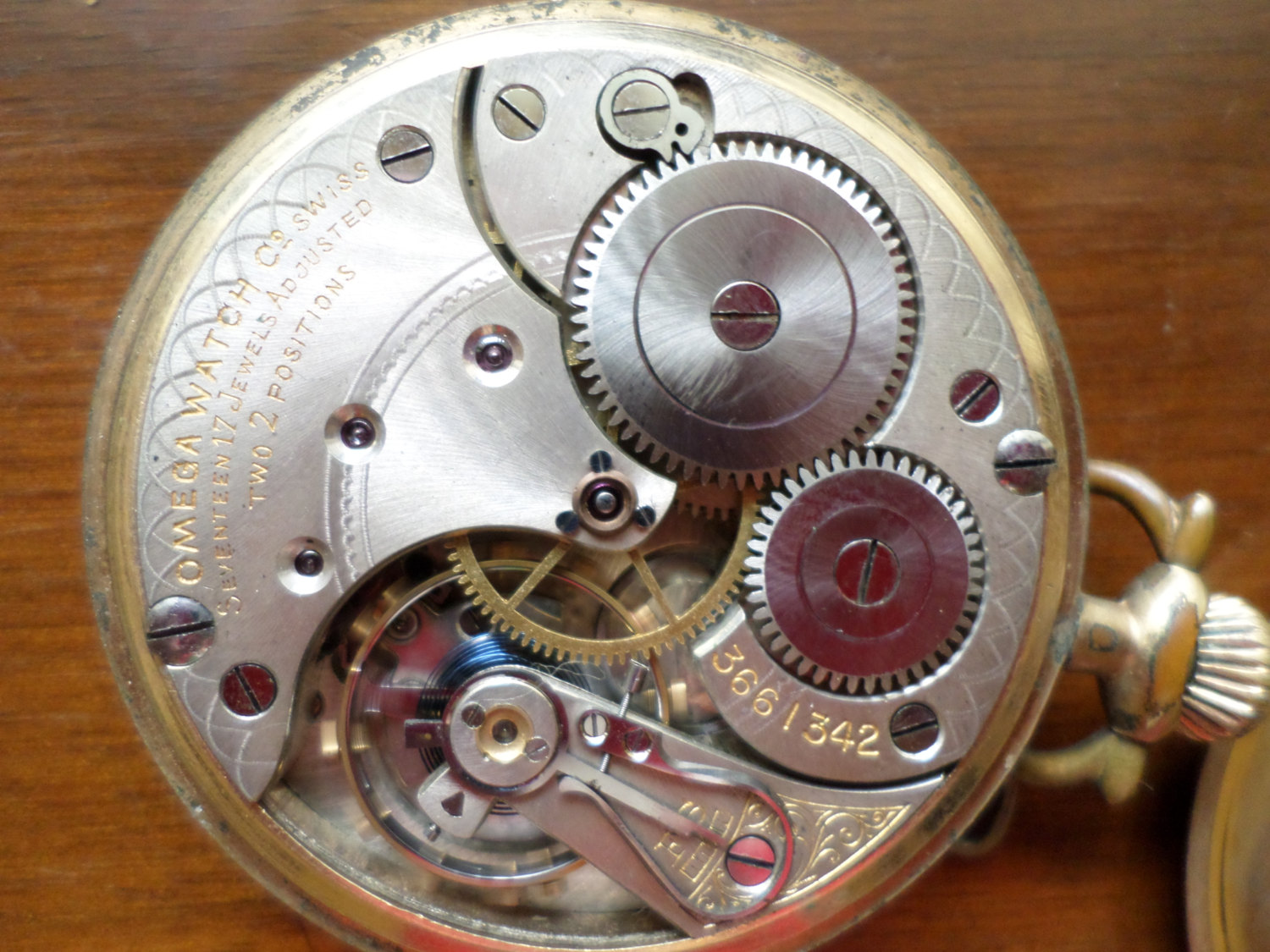

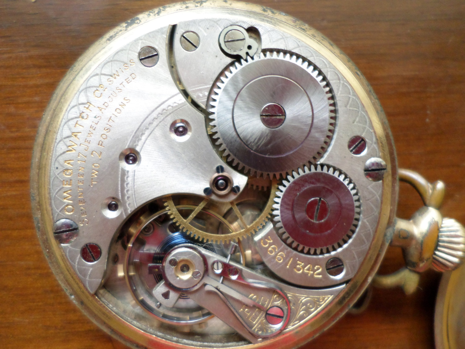

I'm no Omega expert but I believe it is a 19 ligne, though it's certainly not a 15 jewel movement.

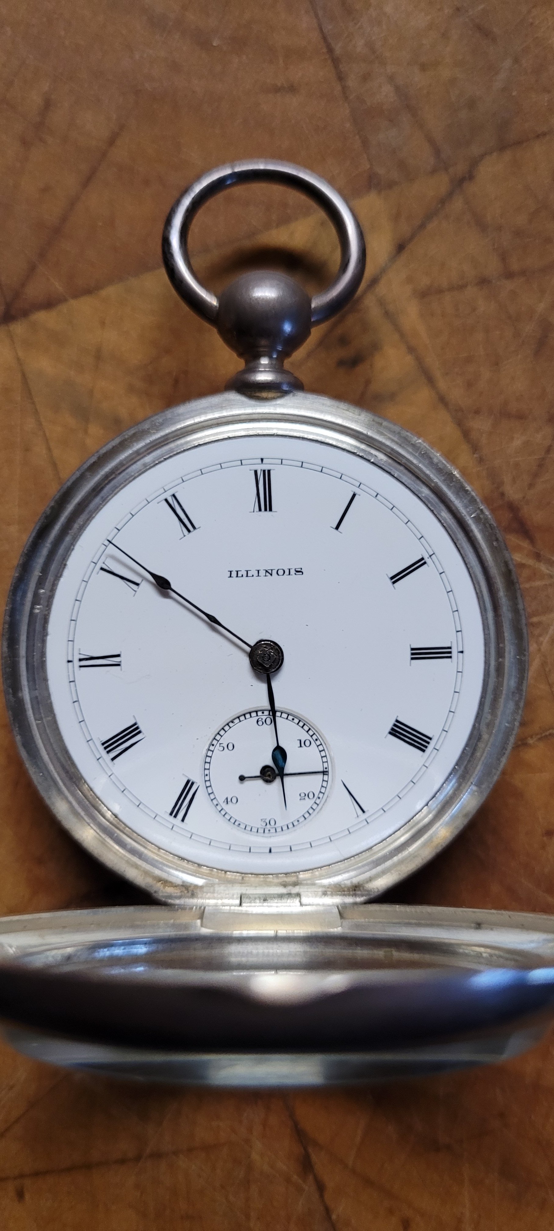

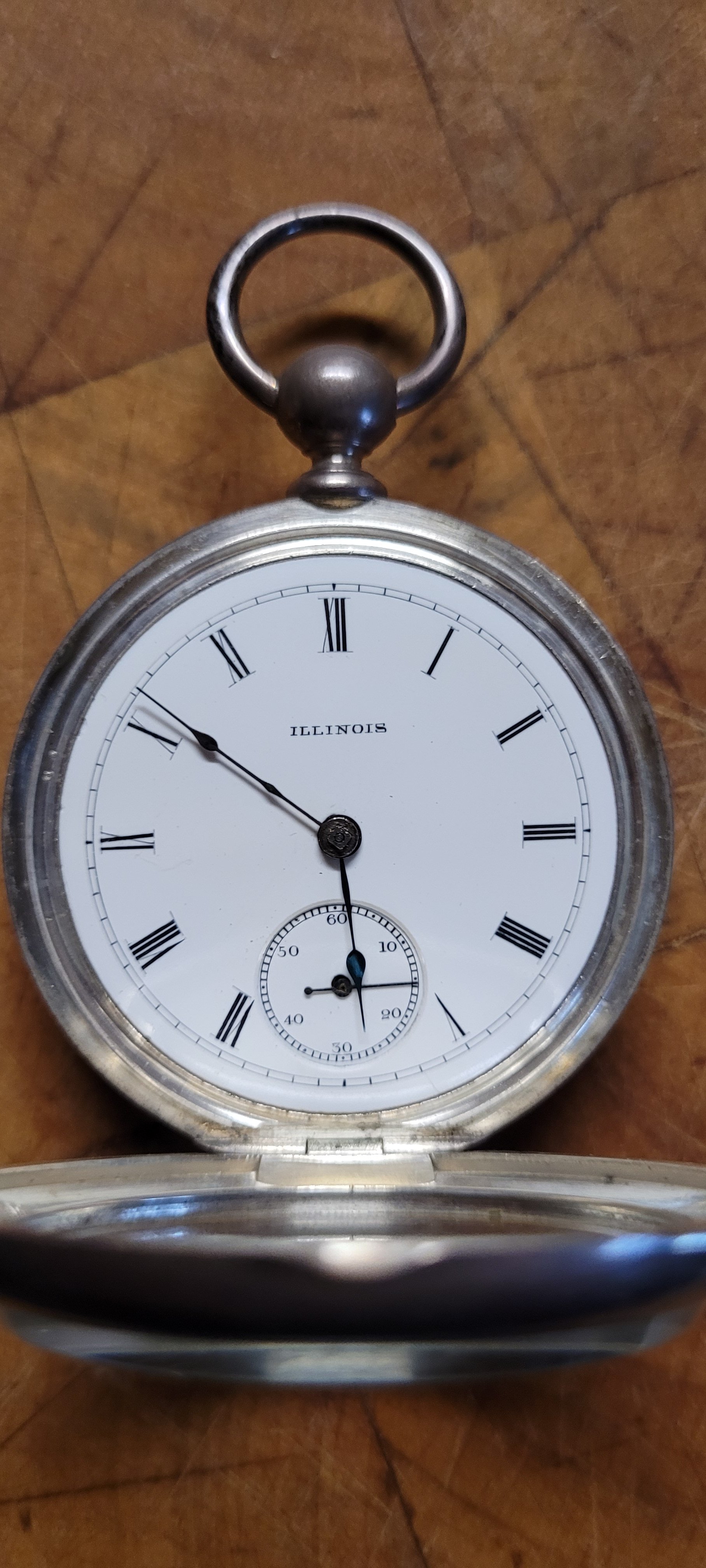

It's not a redial. The dial is vitreous enamel, they hold up exceptionally well as long a they aren't roughly handled. Here is one of mine made in 1883.

The movement serial number says 1911/12 IMO
Thanks, that would make much more sense. I was going off a site that dates by the serial number. I am even more delighted that I have ended up with a WW1 Omega pocket watch. 😀
