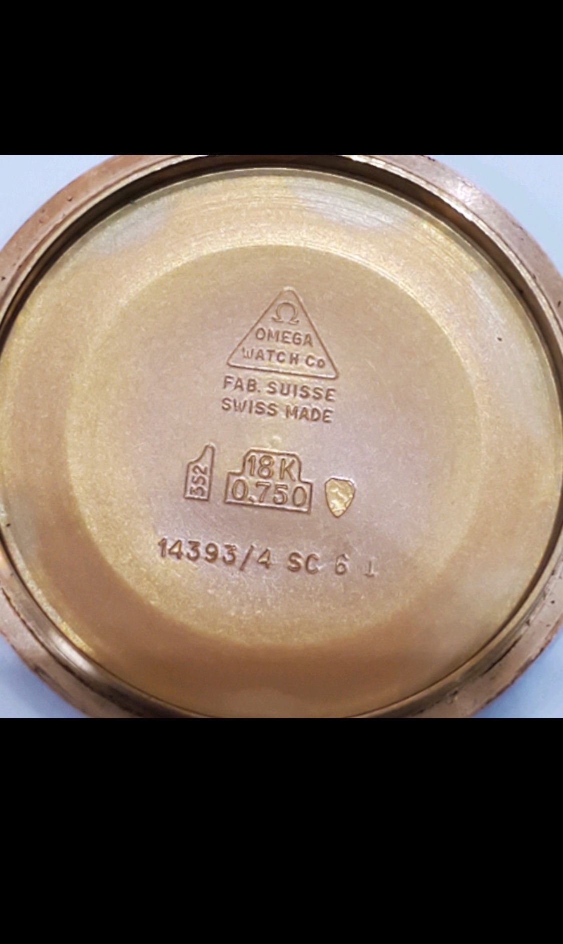

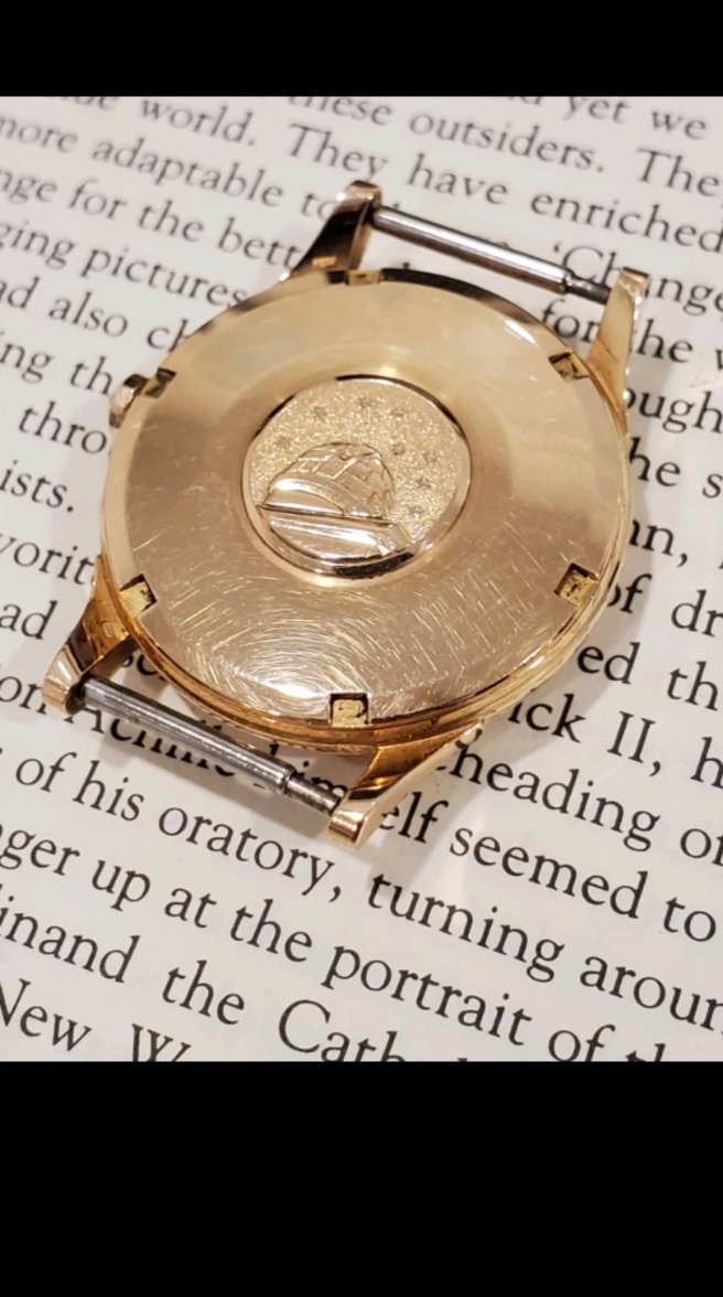

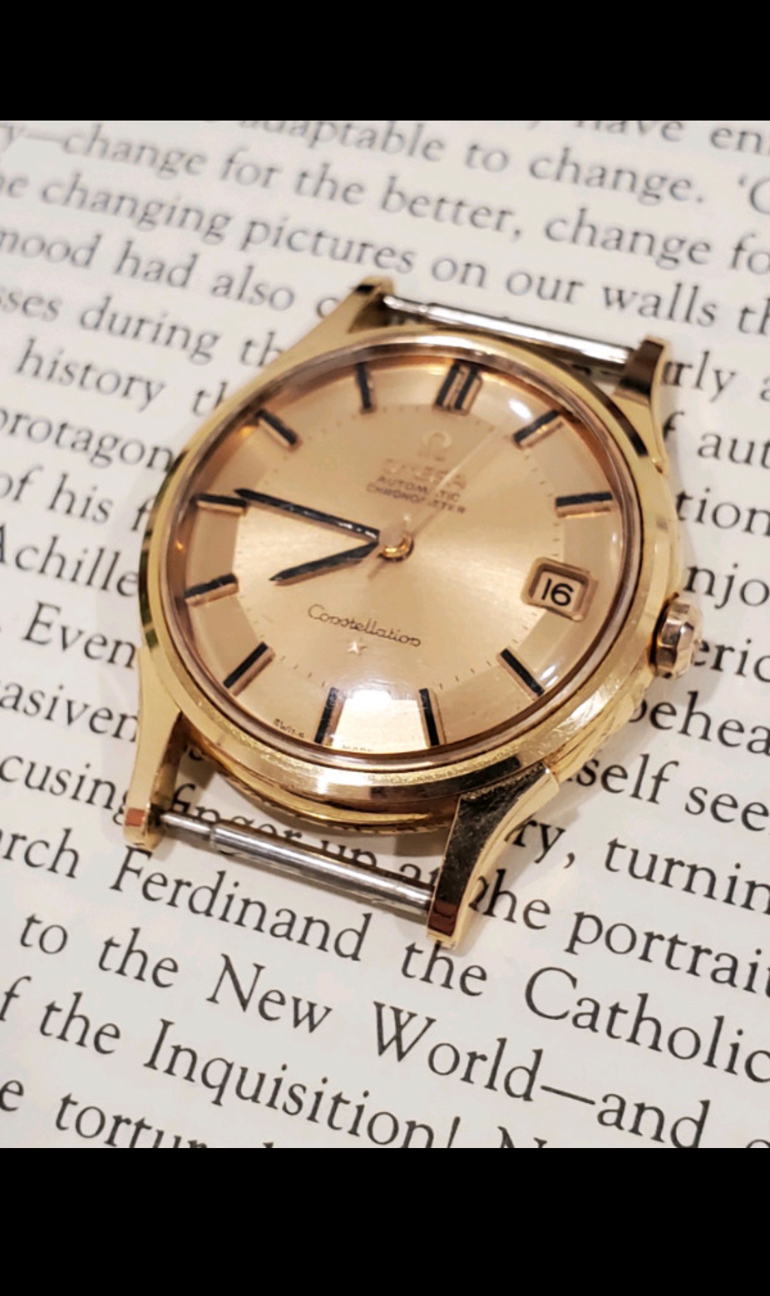

Hi. This has been offered for sale locally and my brother had asked me to post the photos here for your opinions, feedback and/or any red flags. From a quick glance, the hands look off to me. If possible, what’s a fair price to pay for this? Thanks

$3500 CAD which is around $2750 USD

Yeah wrong hour and minute hands. Unless you want to chase for the correct hands (probably be from a donor watch), I would pass.

You are correct in your assumption regarding the hands, we’ll the minute and hour hand at least. Better pics might show the seconds hand is correct.
Judging by the wide onyx marker this is a de luxe model ref. 14394 and if so will have an 18k dial.
The case looks nice and sharp with little signs of polishing.
We just need to see a better pic of that dial.

The black on the markers looks painted... like the hands.
