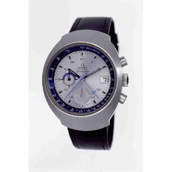

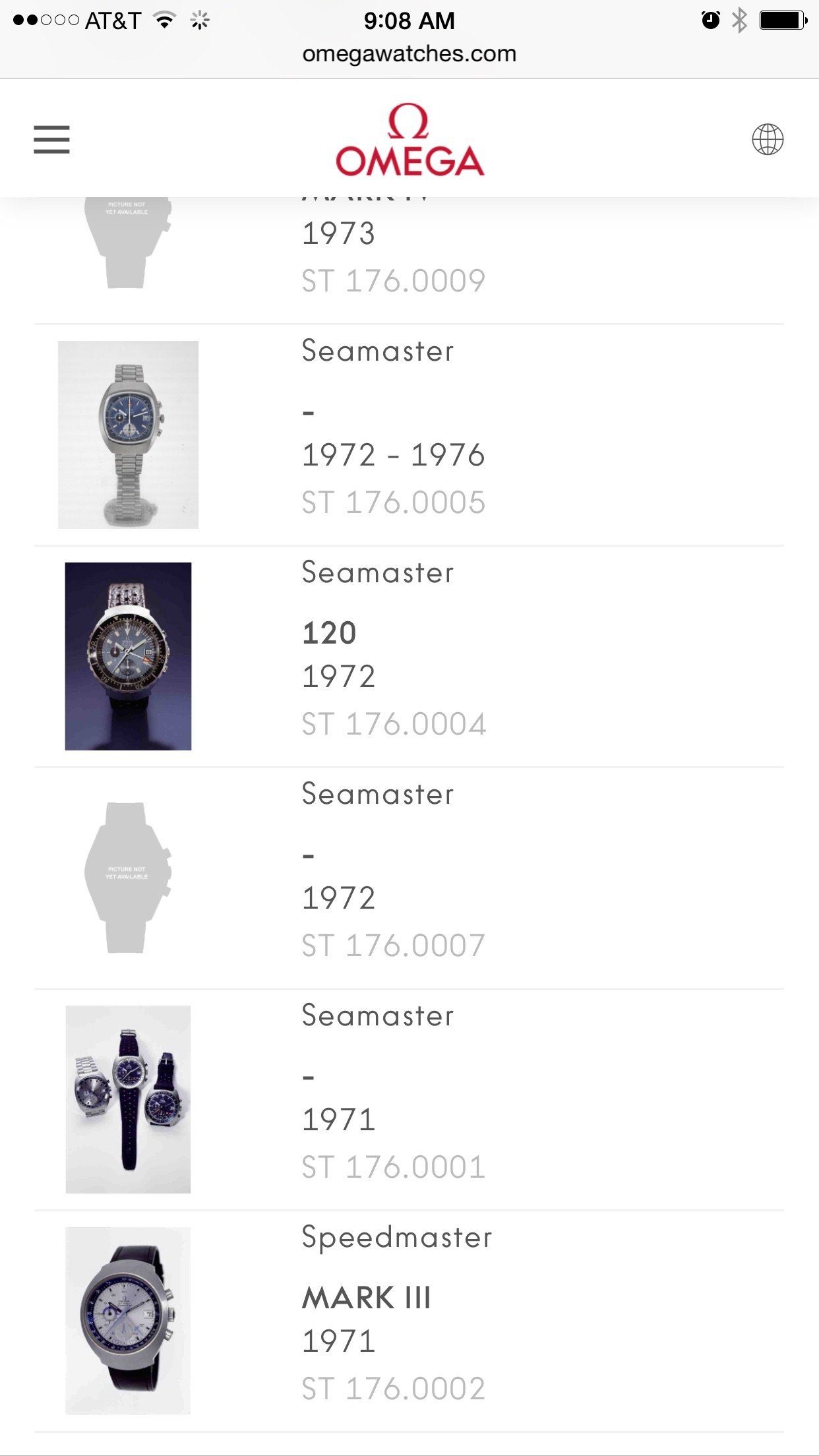

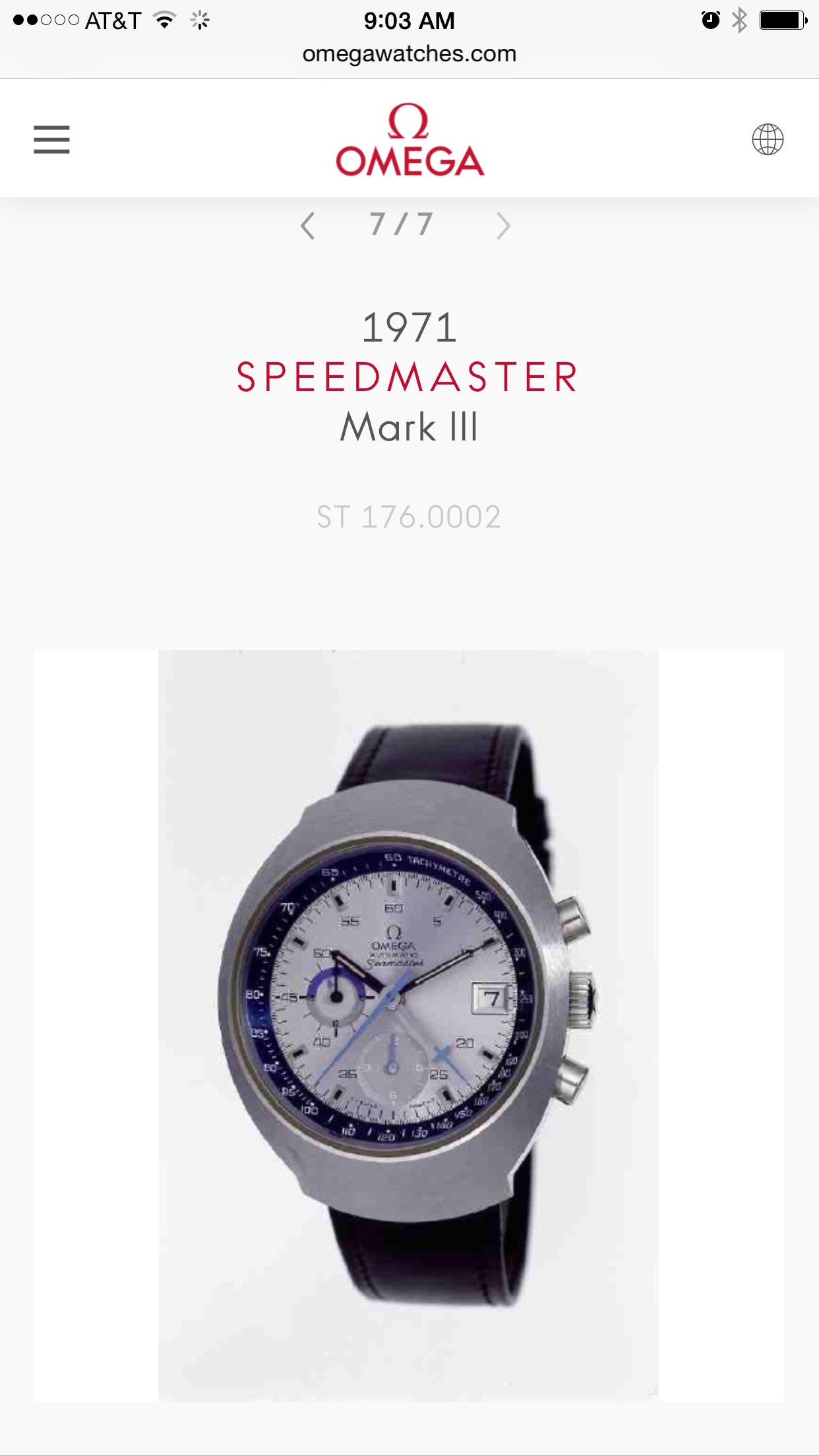

I don't have much opinion on them, and only note that - bizarrely - when you search the Omega vintage database for the 176.0002 "Speedmaster" the site shows a picture of a watch that looks like a Speedy Mark III in all ways except the face of the watch reads Seamaster!
Though, the Omega vintage database has a lot of quirks, especially in its photo choices. For example, note that for the 176.0007 the website has no photo, but for the 176.0001 the website has a photo of three 176.007s (the same photo from AJTT used to demonstrate the three different available chrono rings used on the 007s):

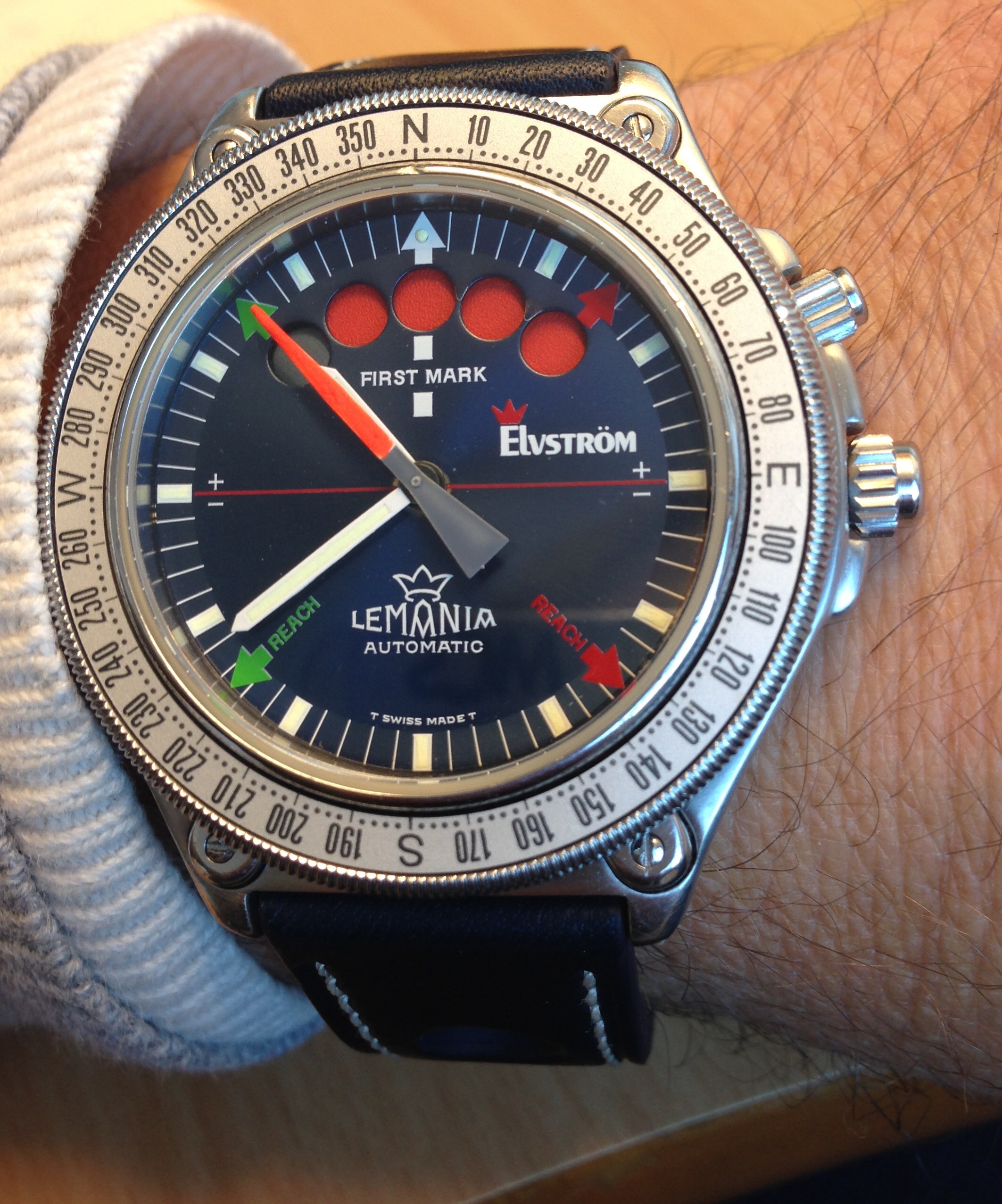

Lemania 1345. 15 minutes regatta fly back count down timer.
Movement details here: http://thewatchspotblog.com/?p=48

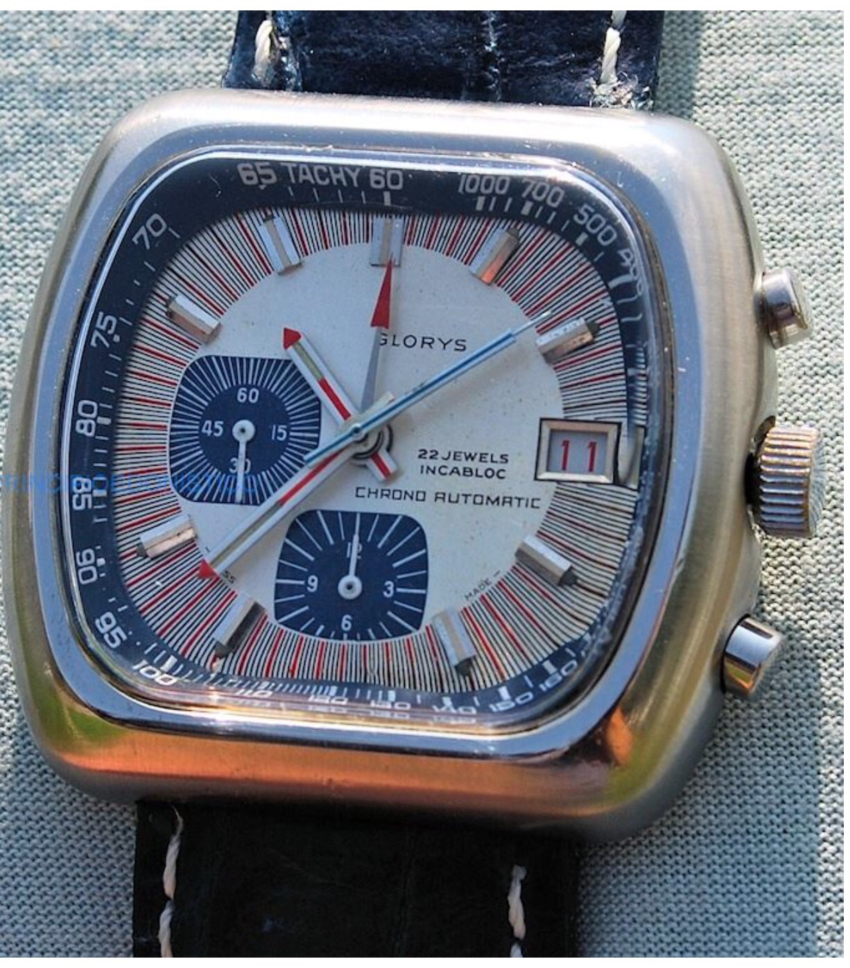

Here's another non-Omega brand that used the Lemania cal.1340 (which is a differently-branded version of the Deffa watch in the review):
You bring up a couple of interesting points.
One is regarding the "Seamaster 176.0002" in the vintage database, which is the same one pictured in AJTT. I have spent a lot of time thinking about that watch. It’s a really strange choice to be the one they use in the vintage database for the simple fact that that case reference is known primarily for being part of the Speedmaster family - and an important part of the family (the first self-winding Speedy) at that. And even if one believes in the existence of real/correct dials with both "Seamaster" and "Mark III" on the dial, it is notable that this one doesn't even say "Mark III" on it. And again, 176.002/176.0002 are references synonymous with the term "Mark III" and the Speedmaster family. So using it in the Vintage Database is bizarre, even if real. I assume that the person in charge of populating the database wasn't that familiar with the reference and just snagged the first pic from AJTT without further diligence.
Personally, I'm hesitant to pass judgement on the authenticity/correctness of that particular piece. But I will say this - If a nearly identical watch came for sale on eBay, the forums, or any other venue I'd pass under the assumption someone just added a dial from a 007 to a 002 case. Partly because it is so easy to mod these common references into something that appears really rare, but also something else you bring up - those quirks in the database.
Really, it brings up the larger question of just how credible AJTT and the Omega Museum actually are as sources of absolute truth. I'm not claiming to have any specific knowledge, and I'm just some guy so their word carries tons more weight than mine. But as you pointed out, there are errors on the database. There are also known errors in AJTT involving watches that are redials or blatant fakes (those vintage Seamaster 300s with "stubbies"). I'm not suggesting that this is conclusively the case with any of the 1040s featured but it is possible.
Finally, we know that the curators are just humans and have to make judgement calls themselves, and they acquire their pieces just like we do from sources like eBay. I trust they are doing their best to acquire pieces that are representative of Omegas long history including the uncommon references, and would never intentionally put something in the collection that they deem to be unoriginal but they have made mistakes. They are an important and authoritative source, but not 100% perfect either.

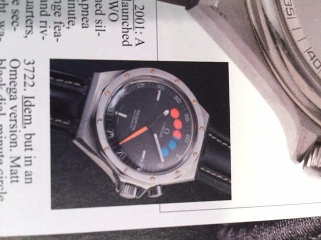

Sigi:
Here are links about some cal. 1345 watches:
http://www.regatta-yachttimers.com/brands/lemania/
Your question jogged my memory, because I had forgotten there was an Omega prototype that used cal. 1345 as well in 2001. More pics here: http://www.regatta-yachttimers.com/brands/omega/ and one from AJTT:
My understanding is that Omega and Lemania showed this cal. 1345 prototype at Basel in 2001 but never released it. At Basel 2003 they released the Seamaster Apnea, but it used a 39 jewel movement (cal. 3601, base ETA 2982-A2).
As far as I know Omega actually delivered a few to Australia. They sponsored a sailing event and the watches was sold/given to the participants.
I was attempting to purchase one a few years ago.

4,440
18,267

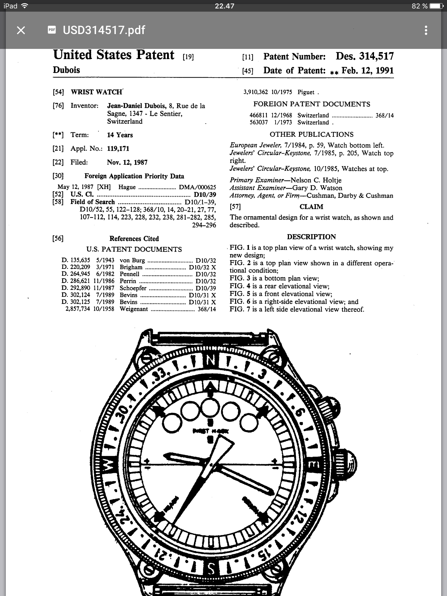

Thanks! Odd that AJTT mentions this being shown at Basel 2001 when this link clearly demonstrates this watch being from 1986. Makes much more sense - that case style was not very 2001.
2001 makes no sense at all.
The 1345 is a child of the 80s.
The Lemania Elvström was the most elaborate as it also have tactical functions embedded. It was even patented:
