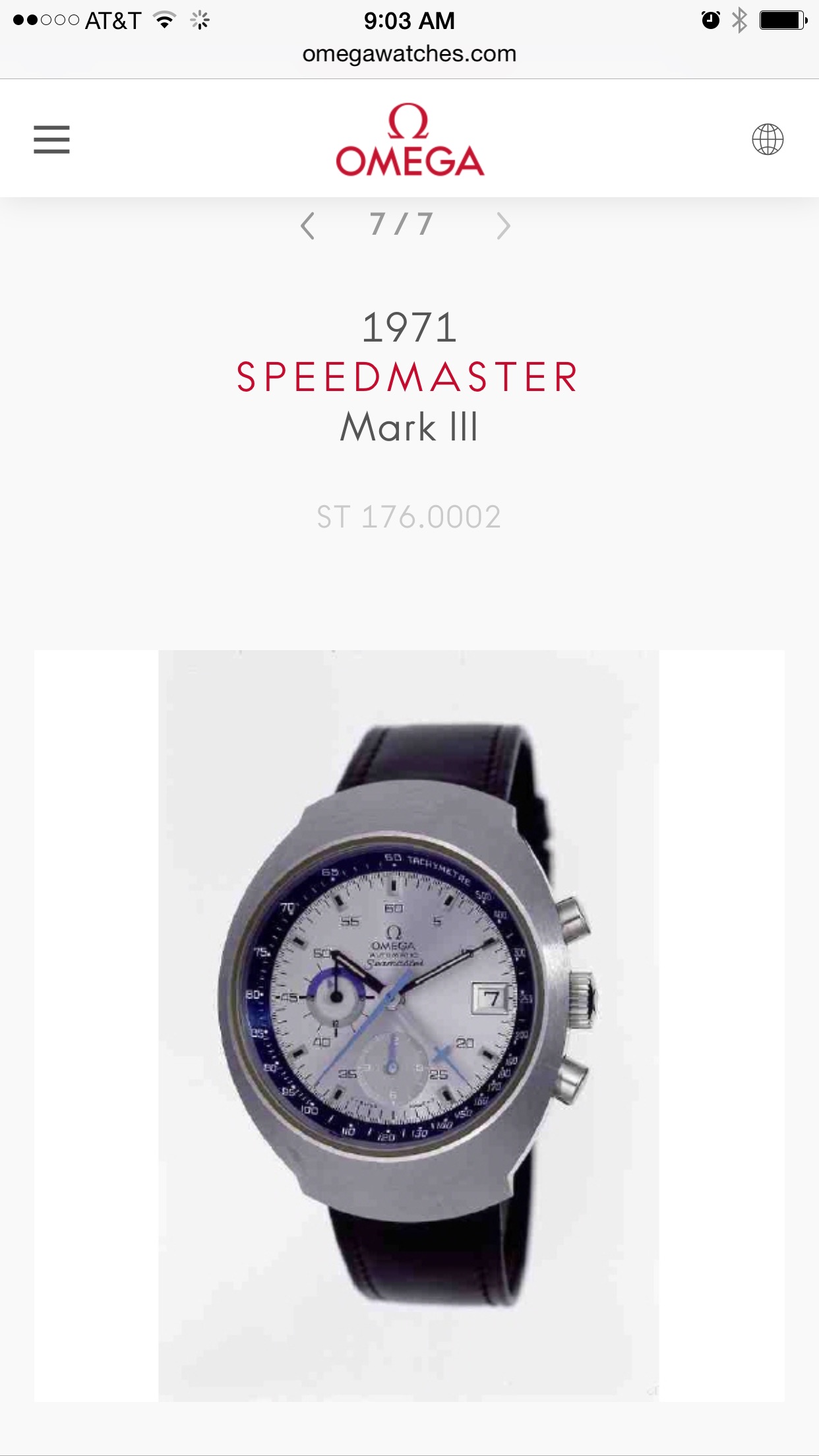

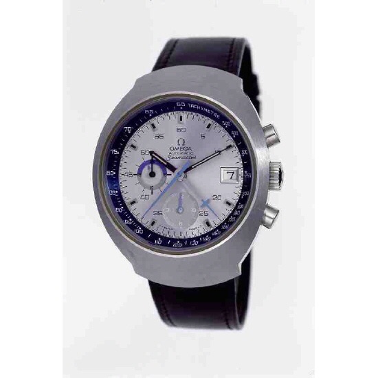

I don't have much opinion on them, and only note that - bizarrely - when you search the Omega vintage database for the 176.0002 "Speedmaster" the site shows a picture of a watch that looks like a Speedy Mark III in all ways except the face of the watch reads Seamaster!
Just noticed that this is the same image that also appears in the book and you called it "Mark 007" in your slides.

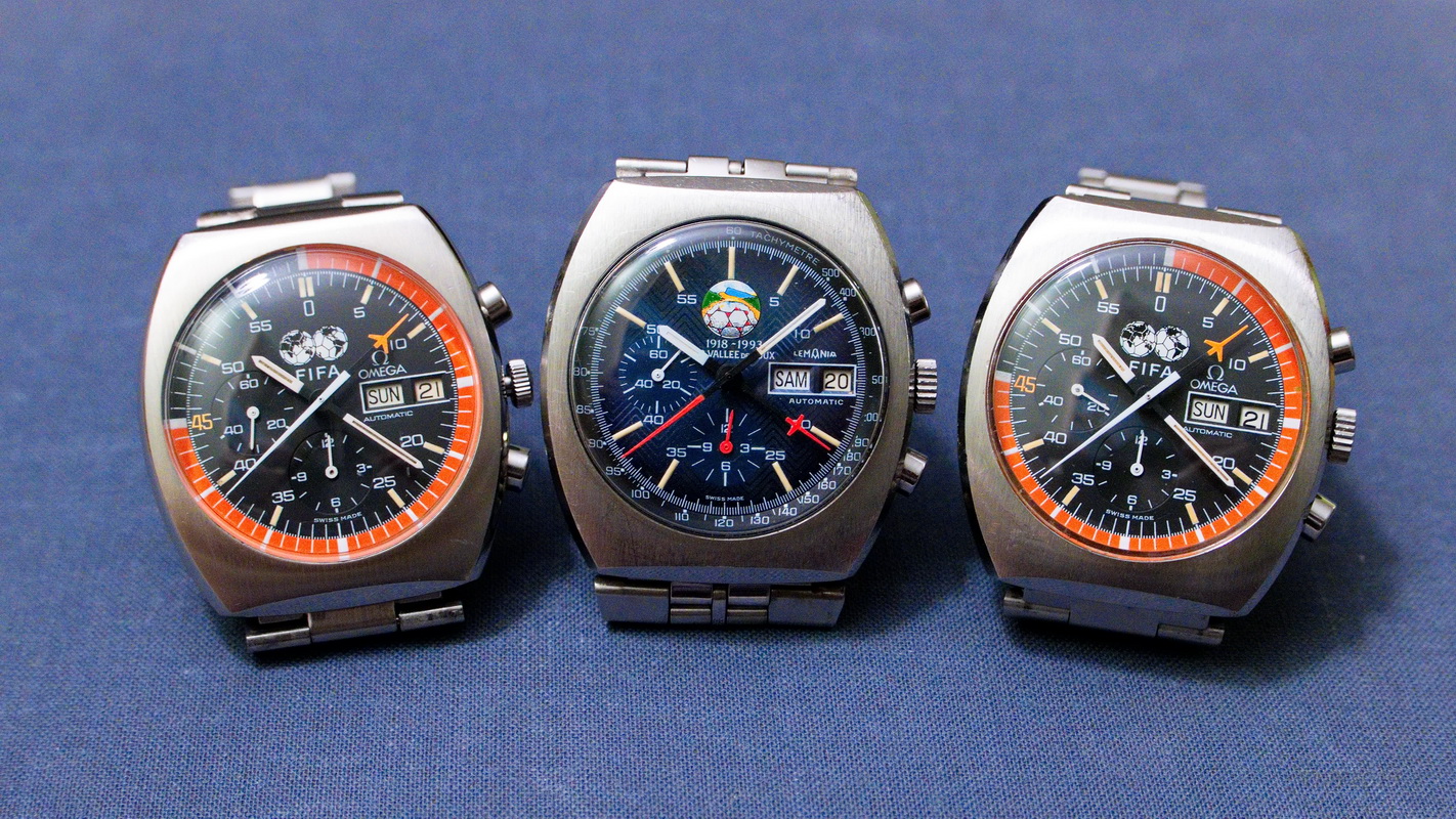

Some more fun to the family:
Cool to see all those together!
Is the Omegas beating at 28800?
Assuming the Lemania is a 21600 cal 5012?
2,876
1,963

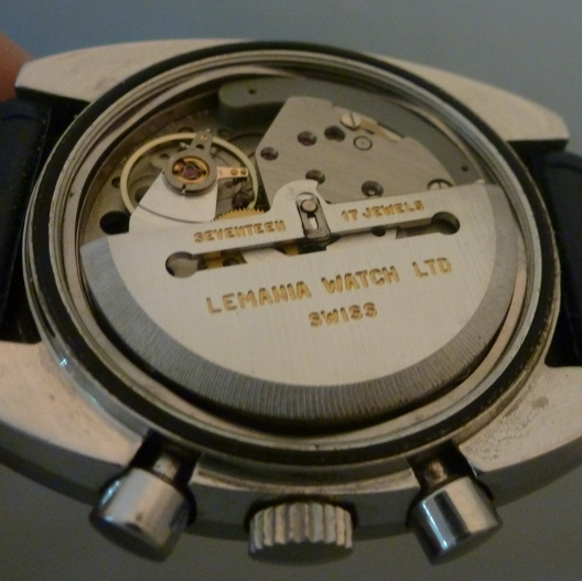

Yes, the Omegas both beat at 28800bps and both are stamped 1045. I haven't had a chance to see what happens with the 24h pivot area on the movement yet.
The Lemania also beats at 21600bps like you already know, but it does not say 5012 anywhere on the movement. It looks just like the 1045/5100 in all apearances without being taken apart though.

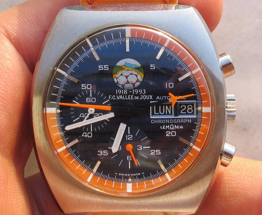

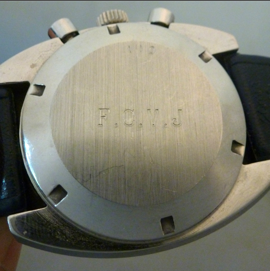

Interesting. Is the Lemania movement labeled Lemania/LWO or is it Tutima branded? There's a peculiar FC Vallee de Joux on eBay currently with Tutima-branded cal. 5100. This one also has the orange/black inner bezel that the Omega FIFAs have, so I'm guessing this watch is pretty much put together.

It is Lemania labelled. It's also stamped FCVJ with a limited number on the back. The one with Tutima label is certainly a put-together with wrong movement, wrong bezel and no stamped caseback. The one Mr. Maddox had also is not a true FCVJ issued since it does not have a stamped caseback either. The movement is also labelled 5100. http://www.chronocentric.com/forums/omega/index.cgi?md=read;id=49577. Another member here does have a true FCVJ with a stamped back, however.

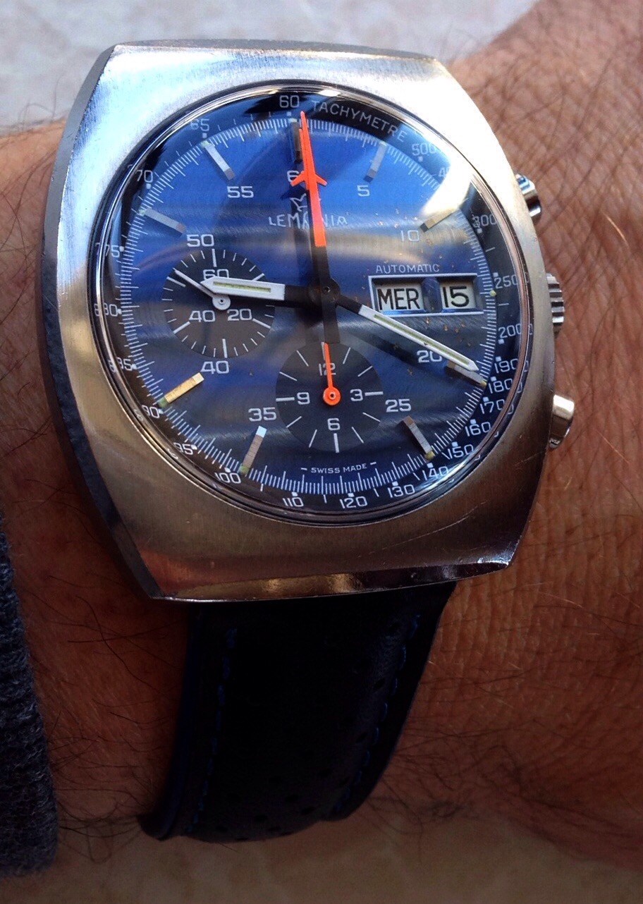

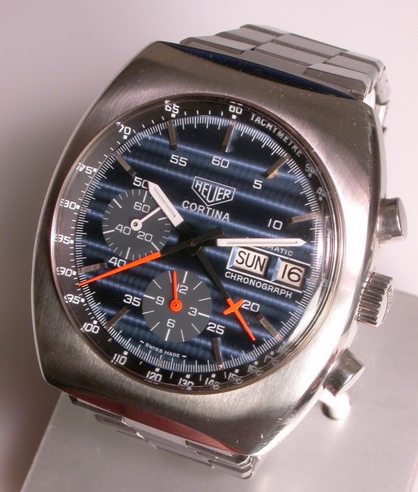

Here's my version of the same. Lemania 5012. Case is identical to Omega, even ref number. The identical case and dial was sold as a Heuer (not mine pictured).
Heuer had a 5100 identical to the Omega FIFA.
4,440
18,267
The Lemania versions I have seen all had the cal 5012.
You would be hard pushed to spot the difference between a 5100 and a 5012, even from a dial shot, as the 24h indicator mechanism is on the dial side, and the only other difference is the gear train/balance ratio for the 21600 compared to the 28800 beat rate.
That's right - and AJTT specifically discusses and calls that watch a 'precursor' to the Mark III line. It's all very interesting. I chose to leave it in my slides as a viable watch model for several reasons, though will be happy to have it sorted out the other direction.
One reason for leaving in the slides is the AJTT treatment, which sort of goes out of its way to declare it a legitimate version - but granted AJTT is not definitive or even accurate sometimes. Another reason for leaving it in the slides is the Omega database usage of the photo; here again, not definitive. Also, given thle "Big Blue Speed" and "Big Blue Sea" that shared the .004 reference number, it wouldn't be strictly unheard of at this time in Omega history (or with the cal.1040 generally) for Omega to have attempted some now-seemingly strange cross-pollination between the Saamasters and Speedmasters, even sharing reference numbers. Finally, I'll also have to go back through my notes, as I think there were one or two other pieces of data that pointed toward this reference's possible existence from the factory; though also not definitive, individually. Collectively, though, all these pieces certainly leave open an interesting question about this reference's existence. Accordingly, I left it in the slides, to be no less accurate than AJTT or the Omega database, and personally am agnostic on its existence.
But if you've got one, I'm certain it's fake, and I'll take it off your hands.

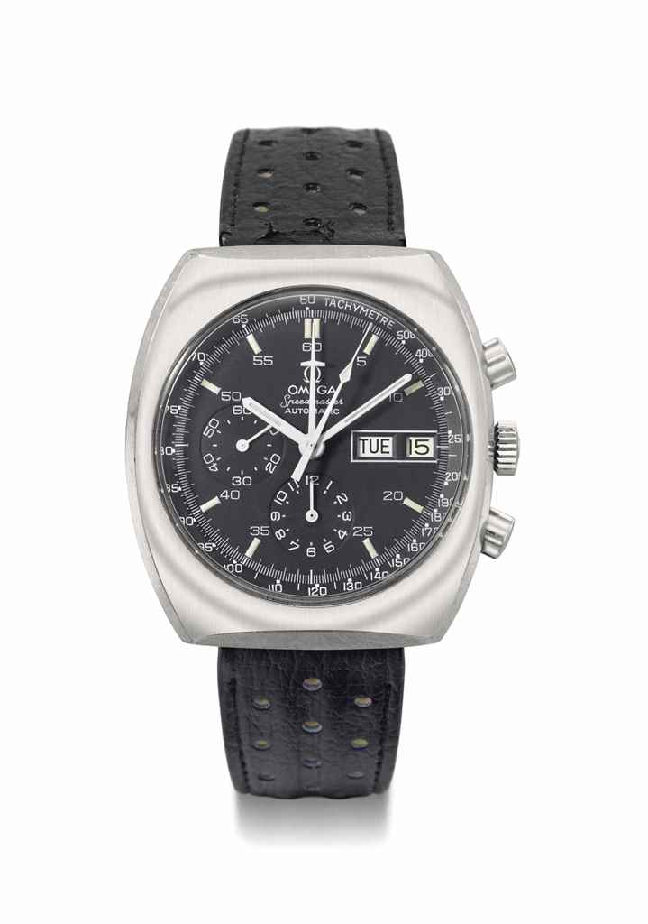

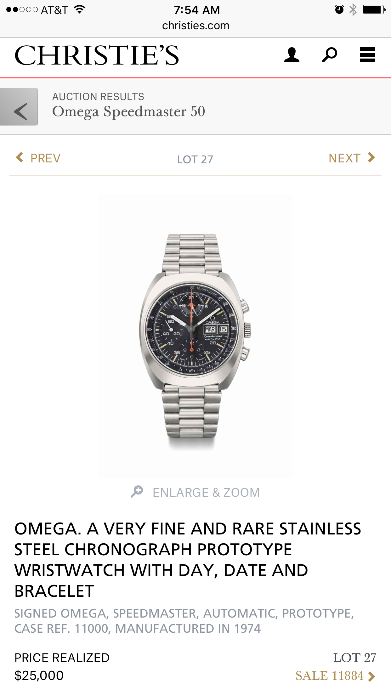

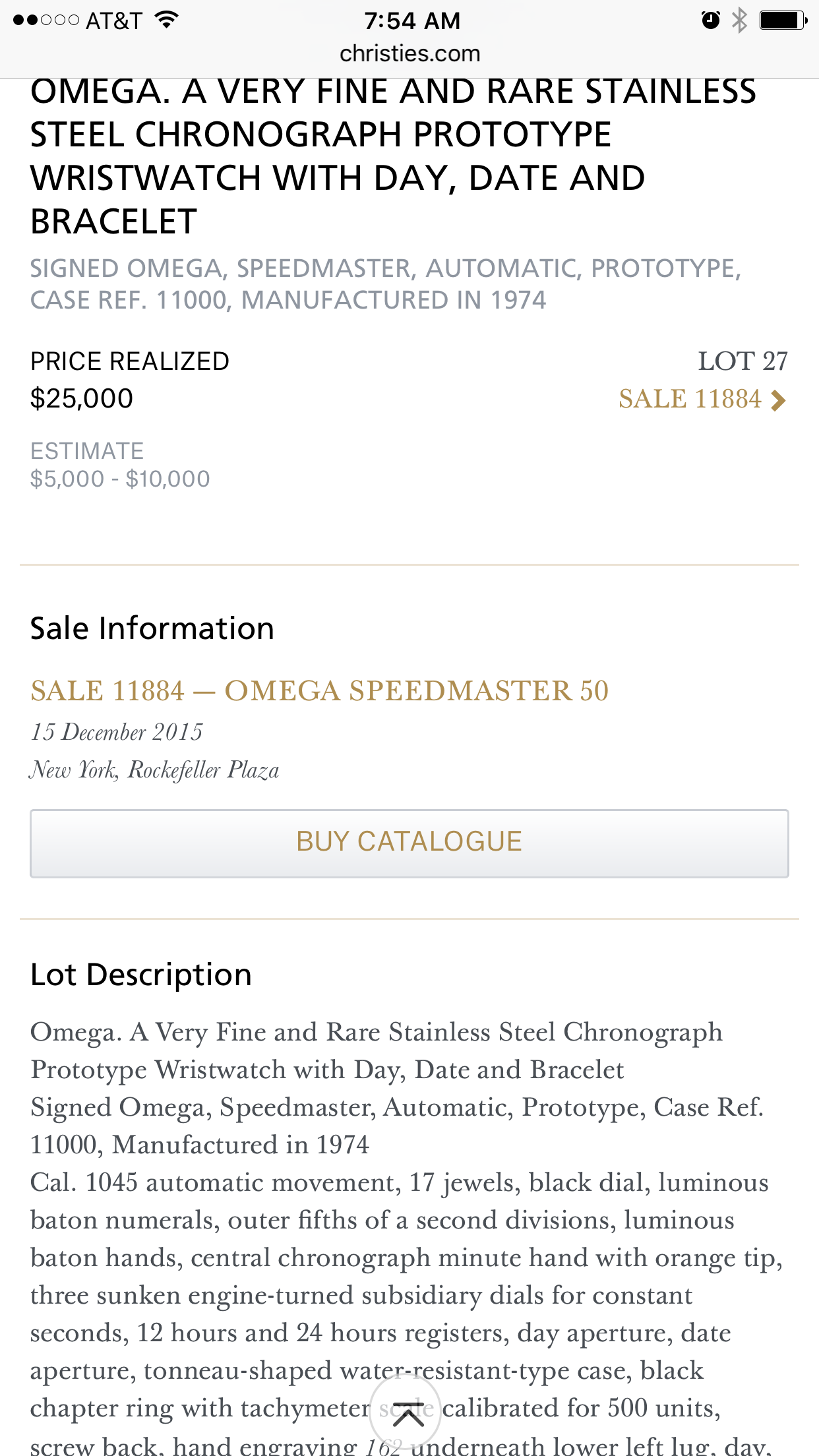

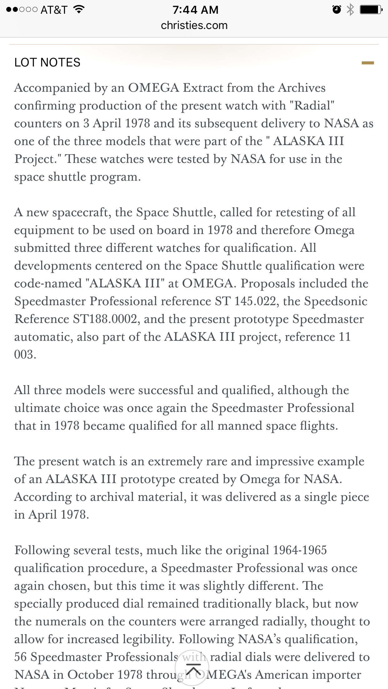

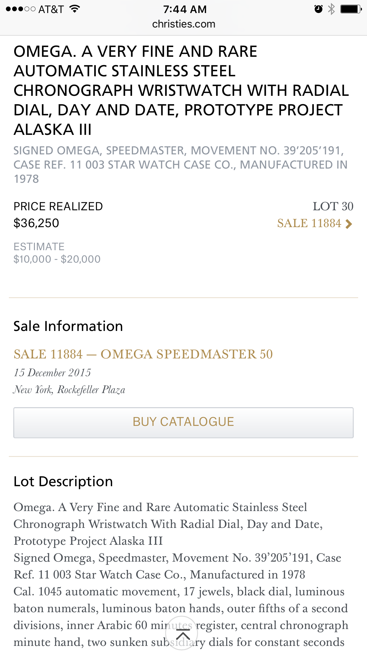

With the Christie's "Speedmaster 50" auction gavels down, there were included several 176.XXX/cal.104X family pieces.
I'll compile them here for prosperity - including the couple of every interesting prototype watches.
Also for prosperity (and readers in the future), I should note that this particular auction saw several pieces going for a good deal more money than similar watches can currently be found through other, more traditional, means. Several speedy officionados are scratching their heads on relatively common examples at the auction, that could have instead been had at lower 'buy it now' prices elsewhere.
The prices reflected in the forthcoming pictures reflect the 'gavel' price PLUS auction commission/fees (which add an additional 25%-33% on top of the gavel price).

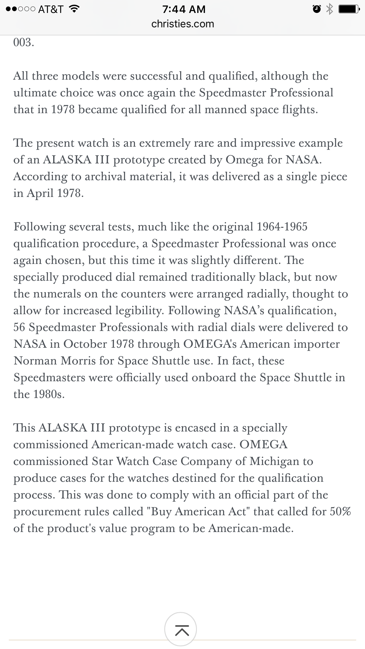

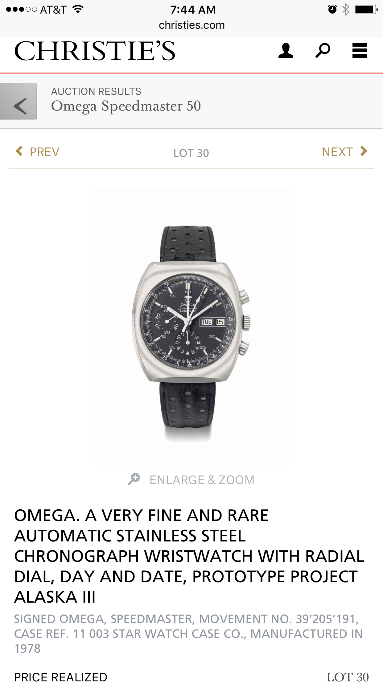

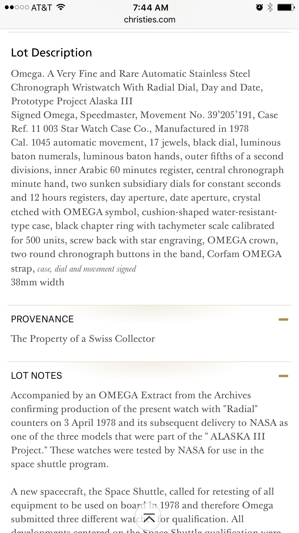

Speaking of prototypes, I'll start these posts with the one most interesting (which gavel price was $29,000):
I have some additional thoughts/observations on this watch (and Christie's lot notes), but for present purposes will stick with the task of reporting on the sales relevant to this thread (and return to my observations later). For now, I'll just point out that the day-date function indicates that the base movement in this prototype was likely a cal.1045, absent the 12-position sub-dial. This would have been the only Omega with such a configuration.
3,997
9,030

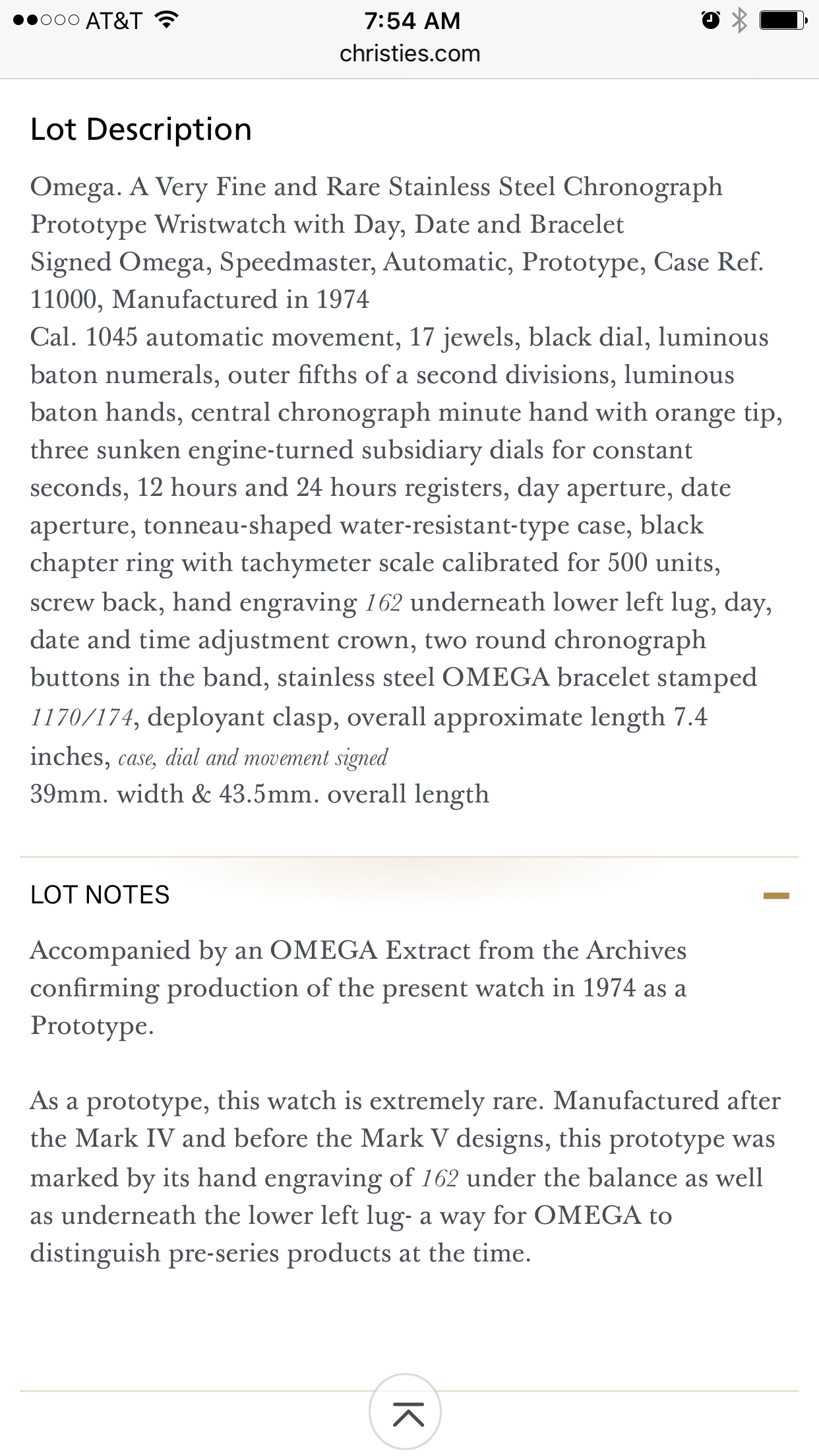

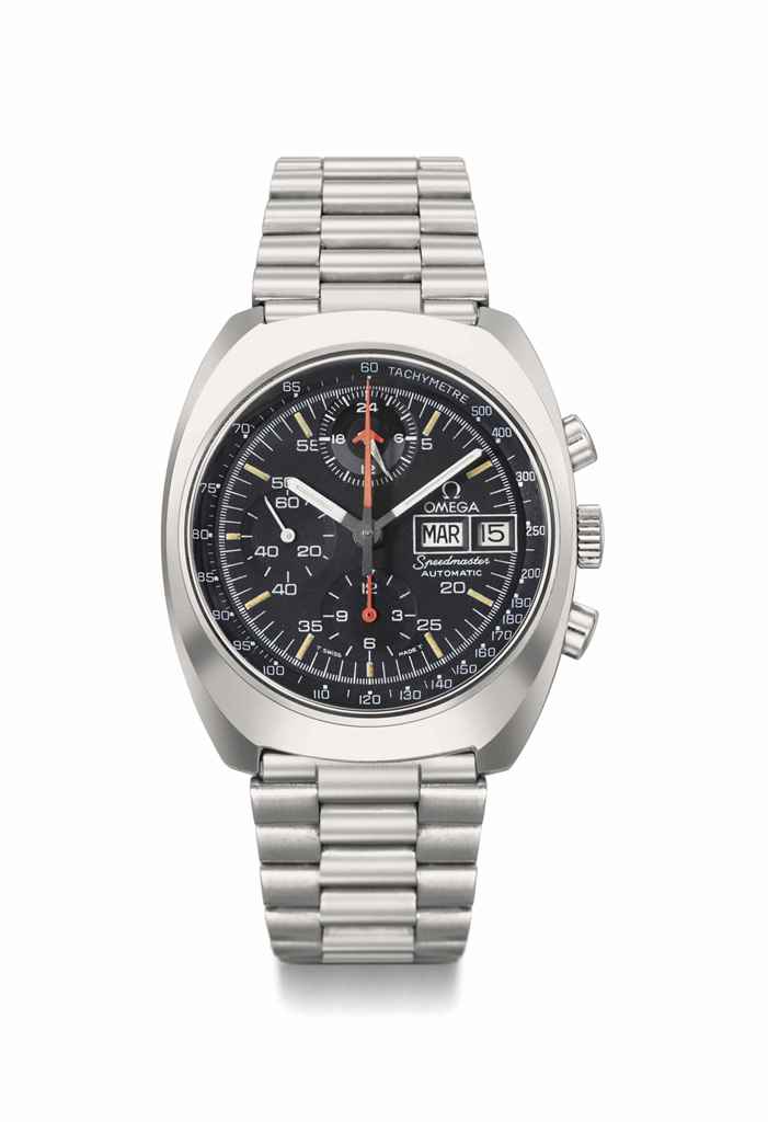

Next up (gavel price of $20,000), is another interesting prototype, plainly housing a cal.1045, and some more interesting lot notes from Christie's.
