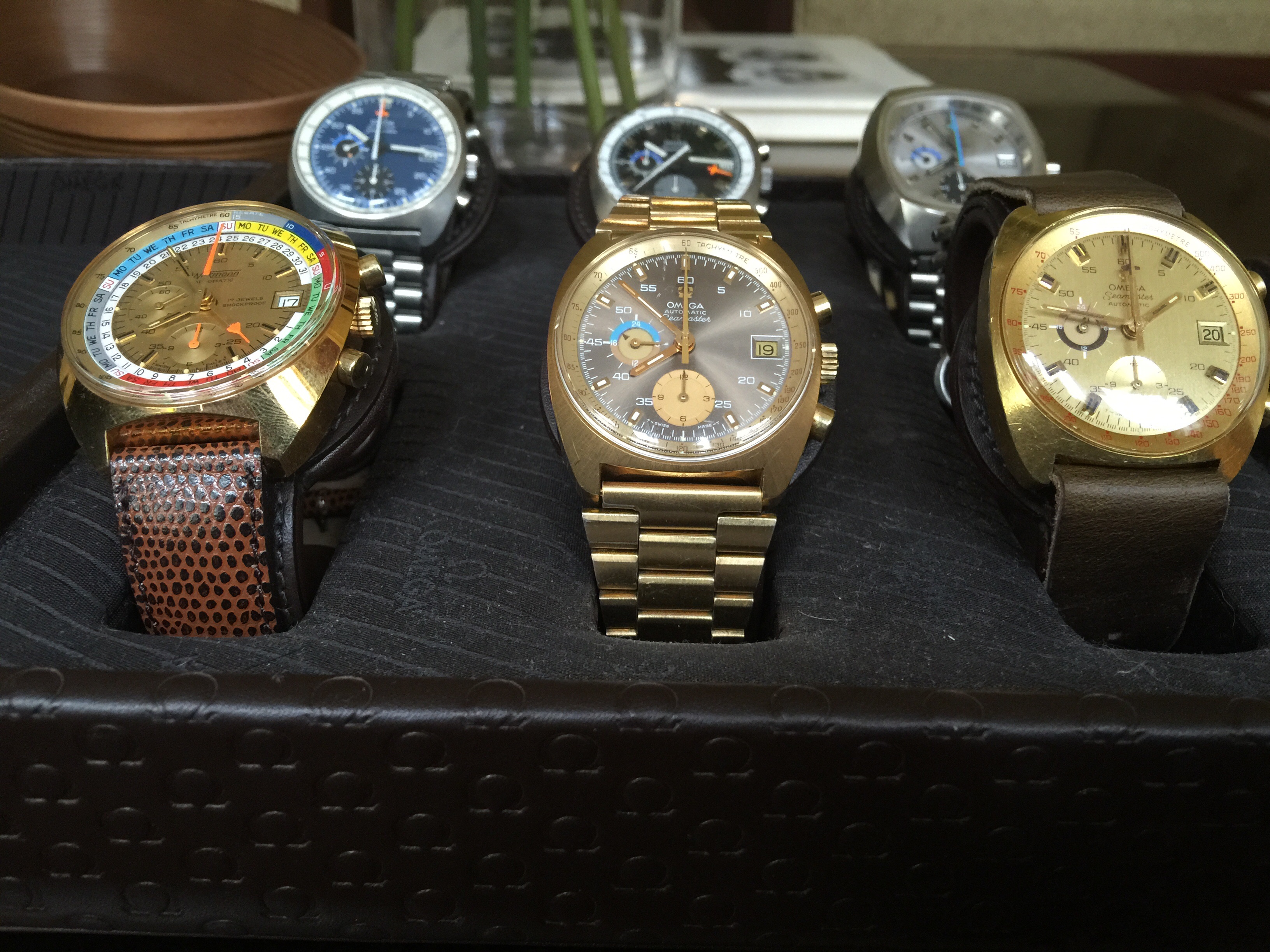

I like that idea! I currently have three 1040s and one 1041:

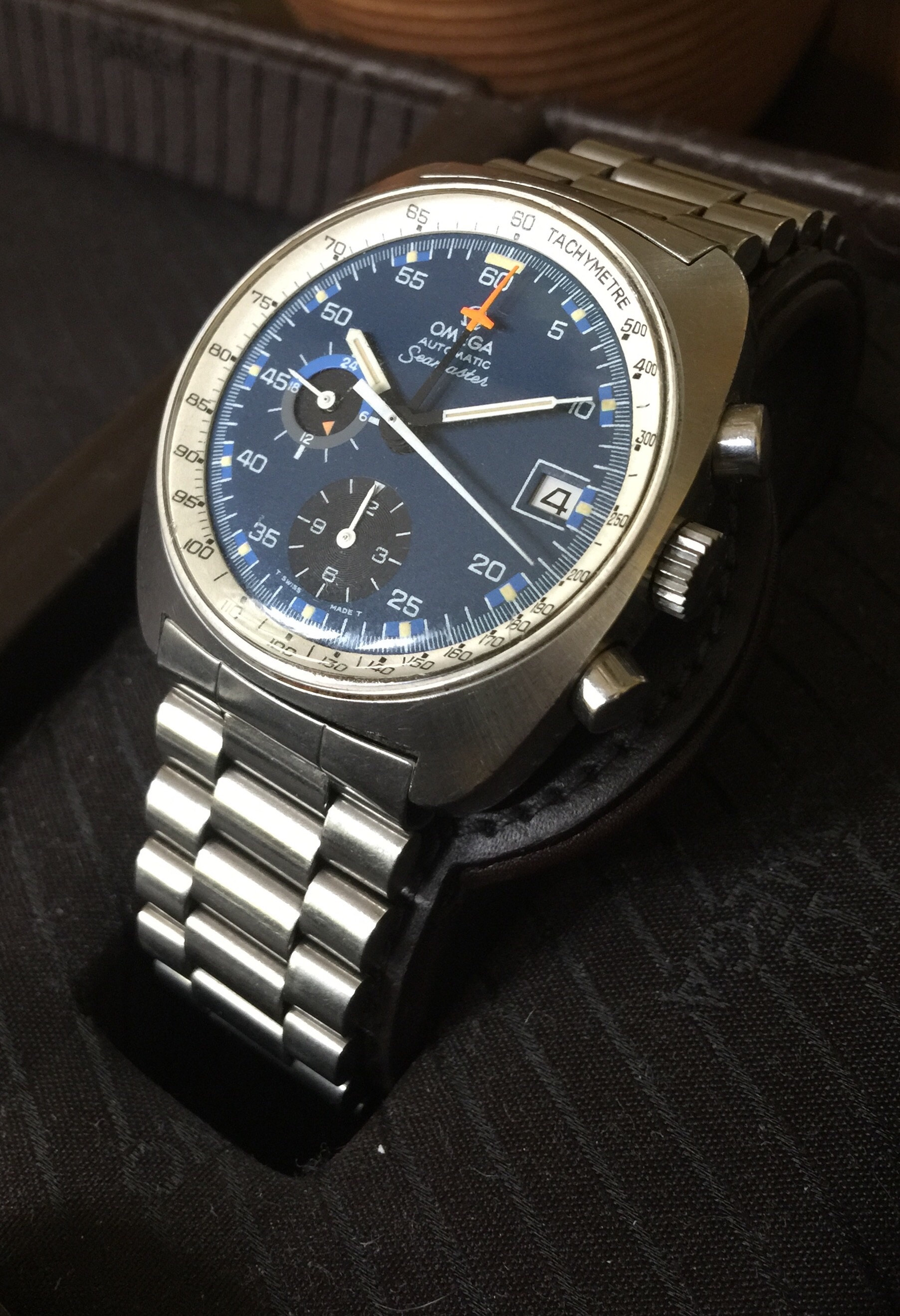

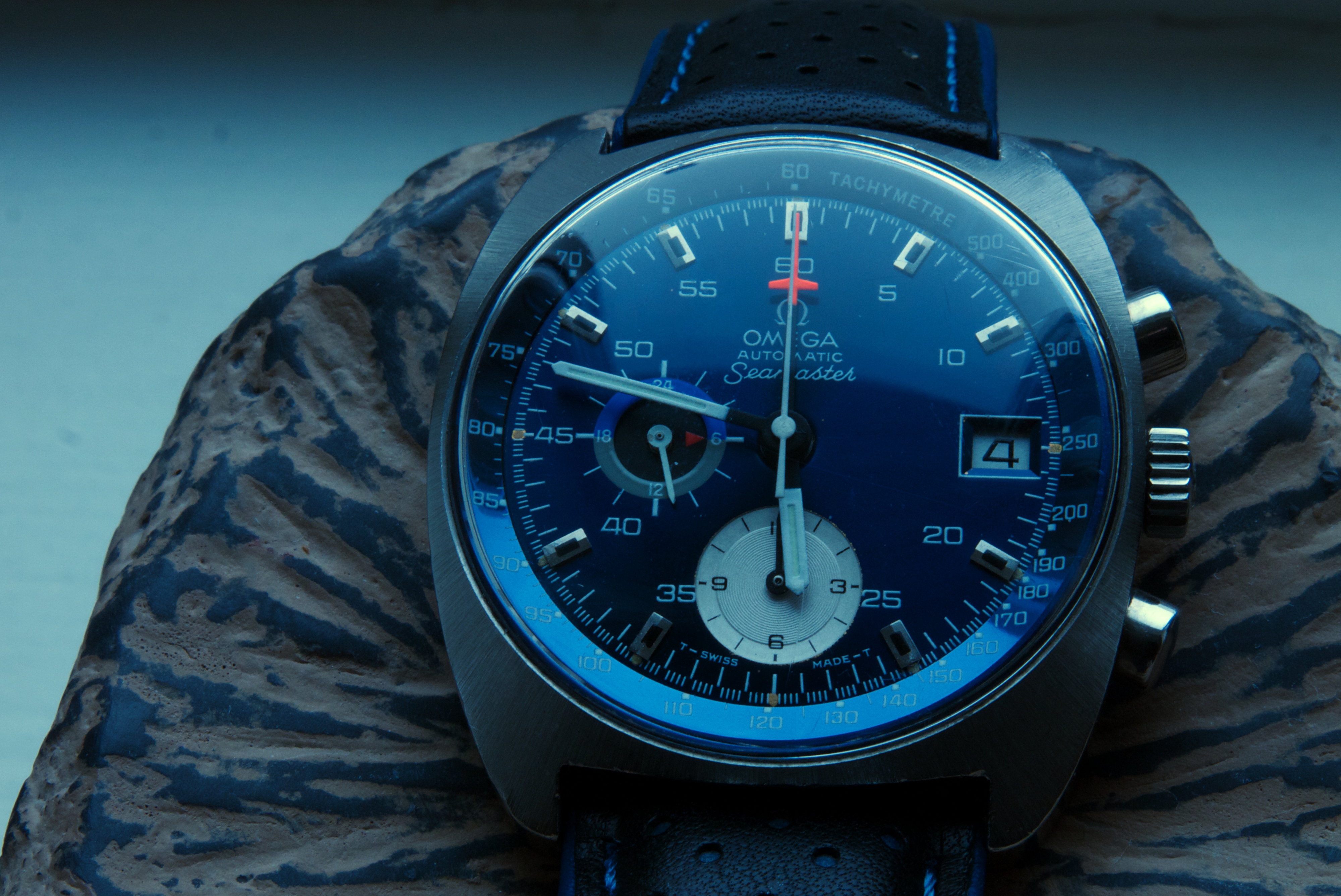

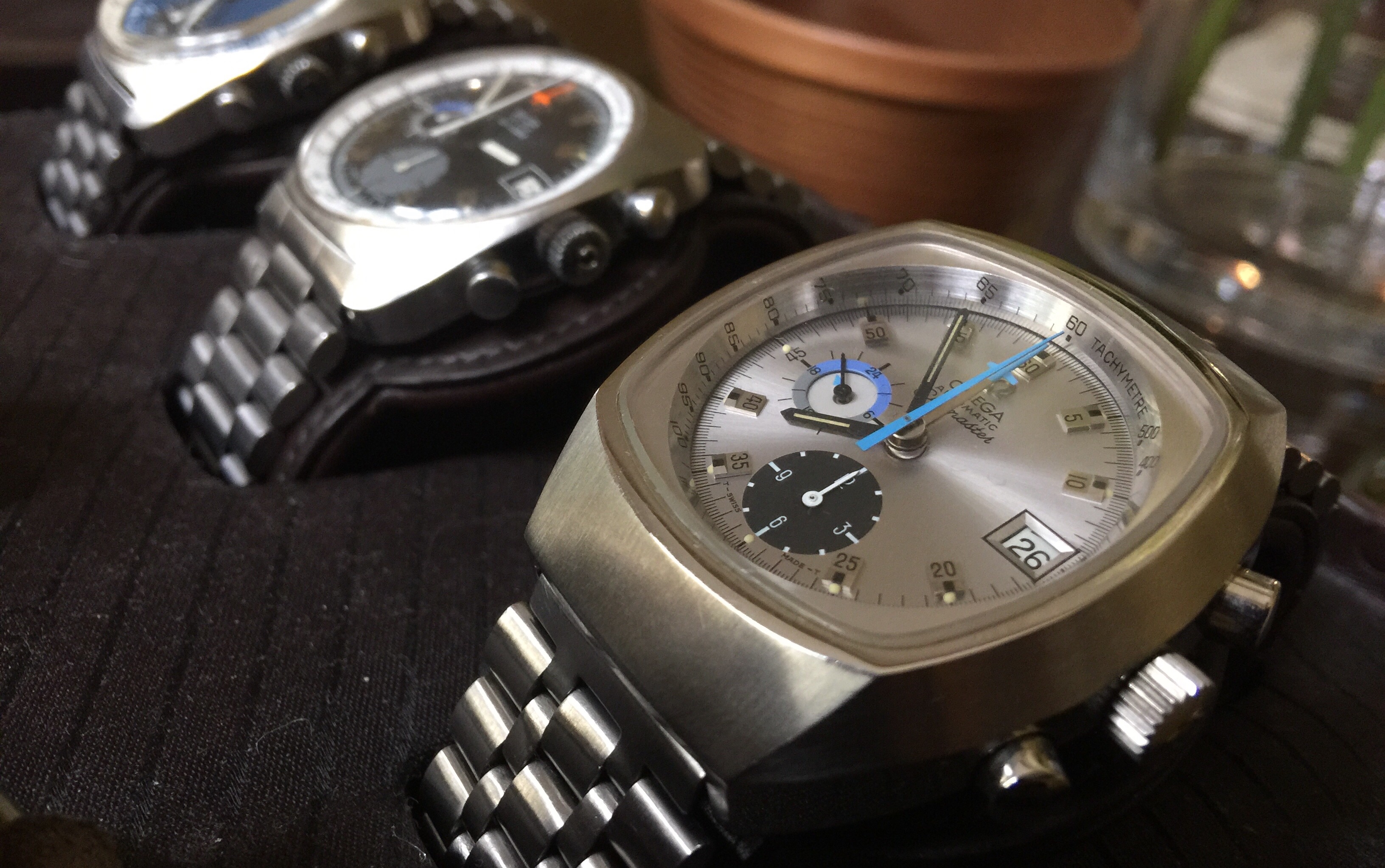

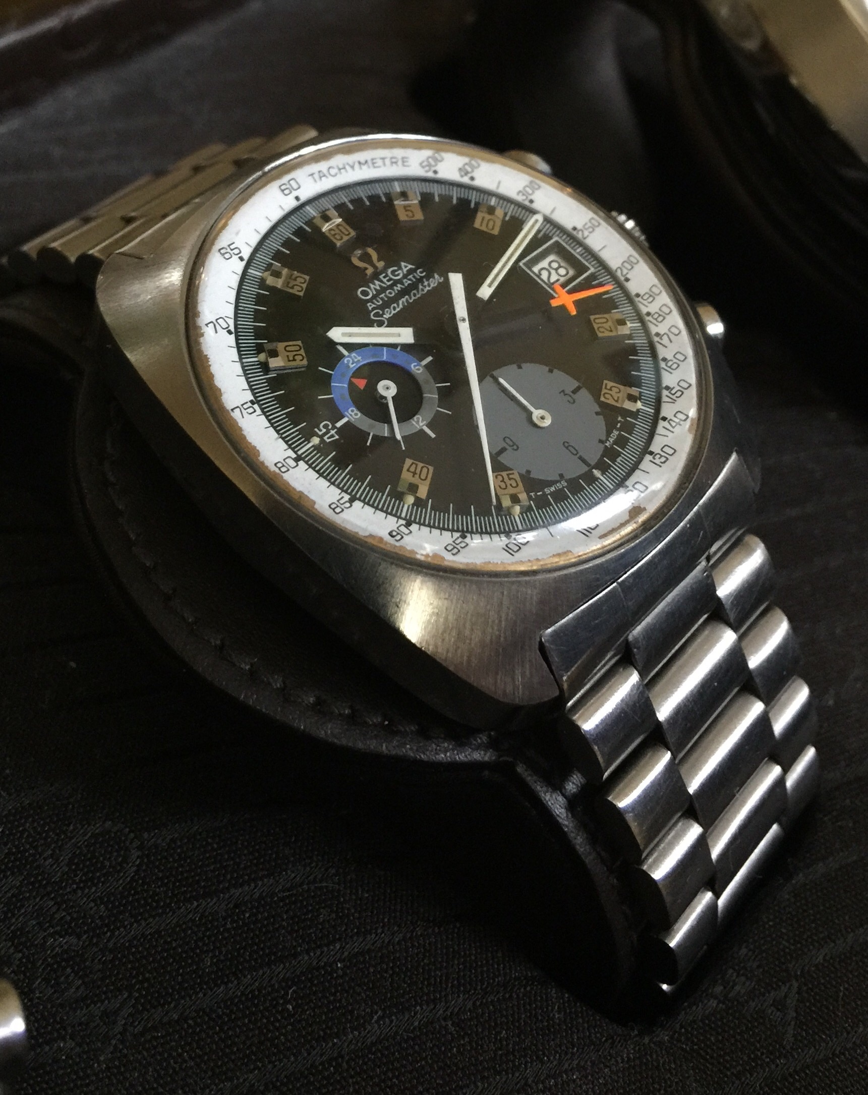

Mine has unusual order of the dial text, "Omega Seamaster Automatic", where most (nearly all) steel 007s are "Omega Automatic Seamaster." You mentioned that most 001s are silver dialed. I agree, but I've also observed that all of the blue-dialed 001s have the "Omega Seamaster Automatic" text. So I've started to wonder if my dial is original to the 007 case or was swapped at some time.

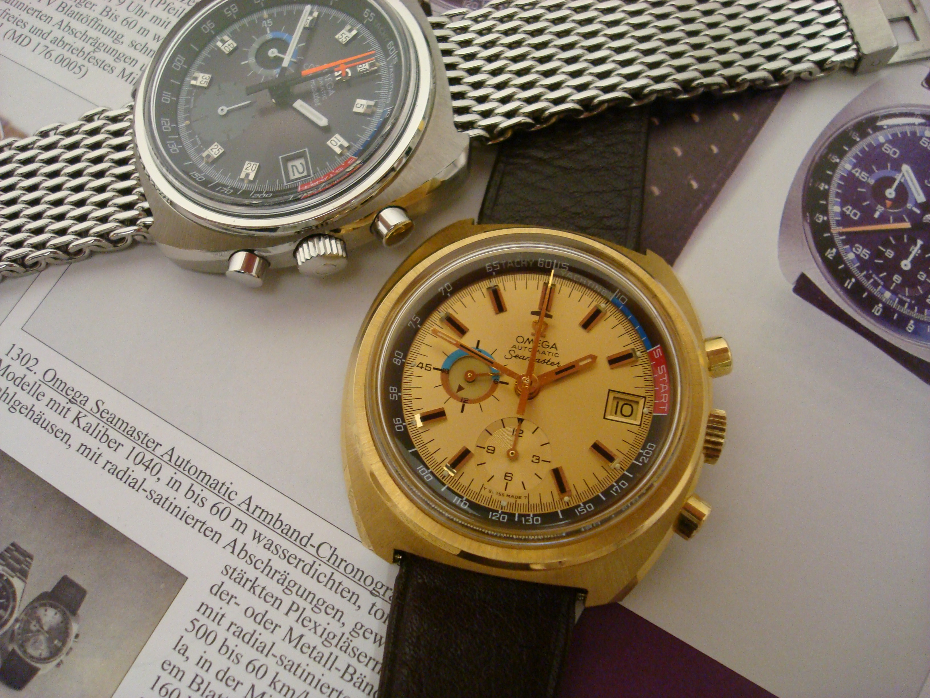

Well, I hadn't noticed the text order before (interesting catch), but note that AJTT shows at least two examples with such ordering, one nearly identical to your blue (but with the - I believe - earlier 'needle' hour hand, and the sun-brushed dial where yours appears to be matte):

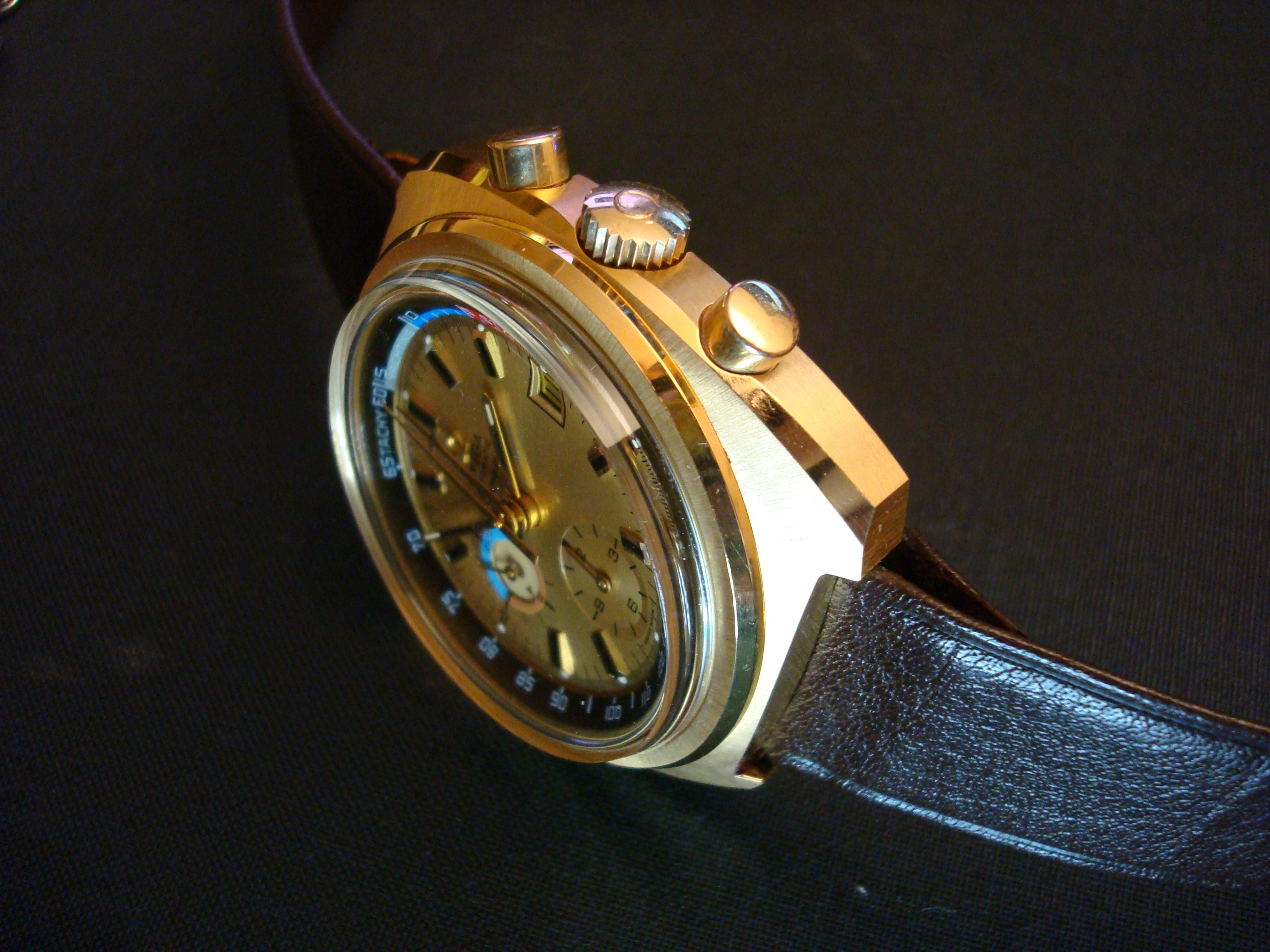

The second in AJTT is a gold-plated version, with the gilt varient dial:
So, while AJTT isn't definitive, at the very least it seems there are some blue-faced 007s with the text order same as yours, and even gilt versions with it - the latter definitely suggesting that proper 007s could have this text order variation. Note that both versions from AJTT have the similar applied indices variation as yours as well (with both applied indices plus five-minute numerals, as compared with versions that only have applied indices without five-minute numerals except at the quarters).

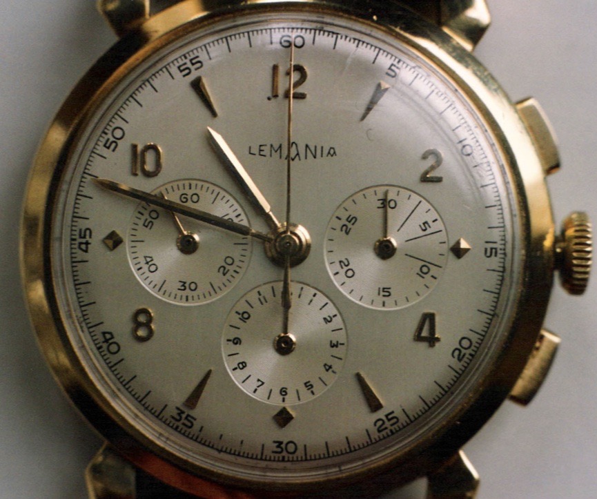

Finally, is the picture you posted supposed to be the 1946/7 prototype designed by Piguet? If so, the date on the movement is interesting insofar as all of the Omega-related histories I've seen place the prototype in 1946. Clearly, October is pretty deep into 1947, which raises at least two questions: (1) why and when did someone desire to date-stamp a prototype movement, and (2) what are folks at Omega/Lemania considering the 'design date' of the movement (as opposed to a completed prototype - or is it prototypeS?).

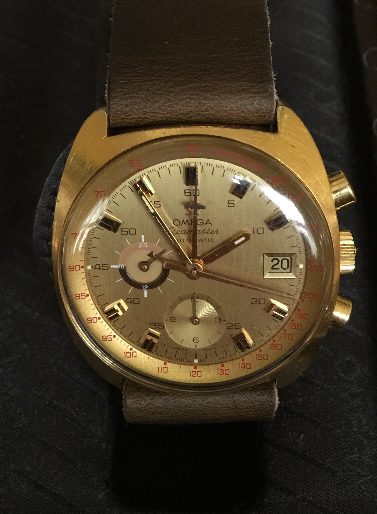

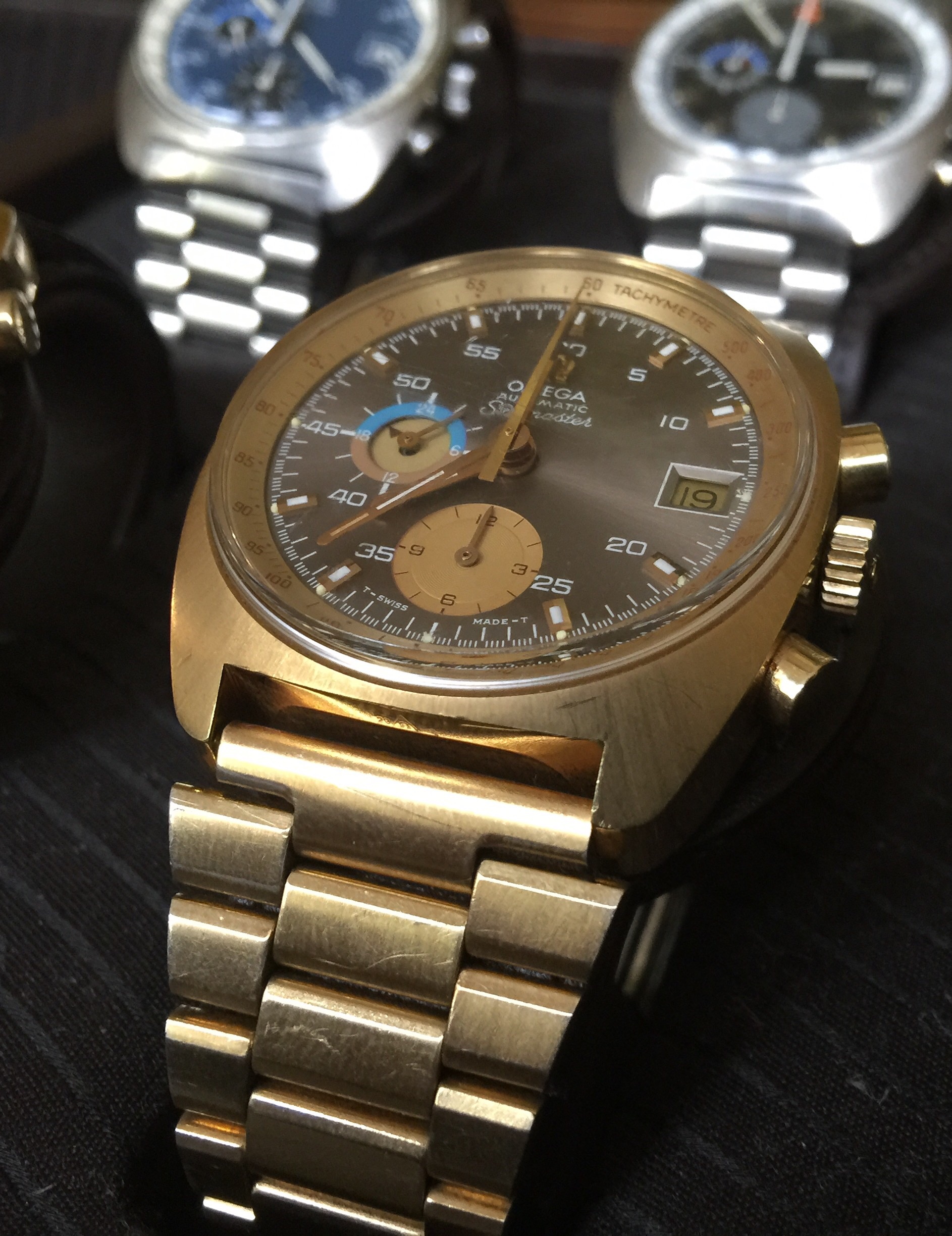

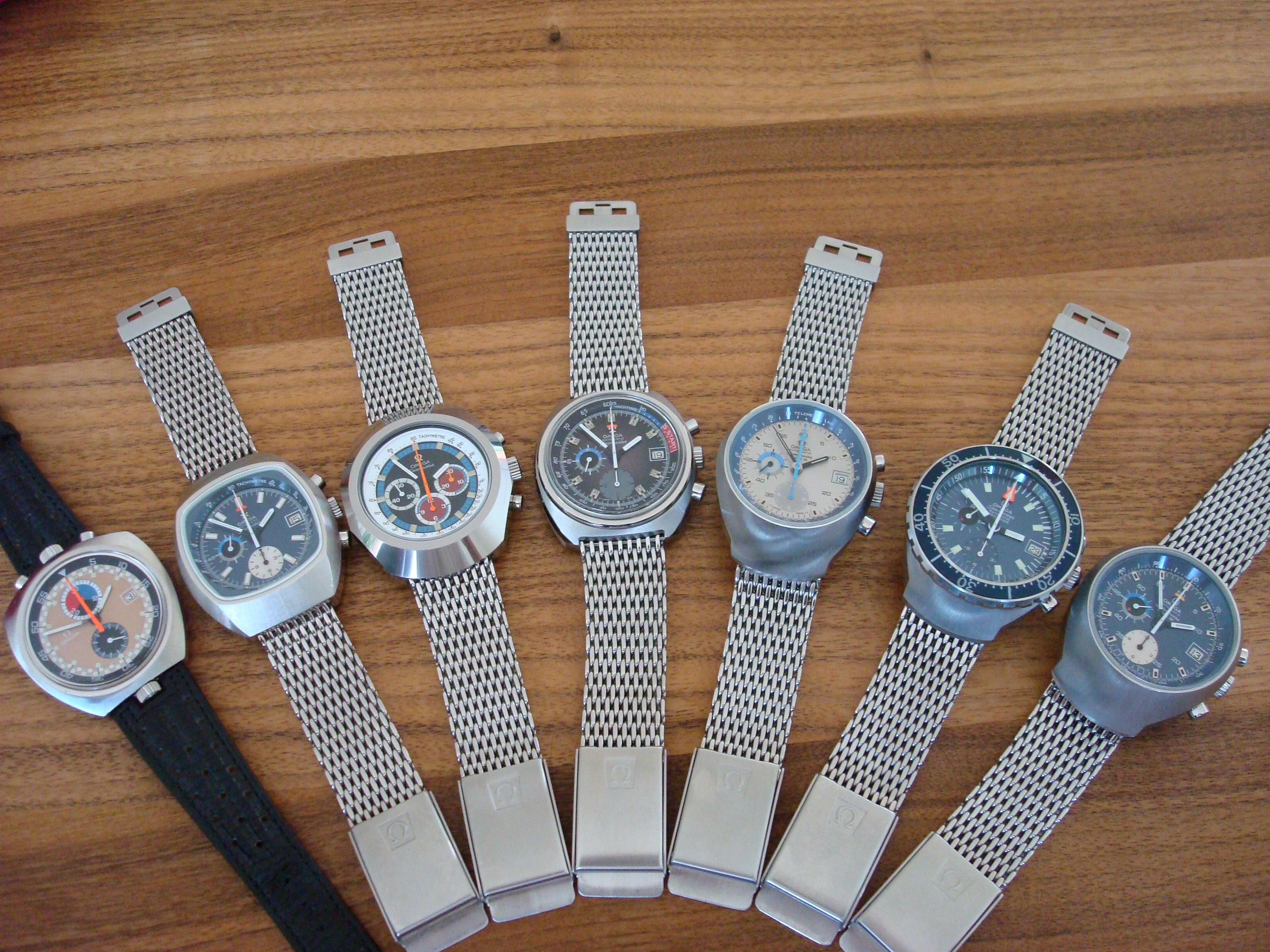

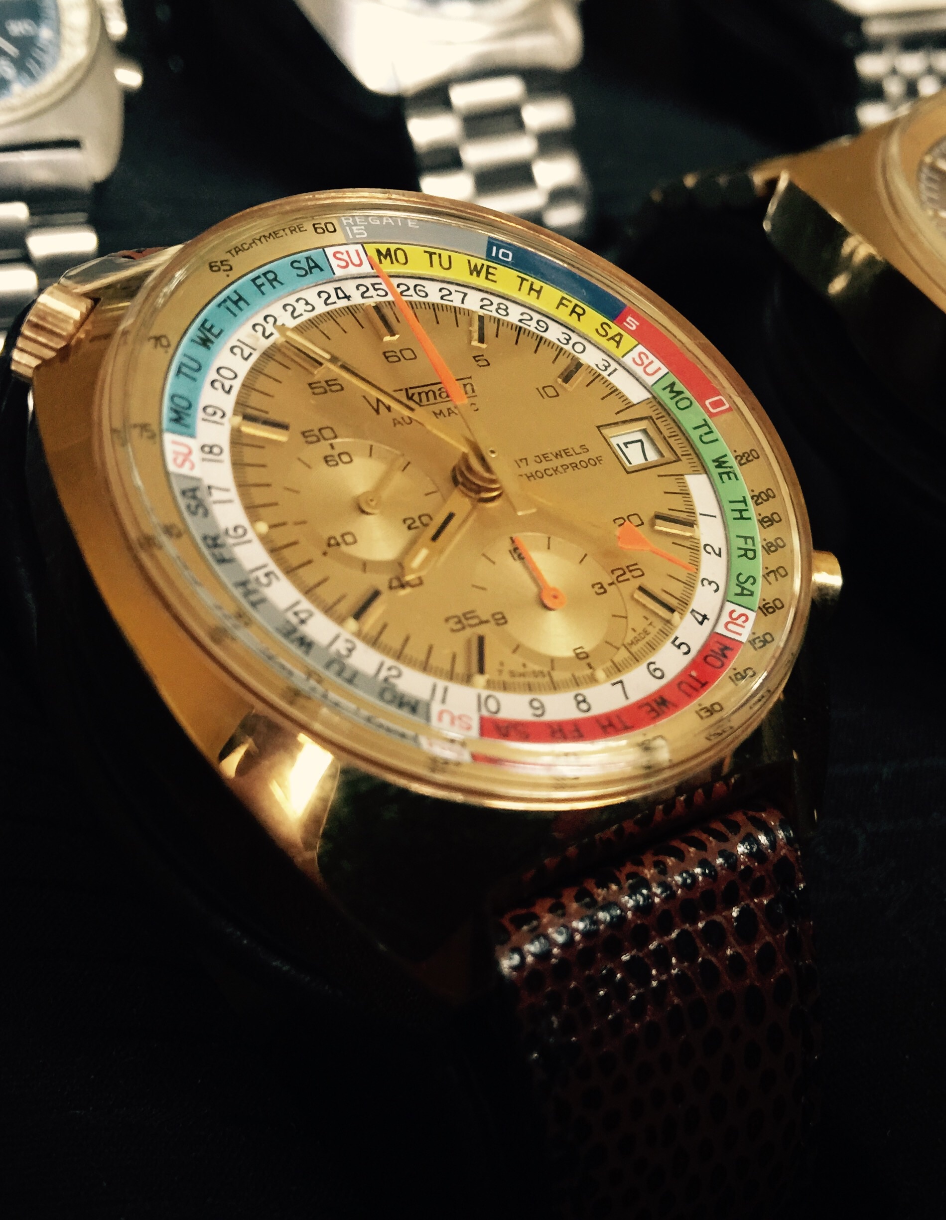

These are mine, with the two gold cal.1040's seeing regular wrist-time, and the Wakemann Lemania cal.1340 being dead NOS (with bracelet also), the Rogue Jedi seeing some wrist time, and the two stainless 007's for good measure. The blue 007 I believe to be a very early version, with matte dial, and no applied hour-markers. That the black-faced 007 has applied markers with numerals on them, and a 'closed' date window, but little else to suggest whether such dials are or are not correctly found on 007s (there are just so many dial/hour-marker variations it is difficult to be definitive).

The picture is the 1946/47 movement. I guess work started in 1946?
I have read that the date is for when it was displayed to the public/board of SSIH.
Here's the face:
As for the 1045 vs 5100 they can swap any part. Color of plates and bridges obviously differs, but that is purely cosmetic.
Wow - I didn't realize that the 'prototype' was not just a movement, but even a completed auto-chrono watch?
This, to me, calls into question further details when people debate whether the Breitling group, Zenith, or Seiko built the 'first' auto-chrono: surely, that debate lives on in terms of which company first mass-produced and marketed an auto-chrono, but discussions on the topic are not couched in these 'mass-produced and marketed' terms, and are instead typically debating which company 'made the first auto-chrono.' If Lemania put together an entire working prototype 20 years earlier, that bears mentioning in the Breitling/Zenith/Seiko debates.
Where can I find more information on the photos you've provided of the movement and the watch itself?
- CB

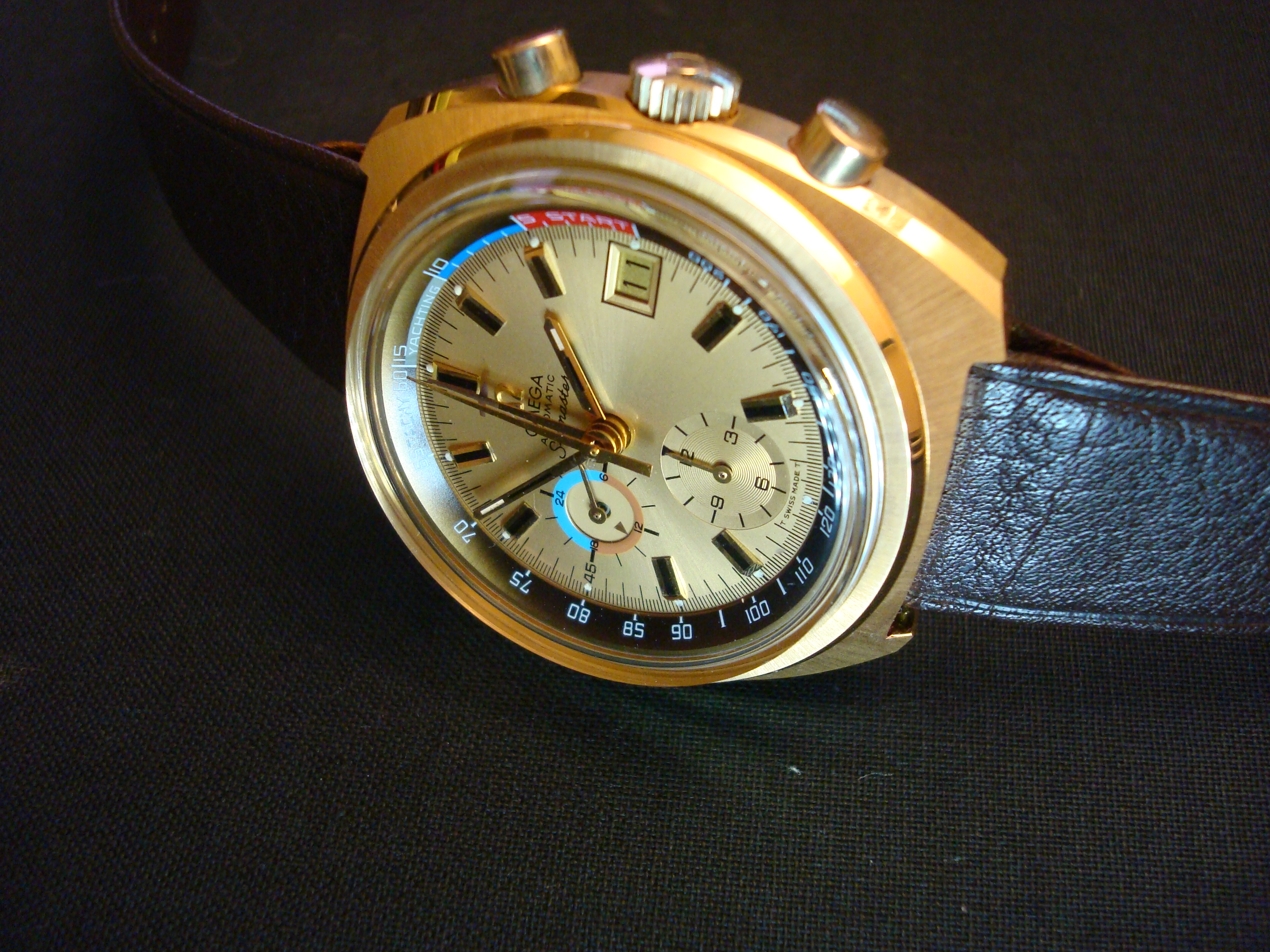

Mine is the sun-brushed dial, amateurish photography skills just make it look matte in those pics! I agree some 007 dials have the OSA ordering, but it seems much less common. Maybe just the first few 007s as they cleared out 001 part stock or service replacements. Who knows. The GP case/dial combinations have a logic or lack thereof) all their own.
