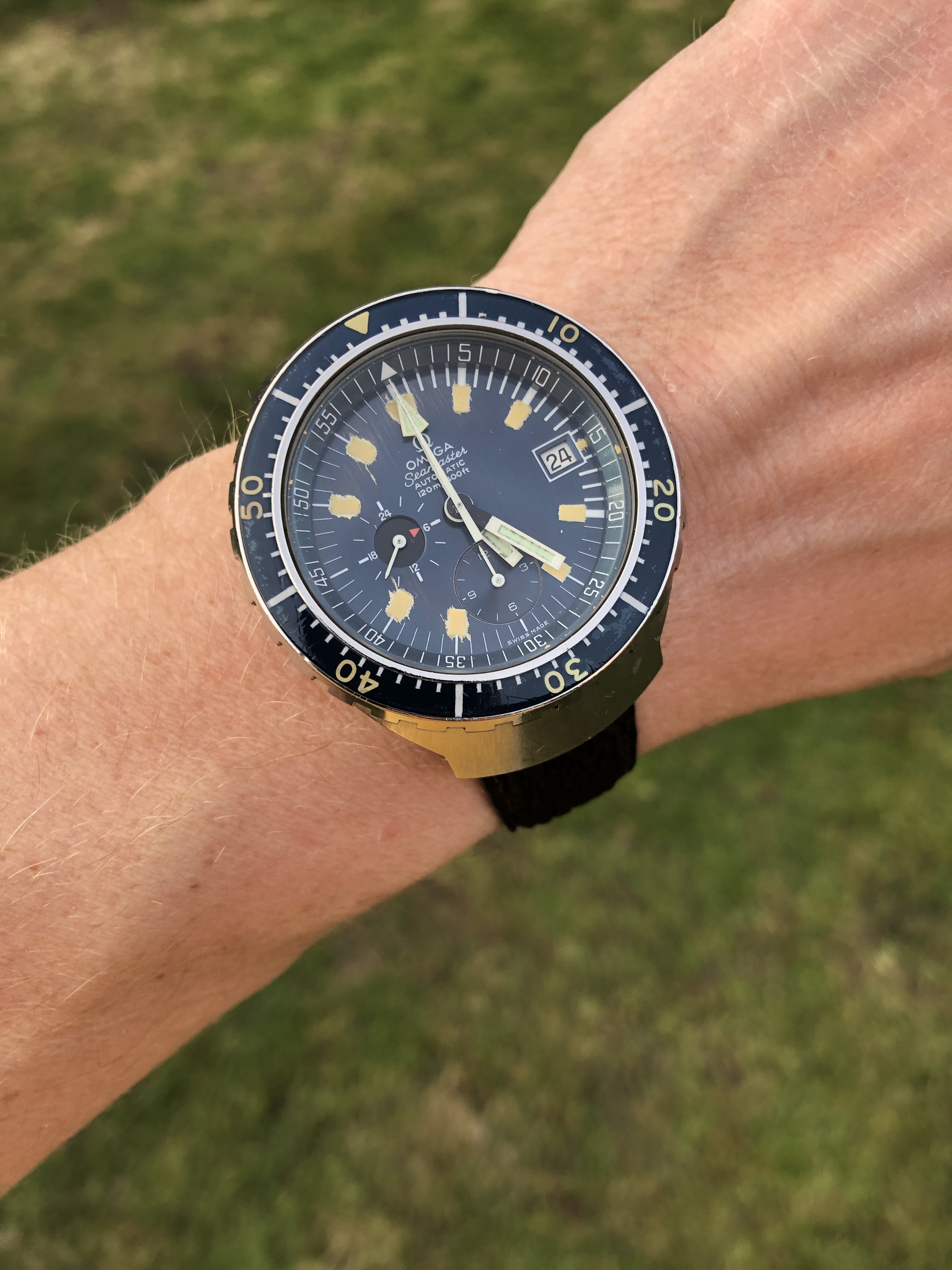

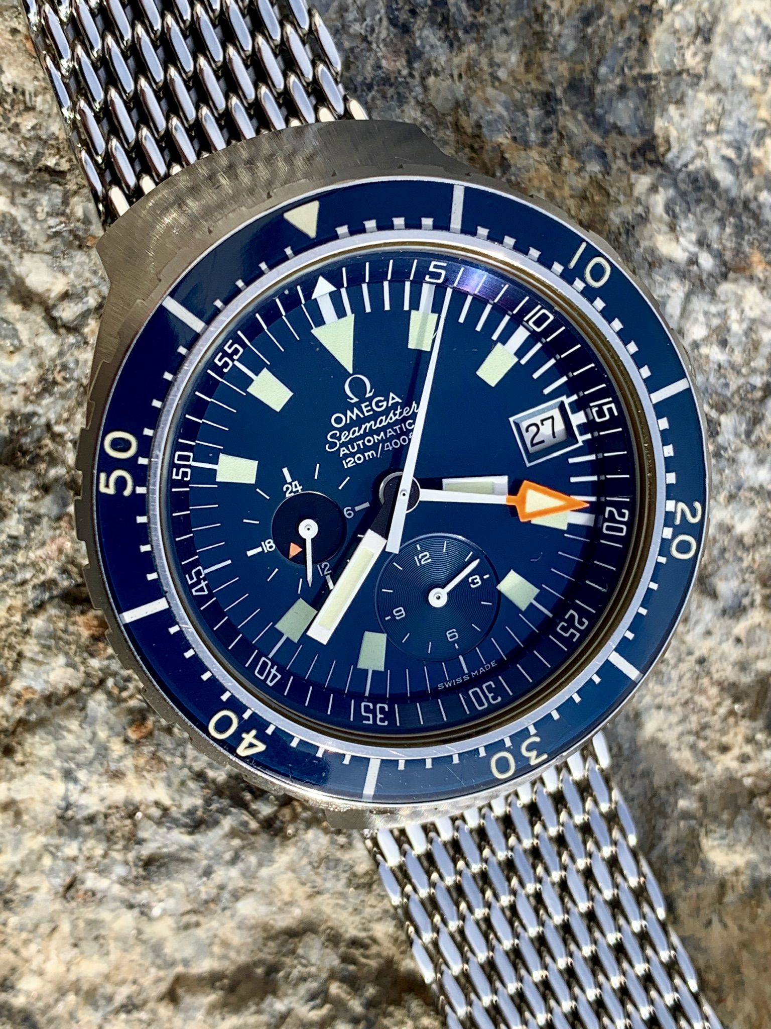

I have noticed that this watch seems to have 2 bezel variations. The one I've pictured which I'll call thin squashed numbers and another that is thick tall numbers. I've no idea if they are both original or if one is a service bezel. Thoughts (or actual facts) appreciated.
1,589
2,024
Yes there is 2 bezels, the one in the picture is supposed the « Original » and the other one from 0 to 20 the lines are shorter less thick and can be considered as service , any way it makes 10 years that Omega doesn’t have bezel for the big blue .

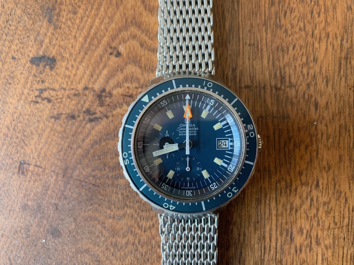

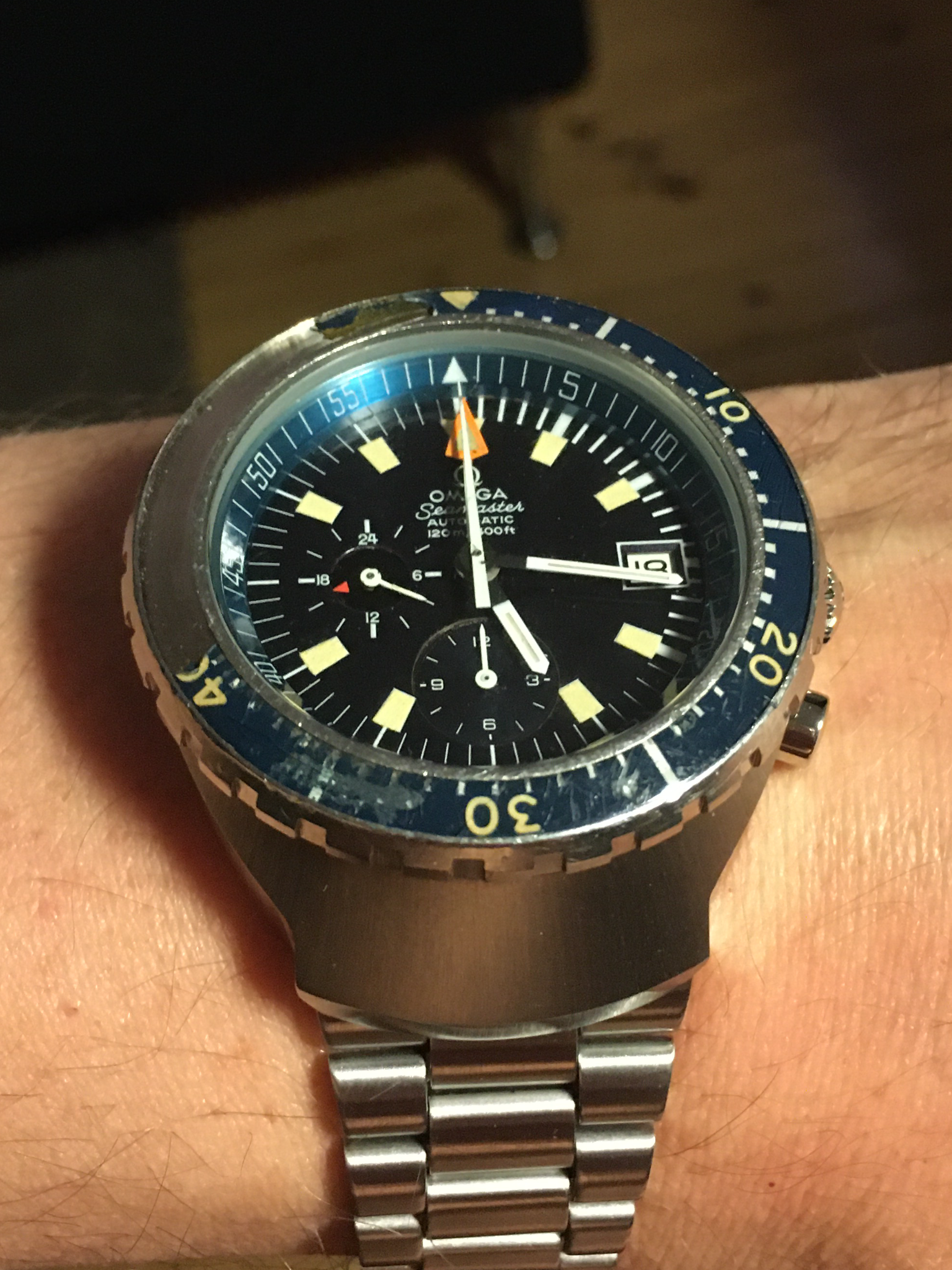

here is mine

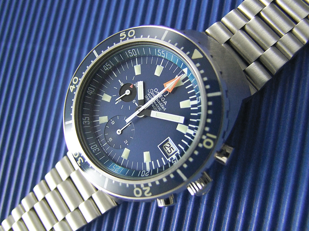

Here is a thread showing two different bezel versions:
https://omegaforums.net/threads/thoughts-on-this-st-176-004-120-c-big-blue.5659/
Picture taken from this thread:
22-jpg.18989
@Fatcat 's bezel looks like the one on the right to me, but the bezel in your picture doesn't match neither left nor right. Your digits are smaller and placed a bit different.
So if I can trust my eyes and the bezel in your picture is genuine, there are at least three versions.
Edit: Taking a closer look, I'm no longer sure if Fatcat's version is the same like the one shown on the right... I'd rather say it's not.

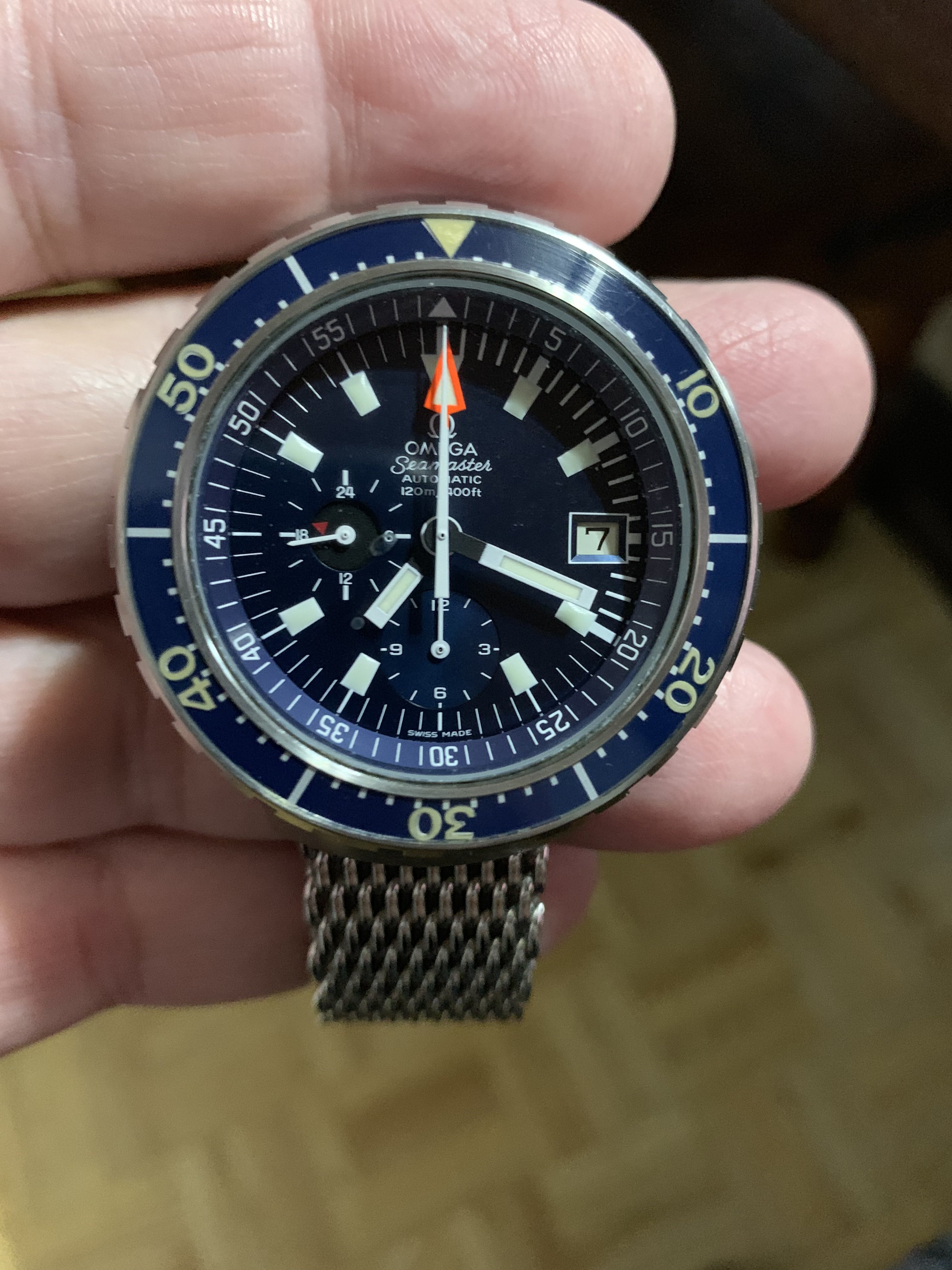

That's interesting. I am guessing mine is an original because pictures i've seen of parts returned by omega after repair look more like mine, but you're right they are a little more squashed, closer to early 60's seamaster 120 bezels. Also in looking at your pictures, unless there's distortion, the inner ring numbers also look different. Where are all the "Big Blue" geeks on this one.

Here is a picture of a NOS watch I once owned. Outer and inner bezel look like the example on the right (picture from the thread I posted above), which was NOS as well. So this can be assumed to be a factory standard.

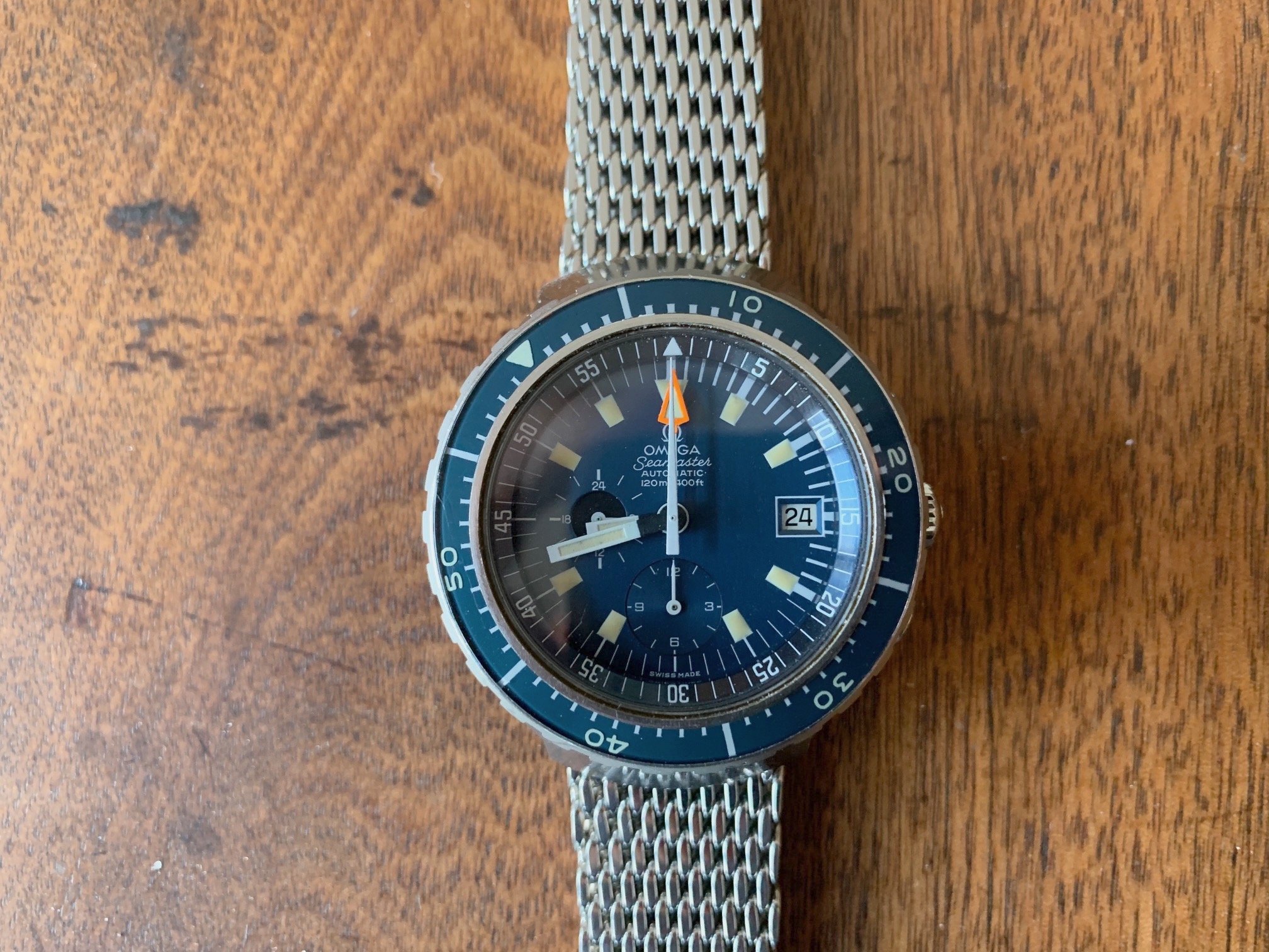

Agreed that this last NOS photo shows a watch with original factory parts, but did the original bezel change, in addition to having a service one. If you look at Chron24, where there are the greatest number of big blues to compare side by side, you can see all three bezels.

I think that all of the bezels we can see here are genuine and I vote for Fatcat's bezel to be a service part (as he said, if I got it right).
Our common observations make it likely, that the factory standard was changed at some point. Would be interesting to know more about the chronology, if there is one.

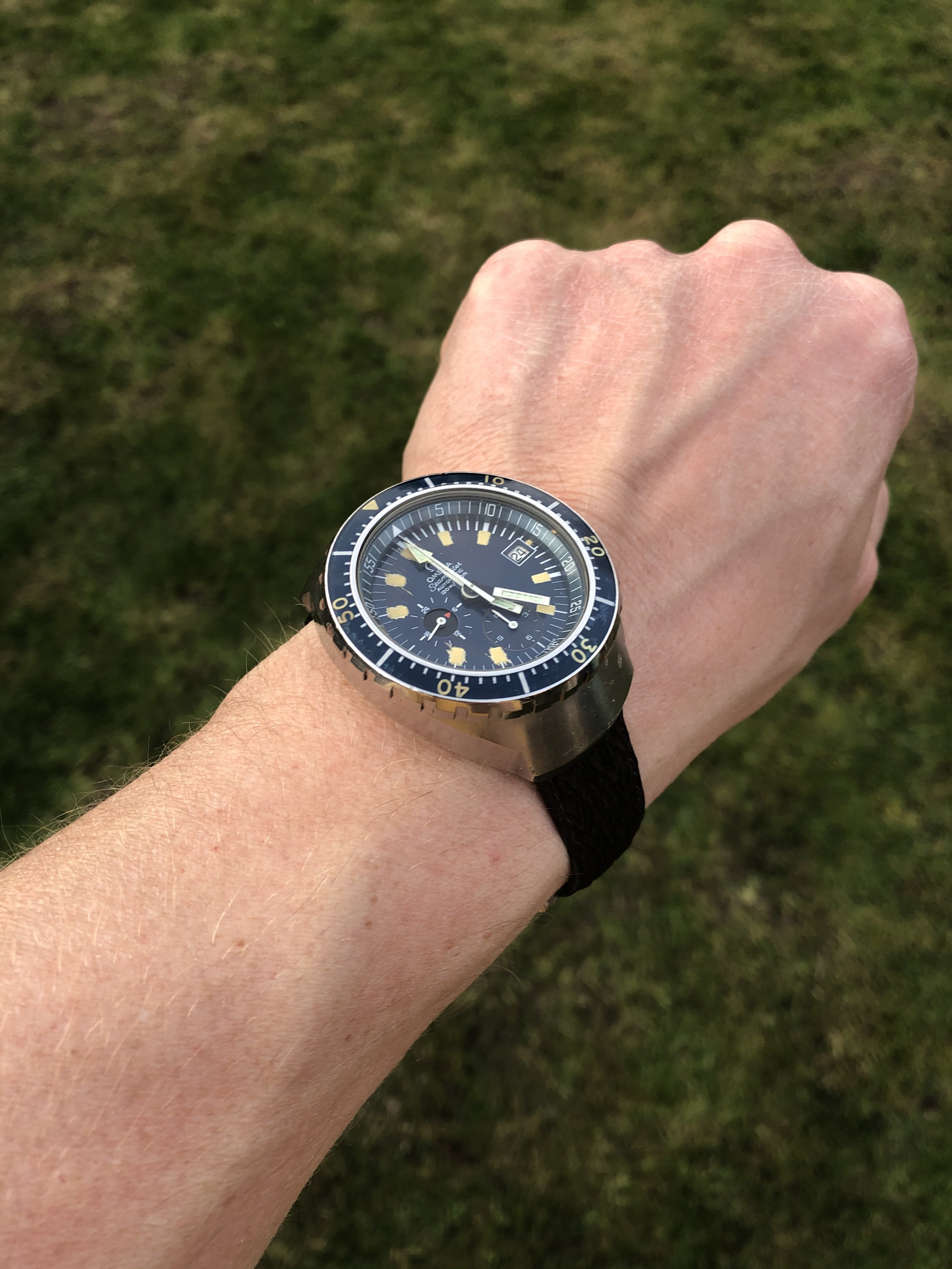

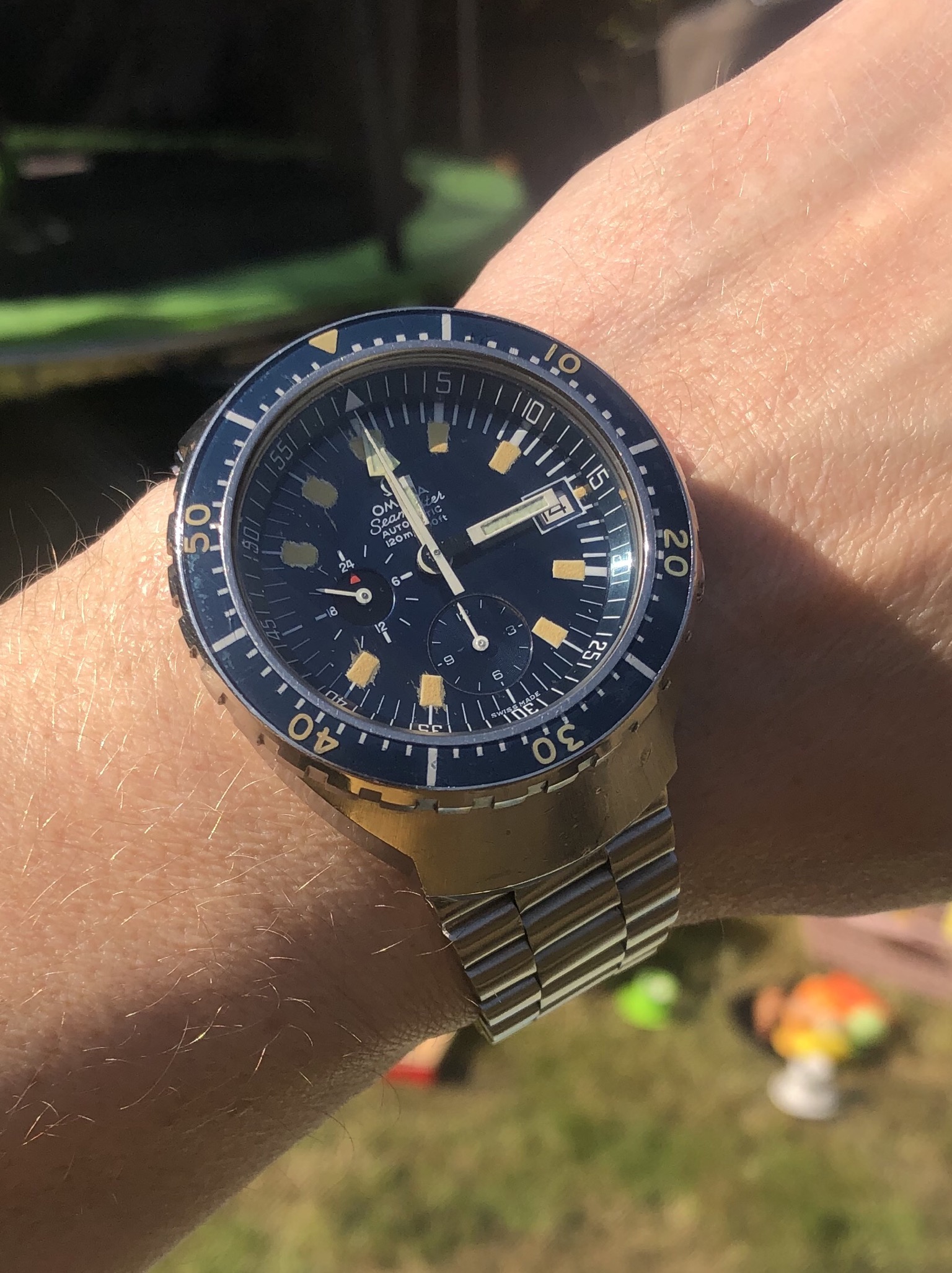

There are actually three different bezels for the Big Blue, two original bezels and one service bezel.
The two original bezels look at first the same but the first really rare bezel “first execution” has very thin and flattened numbers (flat top 4).
Then there’s the “second execution “ seen in most of the cases with a still similar font but just a bit thicker and not compressed and with a sharp 4.
This execution can be seen with two different font thicknesses, (i would call them THIN and BOLD) otherwise absolutely identical so wouldn’t go calling them as different bezels.
And then there’s the service bezel that sticks out quite clearly with big size bold numbers and a different quirky font.
There’s also info to be found here on the forum, just search for it and you will find...

Will post all three down below in order:
First execution, second execution and service bezel.

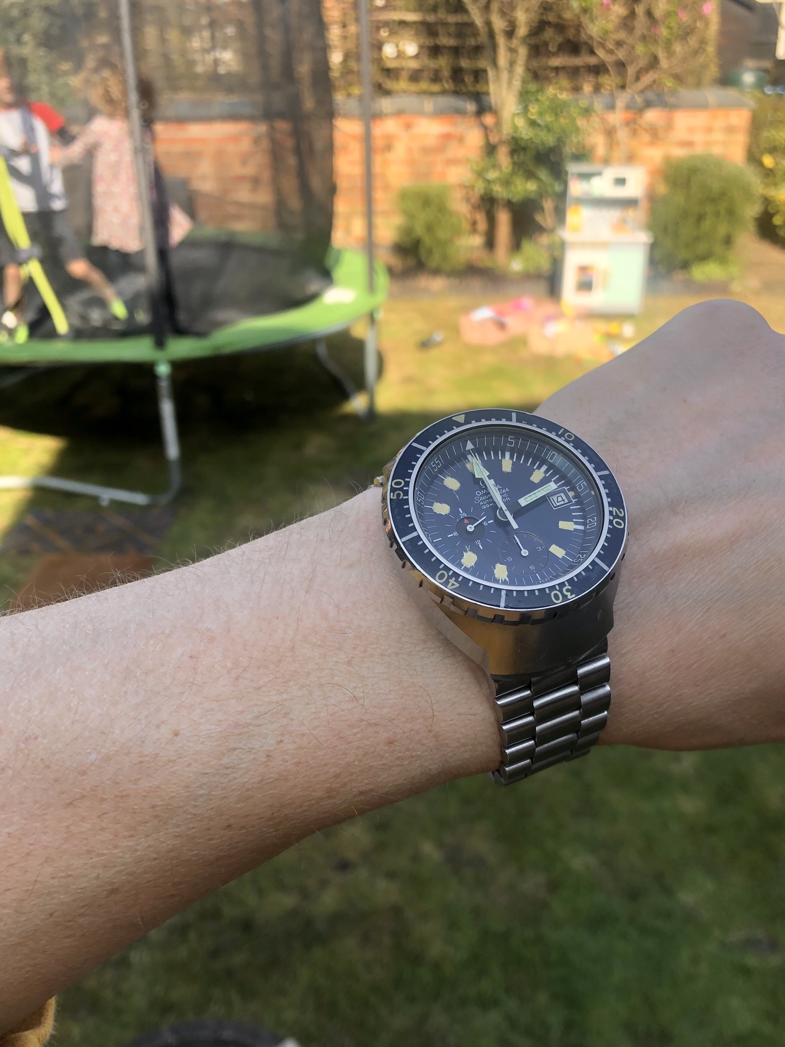

This is the last of my new arrivals in the near future. Been wearing it the last few days and suspect it will become my ‘isolation buddy’
When the world is open for business again I will probably get the case welded and lapped at STS! But still debating that as it’s never been refinished
the watch will go to James hayman first to have the hands lumed to match the dial and the original top repainted because it’s faded.
I’ve owned so many of these over the years but it’s been over eight years since I last had one.... must say I love it

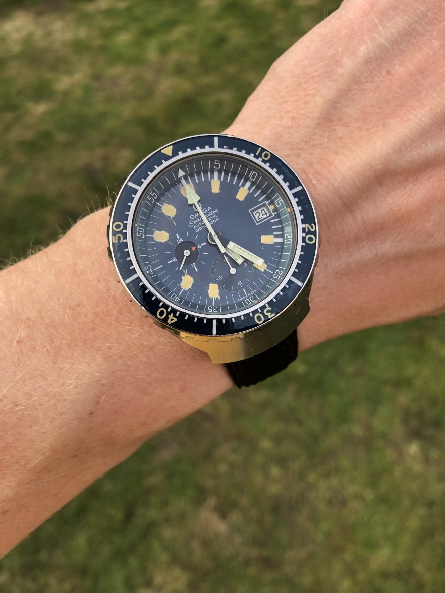

The first watch shown in your thread is mine. I'm trying to find the differences in the inner bezel. It appears that some of the zeros are a little thinner, but I'm not sure if there are others. Unfortunately I cannot accurately date my watch since it has a replacement rotor, and no movement #, only the rotor # which I believe is a relatively early replacement number, R16710.

Certainly the bottoms of the 5's are more rounded in the first, than later iterations. In person, as I look at the watch (I'm wearing it) the numbers appear slightly smaller and more squished than later version. Thanks for that observation.
