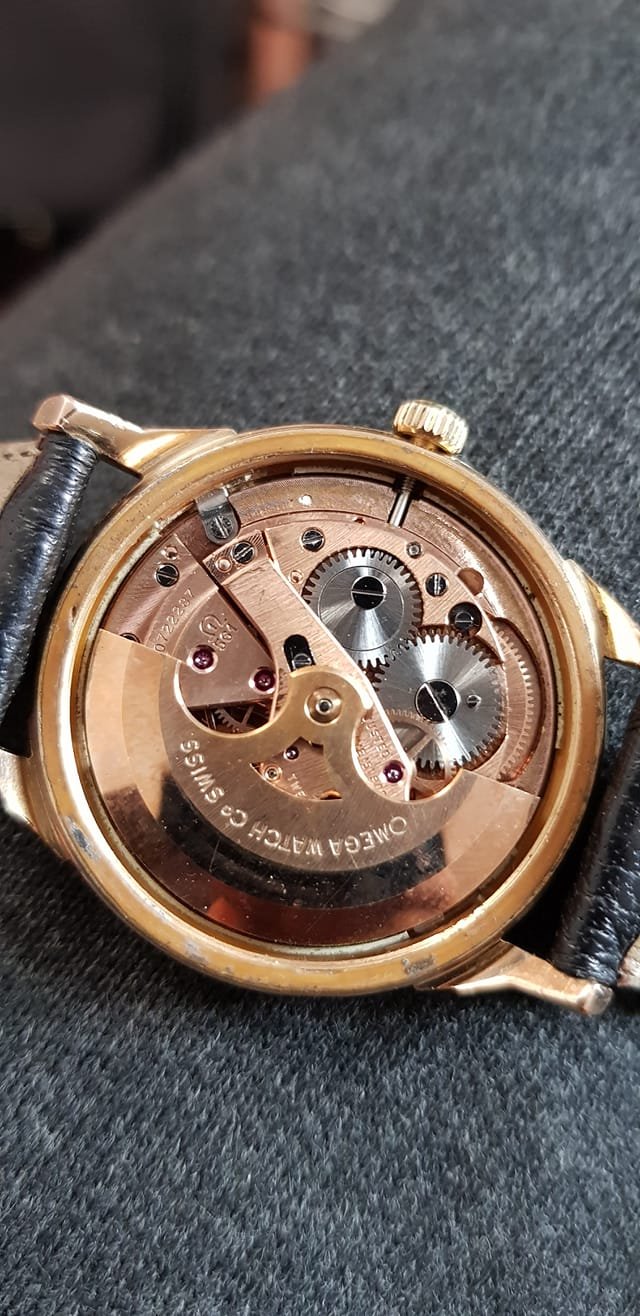

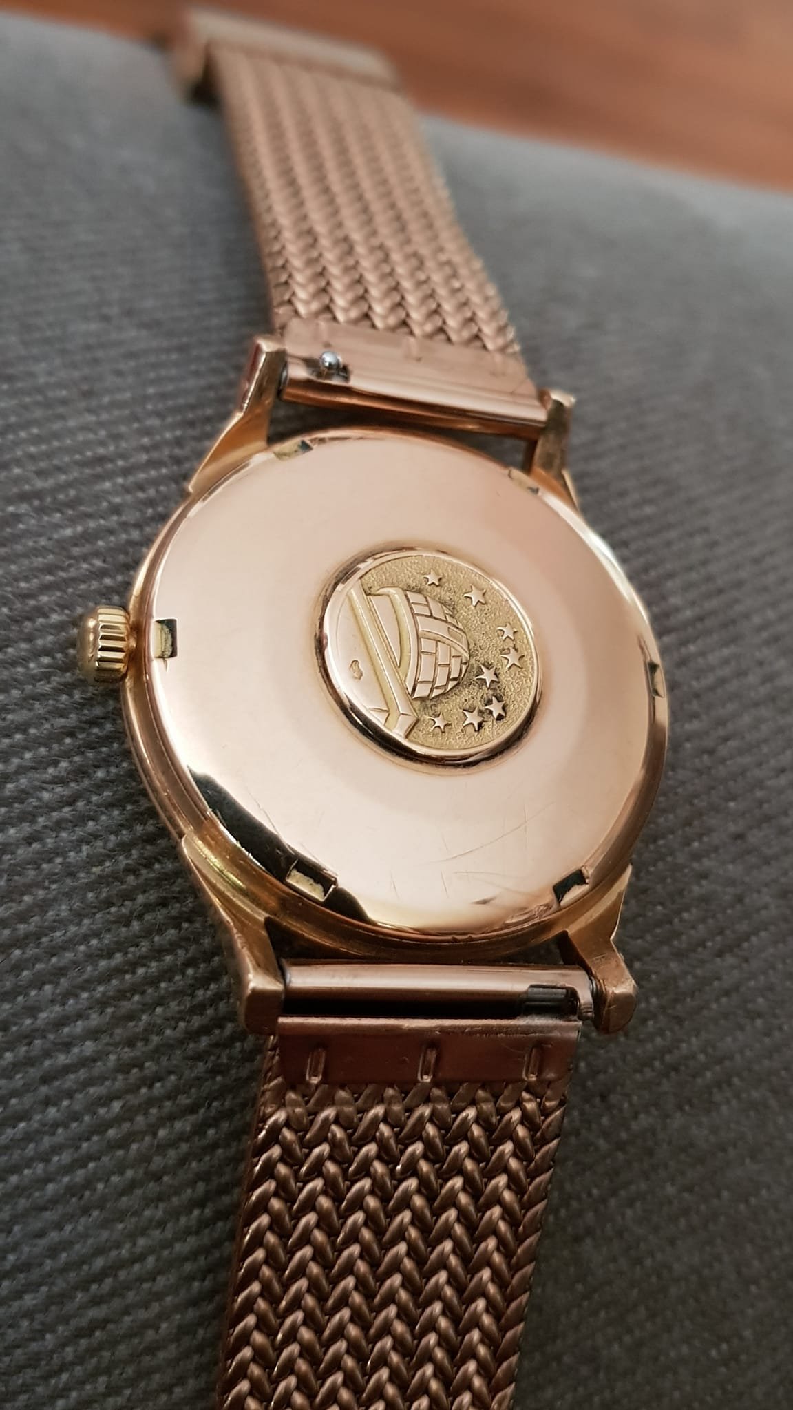

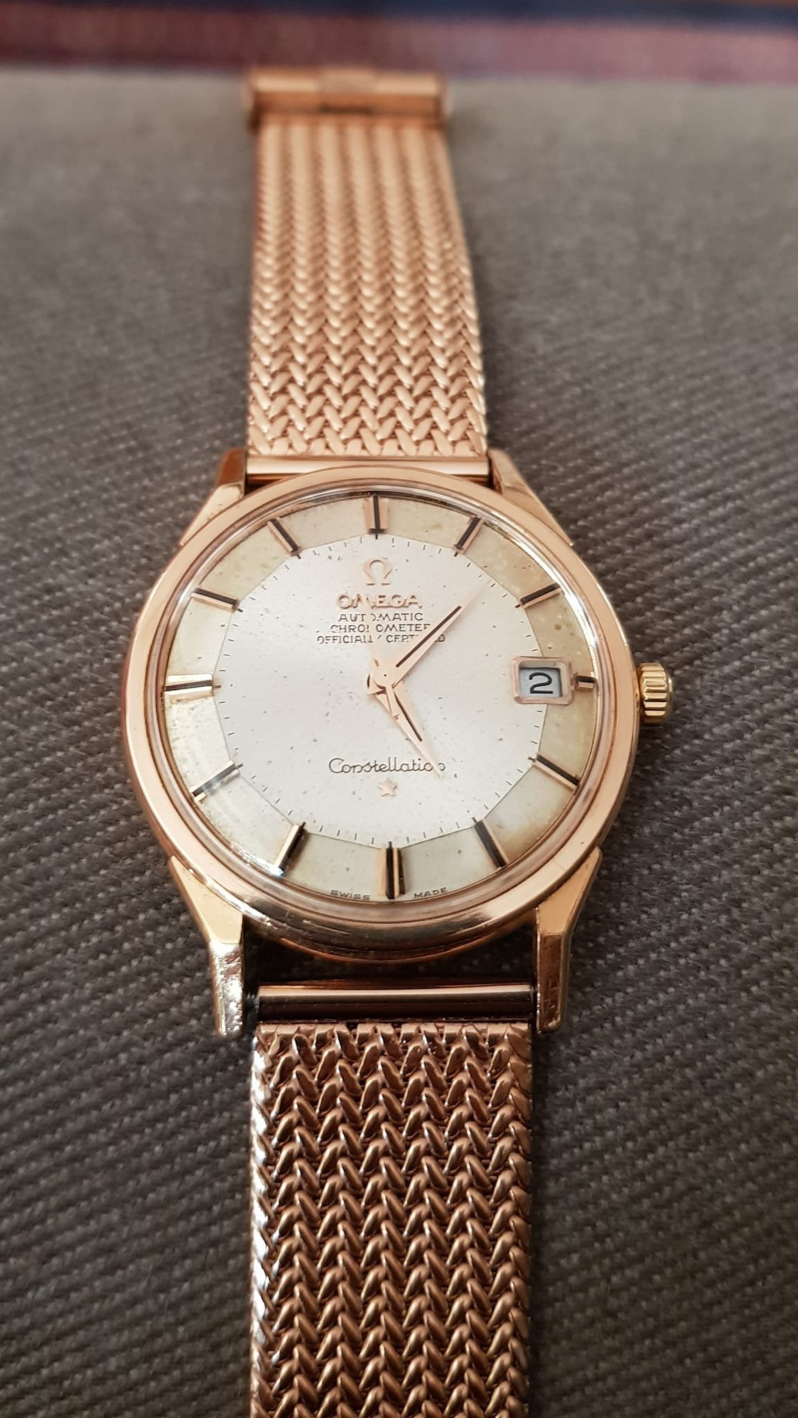

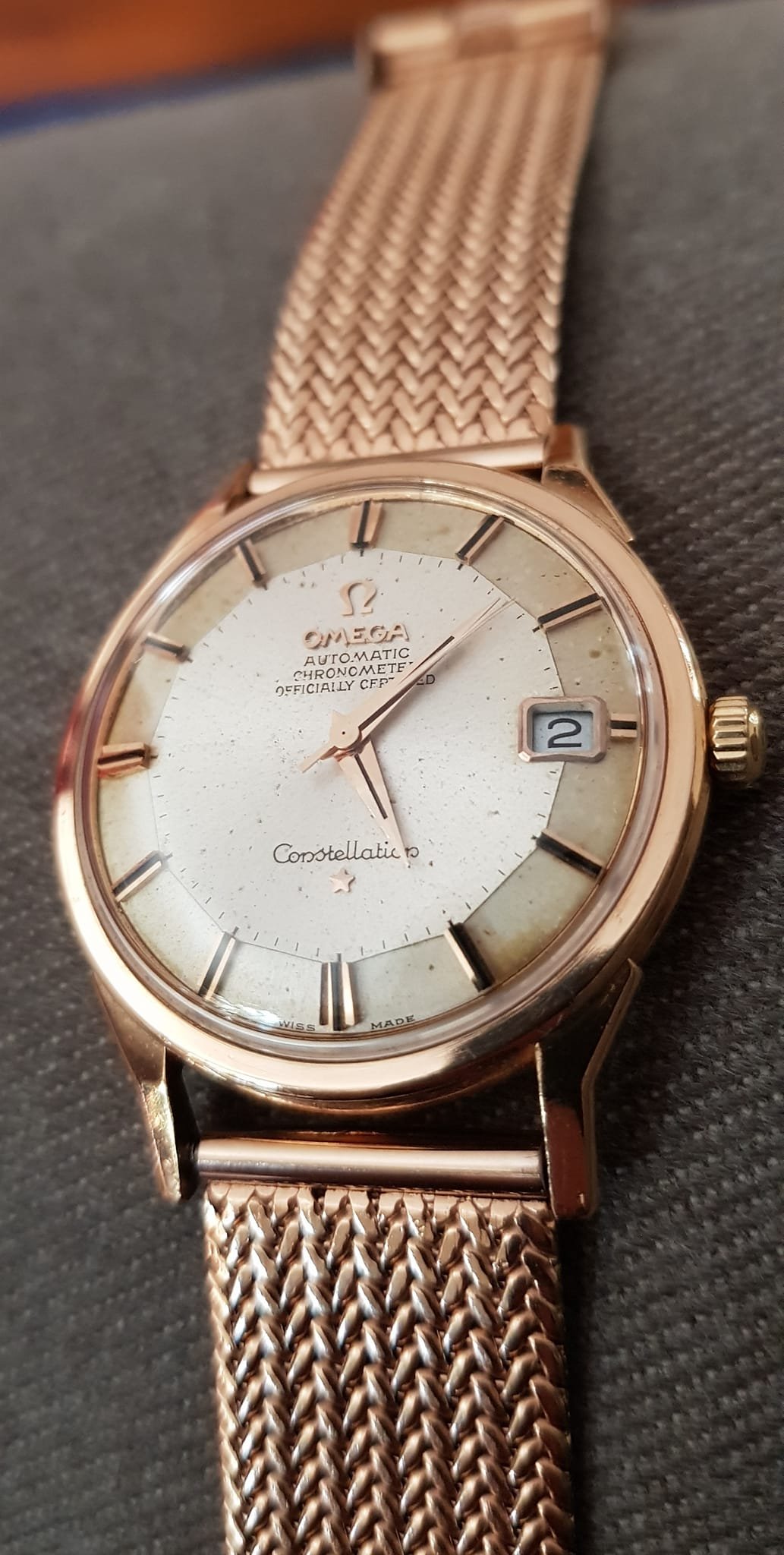

Hello Gents,
another day, another pie-pan as they say...(and by they I mean myself 😉).

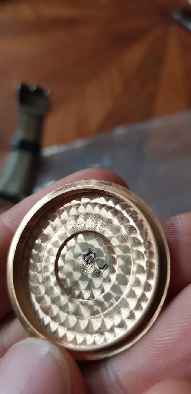

It's not visible on the photos, but the serial no. is 20722287 - so 1964
The inner case says 168.3005.
Bracelet not original.
Is it plausible to have this serial in this model? I think so?
Also, I would expect this to have "Fab.Suisse" on the dial as the serial model suggests it was made for France before we abandoned the gold standard.
What do you Gents think? If you re-assure me all is good I'm thinking of offering 2k USD for it... 😉

Apparently one sign of French cases are oversized stars on caseback medallion which this one certainly has (Maybe too big?) . My understanding is that cases were made locally (France or England) and movements/dials were imported from Suisse and installed and sold locally, so not sure that dials need to say Fab Suisse?- but need experts to clarify this
Is the case rose gold? I think you have some moderate dial issues with spotting, and the lower left lug looks damaged/scraped. And the case has been polished a fair bit. But I am on the steep learning curve.

I don’t know what the rules were regarding ‘fab suisse’ but there are lots of French cased Constellations without it on the dial.
The serial is early but fine.
The case has seen some polishing which leads to the worn down stars looking even larger than they normally do.
The crown is a replacement.
It does look like rose gold and would still be a handsome watch at the right price - but IMHO the patinated dial is somewhat at odds with a high end dress watch.
Hope that helps.

The leading 3 on the case number indicates local case production so French makes sense.

So what would u guys think is a reasonable price for this? 1.5-2k USD?
