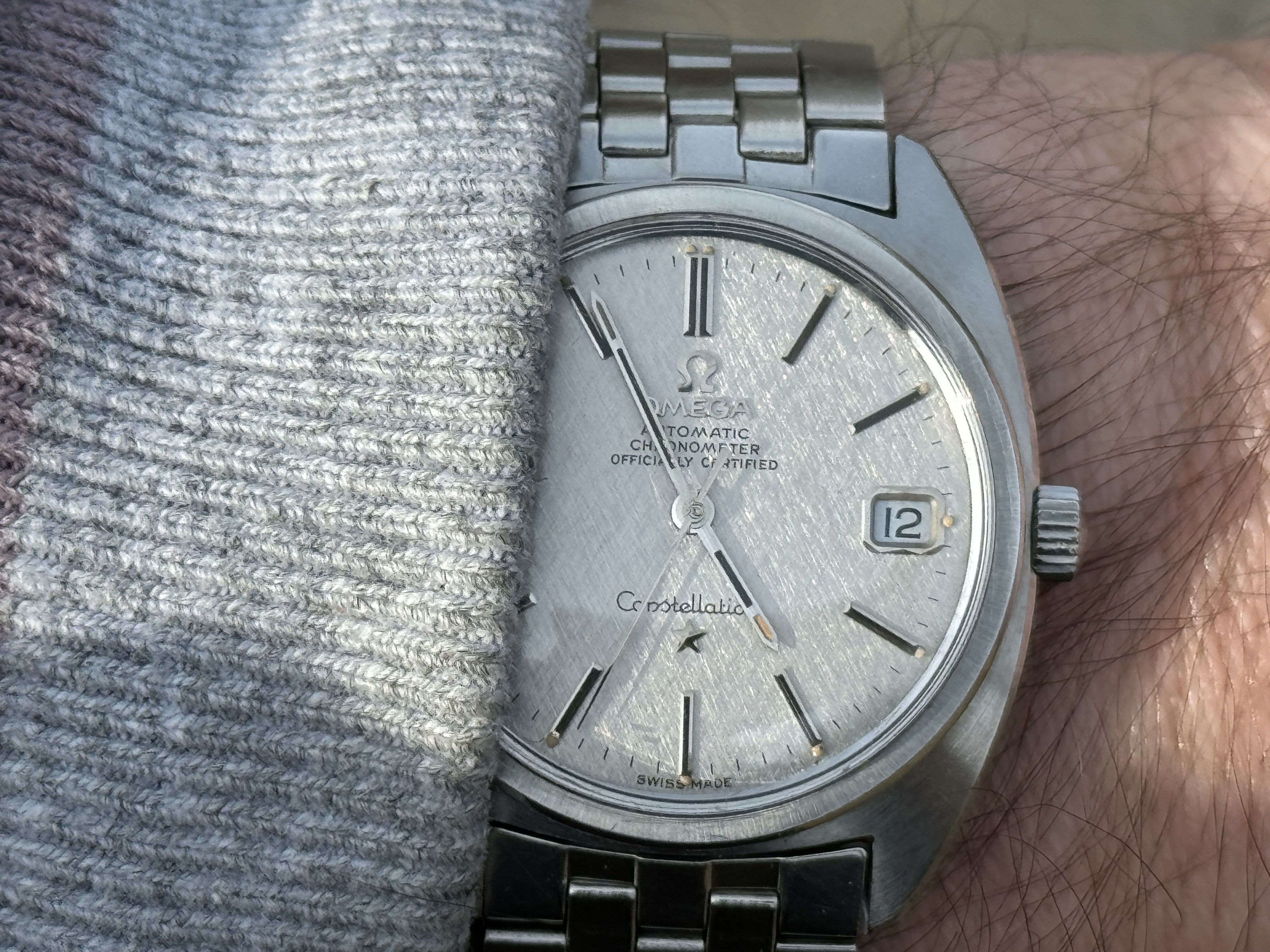

I just saw (on Google images) 2 other examples that have the straight n, but most are the curved n. I have the date only reference from 1970, ref. 168.017, that has the curved n. The lume dots on the indices seem to have been removed on your example.

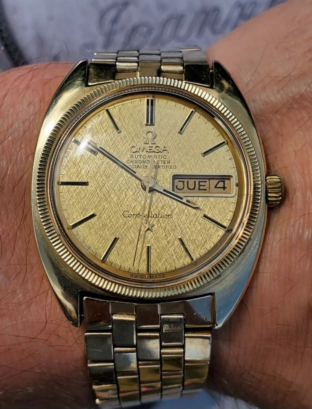

Also interesting this gold-caped model:
Any red flags here? Priced at 1670 GBP on ebay.
3,266
23,413
Later "transitional" examples of the caliber 751 C-cases introduced the new "Constellation" script lettering with a straight "n" as opposed to the previous curly "n". So that’s correct for a 70s 168.019/029.

Any other thoughts about the condition of the two examples shown?

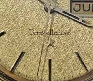

This is actually a better dial in terms of design, there is an improvement on the sides, a ring area
With this said, on the close up photo, that star looks like it might be dislodged
185
170
The dial appears original to me. When the serifs show up that crisply at high magnification it is diagnostic of an original dial. That being said, I think the price may be a bit high for that example. Of course, the value is whatever anyone is willing to pay for it.
63
98
Thanks. Are you talking about the silver or gold dial?
Edit: sorry, my mistake, understood now
185
170
The silver. I’m looking on my phone though, and I can’t really make it out the gold dial as well.

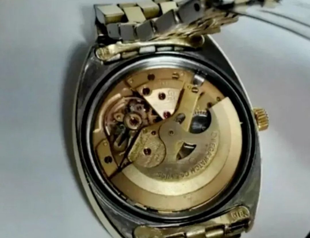

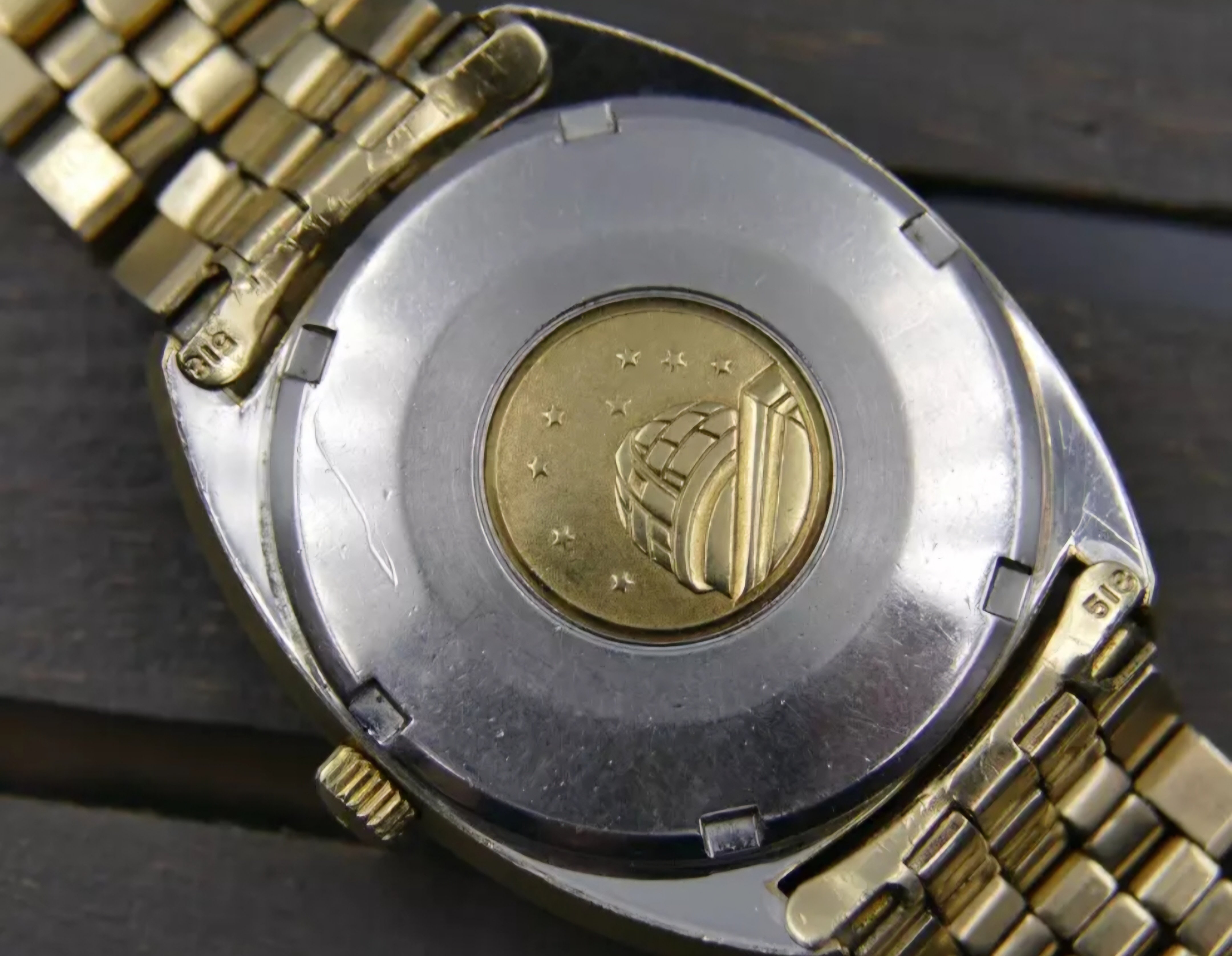

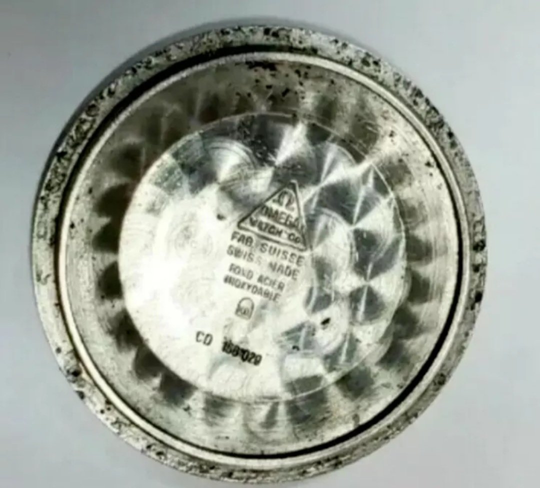

Any other thoughts or even red flags about the golden version?
13,489
31,801
Laughable price, over polished case, nasty looking movement, very pitted case back.

Thank you so much. In this case, the silver dialed should be prefered, right? not considering the price, though.
It looks like the star is facet side down. Like the facets are keeping slight above the dial.
Shouldn’t the facets side be like this?
2,677
3,151
I'm under the assumption that all stars are symmetrical, you can turn them 72 degrees and not notice any change, that facets you see are from the photo shadows - but from the photo it looks elevated, maybe possibly mis-glued in place - that part is worrisome
Actually a second look, the shadow of the star appearing under the star, kinda proves the star isn't inserted, so it's best a pass, mainly out of fear that there is glue on the dial
3,266
23,413
Agreed. It looks like the star was glued on upside down. It’s a shame as the rest of it looks quite nice.
