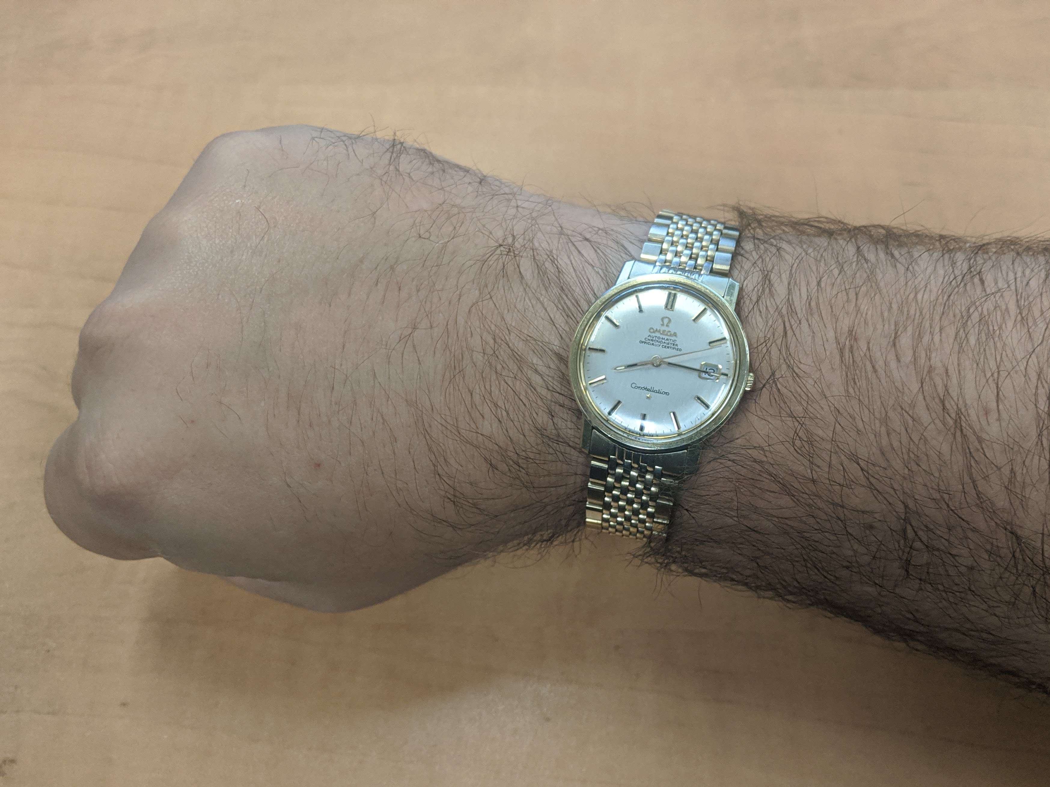

    Since this thread got resurrected - I might as well provide an update!
    The watch was serviced locally and I had them keep everything as original as possible (except a new mainspring).
    As people alluded to earlier the thread the 1068 bracelet wasn't easy to source. I found a pretty decent one out of the Netherlands (need to keep it geographically correct, right?). The clasp was obviously 'tweaked' a few times to insure it stays closed but the gold plating on the whole bracelet was in really good shape. I've been keeping an eye out for a replacement/donor clasp.
    The 527 endlinks were found on Ebay pretty easily after I got the bracelet.
    What good would this post be without a picture?!
