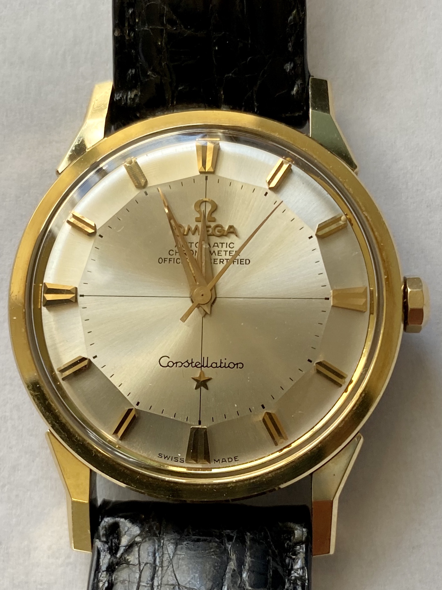

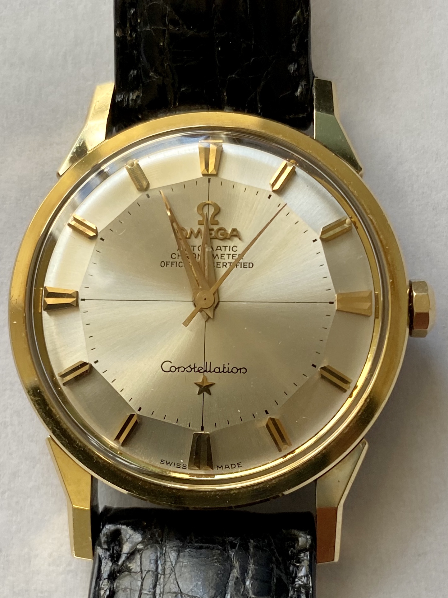

One more example of early Piepan from 1959 with the longer hour hand.
Thanks @Arno (NL) for the picture

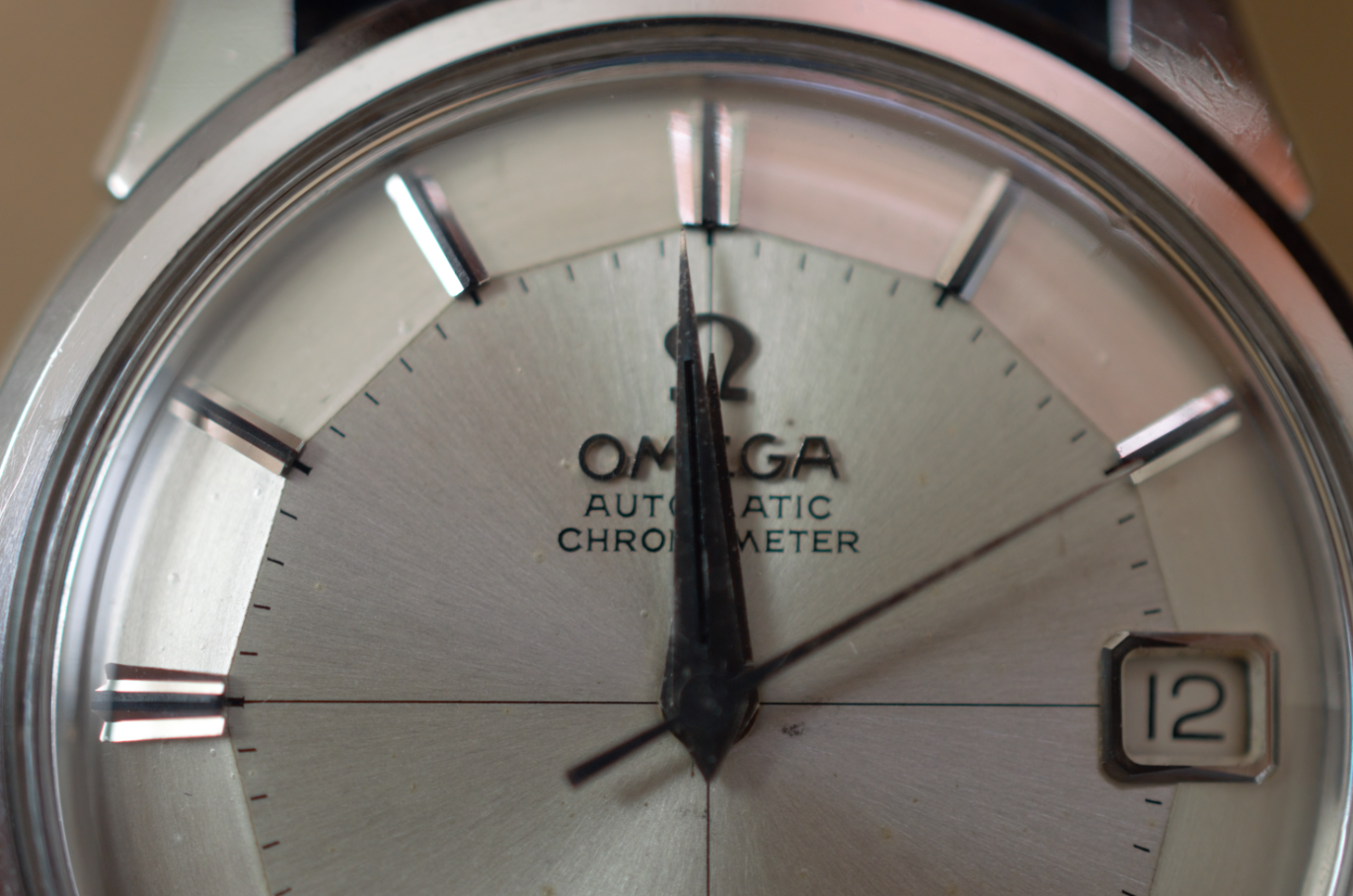

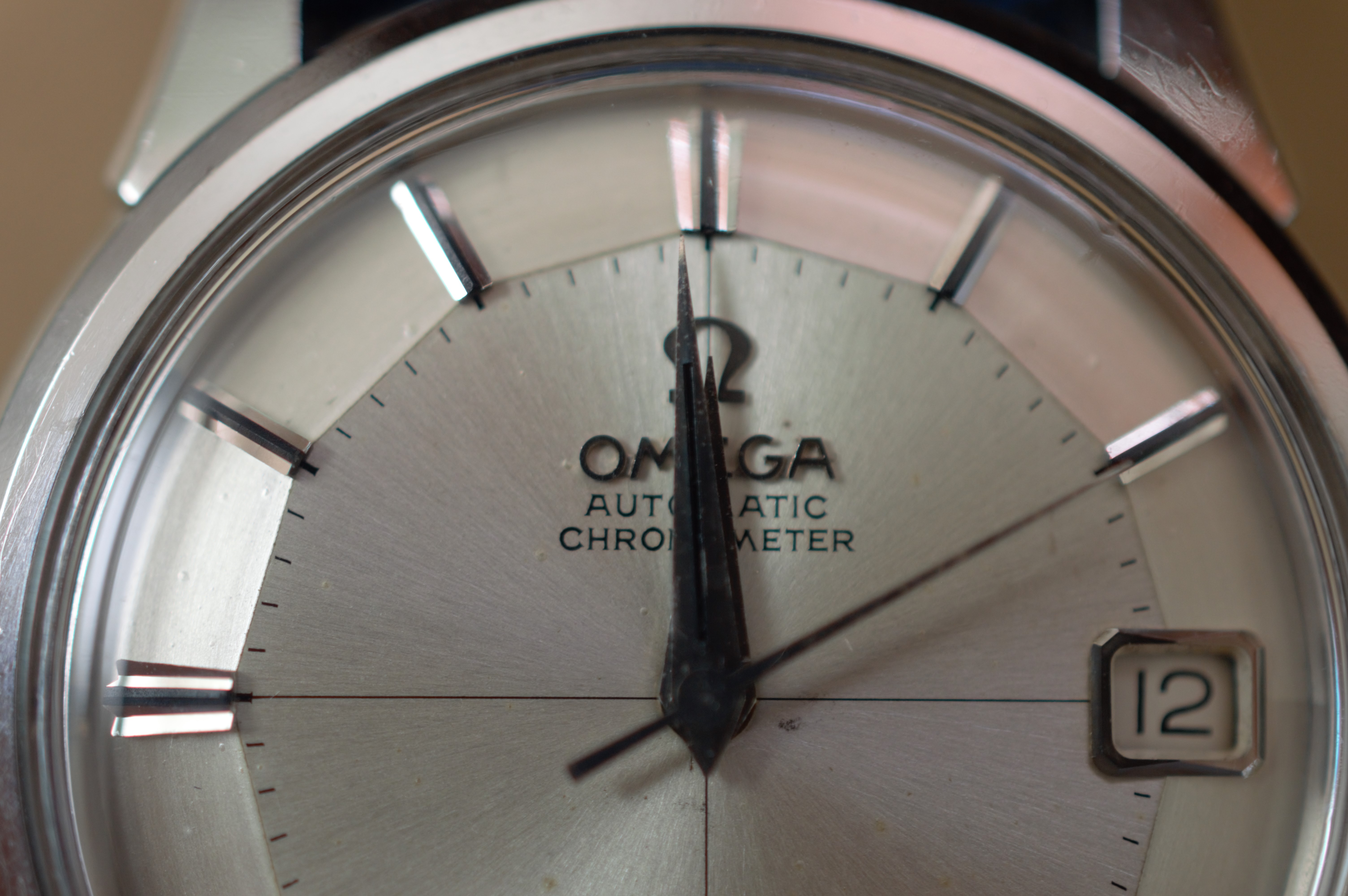

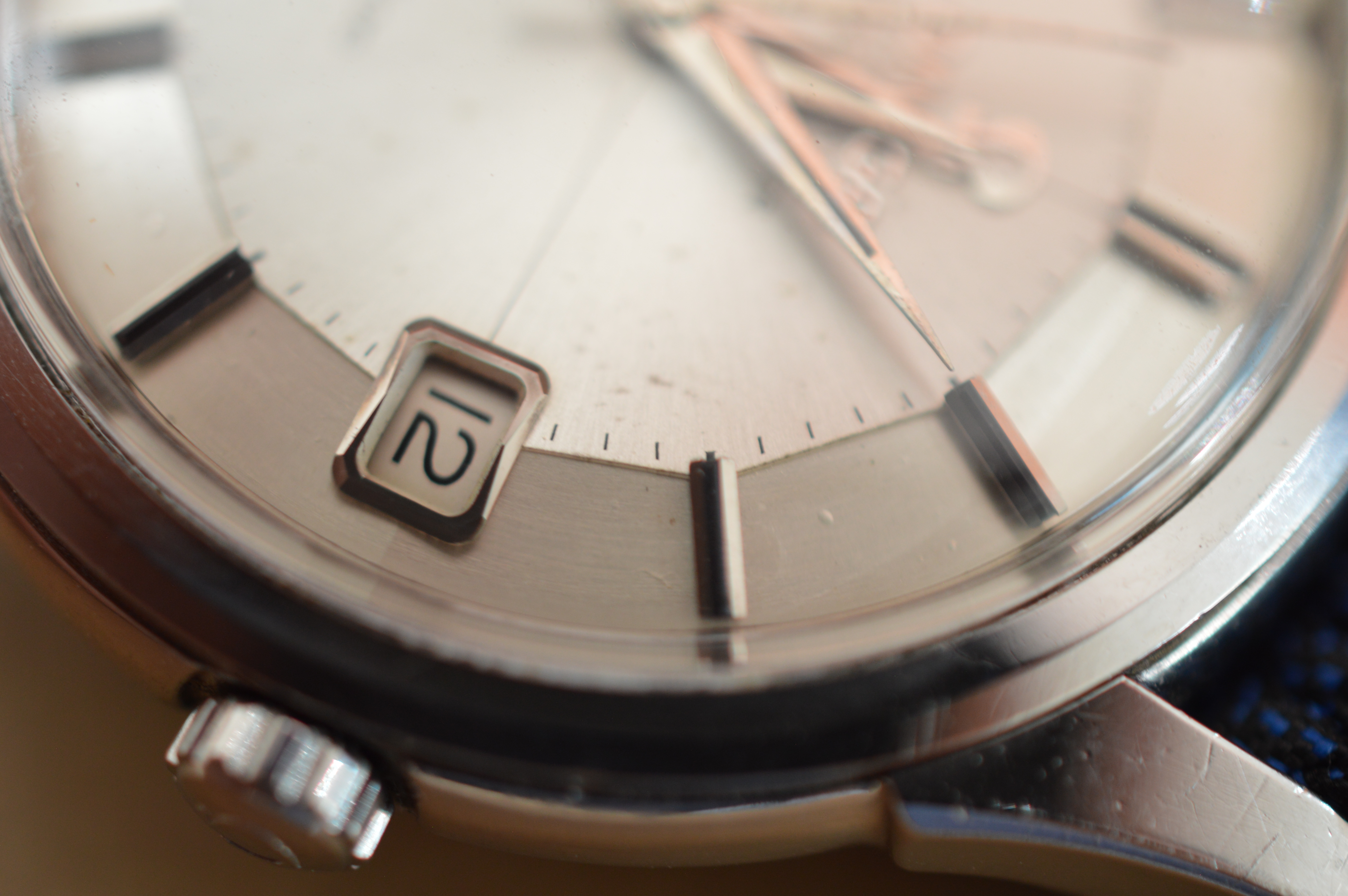

Hi @Caliber561
great, thanks for your shot!
Can you gave us the year of each watch?
On the first pictures, it is exactly the same length that the one I’ve found on Connie until 1963.
On the second picture, hour hand seems a bit shorter, or is it due to the glass?
Well, I guess we start to have several exemples to confirm that there is indeed two length, one until around 1963 and a longer model then

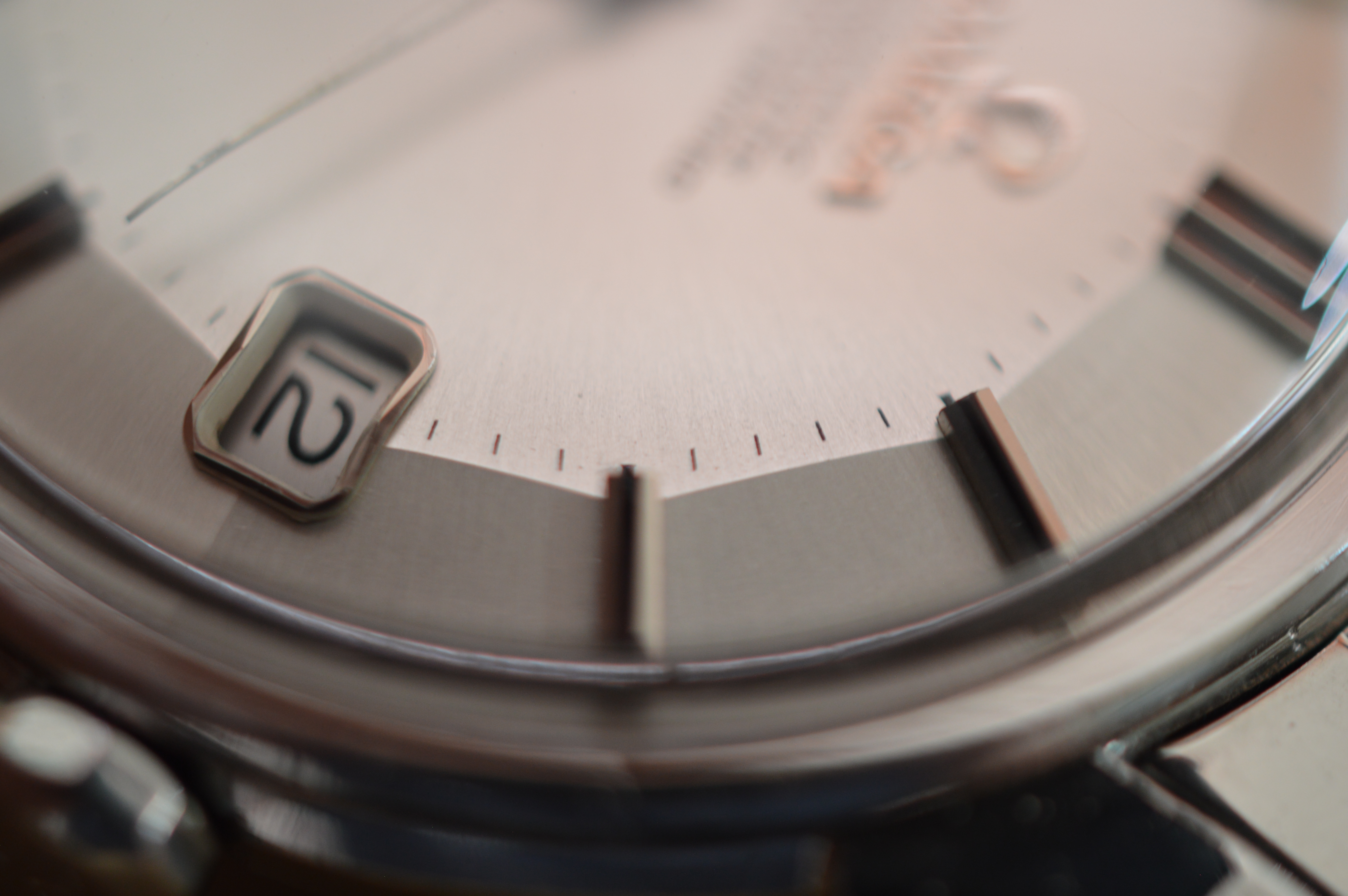

The Arabic Cardinal Dial Connie is from 1962, and the Onyx Insert 168.005 is from 1966.
In the second picture, the hour hand definitely seems to be shorter than the 14900's hour hand, but only if using the AML as the benchmark.

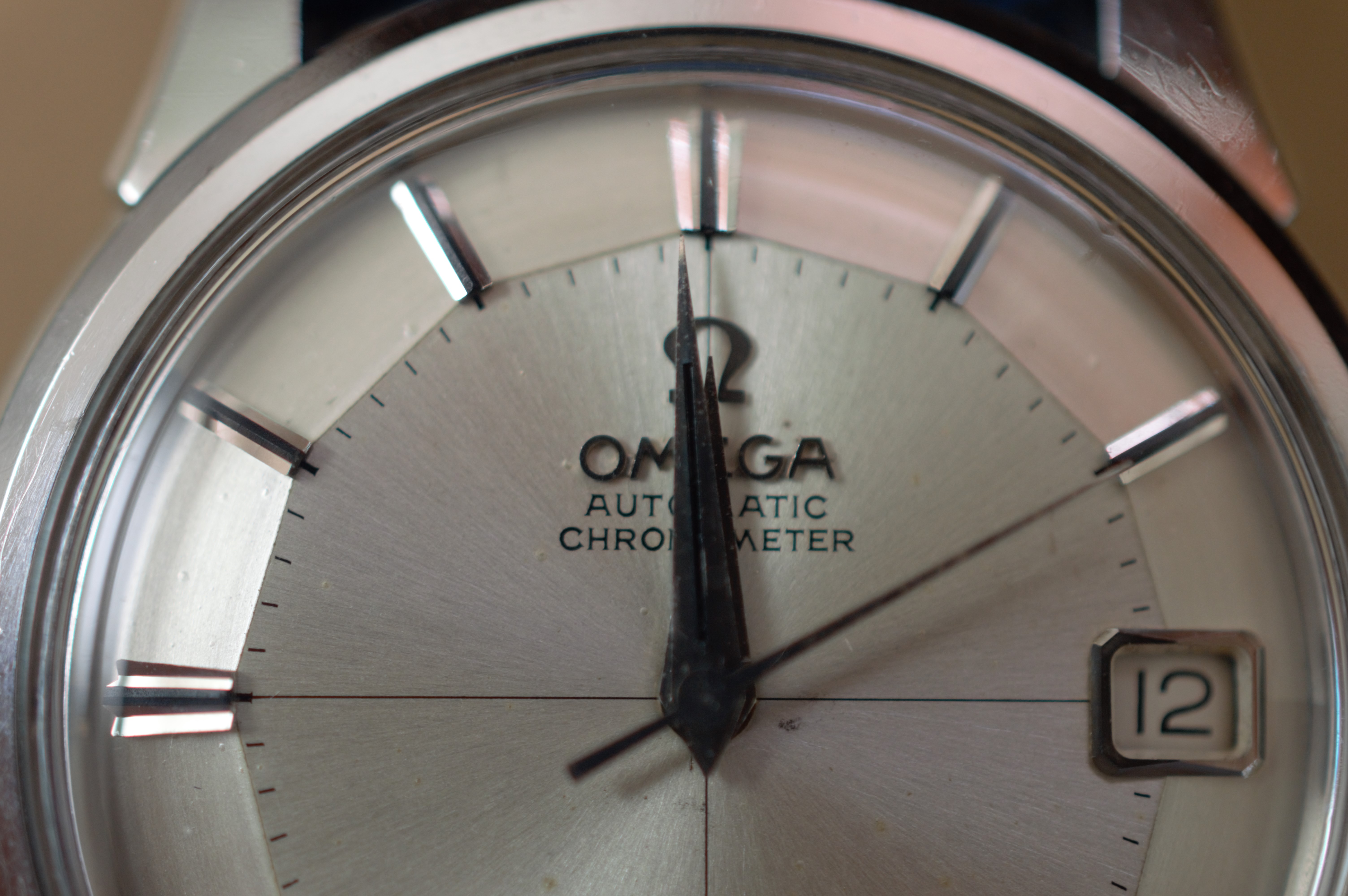

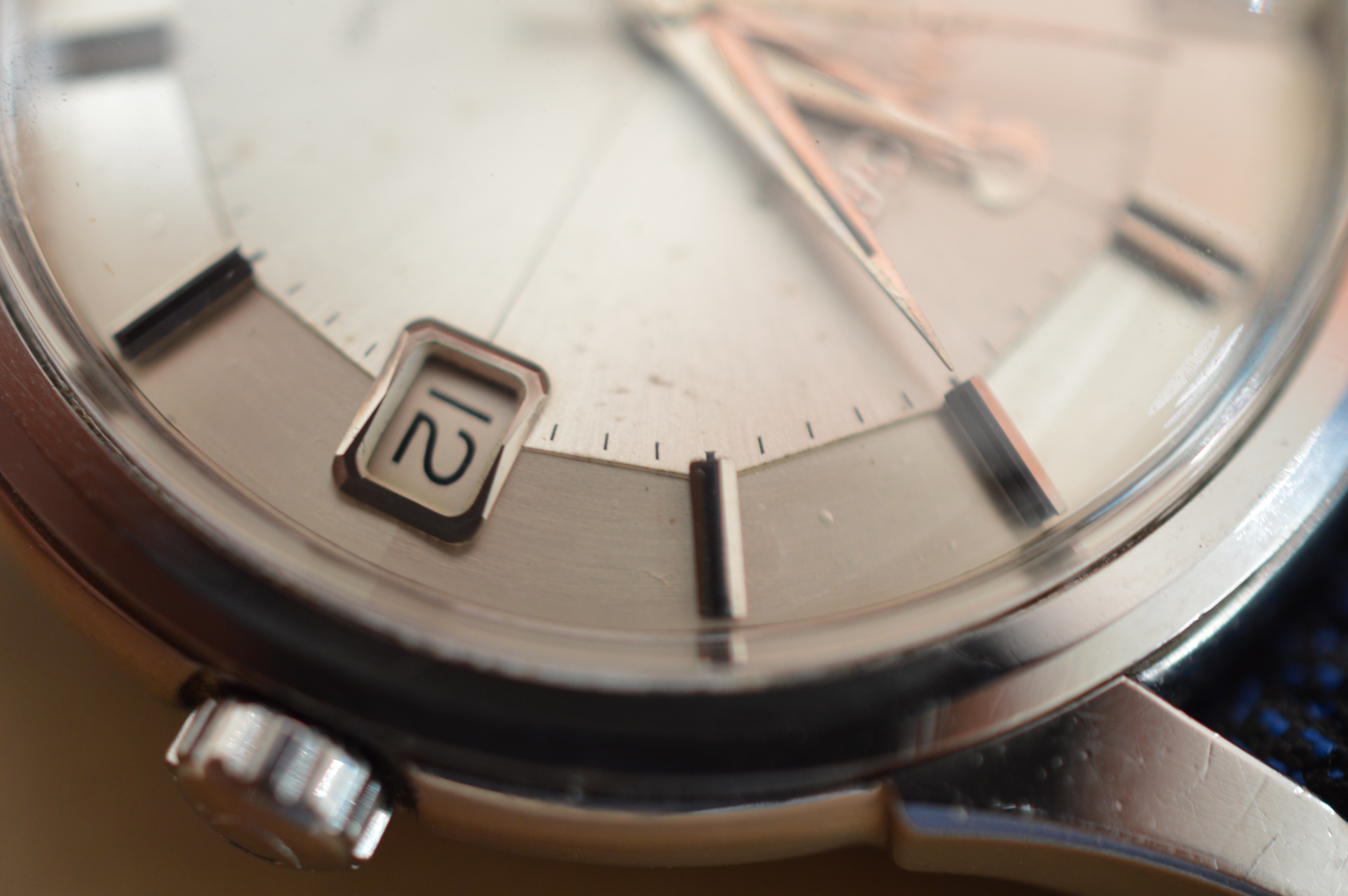

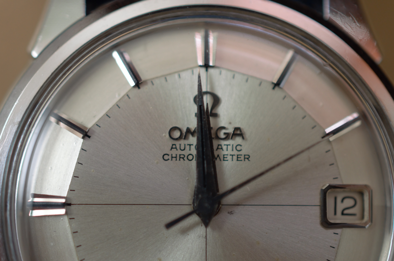

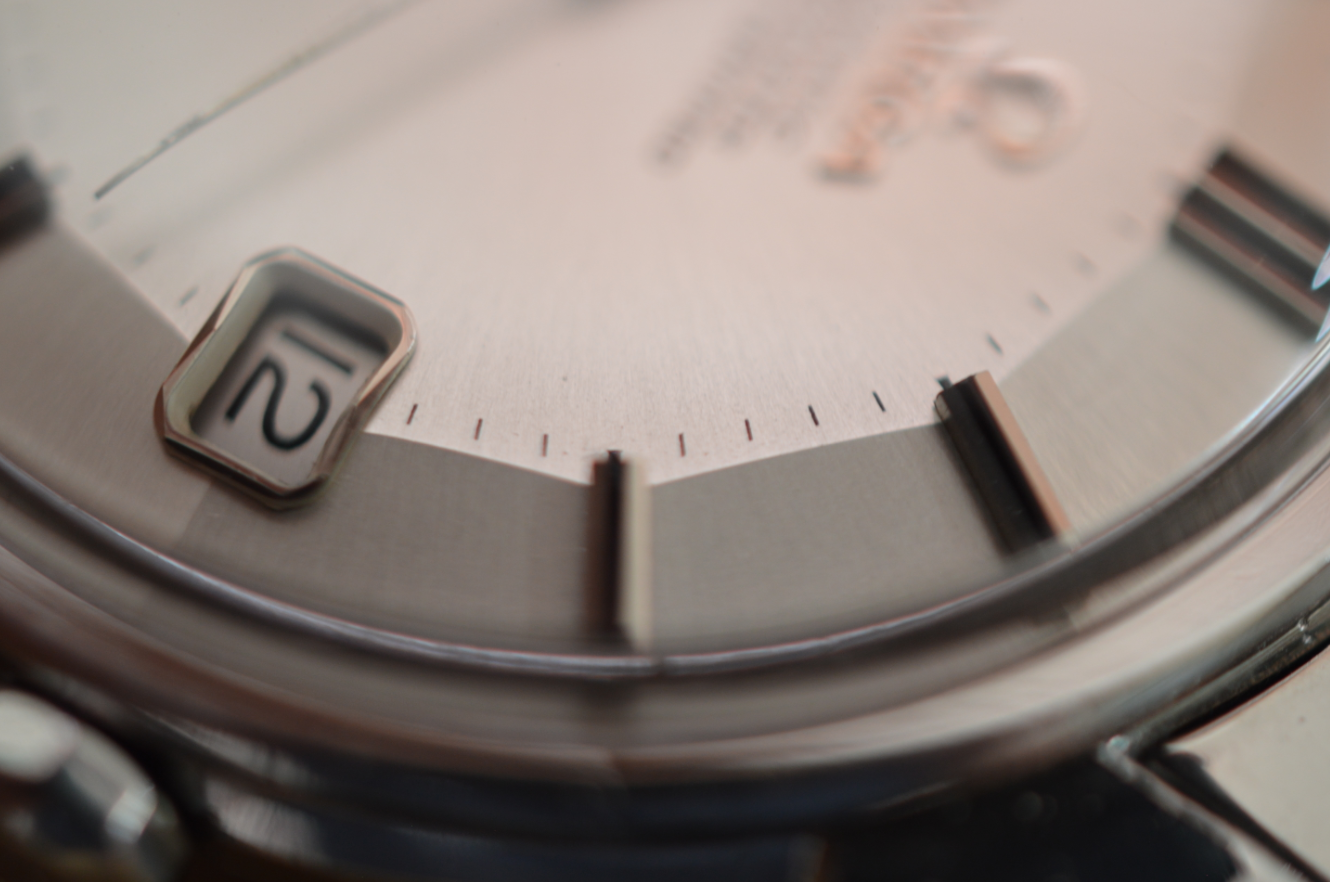

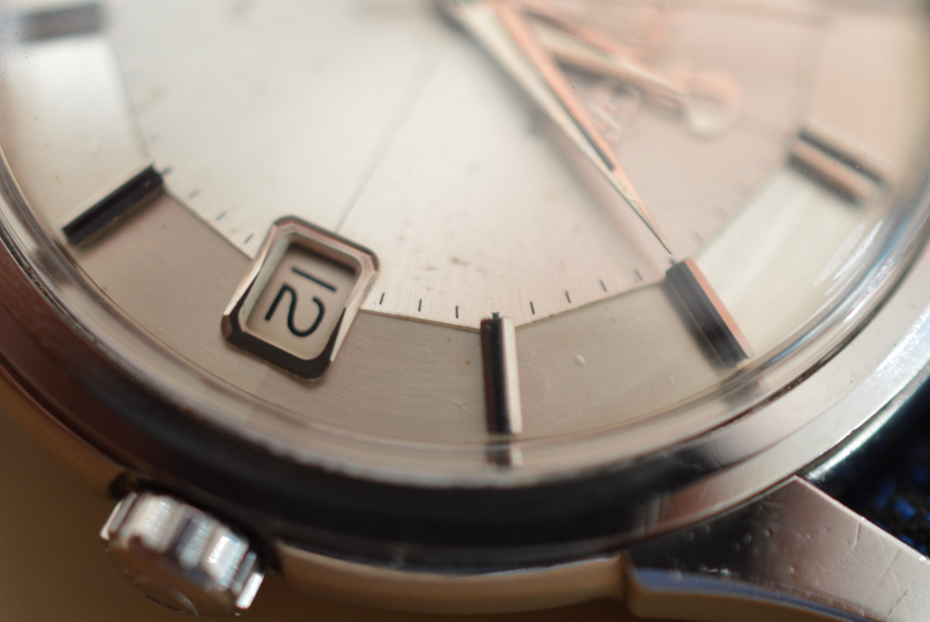

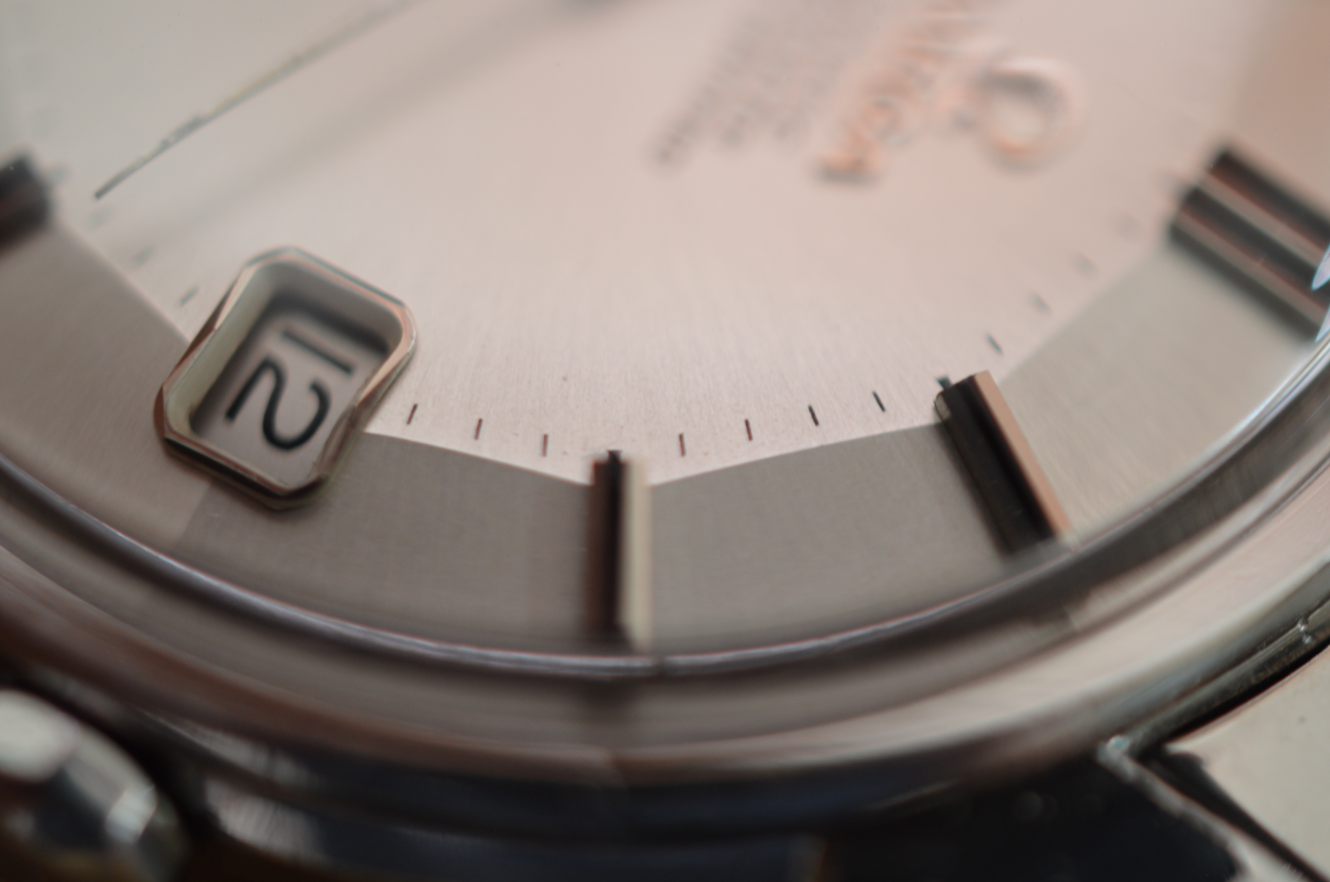

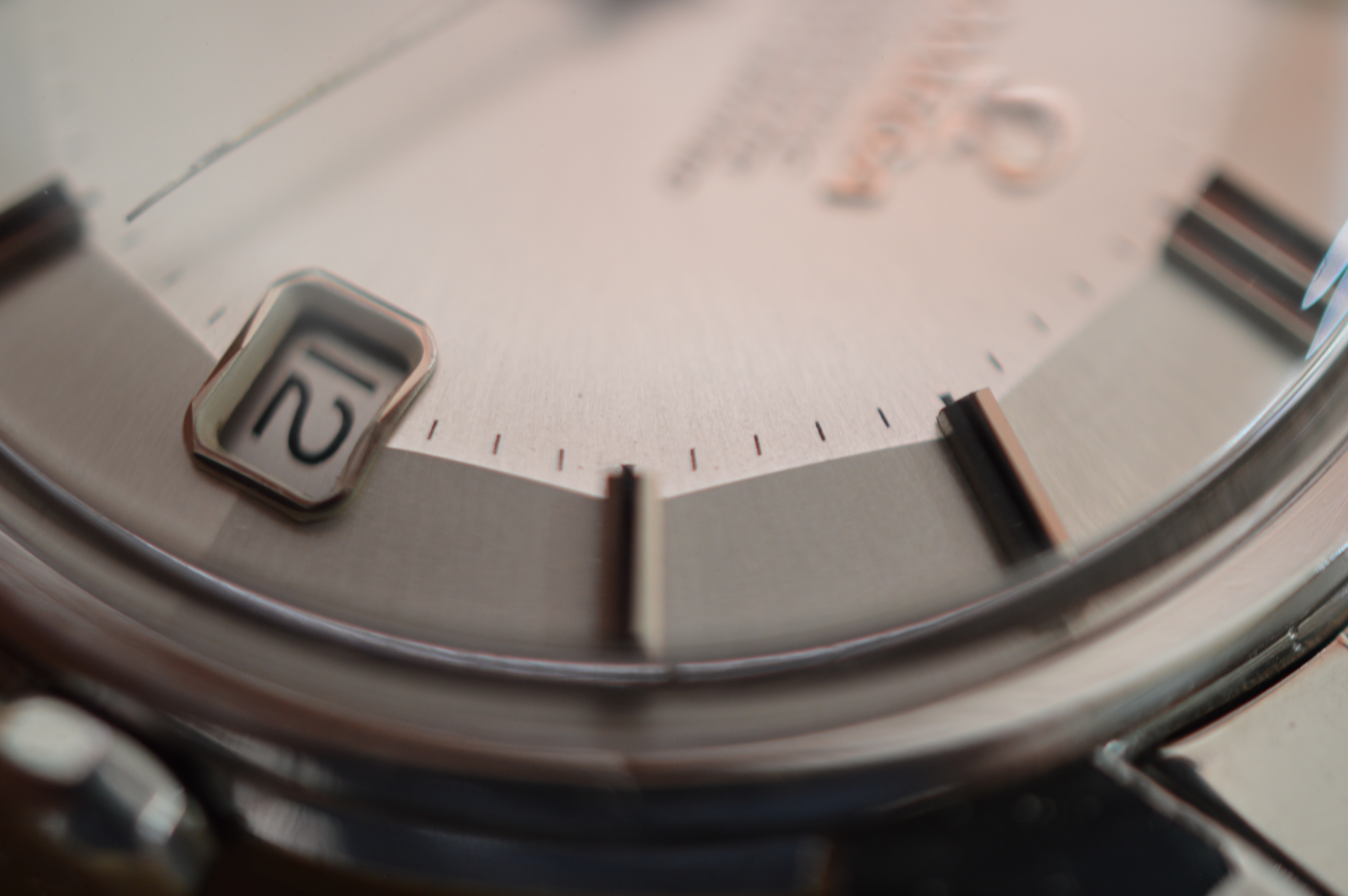

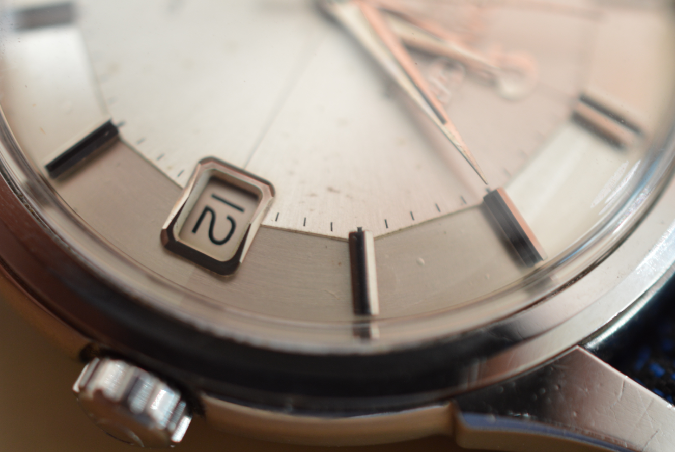

I do not know if this is a widely-known detail, but I found it interesting and figured it ought to be pointed out if it hasn't been already. Basically, both my 14900 and 168.005 do not have step dials, but I have a 14393 that does have a step dial. Assuming that the date windows are at the same location (same movement), we can use them as a reference point to see that their minute tracks seem to be placed at slightly different distances from the center of the dial. I've attached some photos to illustrate the difference.
14393:
168.005:
I can also confirm that the 14393 seems to have the "longer" hour hand. However, it should be noted that the dial is missing the "Officially Certified" script, and the spacing between "OMEGA" and the AML is different compared to the OC, no-step dials I own.
505
738
Thanks for this feedbacks, so now we have confirmation that there is a difference around 1963, but we have two options:
- either the hour hand is longer
- or the AML is not as the same place
6,832
10,502
Actually, it could be both
As @ConElPueblo noted above, the 14393 dial is slightly smaller - but the date window will have to stay in the same place relative to the centre point of the dial as its position is governed by the movt. (hence @Caliber561's splendid illustrative photos above)
However, if the Omega symbol and wording are consistently arranged at the same distance from the pie-pan edge, then (if the hour hand remains the same length) the hour hand would naturally intrude further into the Omega symbol.
This doesn't mean to say that the earlier watches don't have the longer hour hand we are discussing but the only way to tell would be to measure the distance from the centre point to the Omega symbol (and the length of the hour hand of course)

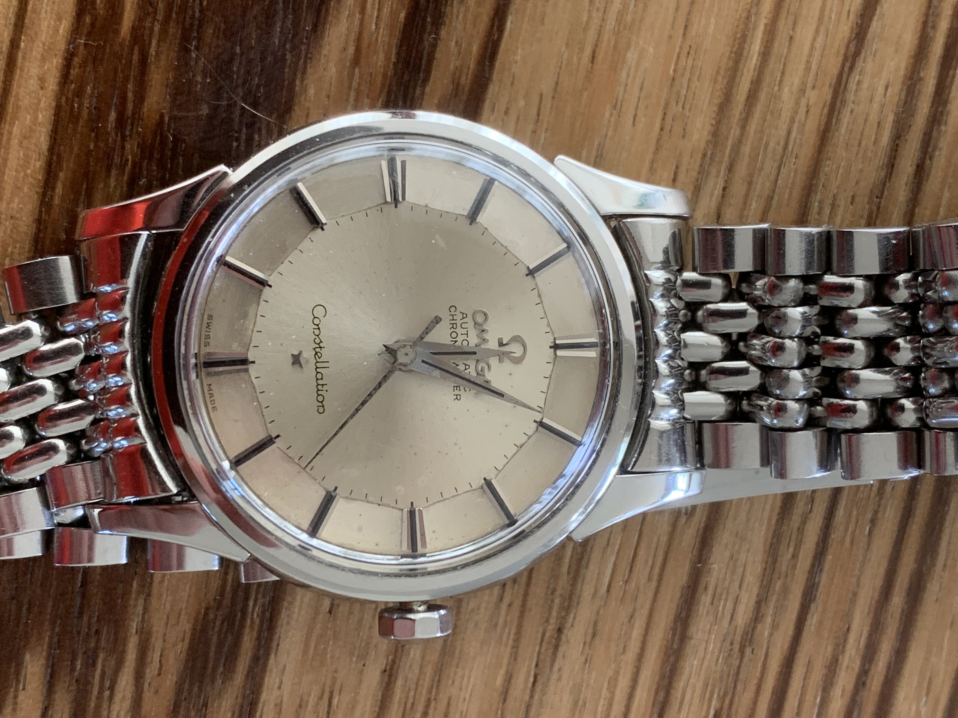

Here another example with this beautiful 1962 14900 from @gbesq
Still an early model with the longer hour hand
