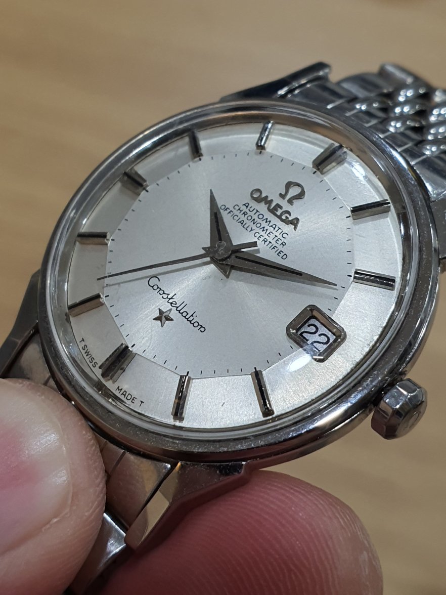

Ive recently came across another pie pan dial constellation and from my research it is 168.005 but i have few authenticity questions before purchasing this piece. One of my concern is the T Swiss Made T .. ive researched about this but english is my second language and ive had little success. From my limited knowledge it is supposed to be indication of tritium dial. Do you guys think this is genuine? Any help would be great thanks!

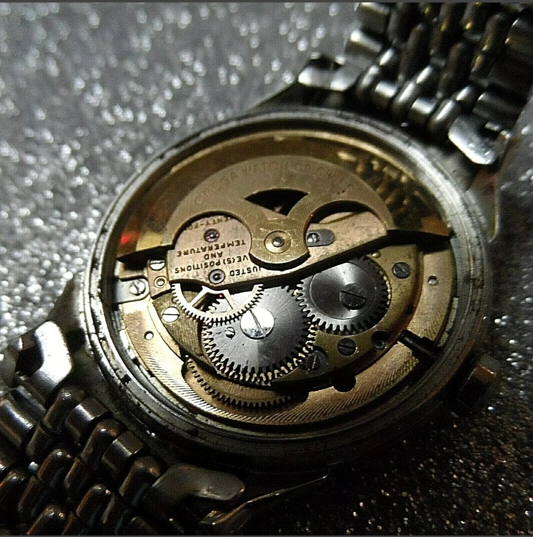

Also Ive been trying to get better photos of the movement but the seller says i will need to wait a bit for him to get a proper tool to open it up. From the picture it looks tired.

Hi,
I think this is a redial, font looks off.
"T Swiss Made T" without lume on the dial is a hard pass anyway.
Movement looks tired as you already pointed out.

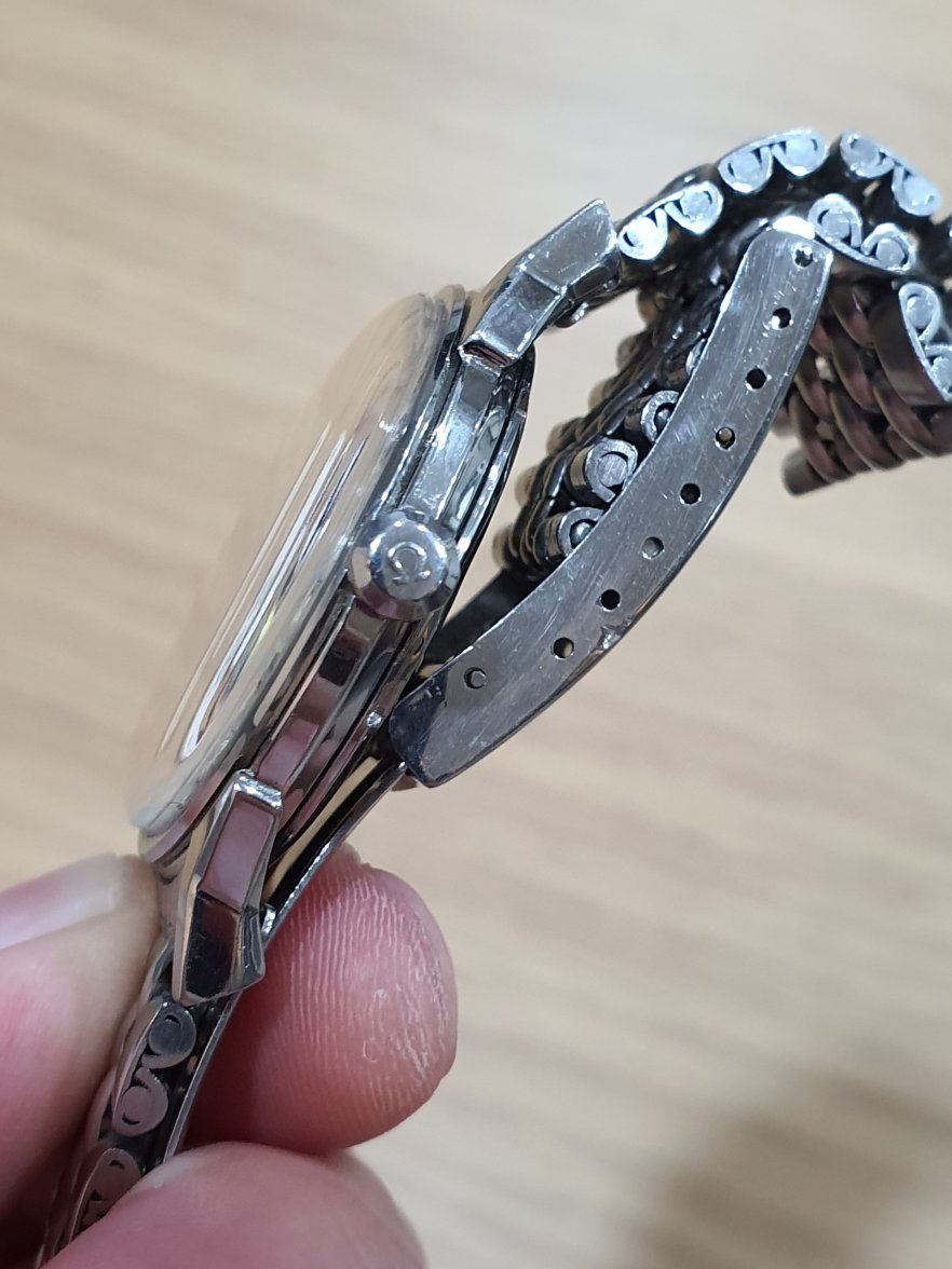

Second hand is too long, crown protrudes...
Pass!

Thanks for the help and confirming my concerns
