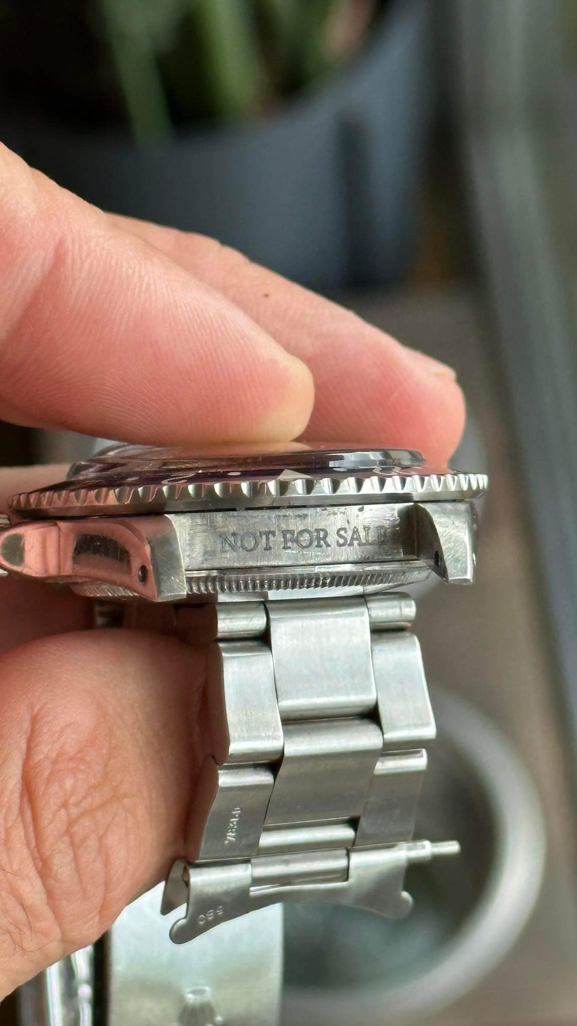

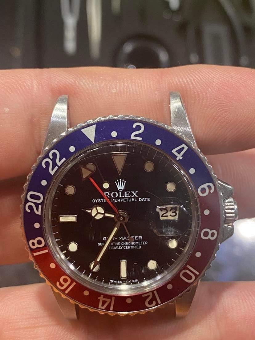

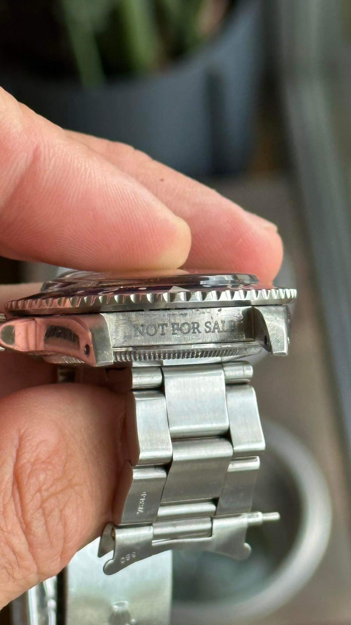

Hello
Rolex 16750 has a text that says "not for sale" on its sides.
Has anybody seen a situation like this before?

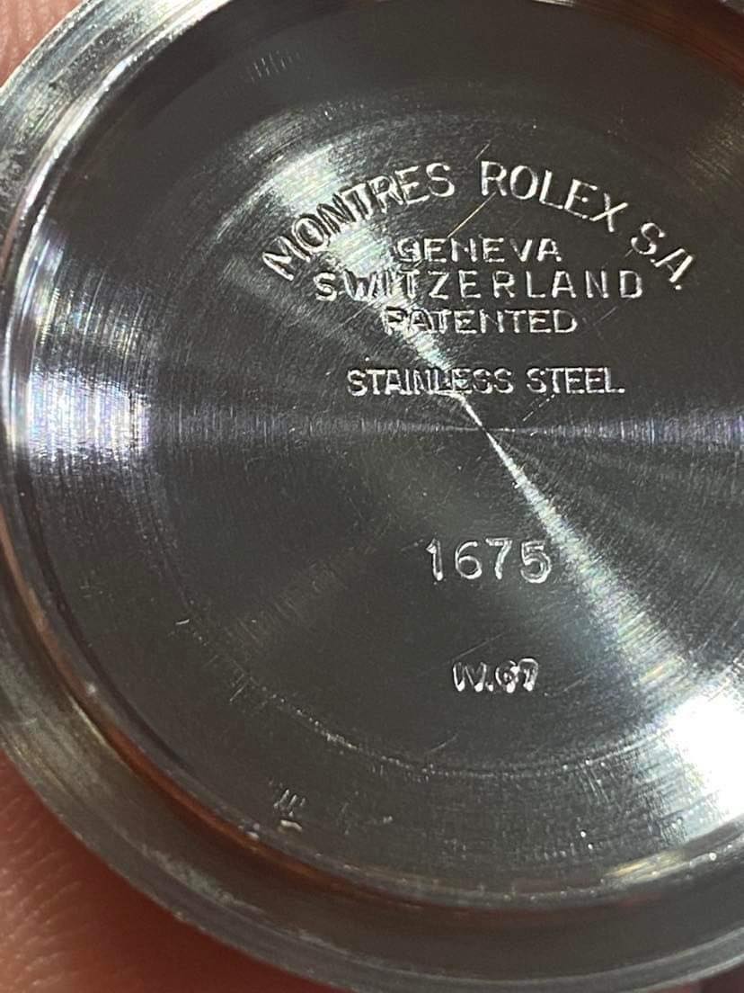

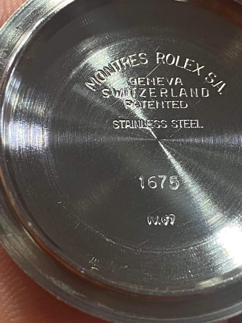

and no SN? best case scenario (pun not intended, happy accident) franken watch with after market case, real movement and caseback. The case might be real but modified, still iffy.
1,388
850
Was a display watch. Someone has put a movement in it

More like a Franken watch built from parts with a display case 🤔

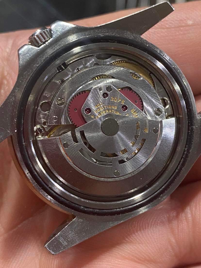

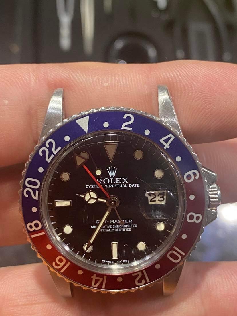

In addition to the other issues, AFAIK, the hand stack on a 1675 from bottom to top is GMT, hour, min, sec. This one looks like the gmt had is above the hour hand like a GMT II. Also the clyclopse mag looks weak.
24,799
55,081

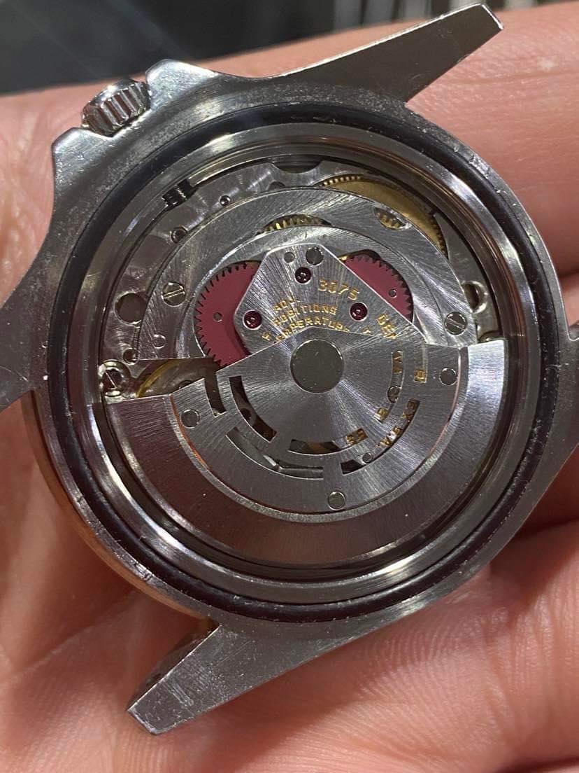

Indeed, the caliber 3075 is visible in the movement photo. 😁
944
2,450
Oh goodness, haha!

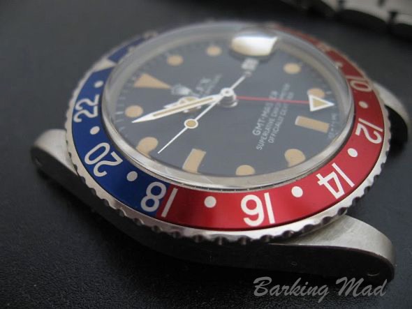

5,430
82,030

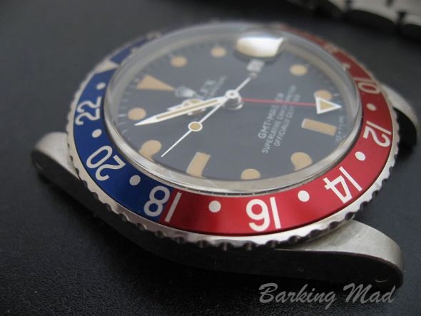

Here you go..
