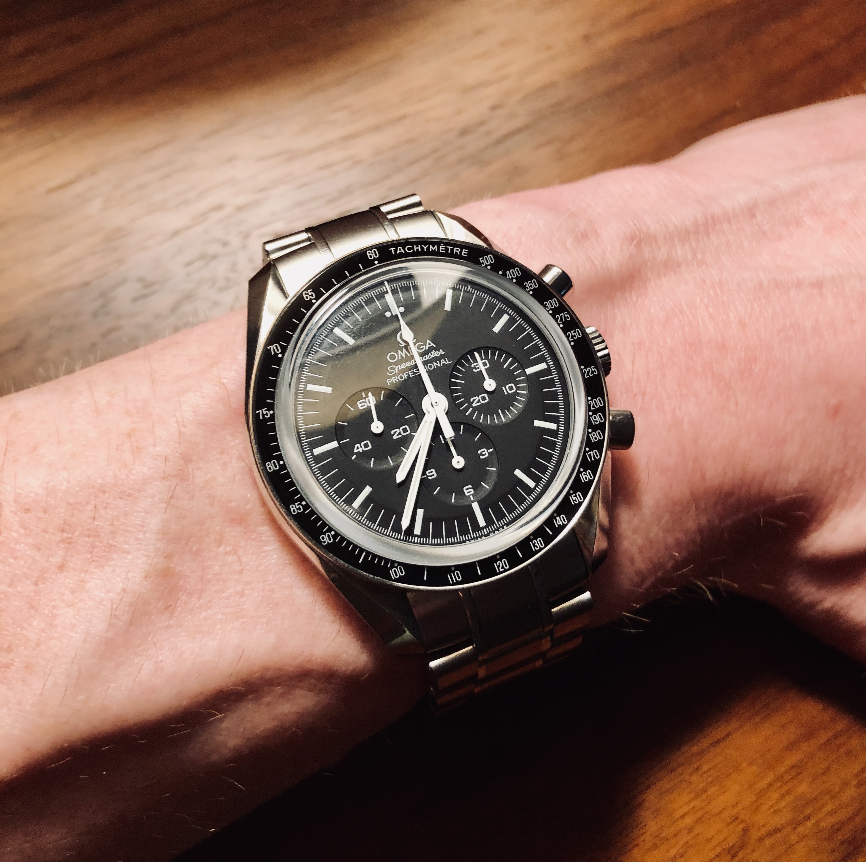

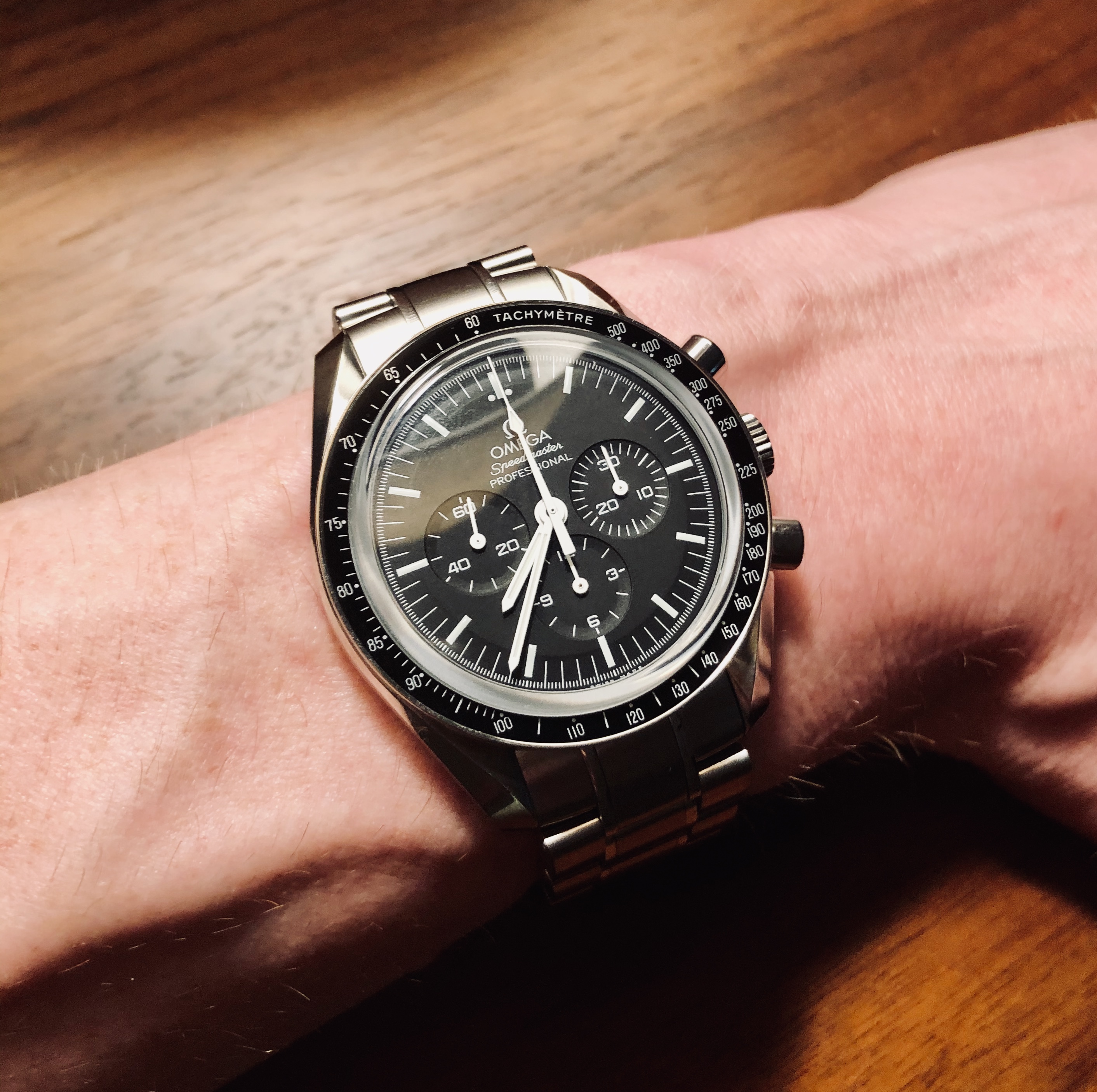

I'm roughly 3 months in to owning a new sapphire sandwich moonwatch. Recently I noticed a small dust speck inside the case between the front crystal and dial at about the 11 o'clock position. The speck seems to be sticking to the crystal itself and while largely unnoticeable, it's bugging me now that I've seen it.
The case has not been opened since purchasing it new back in July so I'm somewhat perplexed how the piece of dust got in there and through QC at Omega before landing on my wrist.
My question is: is there a way to open the case and remove the spec of dust with air or another method without taking it back to the OB where it was purchased? I would like to avoid any chance of damage or allowing even more dust to enter the case during this process, so maybe I've already answered my own question. I'm not a watchmaker or even someone who would want to pretend to be one so my preference would be to err on the side of absolute caution in this regard.
Have others seen things like this in a brand new watch that hasn't been opened before? Is it something I should just get accustomed to living with or do you feel like I should go back to the OB and have them get the spec out of there for me?
For the life of me, I've been unable to get the speck to appear in photos (which exhibits how small it is), but to add some life to the post, here's a quick shot of the watch.

I don't see any speck but I do see a mottled appearance around 11, is that smudges on the outside of the crystal or inside? If it's on the inside something isn't right..

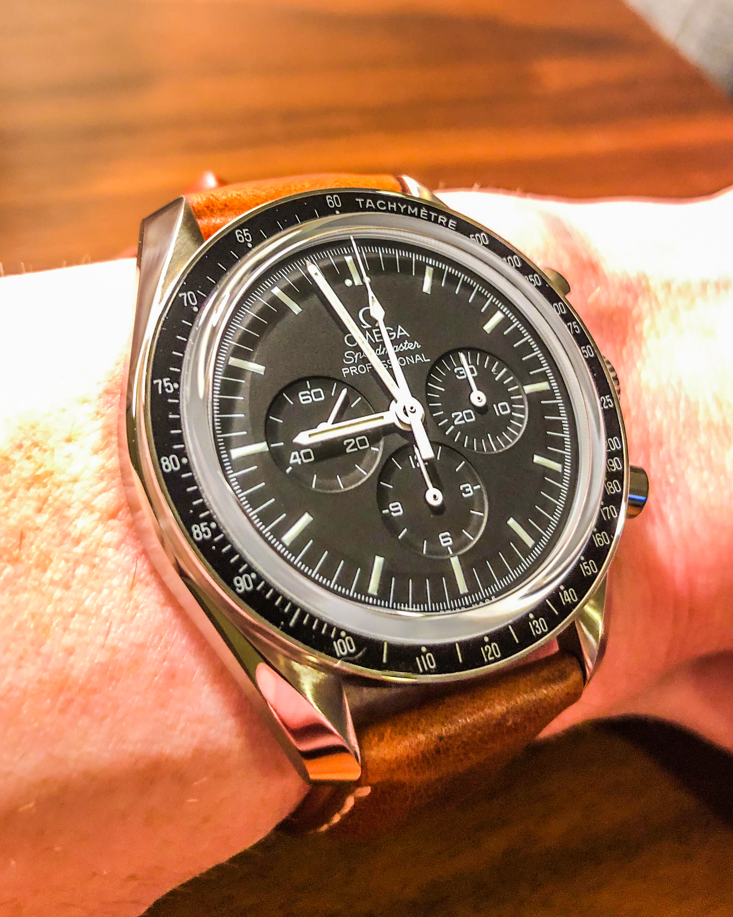

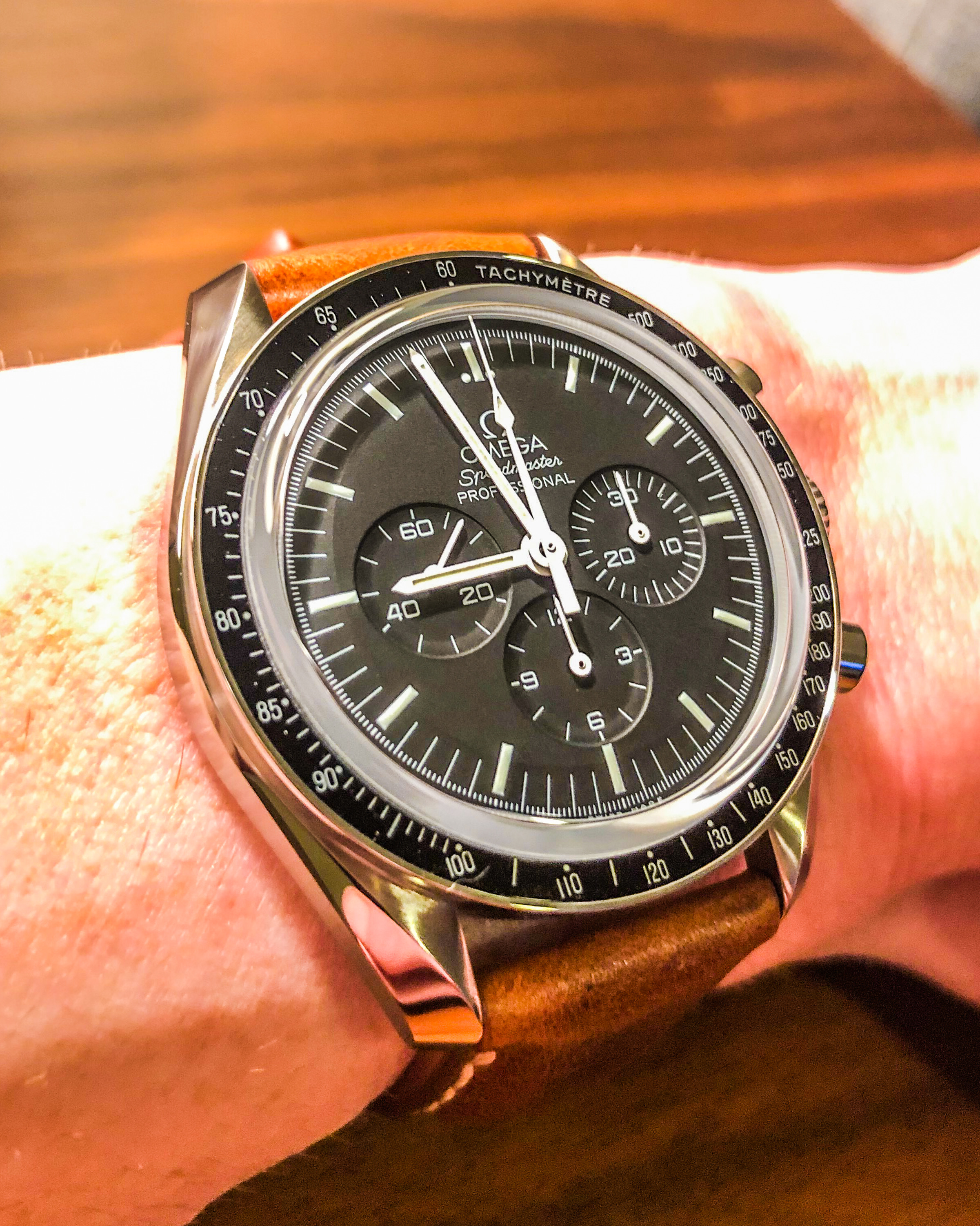

That appearance is a reflection of the texture on my drywall in the area where I took the photo. Another image for reference. Again, I’m not able to get the speck to show up in any images unfortunately.
