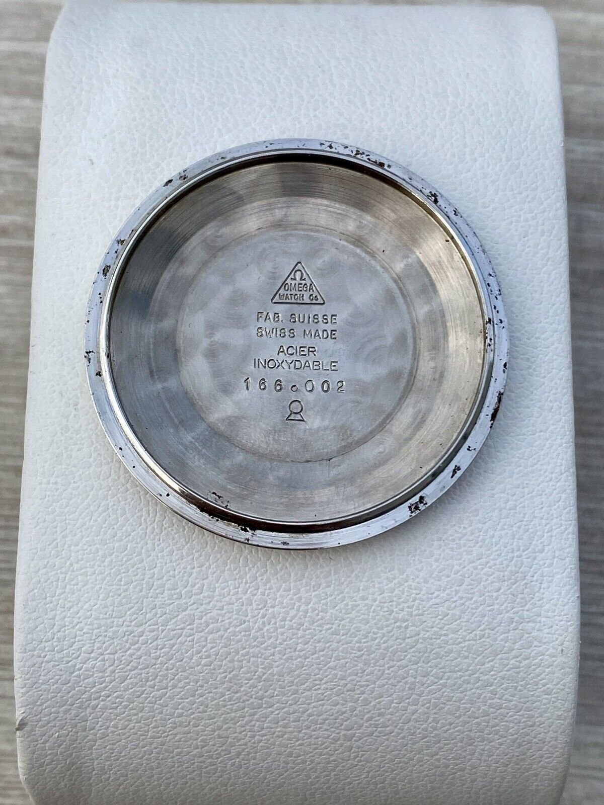

I like how they redialed it a polished the case but haven’t bother to clean the case. Look as the decades old remnants of the seal in the caseback pic.
3
My thought was they tried to leave the case dirty in an attempt to "sell" that it isn't redialed. Glad my suspicions were confirmed! Thank you!

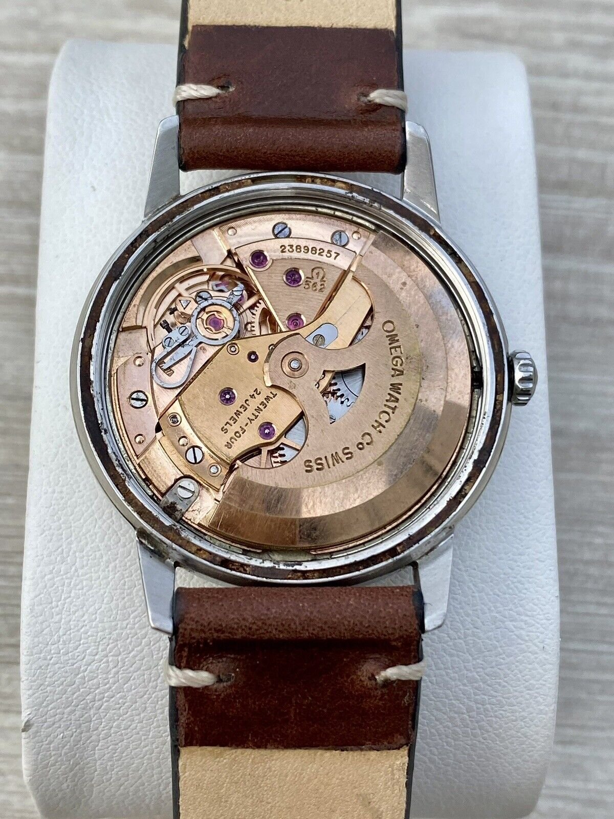

a couple of more give-aways (in addition to the ones above) that the condition of the dial is inconsistent with the rest of the watch
1. The date wheel seems to be pretty mottled looking, in contrast to the dial.
2. The rehaut has a fair amount of corrosion pitting which is inconsistent with a dial in this condition.
9,357
78,341
And that corroded gasket 😲
