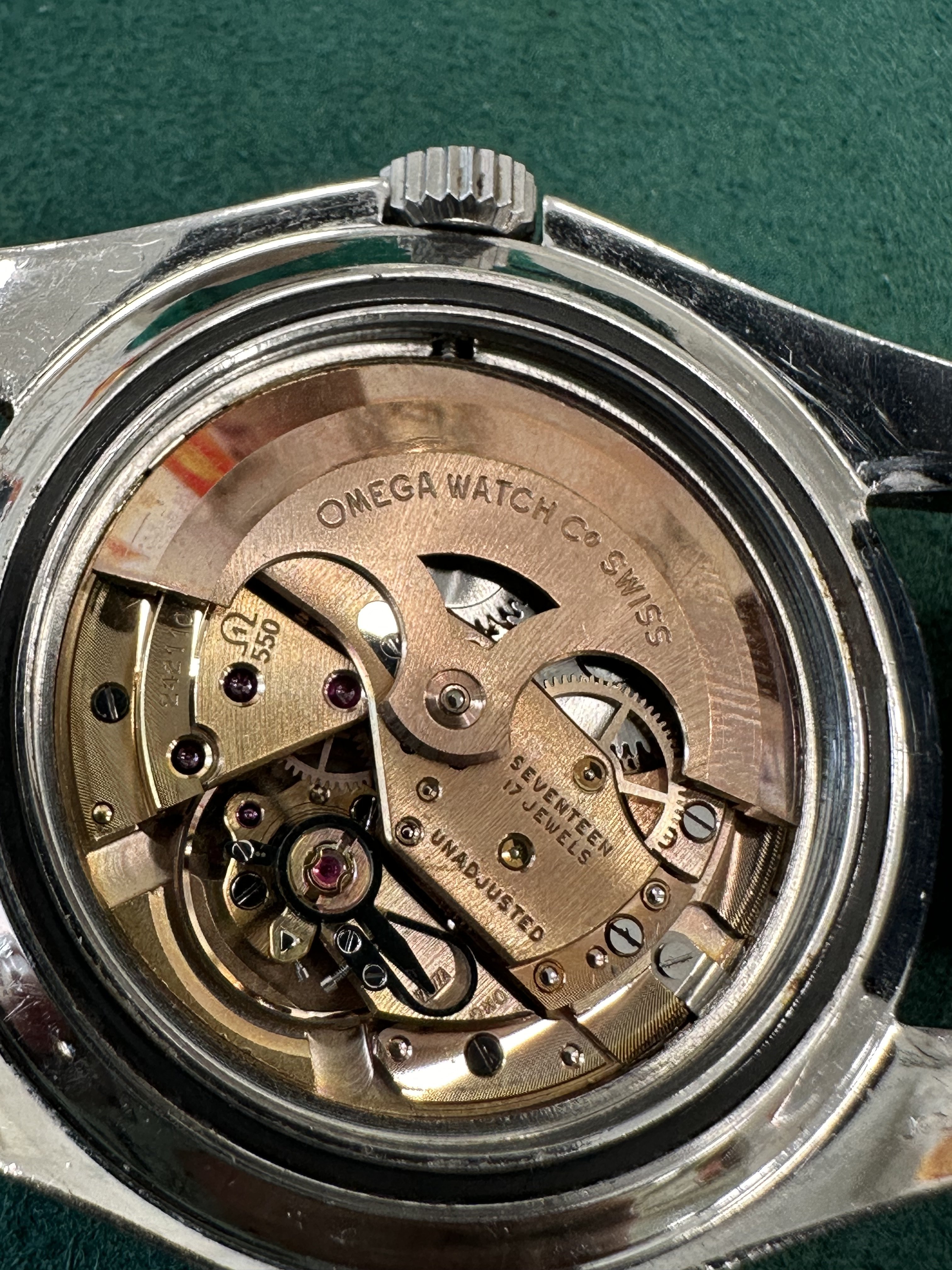

Also just saw another post from TZ-UK forums (Jack Norman), which i find very helpful (also addresses the 550 movement point):
https://forum.tz-uk.com/showthread....mega-Seamaster-300-including-Military-watches
To quote the 1st post there: "...The Omega cal.550 movement with 17 jewels created in 1960 was chosen specifically for the American market, as watches that exceeded 17 jewels were subject to more tax in the US. The compromise was made in the automatic assembly, where brass bushes were used instead of jewels. The brass bushes were prone to wear, and it is not uncommon to see cal.550 movements that have had both the upper and lower automatic bridges changed to the jewelled version." I guess the highlighted sentence may also be a cost factor (servicing) when considering the price.
Hopefully other people interested in the 165.024 can find this useful too.

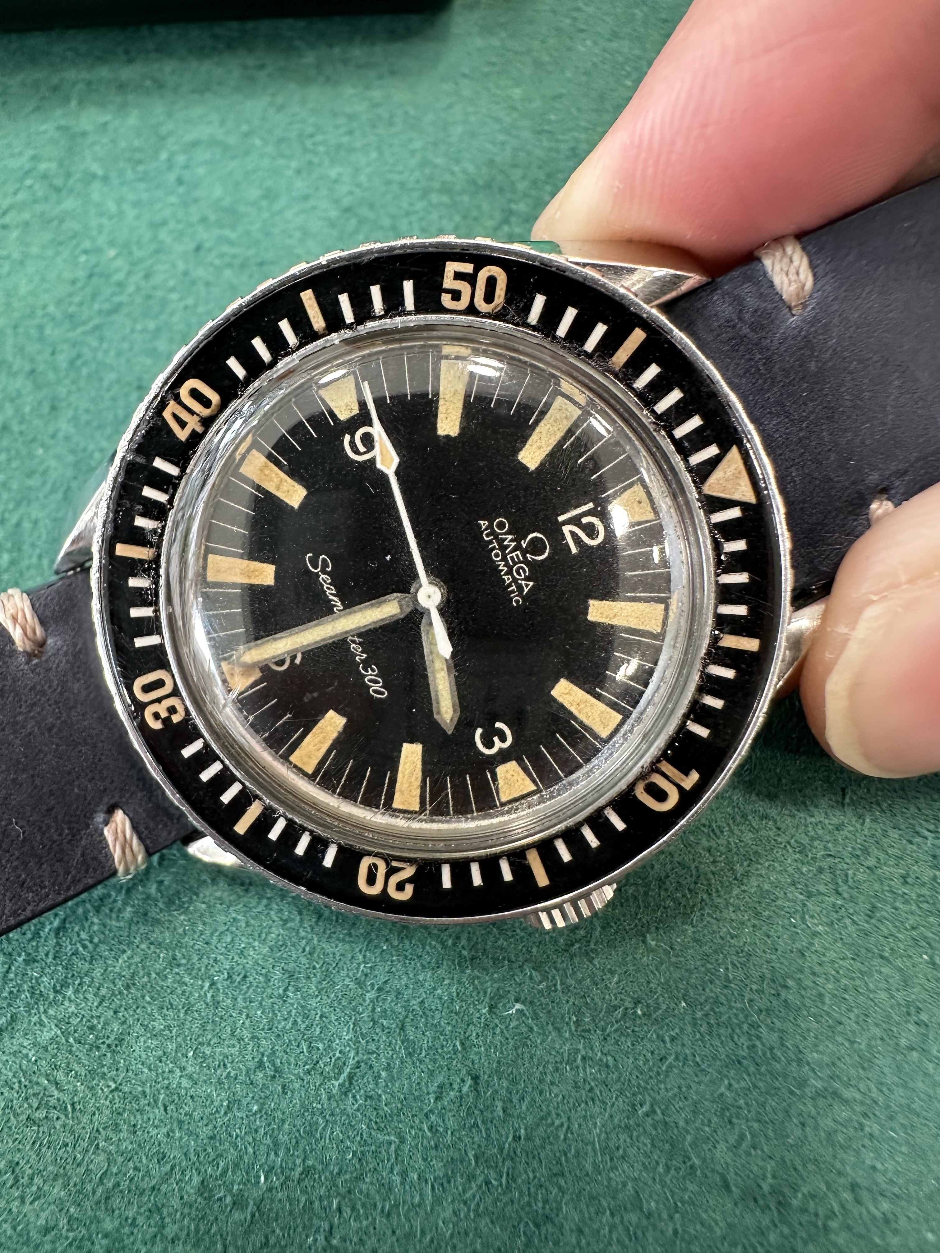

Also if I take it to a watchmaker to fix the bezel click problem, then further damage to the bezel may be made during the removal process… fingers crossed.
Why are you concerned about the bezel? It looks in good condition and stable to me. Maybe there’s a crack I haven’t seen, but even then they don’t tend to fall apart.
5,537
9,475

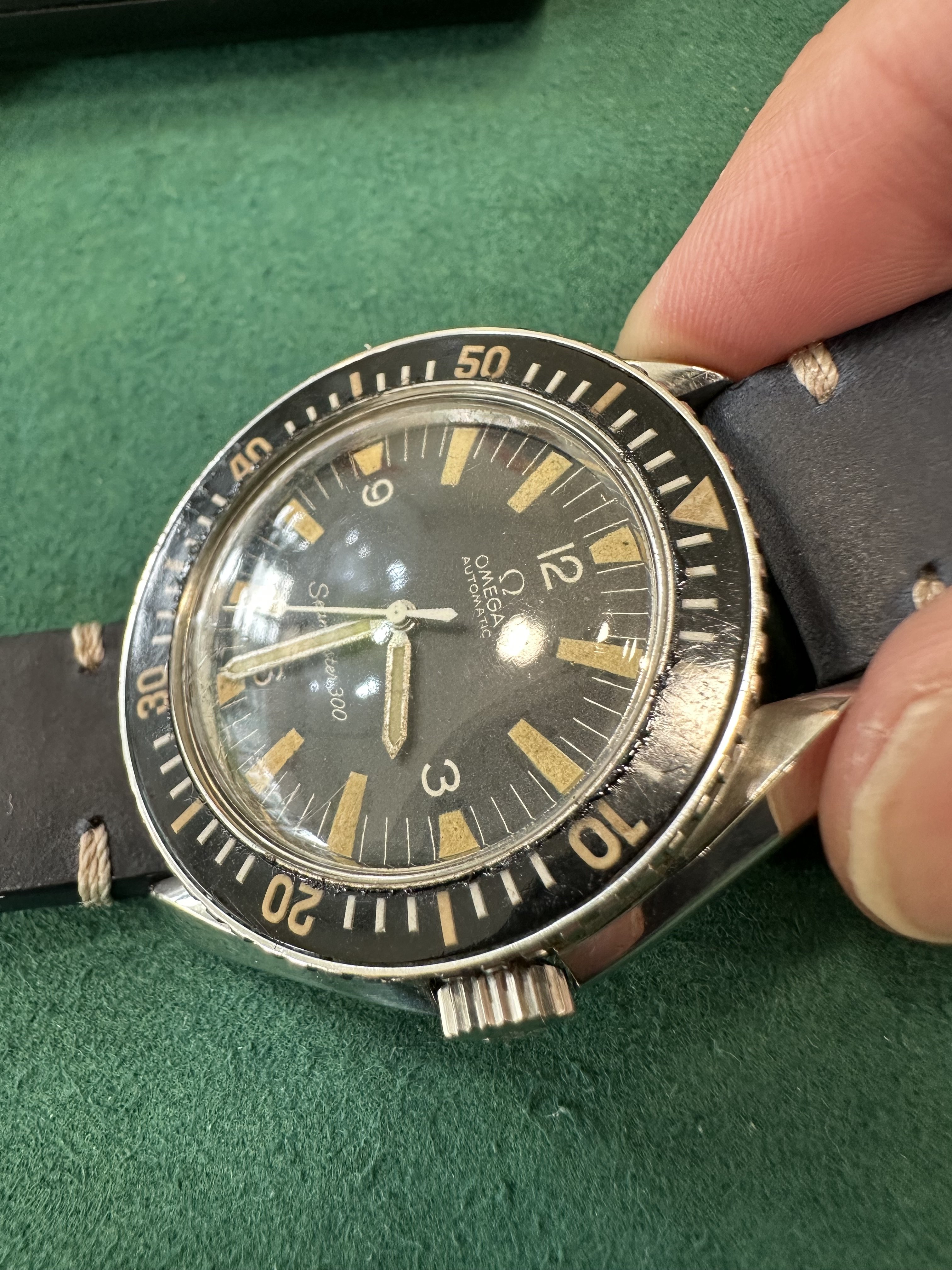

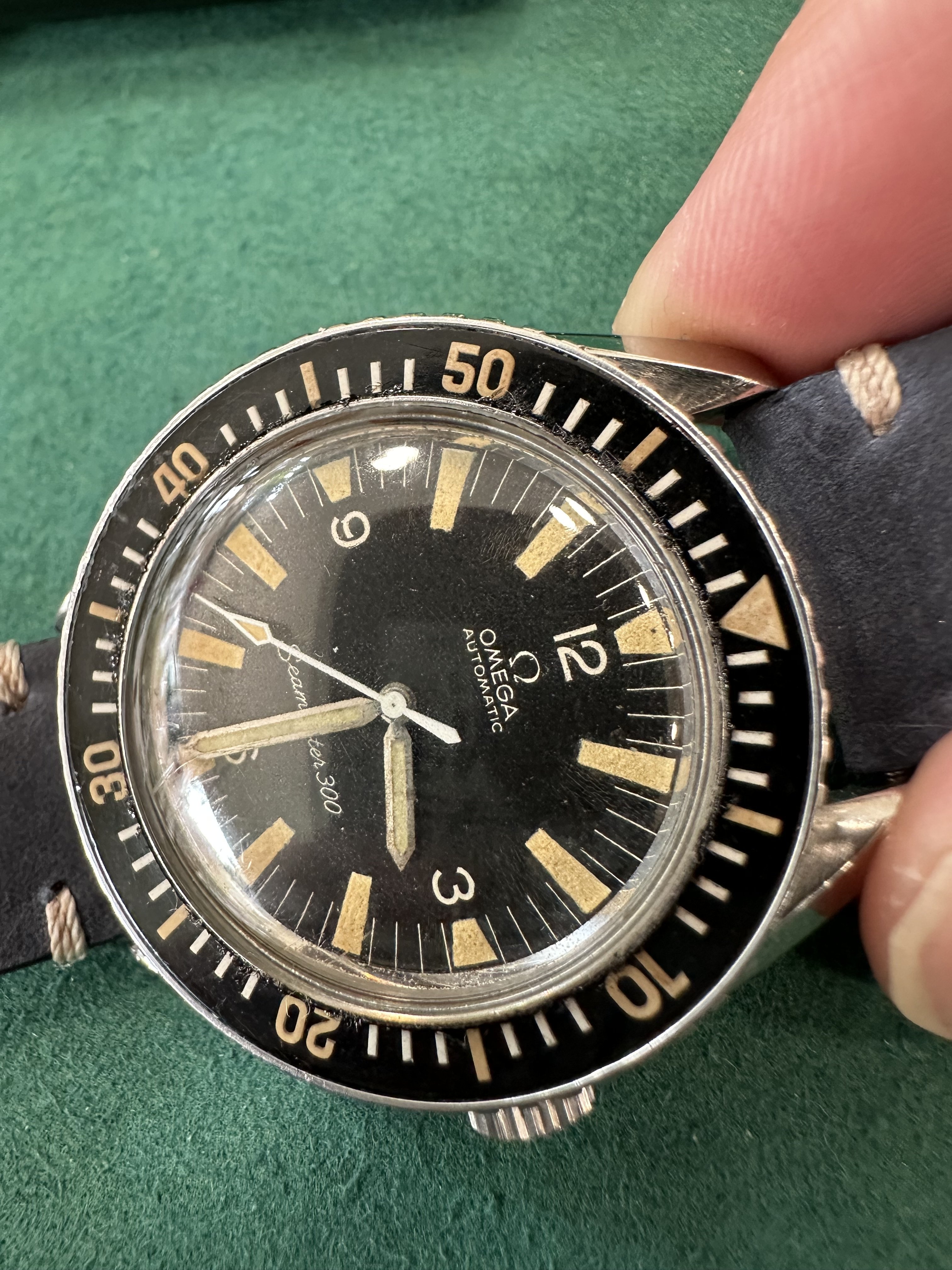

Look at the 3rd-to-last photo. The inner edge of the bezel insert has some damage/ deterioration. The other photos aren't really in good enough focus to see it. It's not significant, but it's there.
1,160
1,483
I see it now. I wonder if that's just topical funk, or some sort of resin used in a repair?
1,915
3,965
Exactly. Could just be gunk, hard to say without inspecting it in hand.

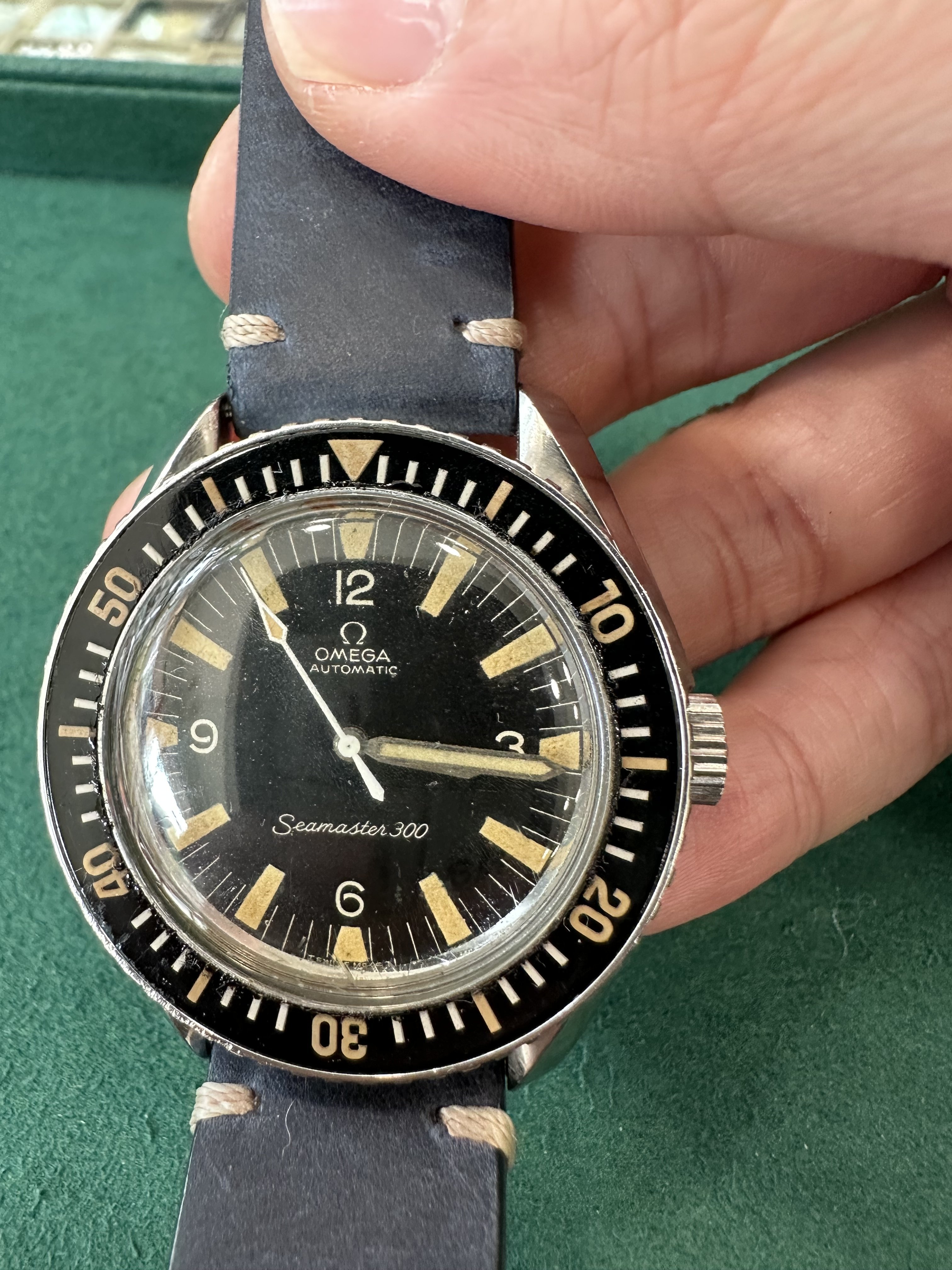

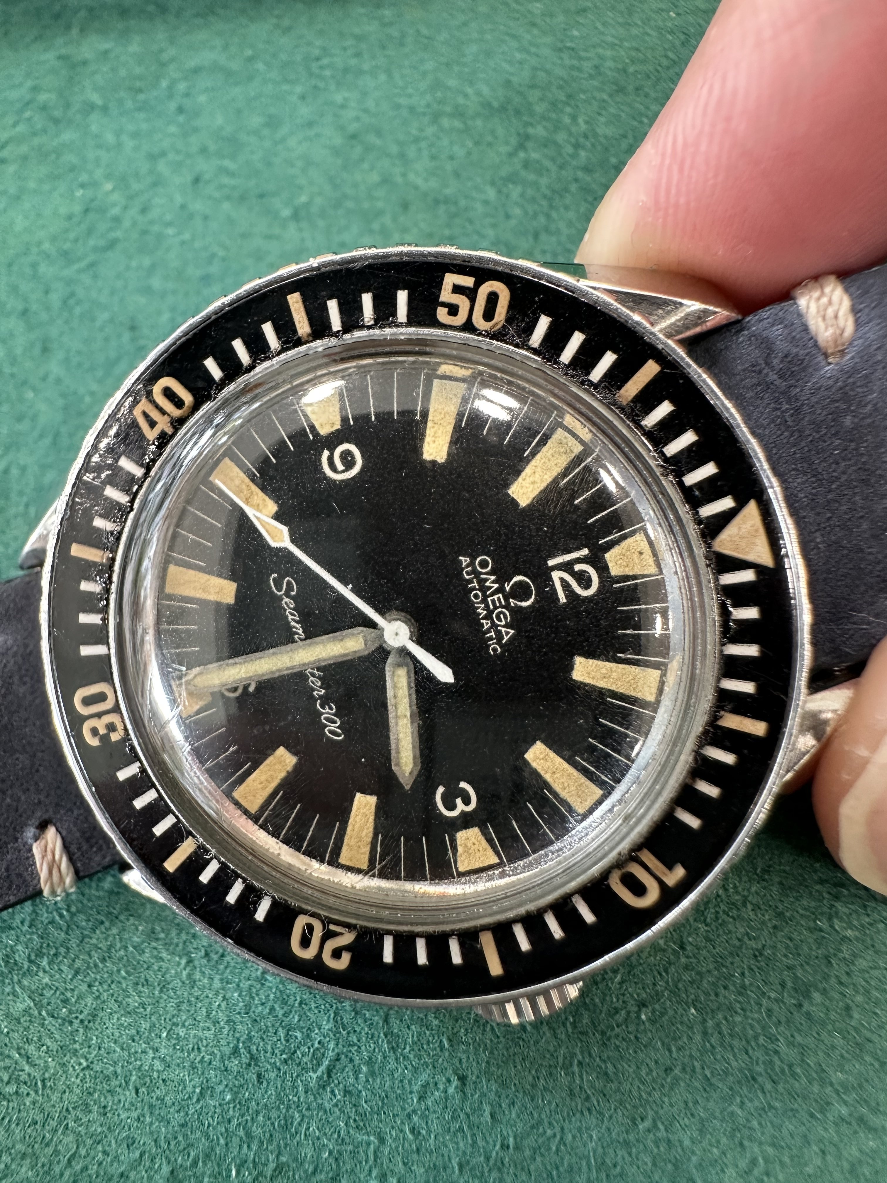

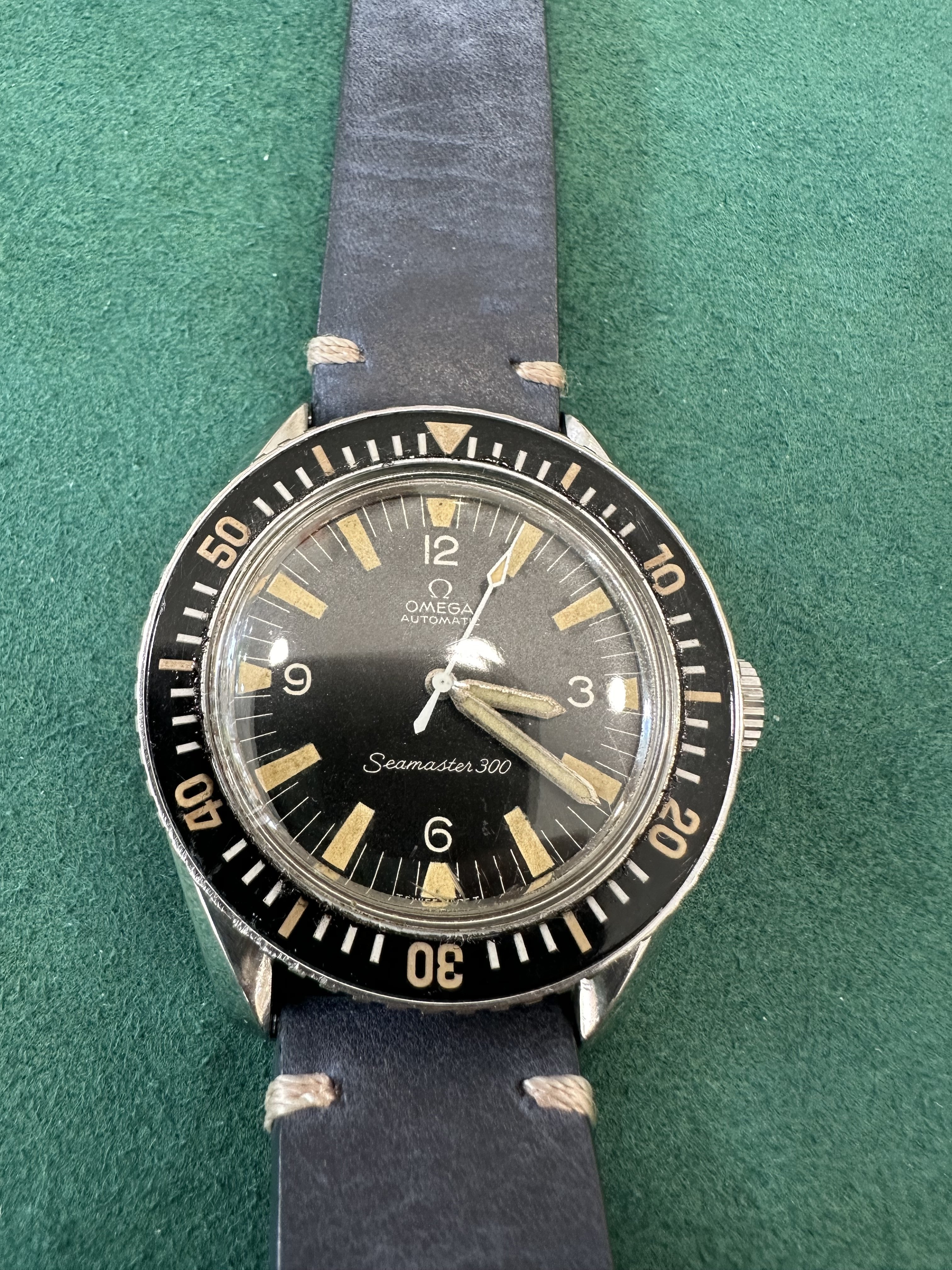

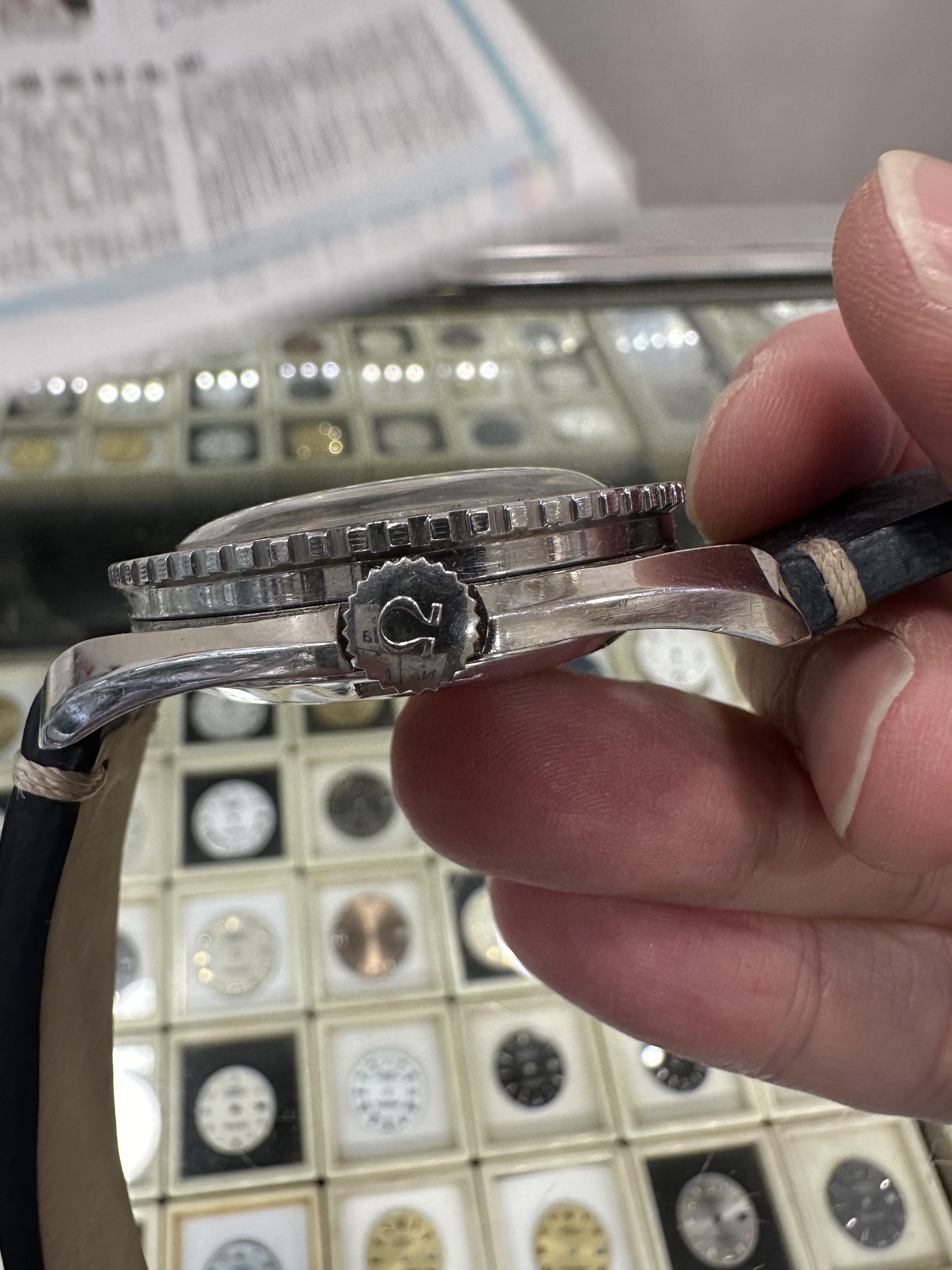

Hi All,
So I managed to visit the shop and take more pics today, focusing on the bezel. I also took a pic of the movement. My observations:
- bezel: without magnification it doesn’t look too bad but please see the “glue” issue in the close-up pics. I have no idea if this issue has been stabilised as this cannot be verified by touching and to my inexperienced parts. I didn’t ask for the bezel to be removed as this seems abit impolite since I didn’t commit to buy yet. Confirmed again that there's no "clicks".
- movement: OXG marking is on the balance cock as per @kox comments.

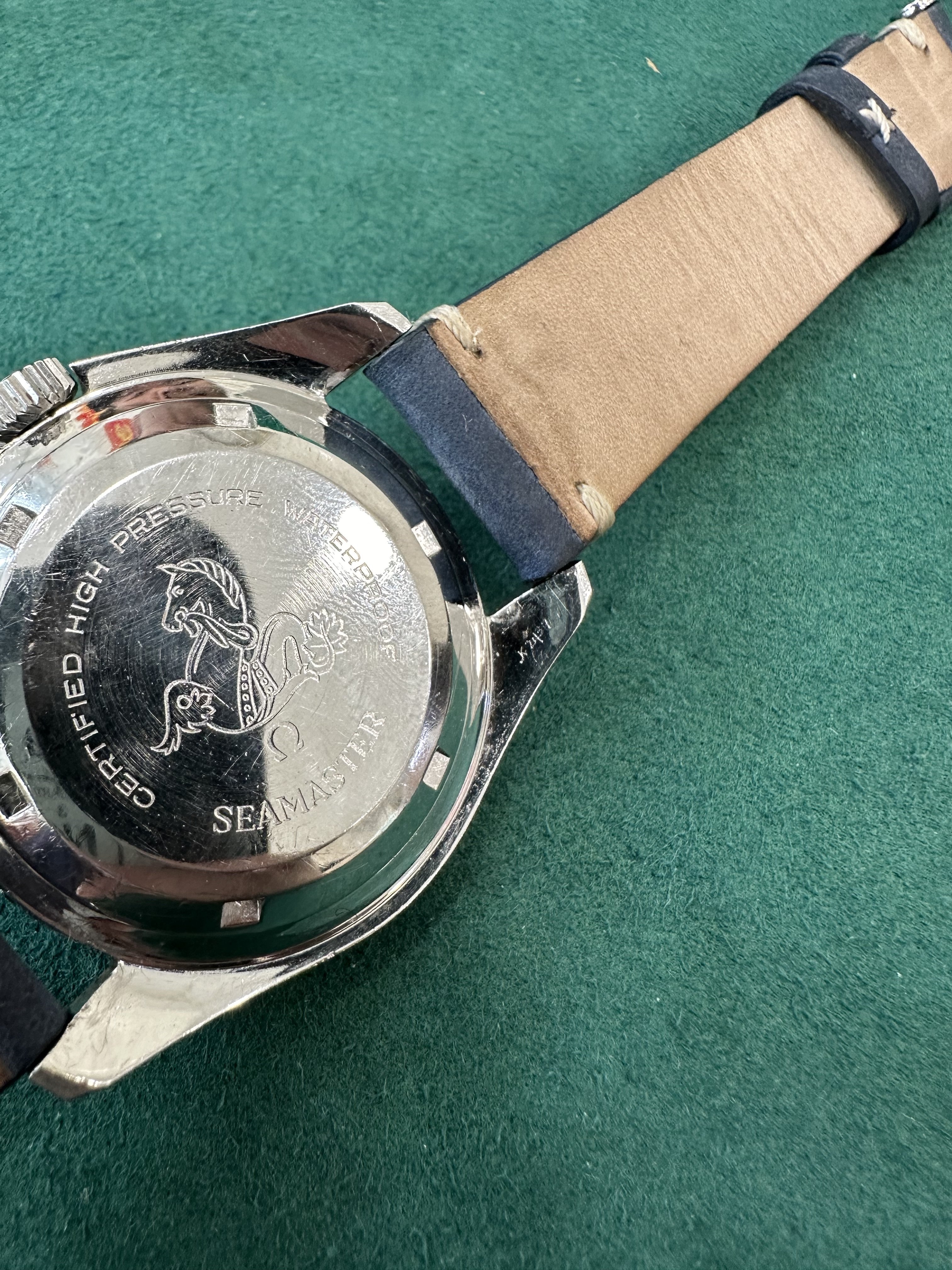

- back lug: there appears to be a marking manually inscripted onto one of the lugs. Seller also just noted the same and said maybe done by a watchmaker before during service. Any views on this?
- case profile: I didn’t take any pics this time, but noticing my previous pics (re-attach one of them ) do you think the side case has been polished? Seller thinks that the case is not polished. At the same time he readily admits that he’s more familiar with Rolex datejust and day dates, which are their bread and butter.
- Lume: I have checked with the UV light provided by seller, the bezel and lume markers do light up according to the period correct parts, i.e., for the bezel, luminous numbers and 5 min index.
- Value: The seller is looking for approx. USD5100 - what do you guys think?
1,126
1,731
I try to give my interpretation of the problem.
I had a similar issue in another sm300 bezel:
Basically the black paint which is below the acrylic disc for some reason (probably moisture?) tends to leak from the bezel. When I tried to wipe it from outside the result was more leakages, leading to partial discoloration of the disk itself.
