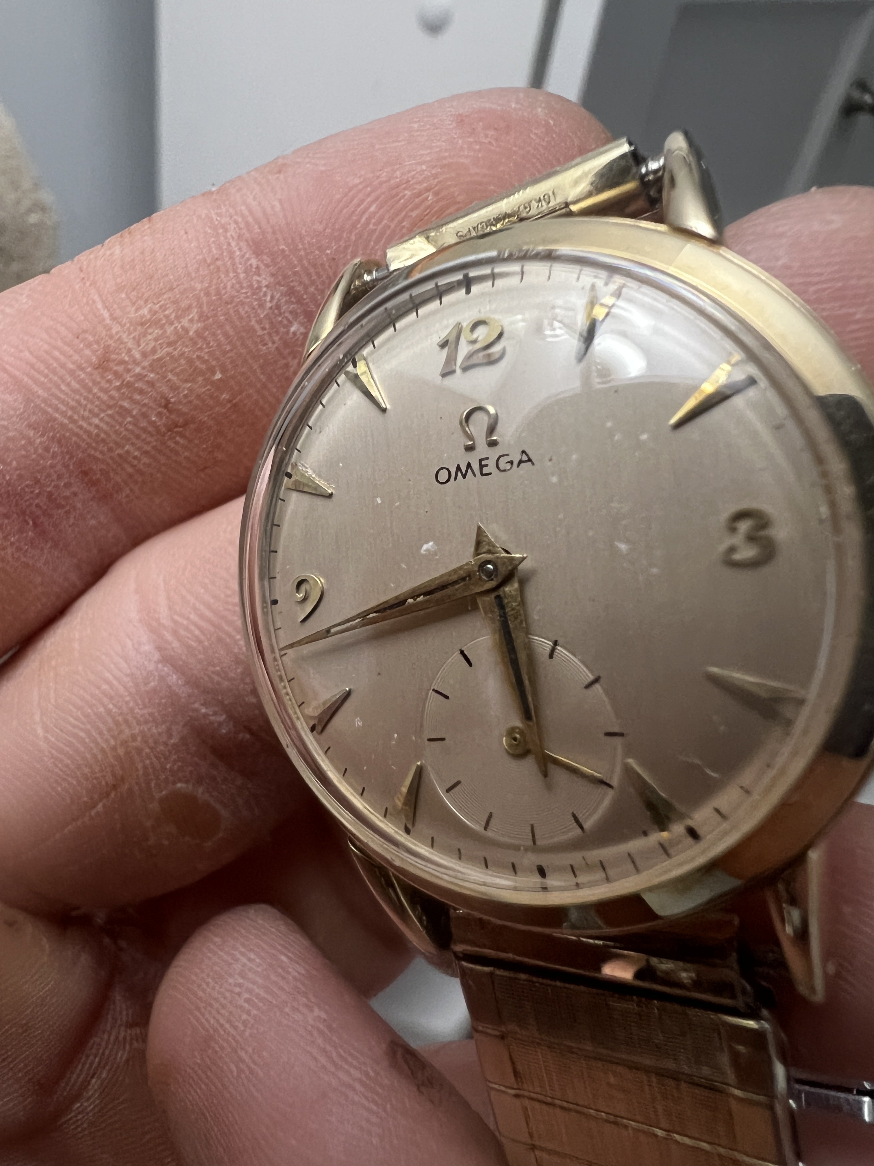

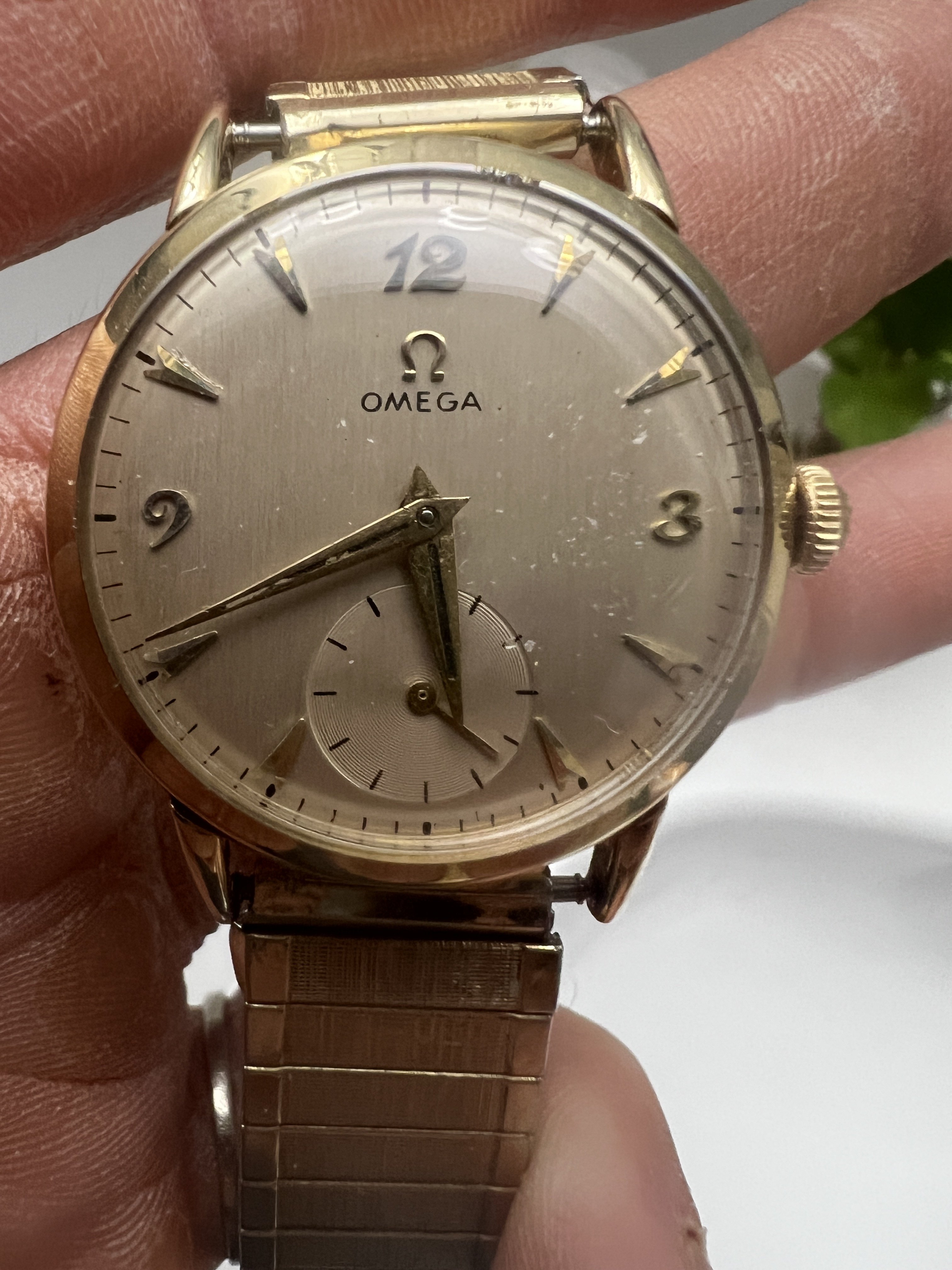

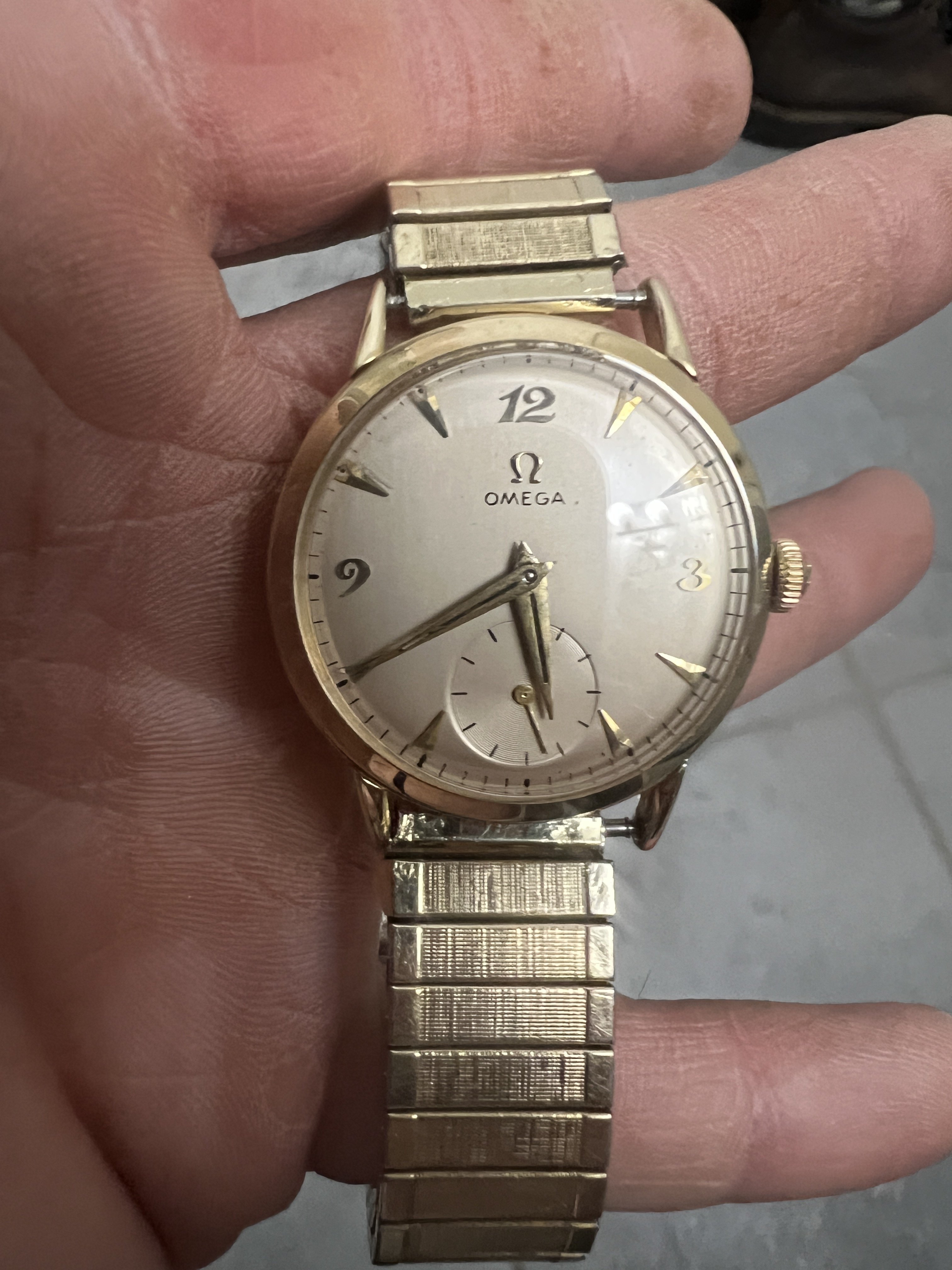

Purchased a 1952 cal. 410 Omega in 14kt solid gold with a case reference of BX6520.
I’ve spent the last 24 hours obsessively researching Google for advice on the authenticity of this dial.
24,837
55,257

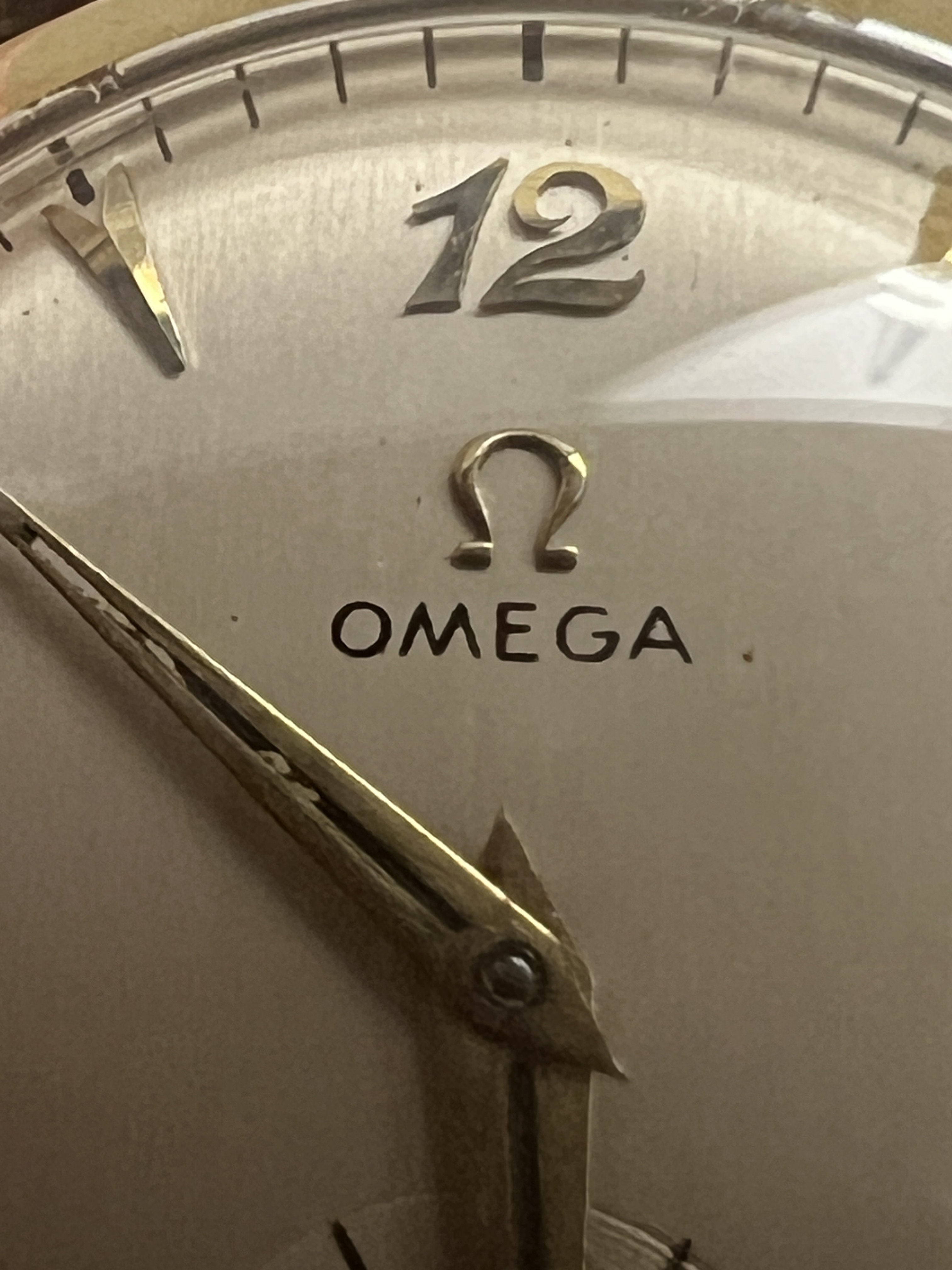

Yes, refinished dial in a US case. The printing is very poor, sloppy and misaligned. In addition to the font error, look at the hashmarks on the sub-dial, the misregistration of the painted and applied markers, etc.
13,556
23,504
Certainly refinished. Look at the quality of the font/print on the word ‘Omega’
18,840
39,184
Redial, missing a case screw and in severe need of a nice leather strap to replace that awful bracelet.

Damn. I had a feeling.
Now I have to decide whether to return or keep. I paid $900 for it.
That or try to hunt down an unfinished dial.
18,840
39,184
I know which solution would be easier.
2,346
1,475
Bezel looks badly gouged also.
return
1,626
6,078
Return it if you can.
912
1,255
Sometimes font colouring can fade on the dial so it can be harder to assess, but the finish quality is a good indicator. The marks below are really patchy - some go beyond the sub-second area, some are well within it - and it looks odd. Some are thicker than others etc. Same for the hour marks.
