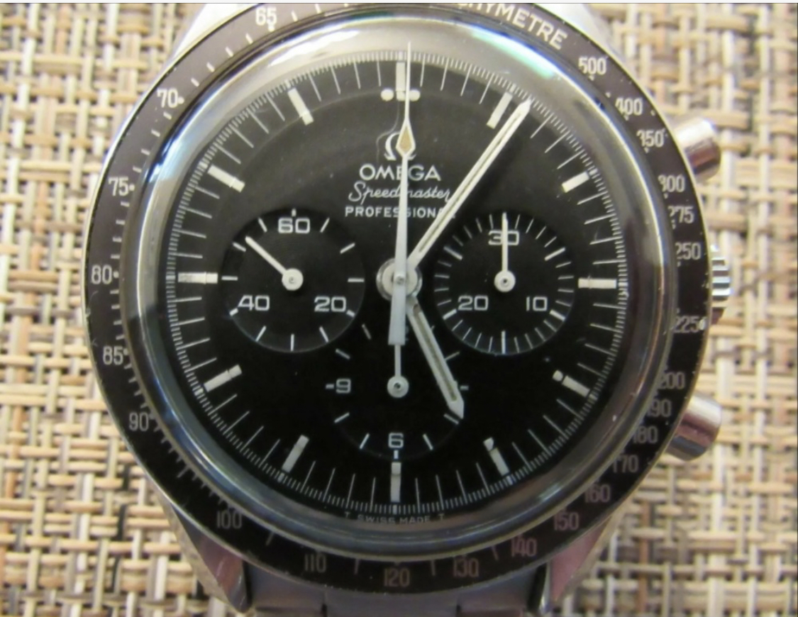

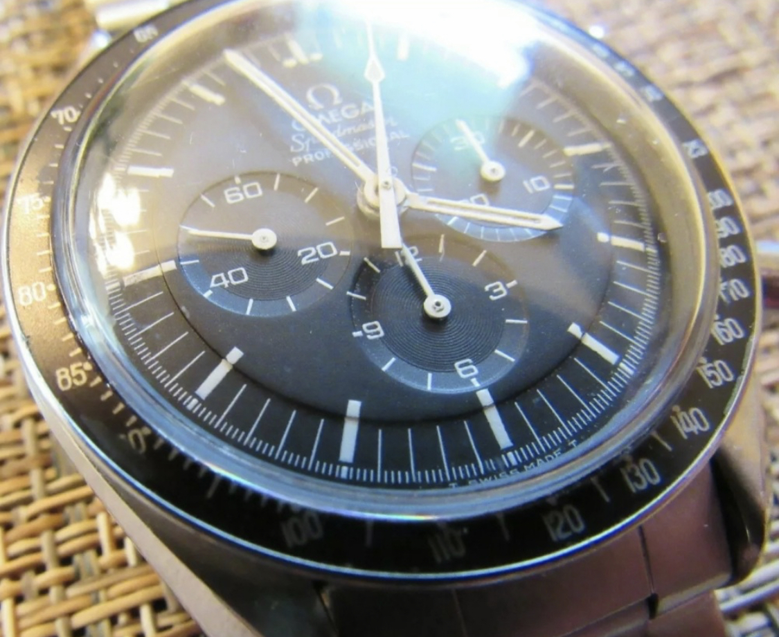

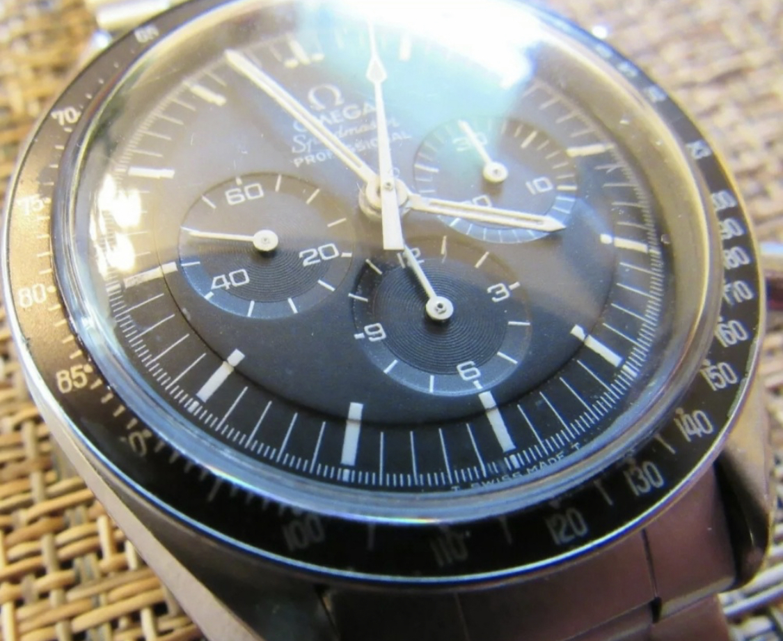

The lume has been washed/scrapped off the dial.
1,441
3,809
Better pics and serial would be helpful but missing lume is not a good start
2,317
5,709

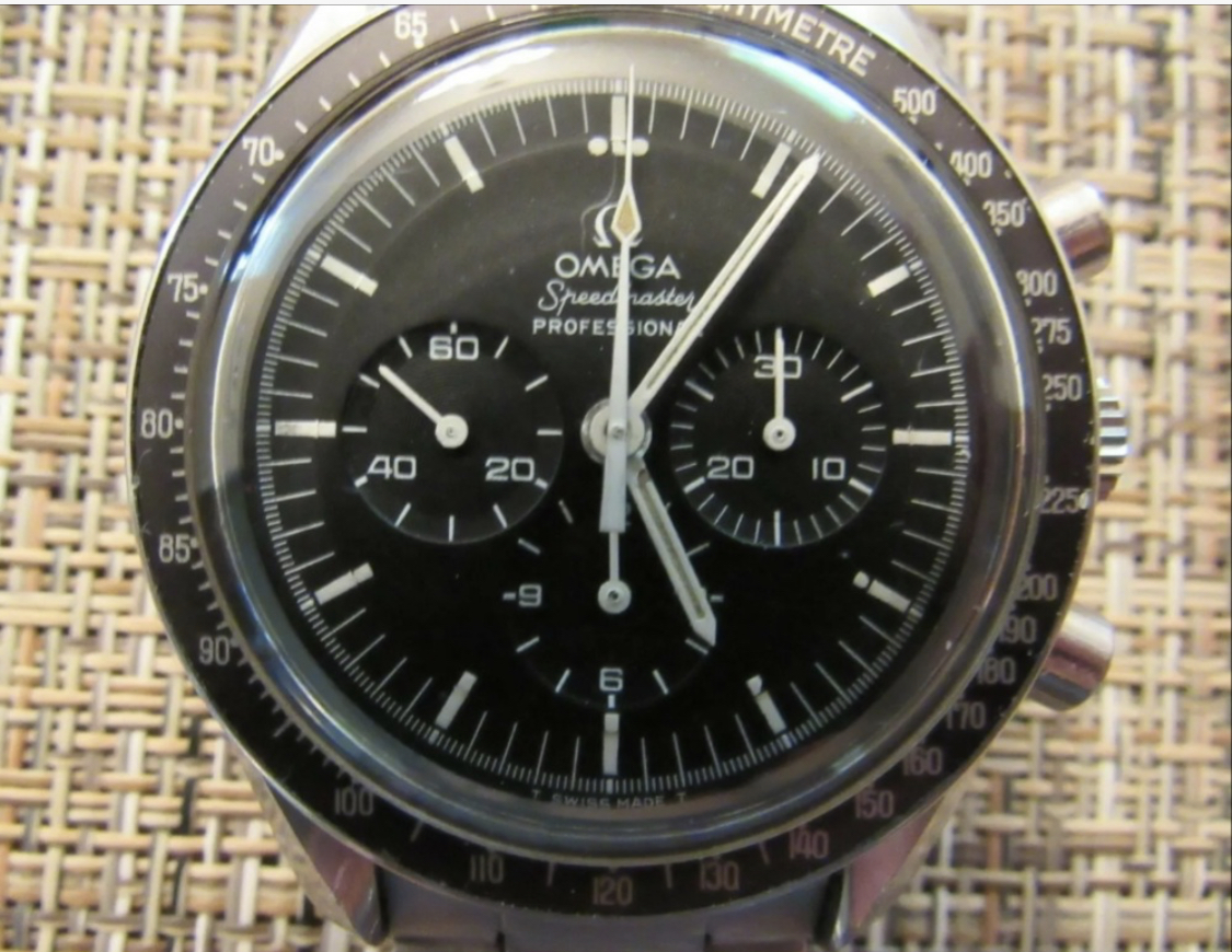

It's been listed on eBay 3-4 times already and "Sold".
It seems like the seller keeps on re-listing and bidding on his own auction, and winning it. (Or he has an extremely unfortunate streak with 3 non-paying bidders in a row... 😗)
Some people just can't understand that they have a poor example of a watch and it won't sell anywhere close to what they're expecting...

I thought that I'd seen these pictures before somewhere...

I want to see the serial and the caseback.
I think they exist... I’m just trying to prove it for sure.
The official line from the 2 sources that are considered the Bible on these is that they are not wrong, but won’t conclusively say they are correct.

This eBay watch is only 72 serials apart from this one I sold last year:
https://omegaforums.net/threads/ome...4-stunning-step-dial-1171-633-bracelet.96668/
And 493 serials apart from this one I sold two years ago:
https://omegaforums.net/threads/1975-omega-speedmaster-145-022-74-step-dial-1171-633-bracelet.82454/
145.022-74 with a step dial definitely do exist and are correct in this serial number range (35.57X.XXX)
