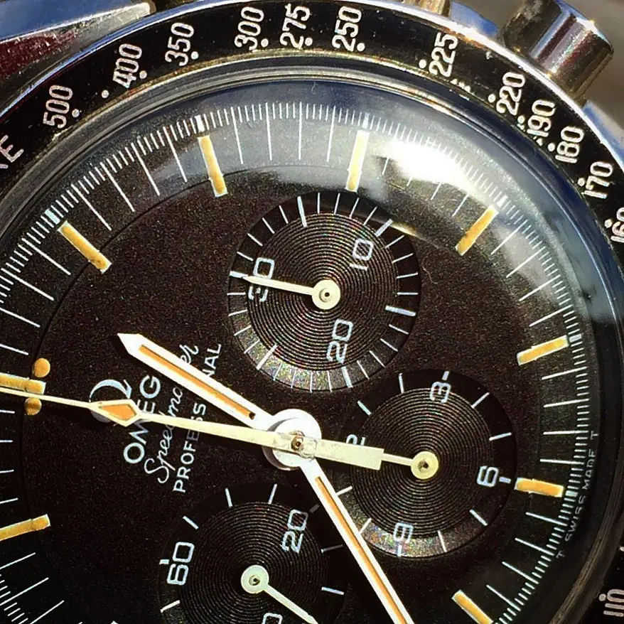

Found the link and picture of Spacefruit's Switzerland delivered watch:
82
301
Interesting, but this caseback has the „normal“ fonts and the watch was delivered in 1971 unlike the ones with the pointed „A“ fonts, which were shipped in 1970.

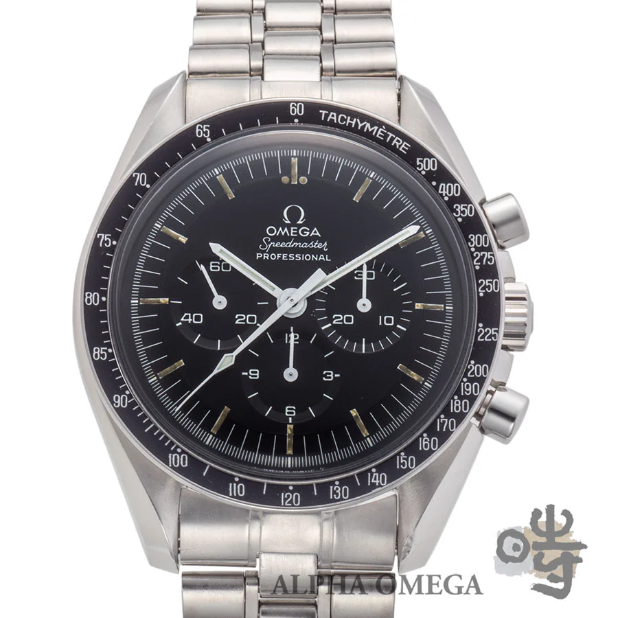

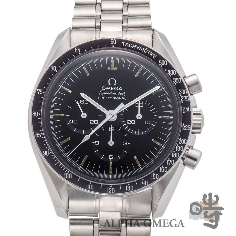

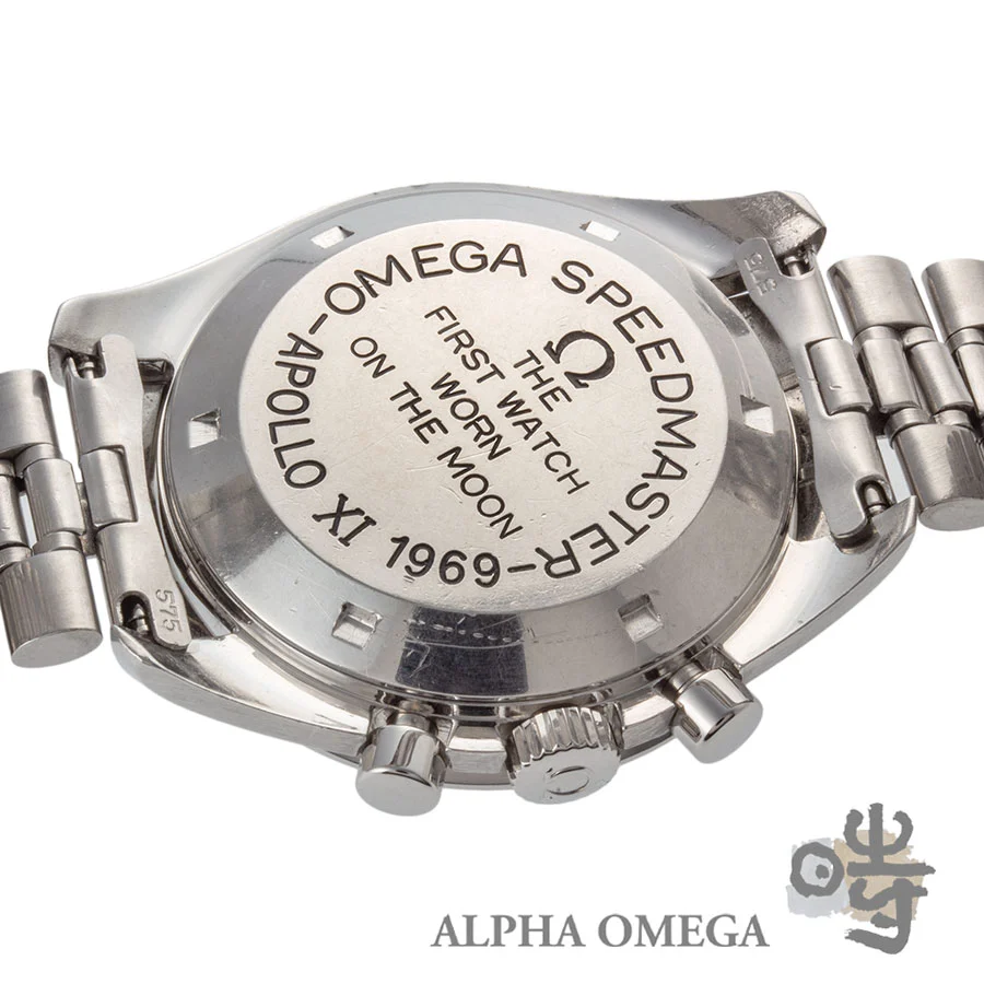

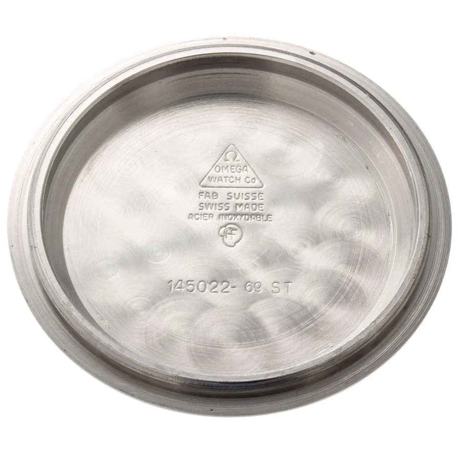

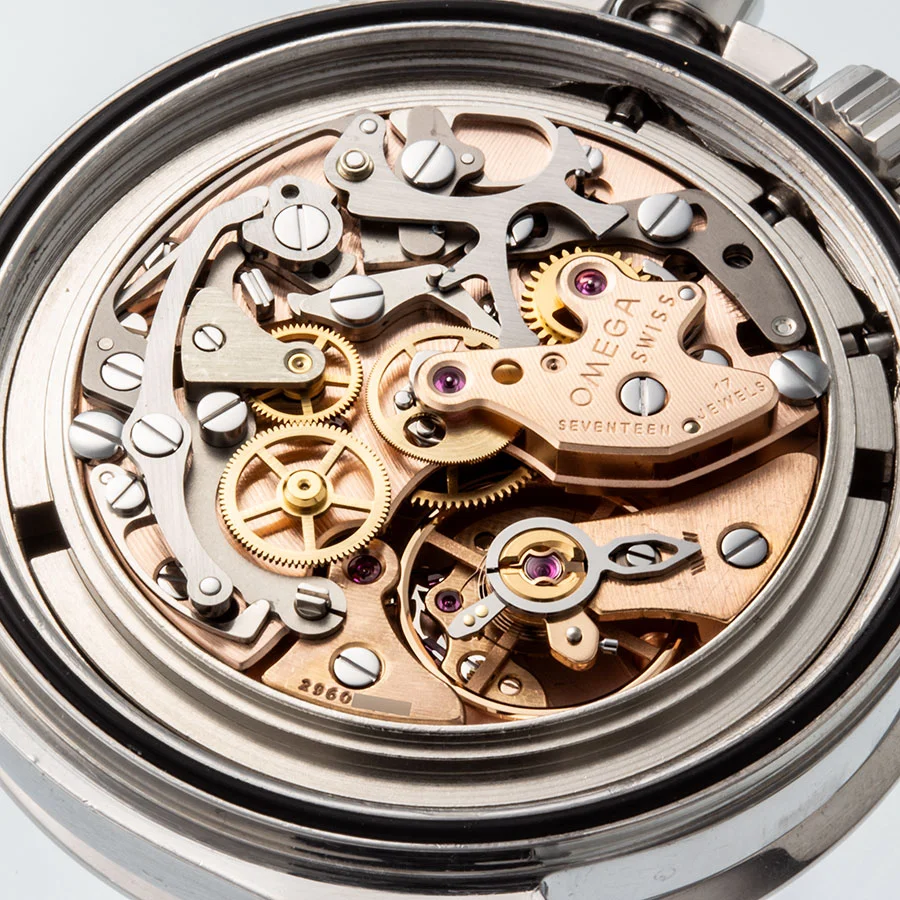

Since I created this thread... so I did a little research on the internet.
I found this pre-1971 Straight Writing Apollo 11 model.
This watch was sold at Wako, a store that still exists in Ginza, Tokyo, Japan.
Originally, Hattori Tokeiten was engaged in selling imported watches such as Longines and repairing used watches. Later, they began manufacturing watches domestically and established Seiko (formerly Seikosha). It is well known that the retail division of Hattori Tokeiten eventually became Wako.

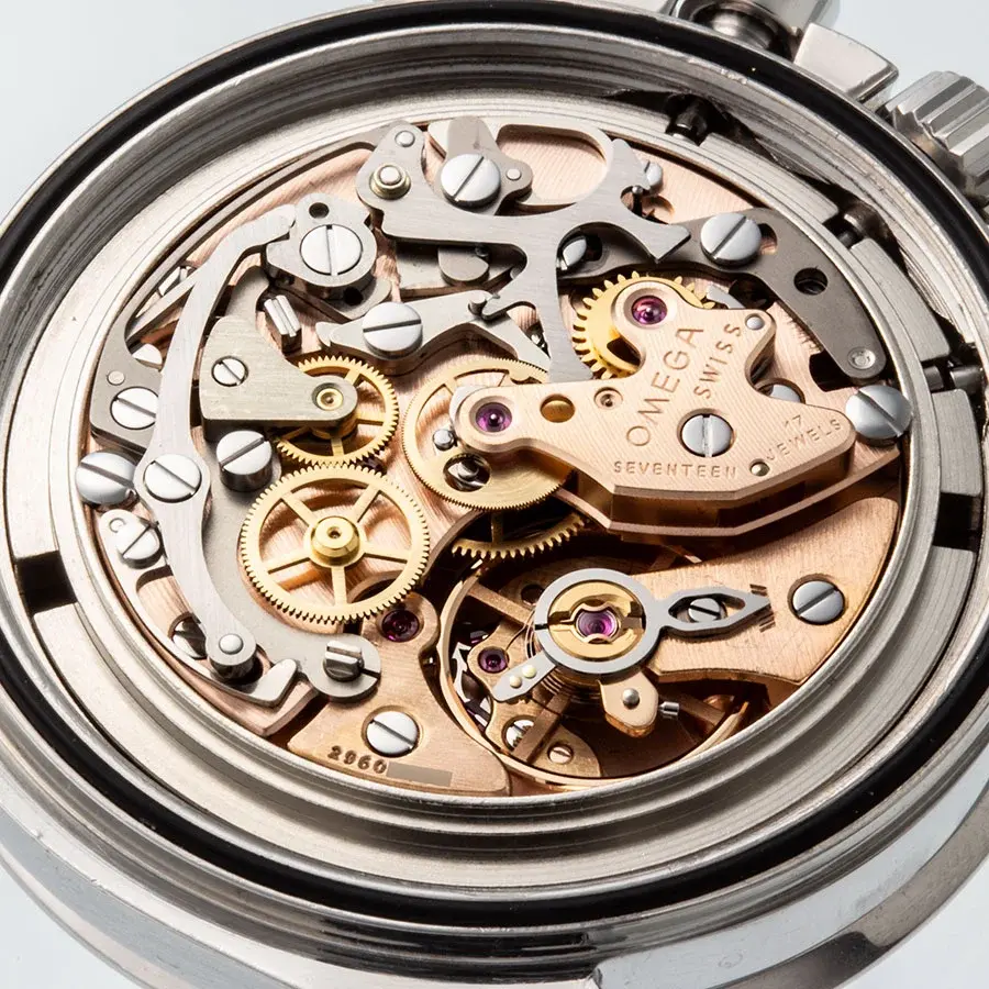

The serial number starts with 2960, so it appears to be from 1970, but since there are no archives, it's hard to say for sure...
Since it's a 2960 serial, the bezel should be a DON bezel.
The bracelet and end links should be 1161 and 575, respectively.
I'm not sure if this will be helpful, but...
https://www.awc.co.jp/2024/01/17/om...writing-apollo-xi-1969-ref-145-022-69st-e151/

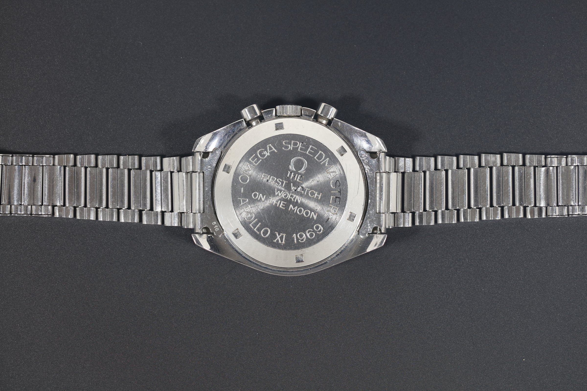

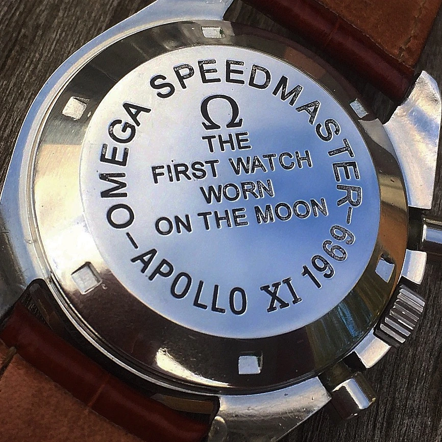

This makes three types of font used on SWA11: the pointy top 'A' (like Tigertom and davidoff), the slightly flat top 'A' (like the one you posted), and the wide flat top 'A' (like the one I posted, which is more often seen.)
There are other differences, such as the width of the font, which is easier to distinguish in the '1969.' I'm not attempting to thoroughly identify each distinction at this point.
Your Wako watch has a sold date in 1972, even though it has an early serial number. Further demonstrates the difficulty in relying on the serial numbers, production dates and sales dates to determine when a watch was developed.
Thanks for posting this. It appears that the Wako watch is sold?
I passed on purchasing a pointy A font SWA11 because I suspected i wasn't real. Now I regret that.

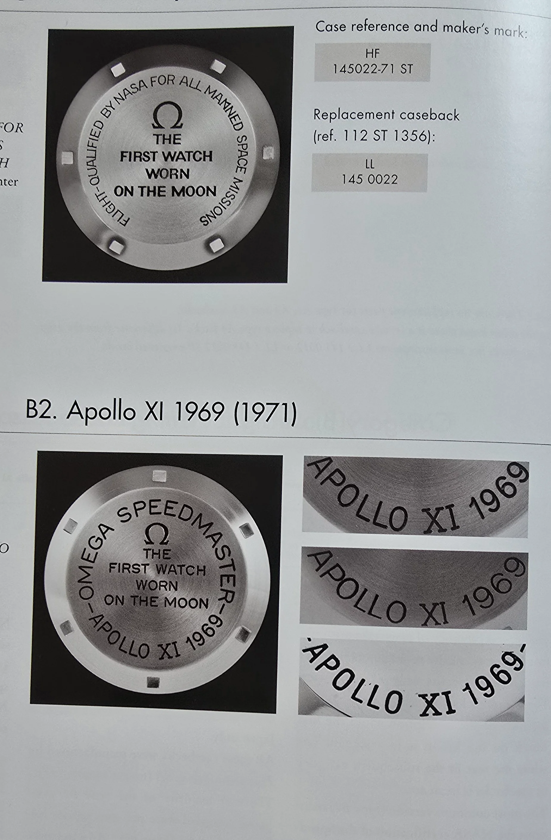

To recap, it's looking like there may be 3 different types of SWA11 case backs, based on different fonts. They appear to be in similar serial numbers, but there are so few (1 or 3) that it's too small a sample to be certain. Regardless, it's difficult to dismiss the non-conforming as not coming from Omega. Omega used different fonts in the gold speedys, which you obviously know, so there's precedence for using different fonts in the steel. I'm curious about how difficult it would be set up the machine tooling. If not too difficult, then it's more reasonable to think Omega may have changed fonts for some reason. A commonsense reason for changing font would be a production run, i.e. use one type of font to produce a few watches and then stop. Another order comes in and retool, but this time using a slightly different font. It doesn't make sense for a manufacturer to randomly switch fonts in the middle of production runs.

Stupid me! It's been in the Moonwatch Only book all along! Three types:
Reminds me of a joke a work colleague said: "You know an easy way to get ahead, Dave? First, create a problem, and the fix the problem!"
Well, I won't soon forget that there are three types of SWA11 casebacks. It still doesn't quite make sense why, but it appears that based on the serial numbers, they came in sequences. Also, based on extracts, a few were sold in countries other than Japan. We don't know how wide spread that was, but it's hard to argue with an extract.

One thing I could imagine is, that they produced a small batch of casebacks in steel (pointed A) and mounted them on watches that they shipped to different countries in 1970. Then, responding to a request from Japan, they produced a larger batch of cases with slightly different fonts (flat A) for the japanese market.
Anyway, that‘s just a guess, and we certainly would need more evidence to verify or falsify this theory. I am happy however that the discussion is much more open and fruitful now than in earlier threads. 👍

3rd. One of the authors said they hope to add more details on the SWA11 in new editions.

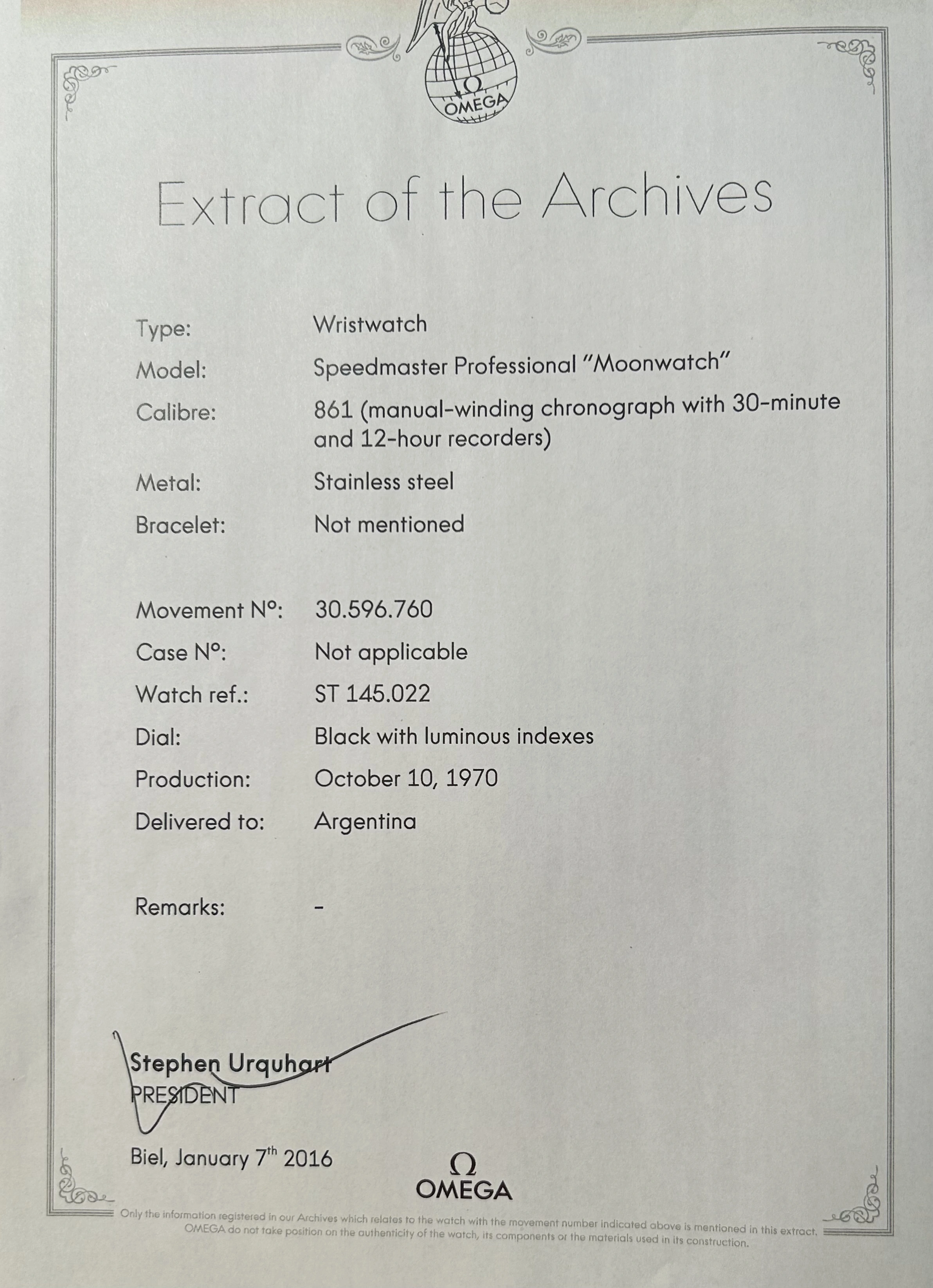

Had an email conversation with Grégoire Rossier a couple of years ago, where I was questioning them stating that no straight writing with 220 bezel has been seen, as my watch showed exactly this combo. By then, he argued that the caseback could have been switched, which I had my doubts for obvious reasons.
Very happy now, as new findings, your contributions and the pics in MWO 3rd edition seem to confirm that
a) different types of fonts exist and
b) not all SWA11 watches were solely delivered to Japan
Thanks to all who contributed! 👍🙏

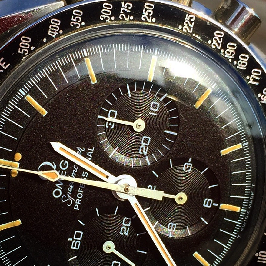

That dial and hands are gorgeous. Most Japanese that I have seen have more light yellow lume with dark spots from mildew or green lume from mold. It looks like your watch benefited from a dryer environment.
Were you able to get an extract before it was shut down?

I have added a new number here.
82
301
Here is the extract, and the movement number falls exactly into the short period for the 220 bezel 😉
