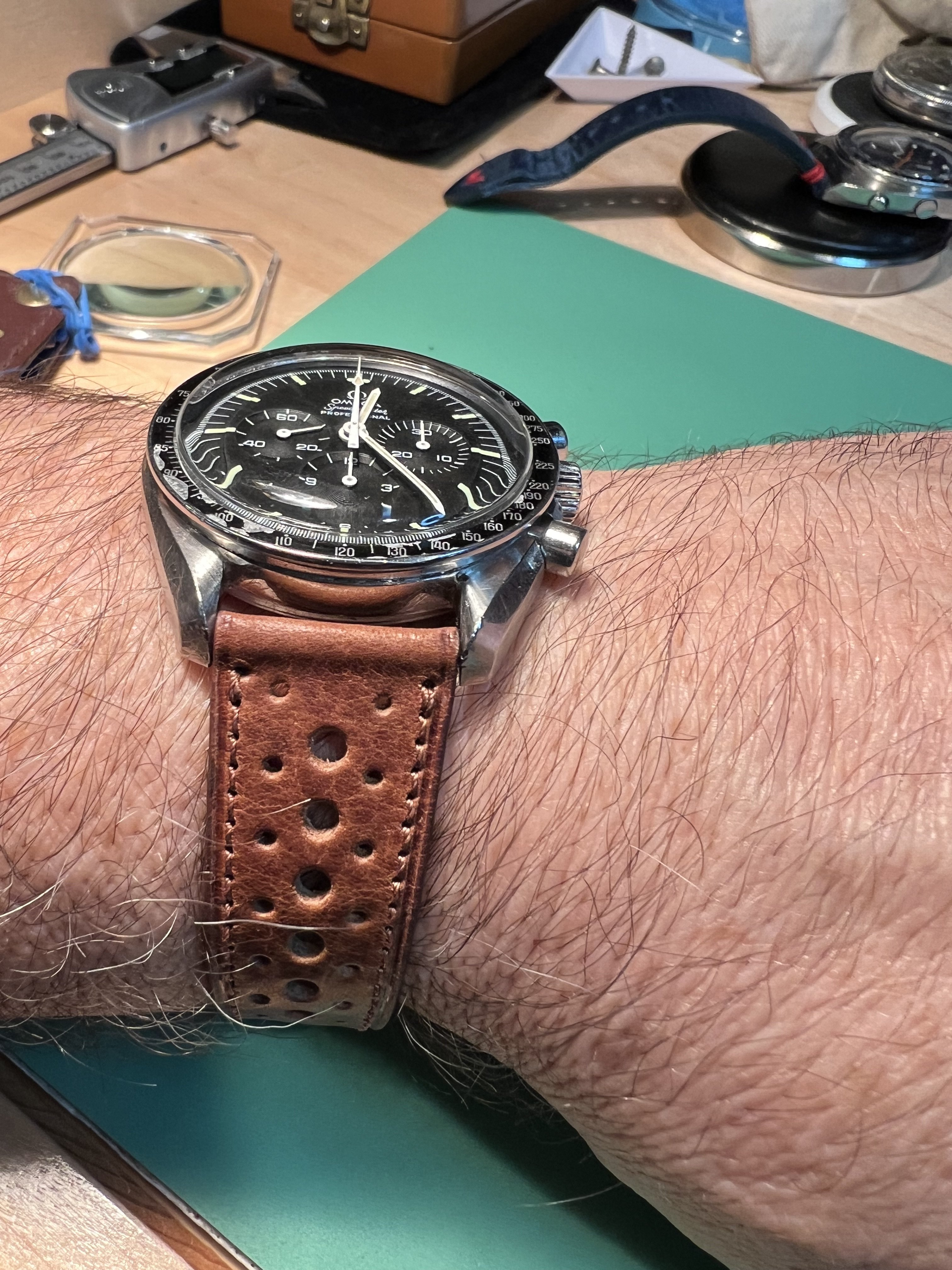

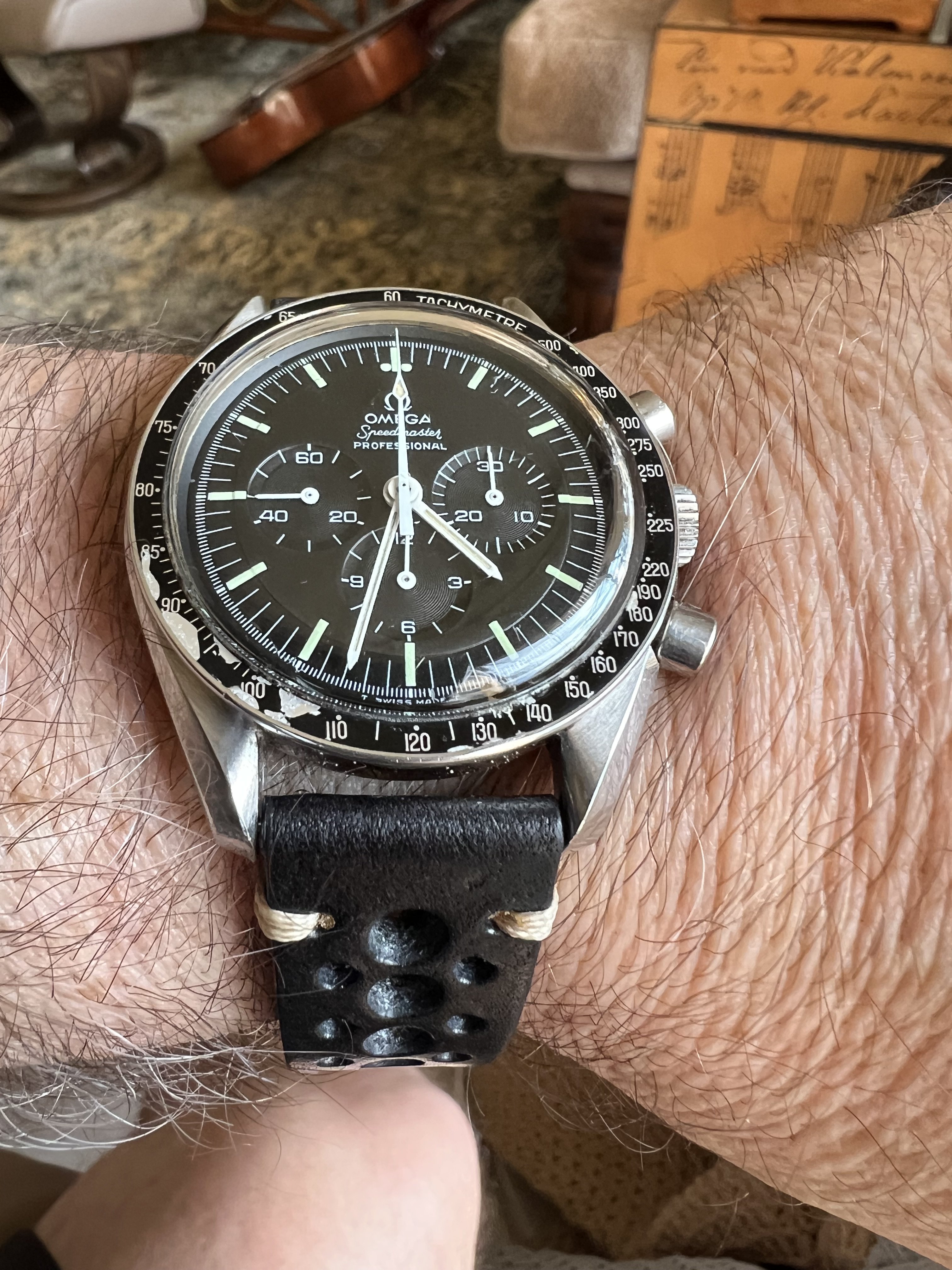

I would just get leather strap for now and take your time reconstructing a bracelet. Most of us swap between leather strap and bracelet anyway. Here’s my black thick racing strap from WatchGecko and thinner brown from Torre. but many ideas avail.
Thank you for the suggestion but my dad only wore it with this bracelet and it’s the only way it matches up with my memories. I’m not in any hurry and I’d only wear it for special occasions so I’ll try to be patient to get it the way I’d like it to be.
