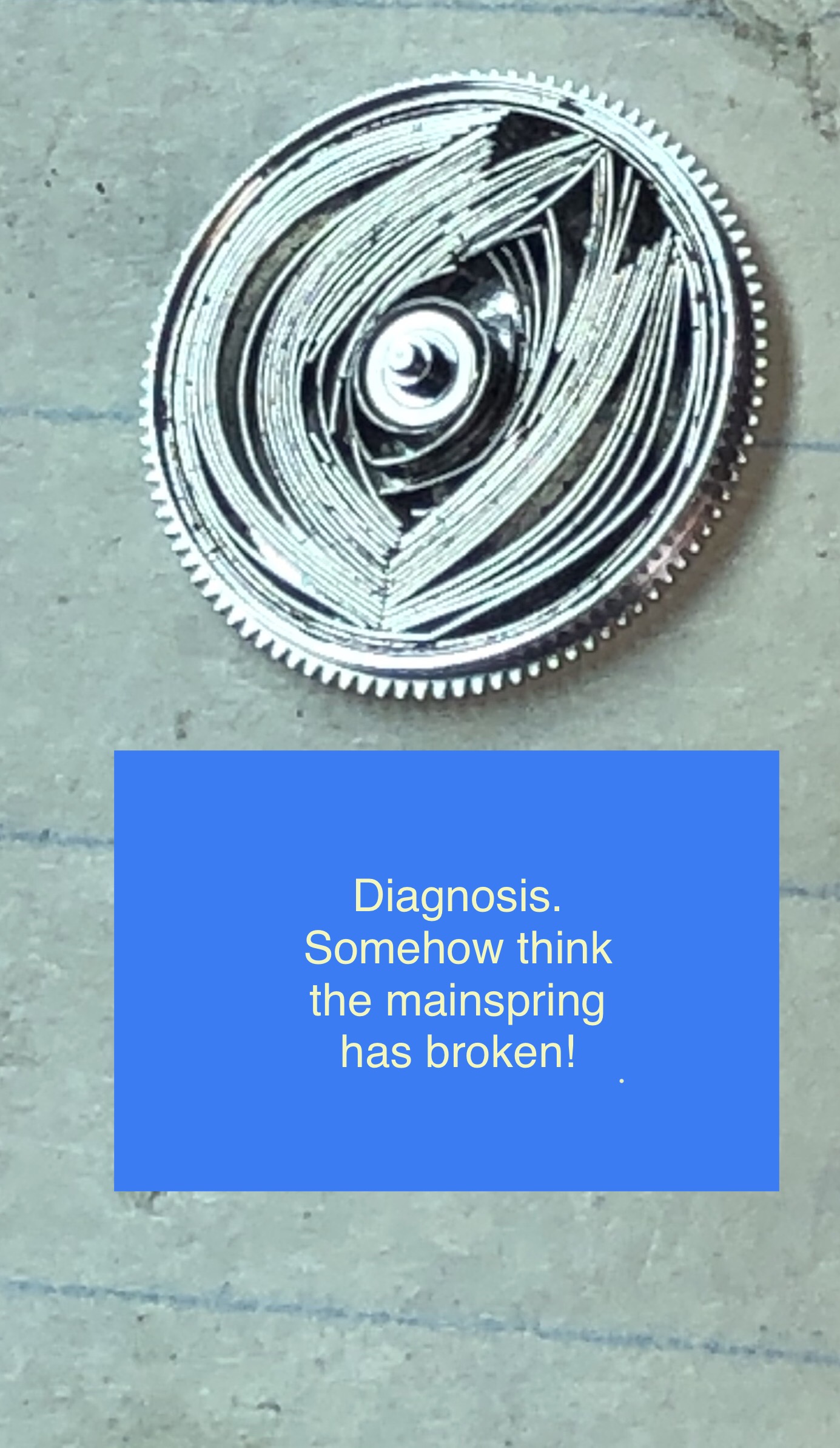

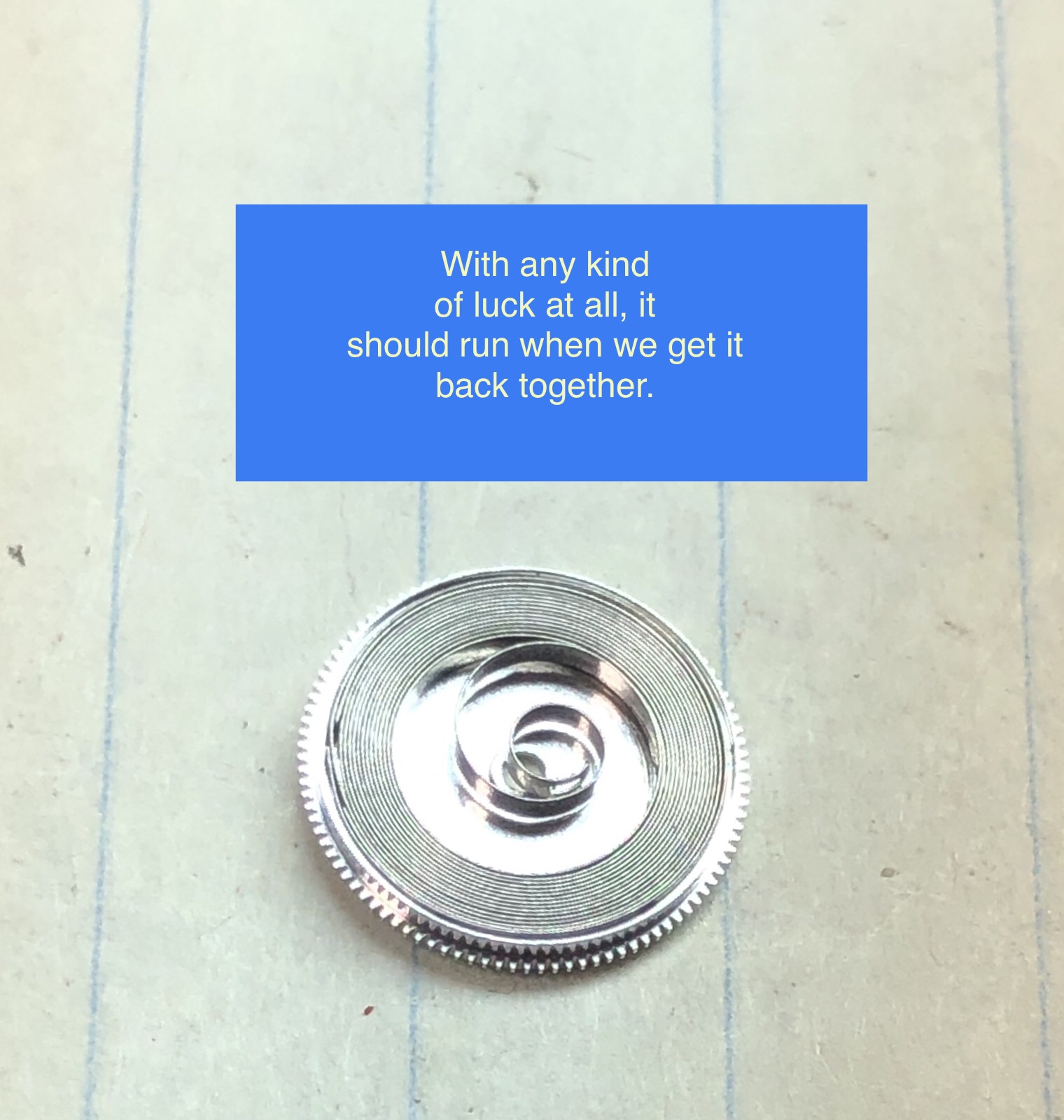

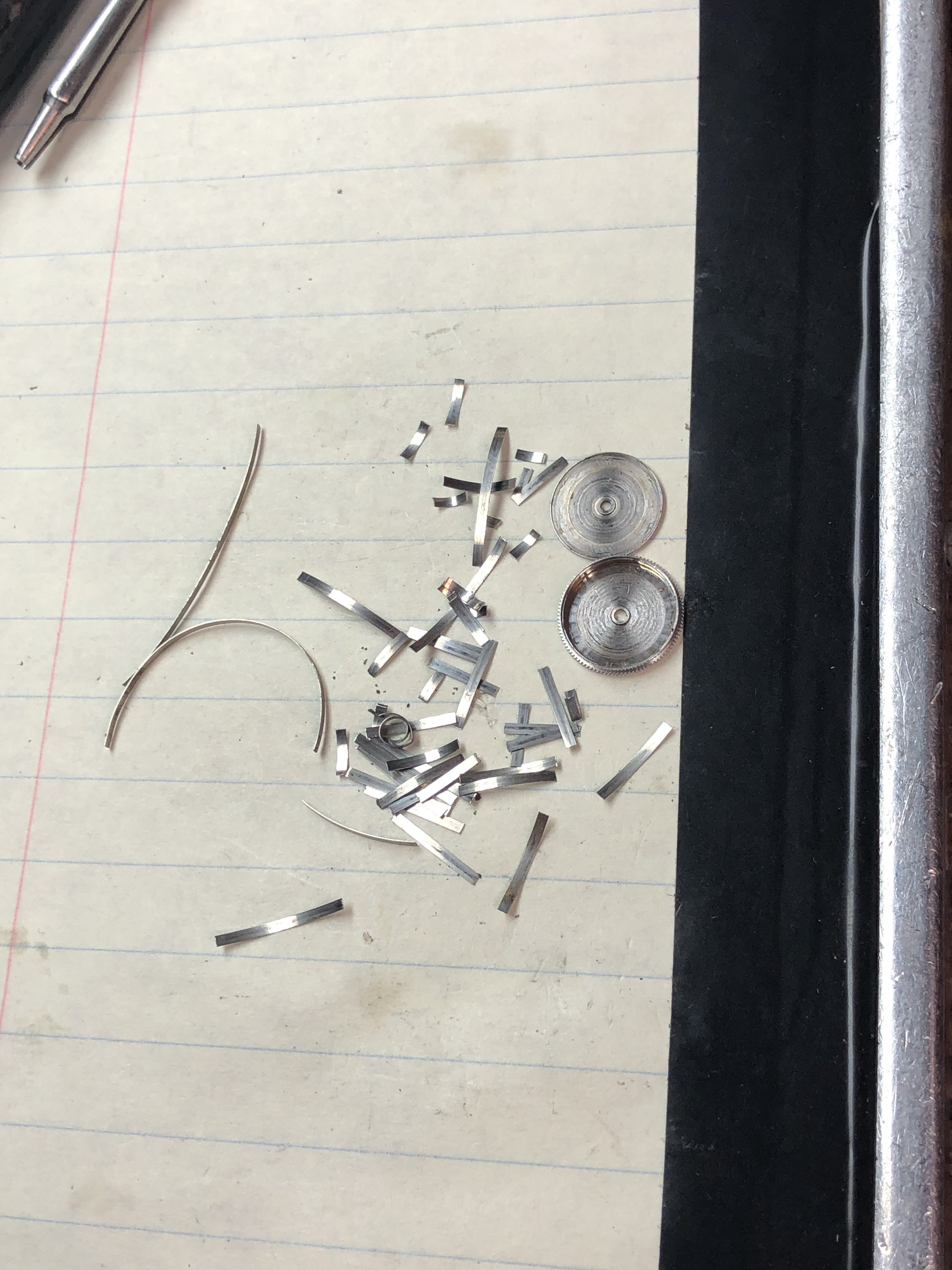

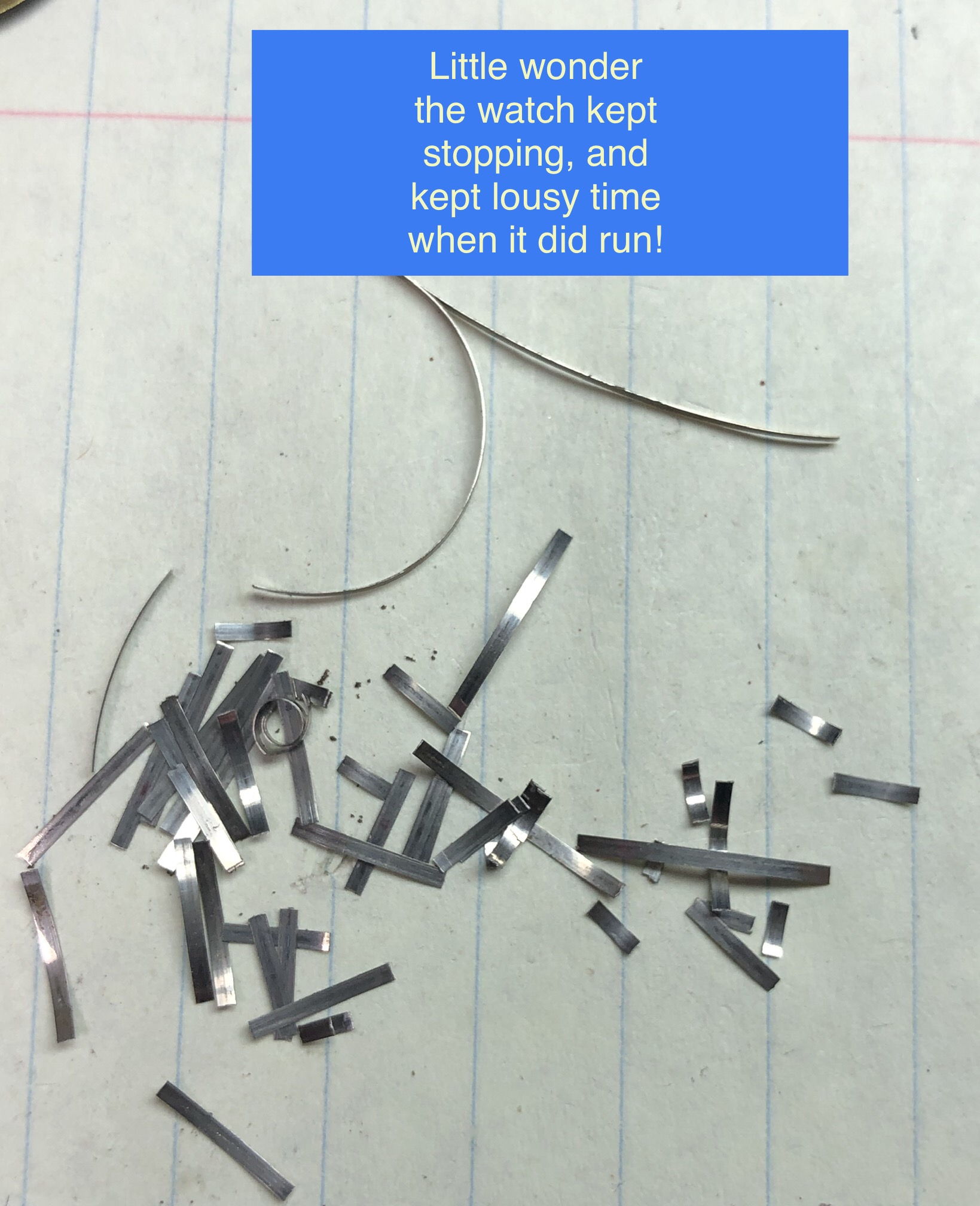

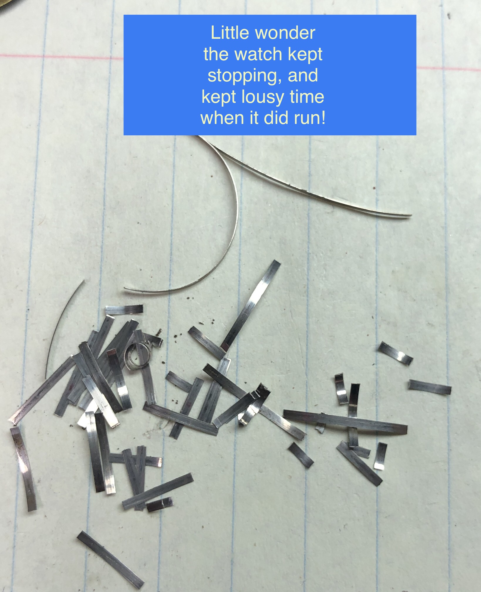

The life expectancy of many mainsprings is approximately 20 years. Many last longer, and some don’t last that long. Metal that is caused to frequently flex can “work harden”, and breakage can result. A mainspring can also lose its hook at the outer end. The type of breakage can give an idea of the cause of the breakage. A mainspring should be replaced (even if not broken) at the time the watch is serviced. I have shown an extreme example of mainspring breakage that crossed my bench recently.
